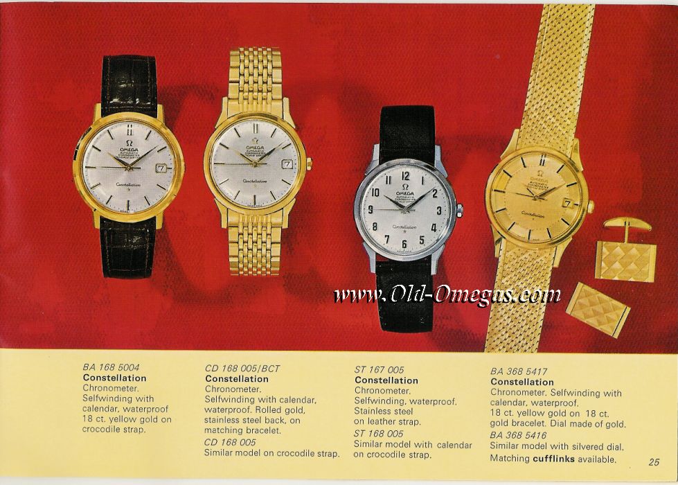

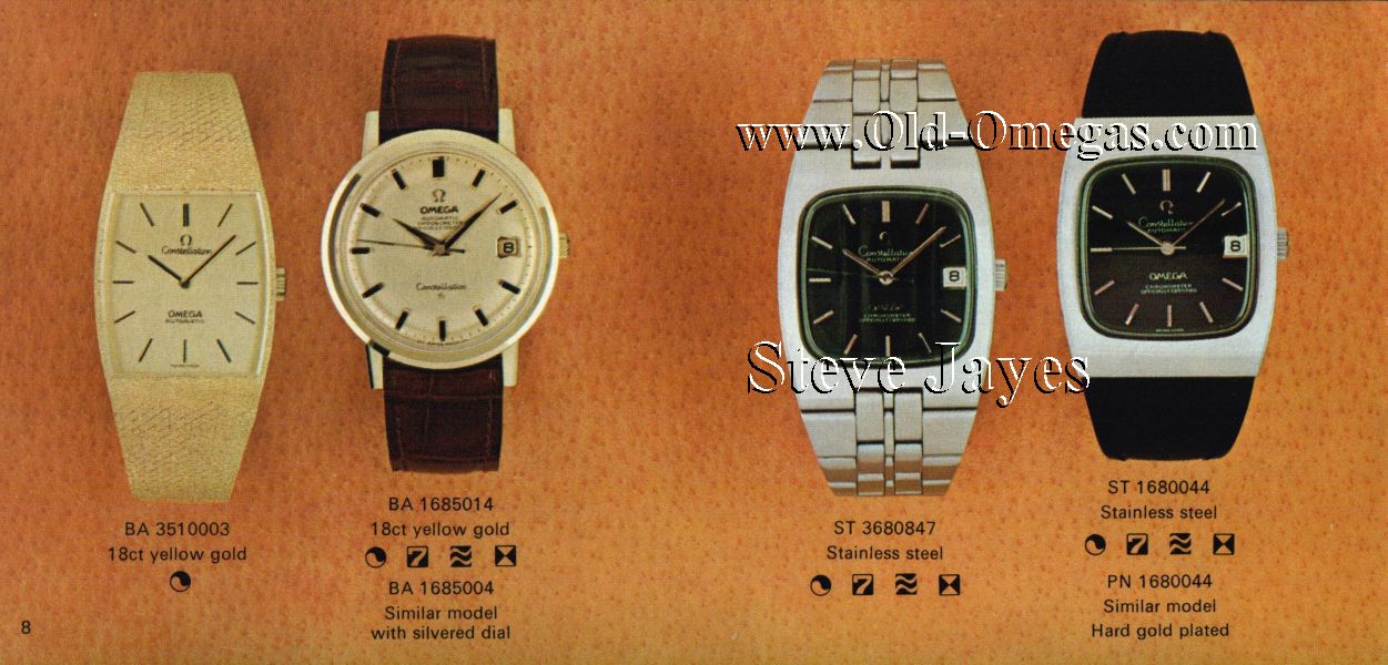

I took another look on the Old-Omegas website, and there is a 1971 UK catalog that refers to the Ref. 168.5004 still being produced at that time.
The dial is an exact match, so my guess is that the same caseback was probably used for the .5014 (deluxe - with gold dial) and .5004 (standard dial). So that is OK and consistent with the movement serial number.
Still, the crown and missing medallion are concerns.
