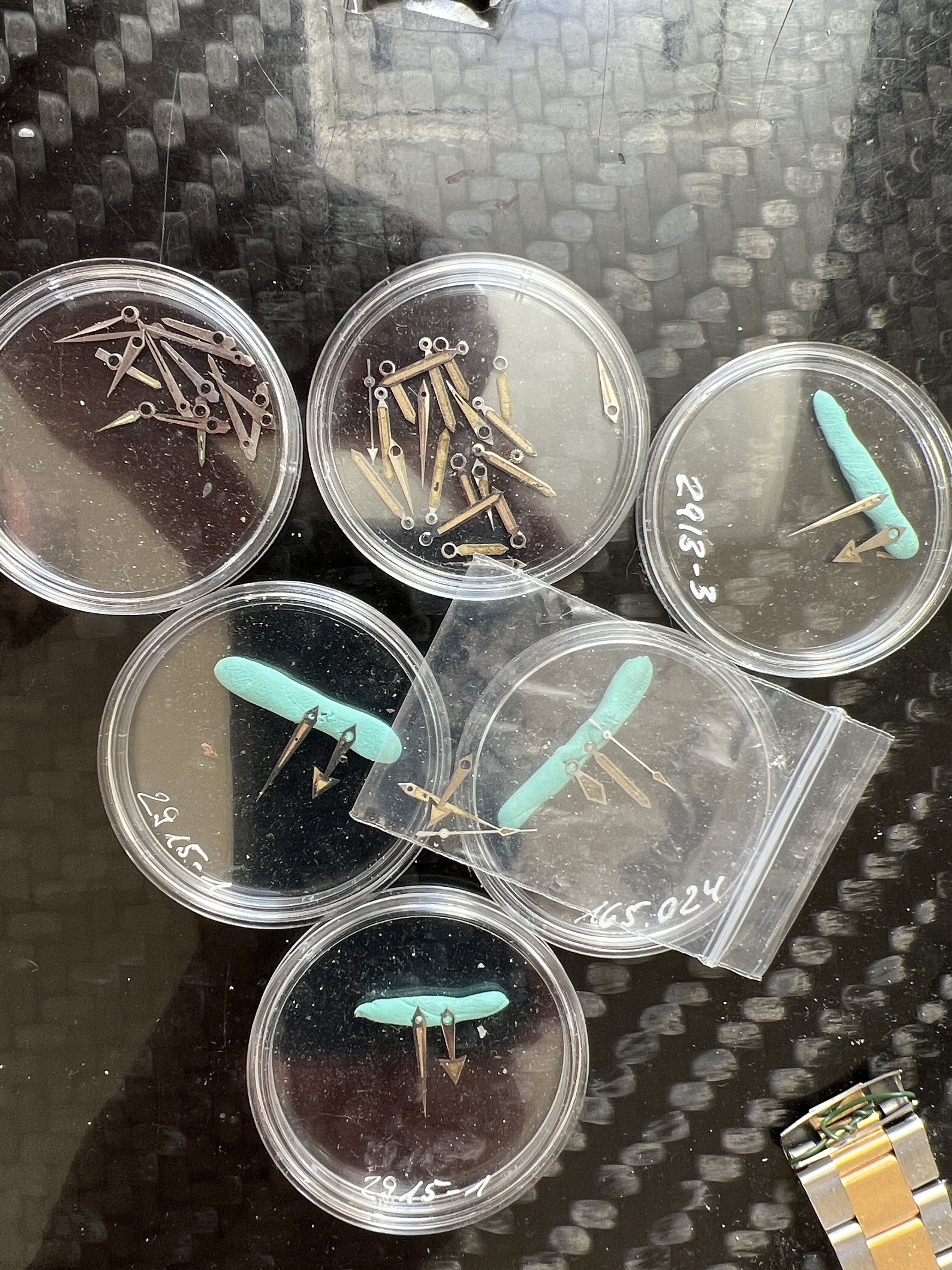

Hi,
I am Michael from tswisst in Germany- long time reader here and lousy poster...I recently obtained a bigger batch of old Omega hands and I am trying to identify them correctly. Does anyone here have the correct hole sizes for the different models/hand types? Help is much appreciated and I am also willing to spend a hand set if needed for a special rate for the guy who helps me in that case. This is not a "for sale-ad" as I want to keep most of the hands for me. Please do not ask me for that. Thank you!

Don't know hole sizes, but and could be in regards to some hands
Container upper left - Dauphine and maybe leaf hands could be Omega. Rest not
Upper middle - Dauphine could be Omega. Fatter hands could be military. Find hole size and check with the MWR forum on military hands.
Upper right, middle left, bottom and baggie - Ranchero hands - caliber 267 and highly sought after
Container 165.024 - Omega 300 hands
Hope this helps
DON

It's not a list as you're looking for, but whenever you have an idea what cal the hands might be good for, you can just check ranfft.de. They list the hole sizes for all Omega movements, if I'm not mistaken.

Omega 550 Hands 1.50 x 0.80 x 0.18mm for SM 300 165.024 / 166.024 in the second container.
Omega 500 Hands 1.50 x 0.80 x 0.18mm for SM 300 2913.
Omega 321 (Lemania CH27 C12) Hands 1.90 x 1.05 x 0.22 / 0.30 x 0.25 x 0.20mm for Speedmaster 2915.

That helps a lot- will work on the hands (have just shown a part of them all) and let you know what my findings are.

One more question: Are the hands for 2915/2913 the same in dimensions exept the hole?

No, not the same as they are for different movements

That is what I asked.... 😀
Same dimensions/ different hole due to different caliber....
