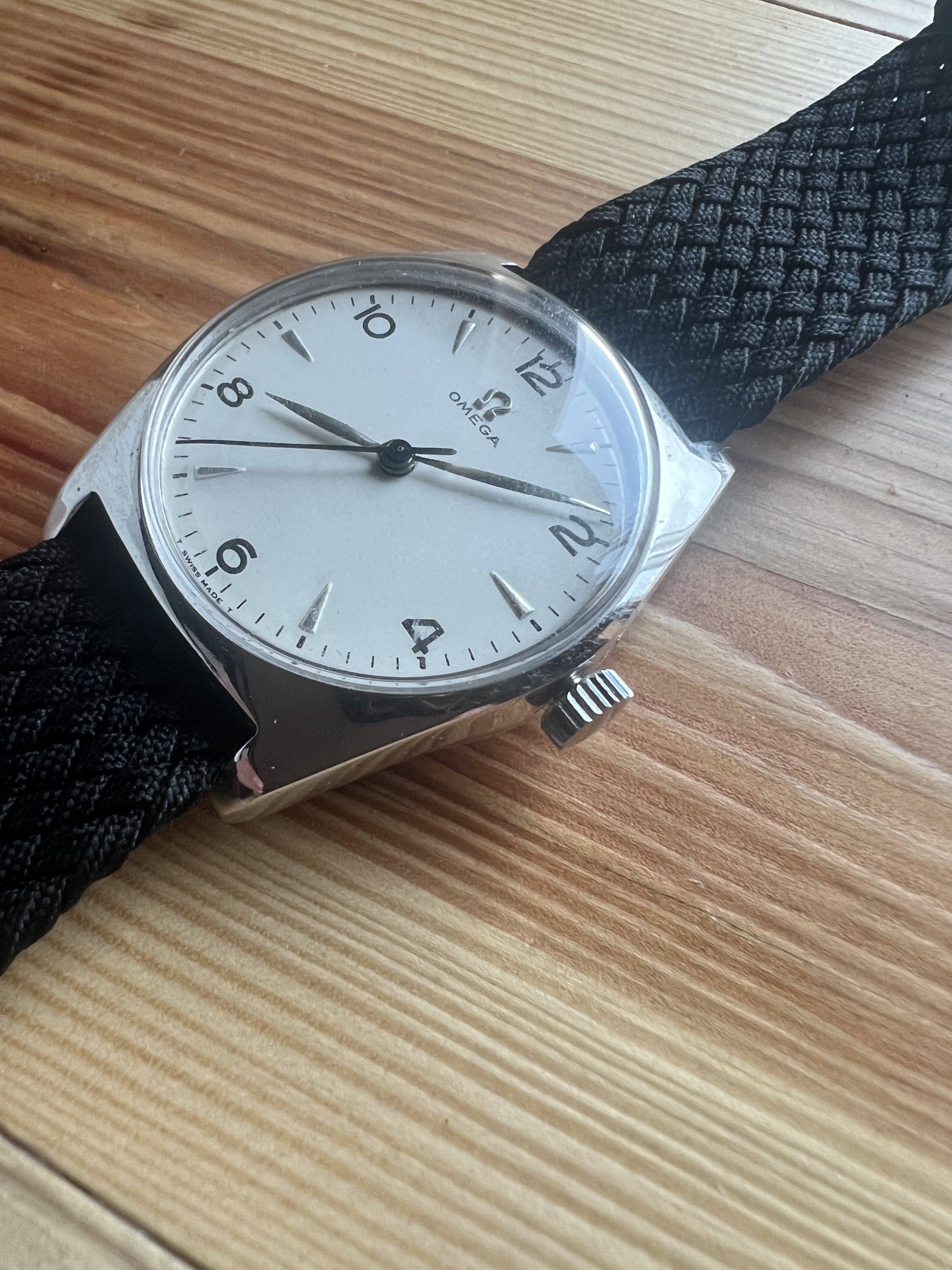

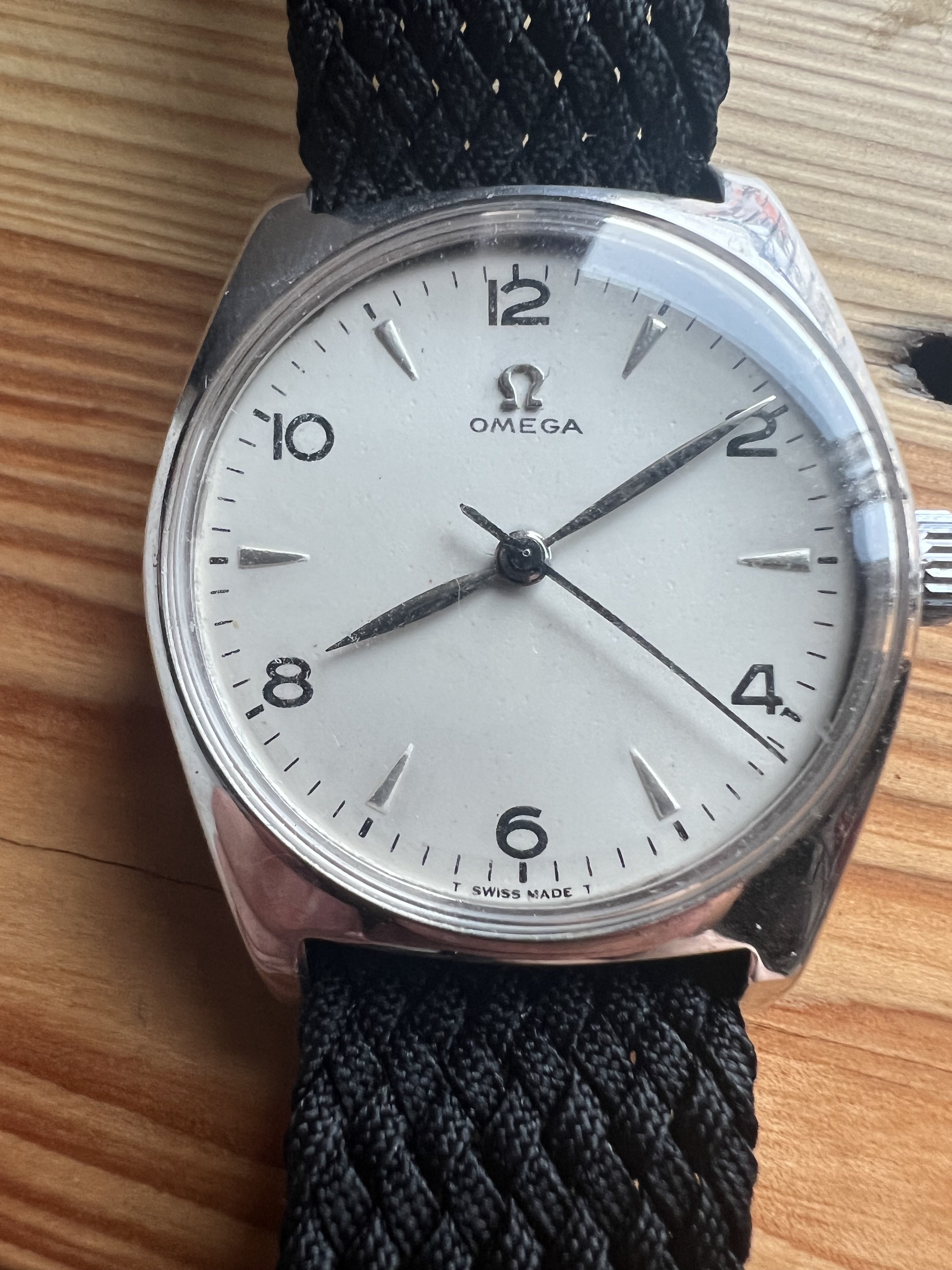

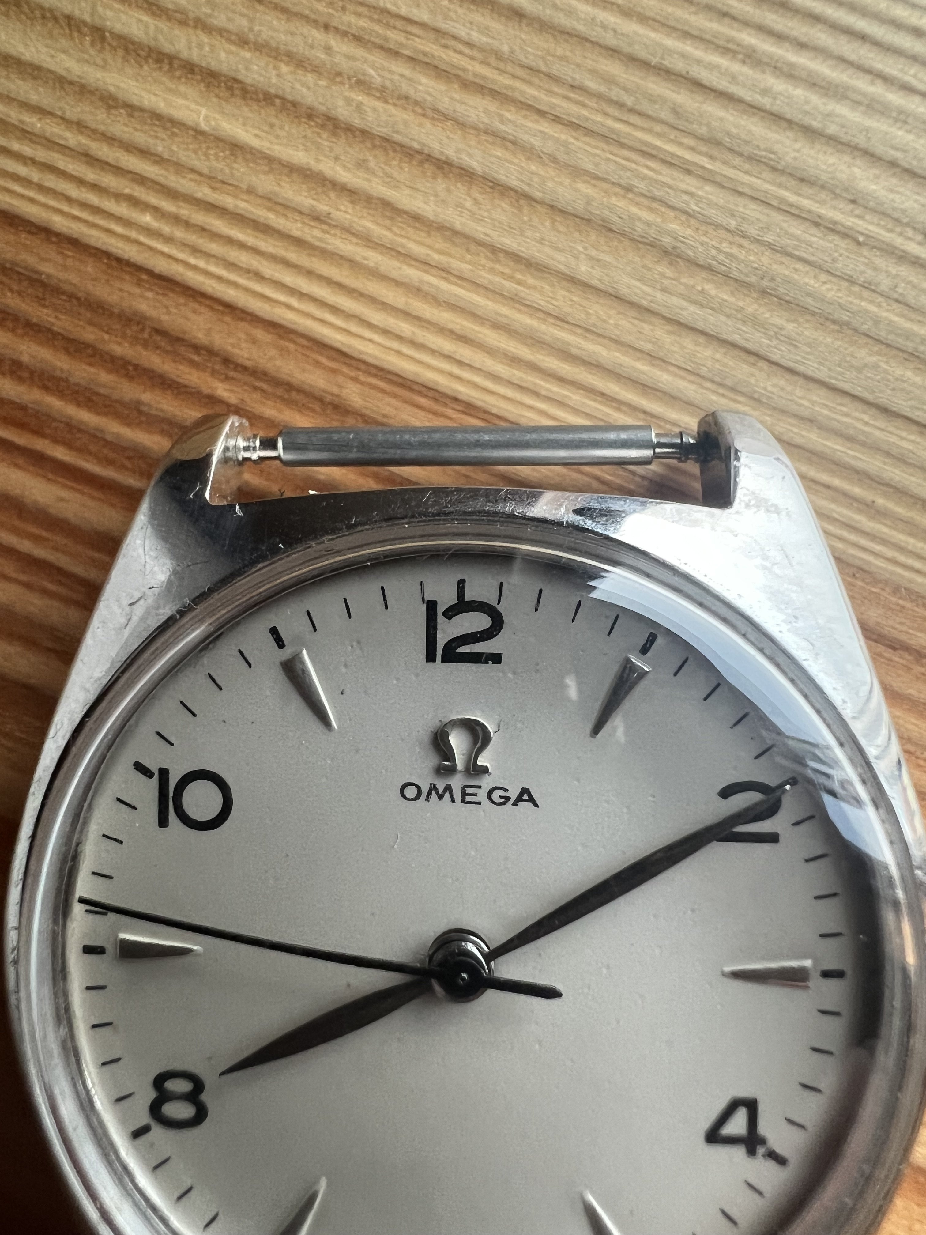

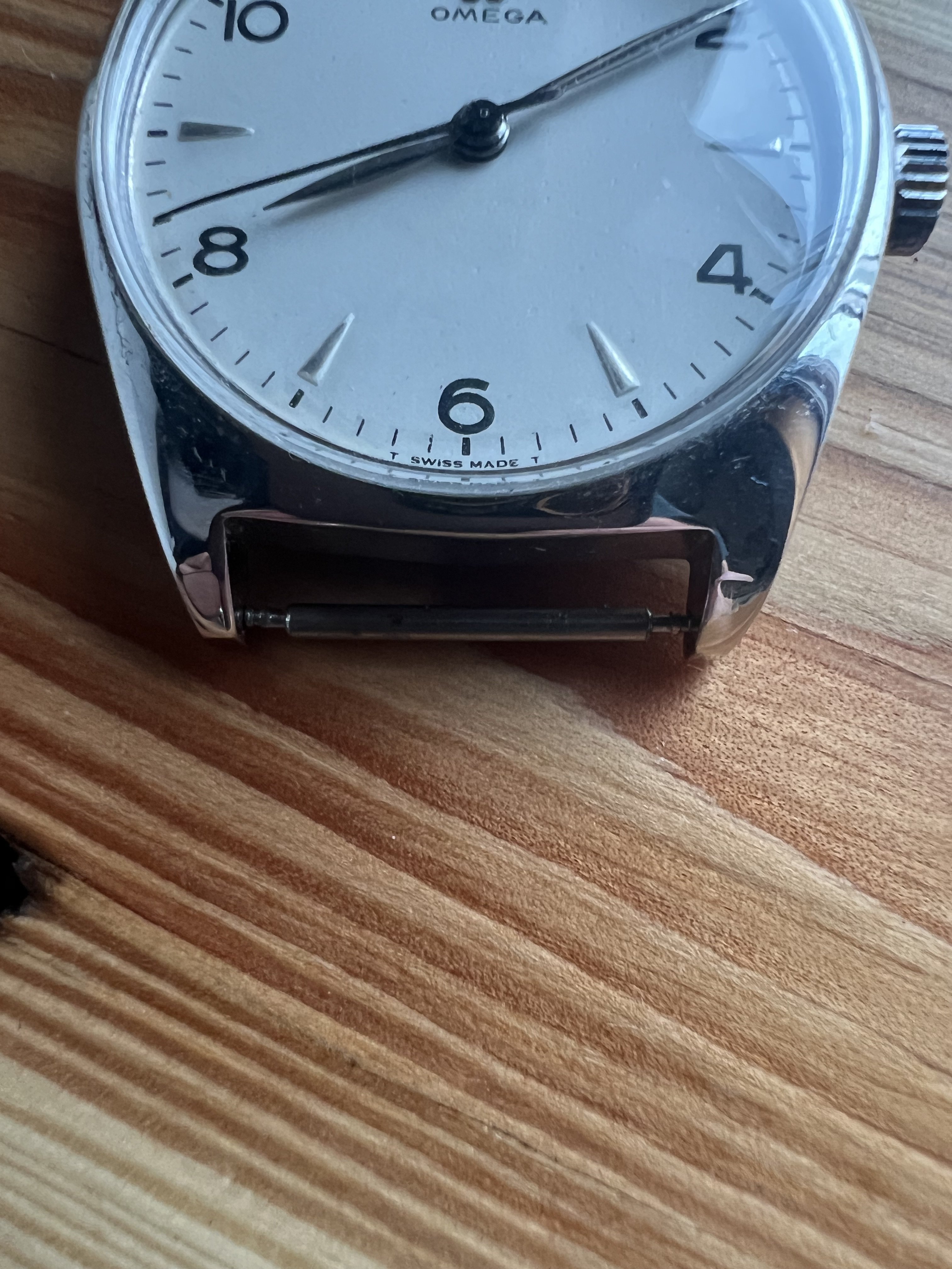

I’d like to know your thoughts on the following watch as it has a case I’ve never seen…
Yea, maybe the dial has been refinished (if it is I’m ok with that), but it’s the case that’s bothering me… Is it legit?

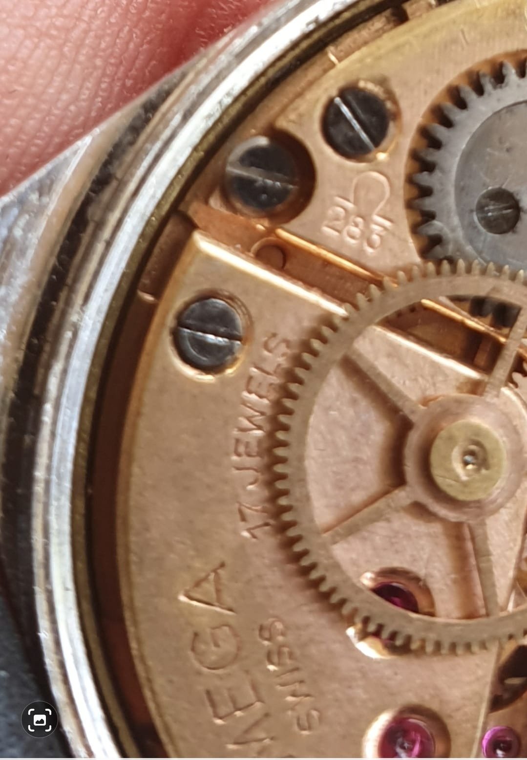

Buy the way it has a 285 movement in it.

What was it supposed to be according to the seller?
18,841
39,184

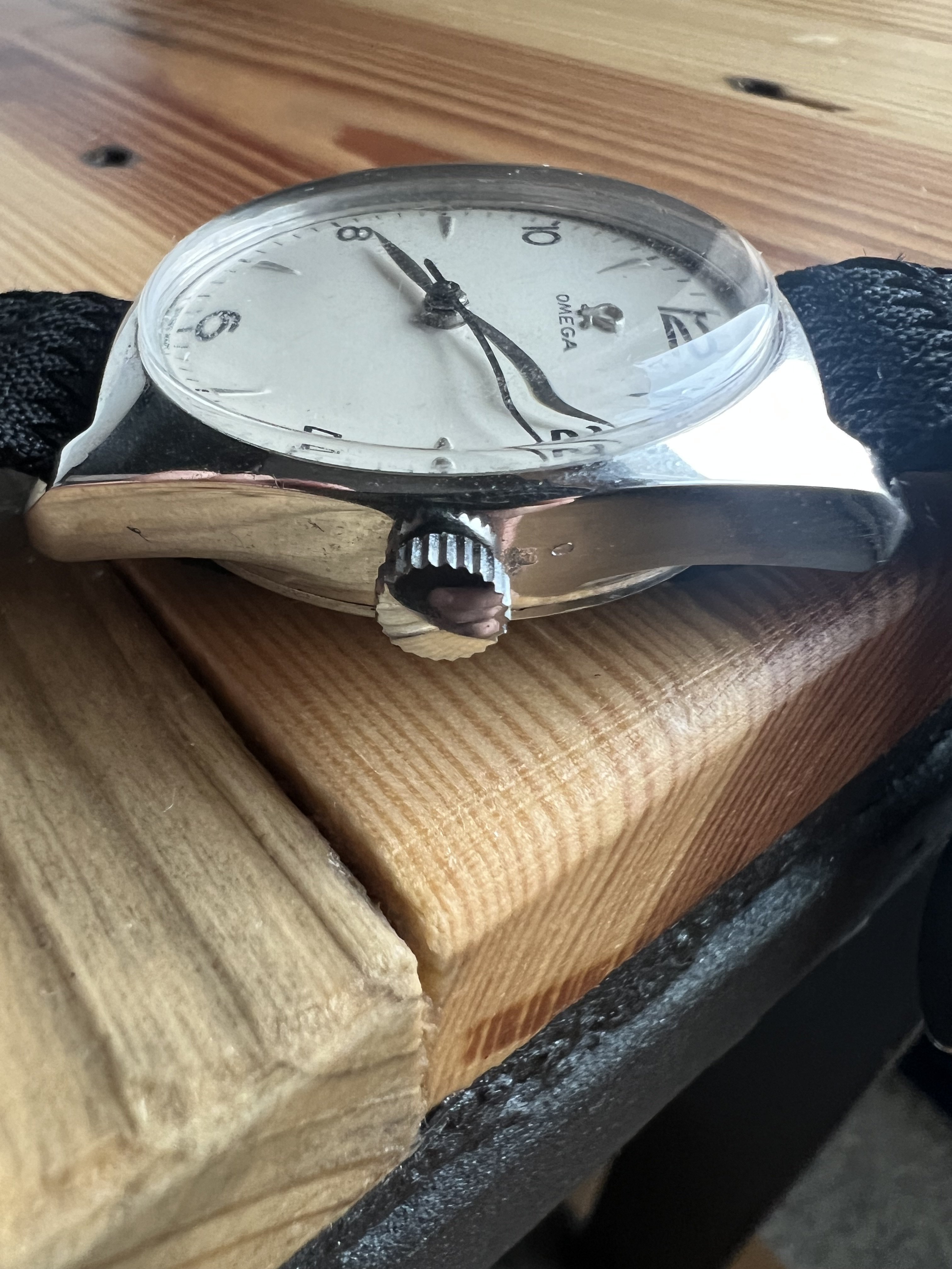

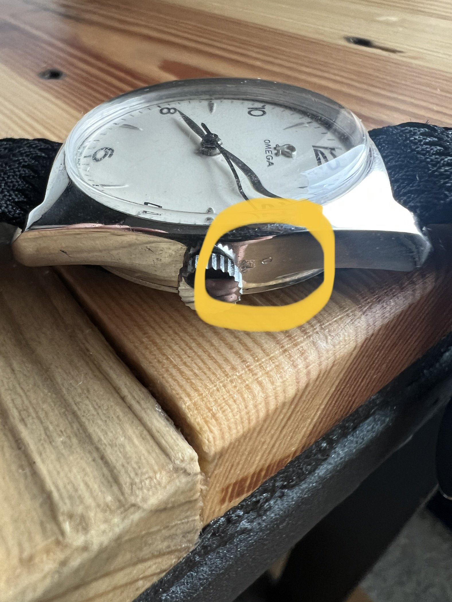

Are they silver hallmarks/import marks near the crown?
Could be a locally produced silver case.
An extremely heavily over polished silver case.
The seller didn’t mention anything about it…
But then again if you’d want to sell a frankenwatch you wouldn’t mention anything, would you? You’d wait for a sucker like me
Thanks for the reply mate. now you mention it there are strange marks near the crown.
See picture below.

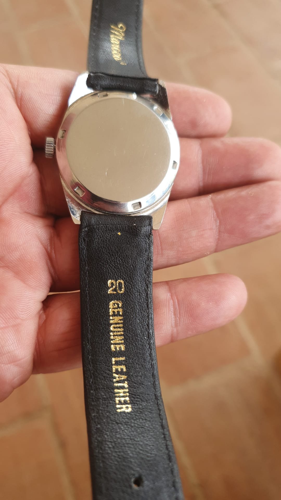

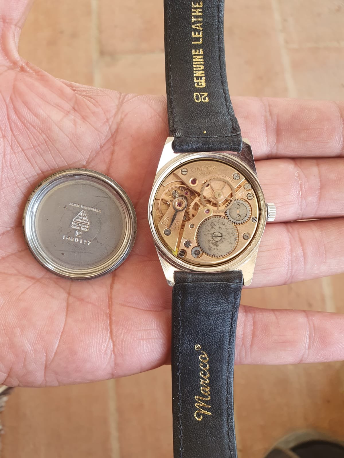

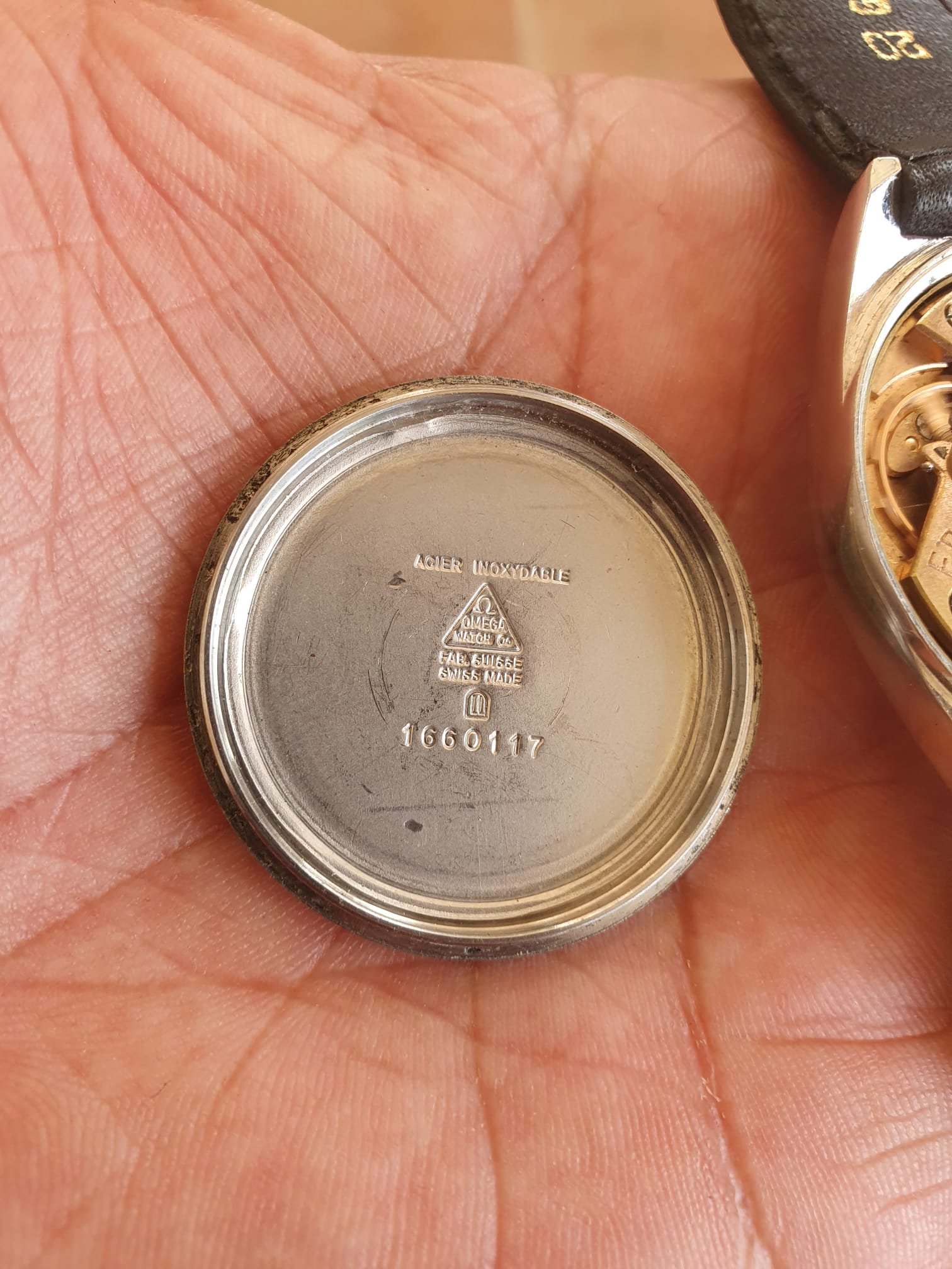

Have you got a pic of the back of the watch?

Can’t seem to find the damn watch
