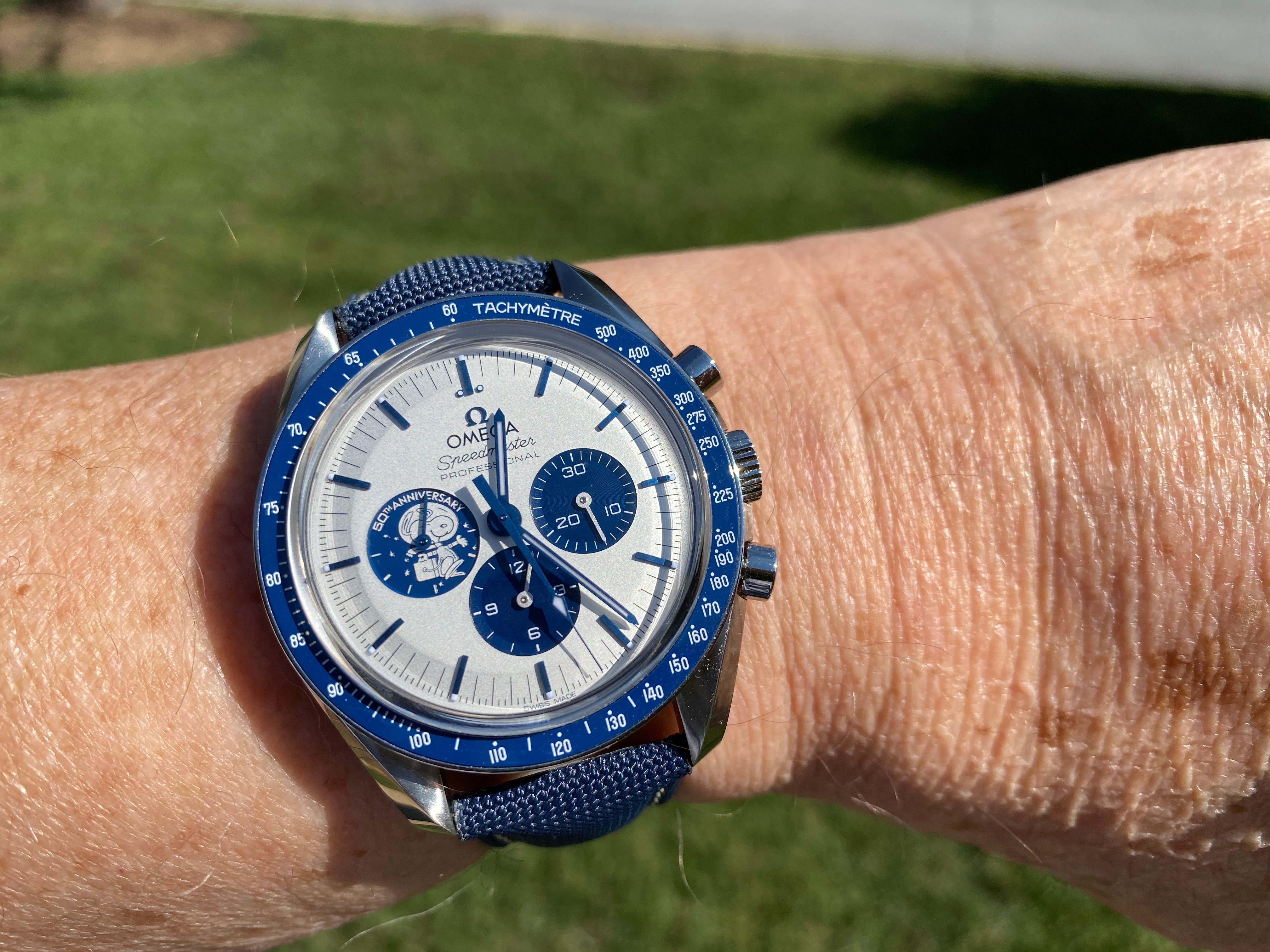

I couldn't make the trip, so I had the Boutique ship it to me and it arrived yesterday.
Love the watch - hate the band. It has be the stiffest, most uncomfortable band I've ever had. I tried bending it to limber it up, but I guess I'll just have to wear it awhile and hope it gets better. I can't recall if any of the preceding 250 pages in this thread mentioned it, but I'll be looking for alternative bands/bracelets.
FWIW, the Boutique said they were receiving 10 pieces this year, and I got #8.
I have a similar strap from Omega (the 19mm blue strap from an AT I believe) that I use on a different watch.
Just leave it clasped around a watch pillow and it'll break it on its own.

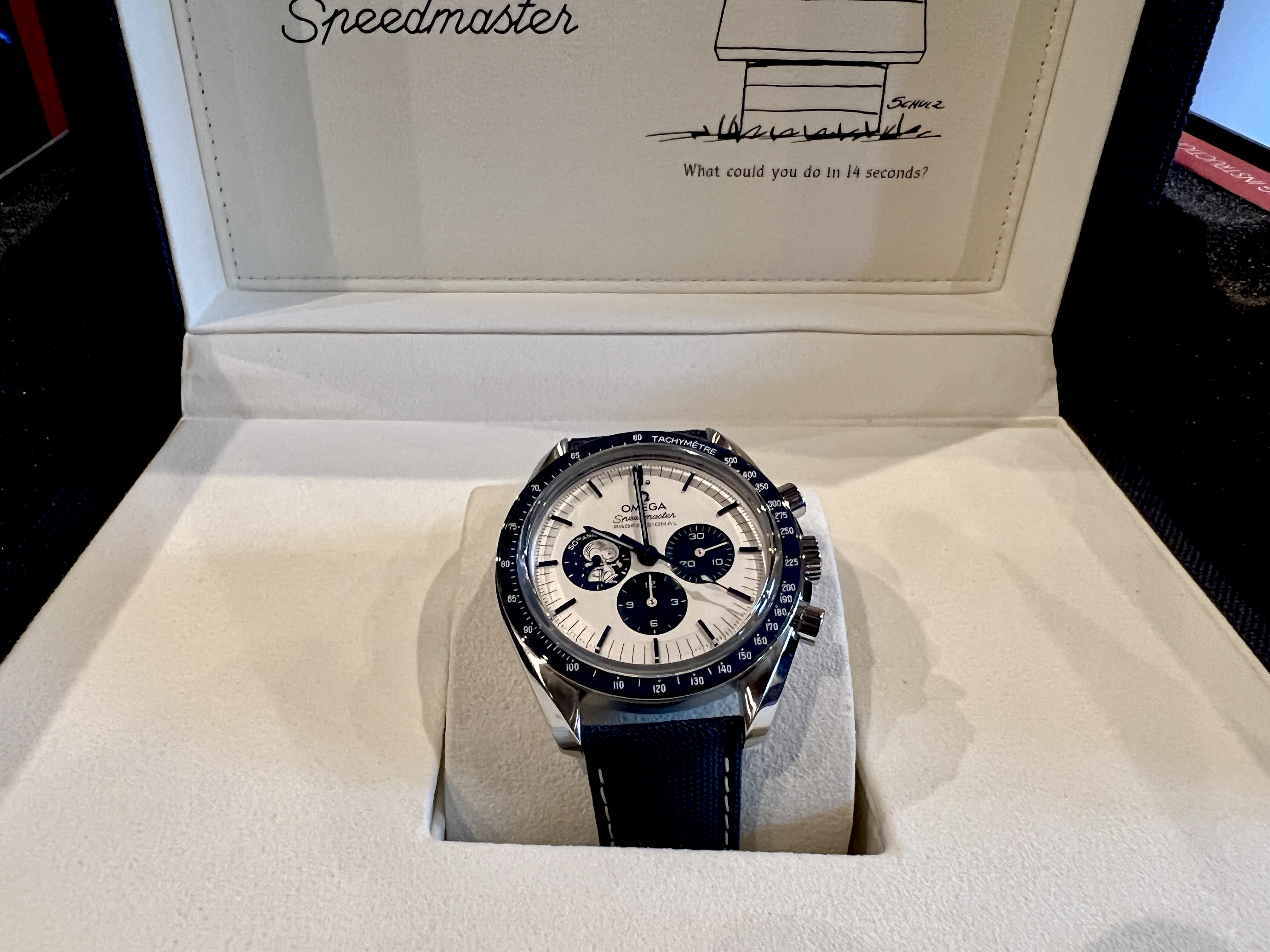

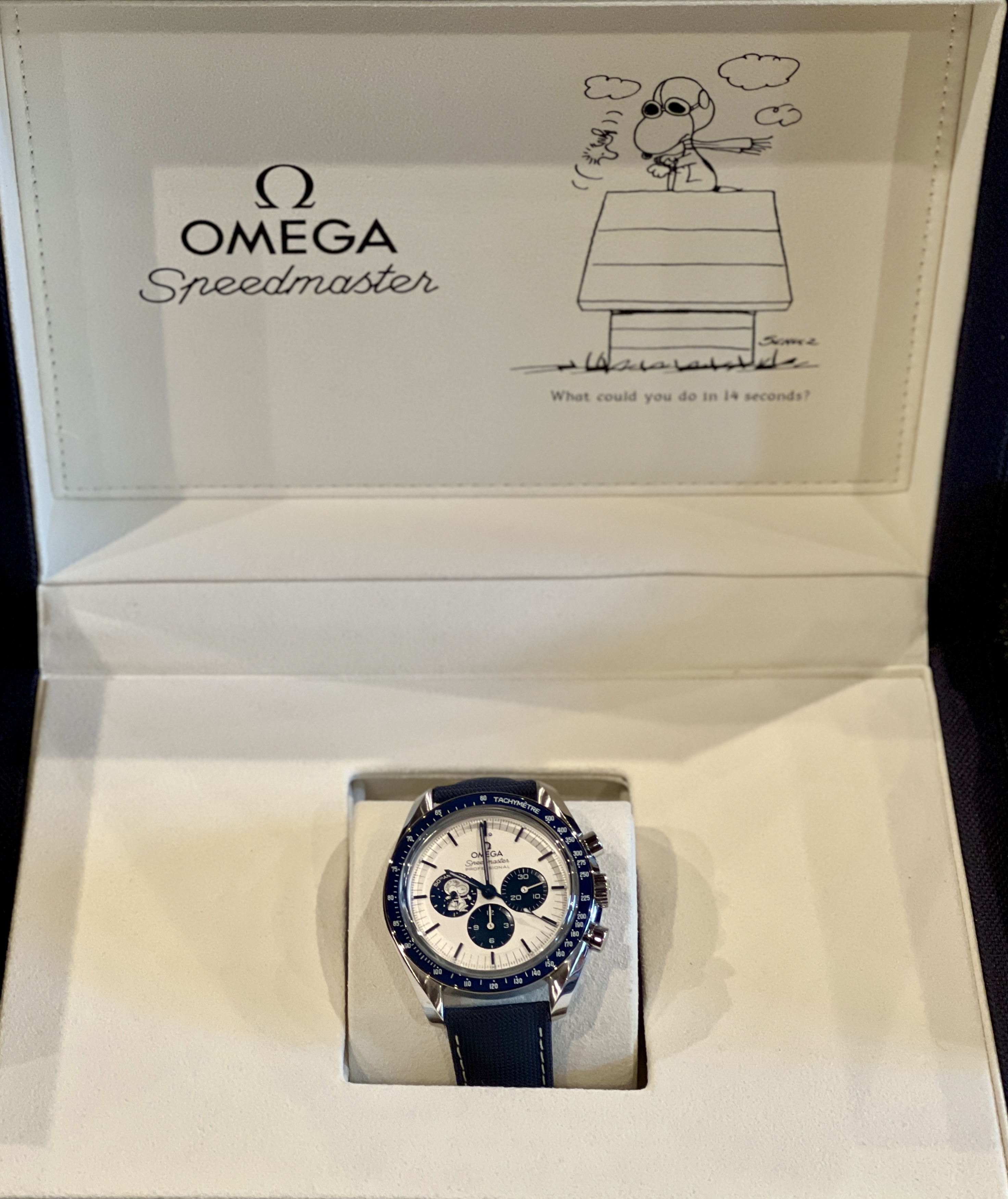

So it arrived a day early. Had a quick look and then back to work! Looks fabulous. Apologies for the rushed amateur photos!
Josh

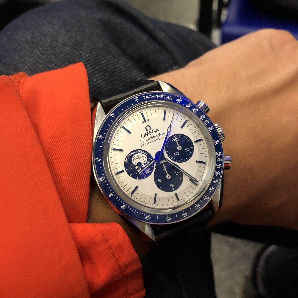

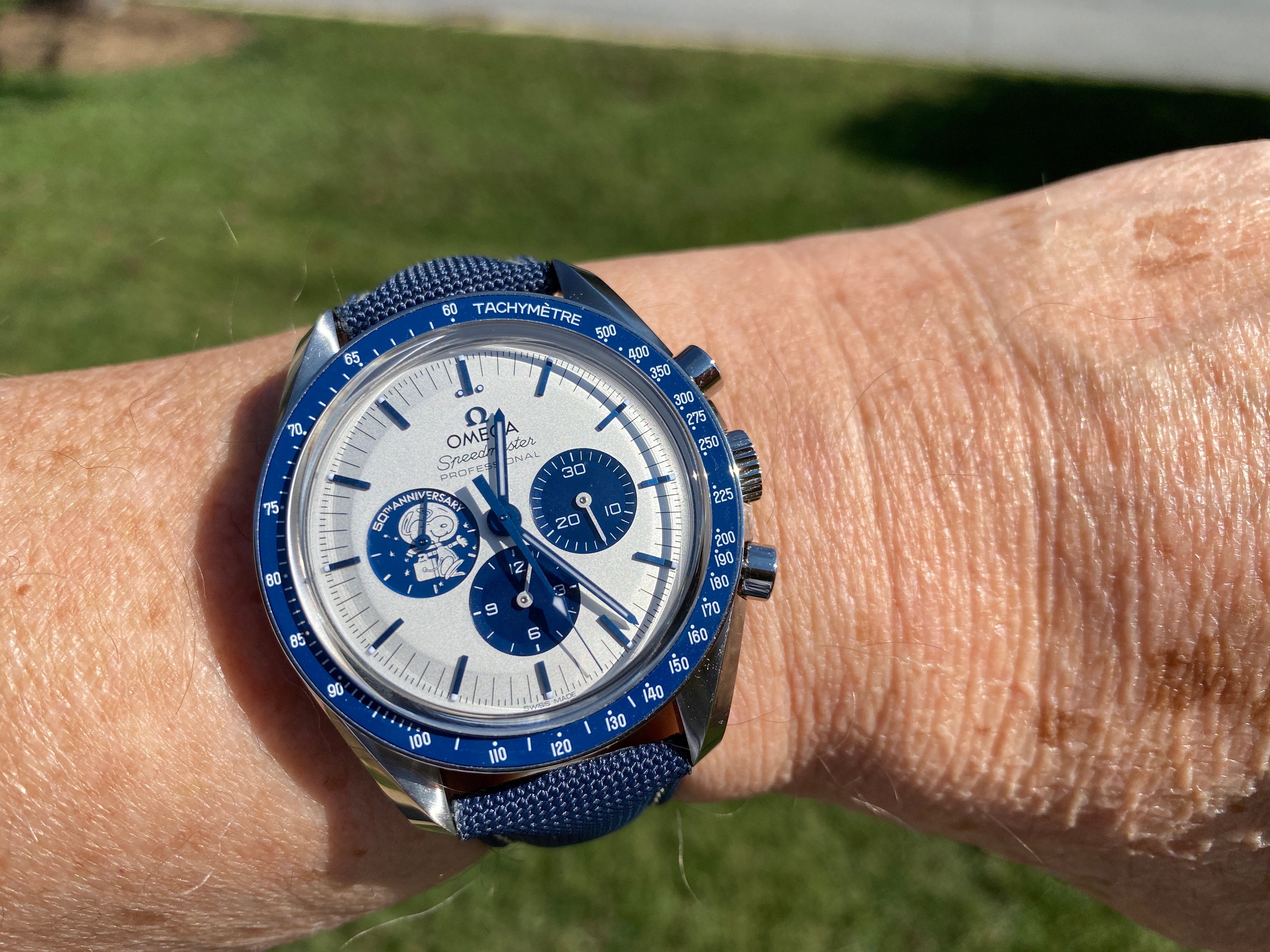

To those still waiting; hang in there, it’s even better in real life!
Especially impressed with the very high resolution printing, which I believe to be better on the production model compared to footage I’ve seen of samples. Amazing piece!

Nice photo! What camera did you use?
1,578
6,819
Thank you! Nothing fancy actually, a regular iPhone (8, I believe). Just had some luck with the light present on the train.

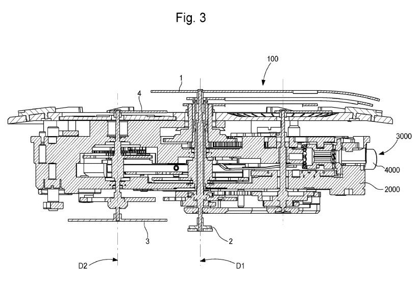

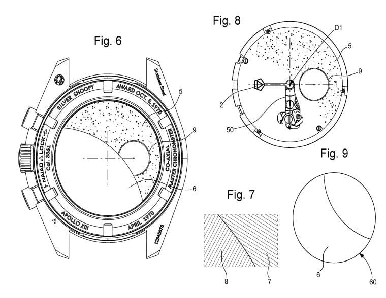

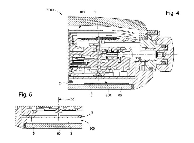

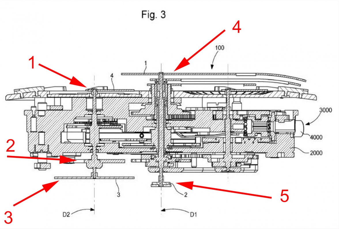

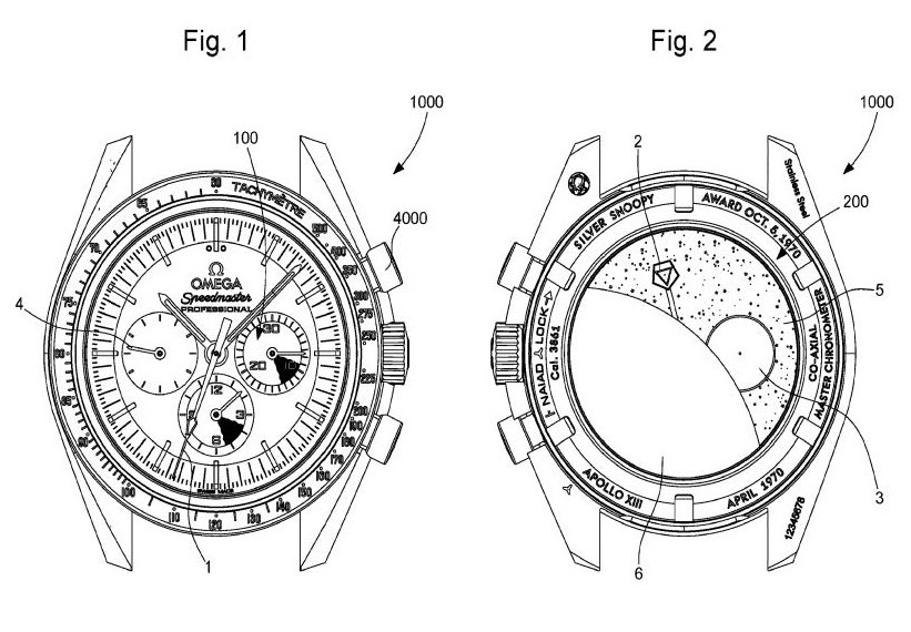

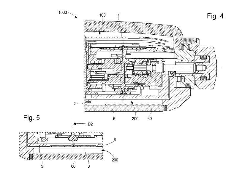

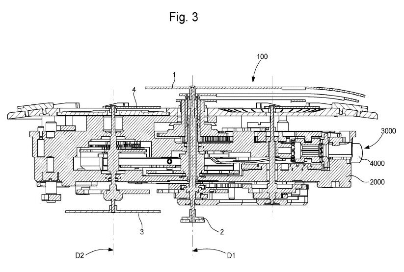

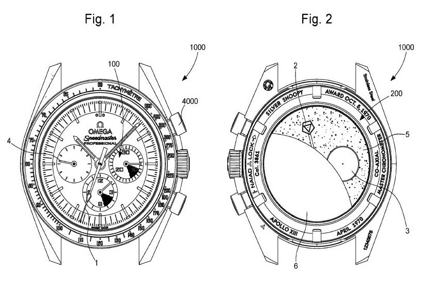

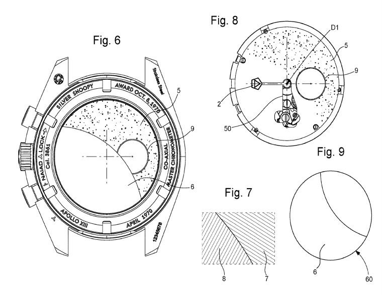

There are already pictures floating around of the Snoopy 3 disassembled, but these fun figures also make it pretty clear how the mechanics behind the Snoopy animation work.
US Patent # 20210294271

30,248
78,088

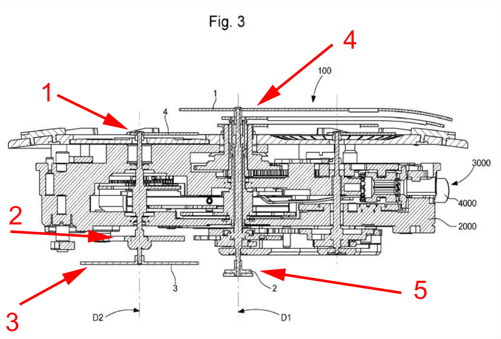

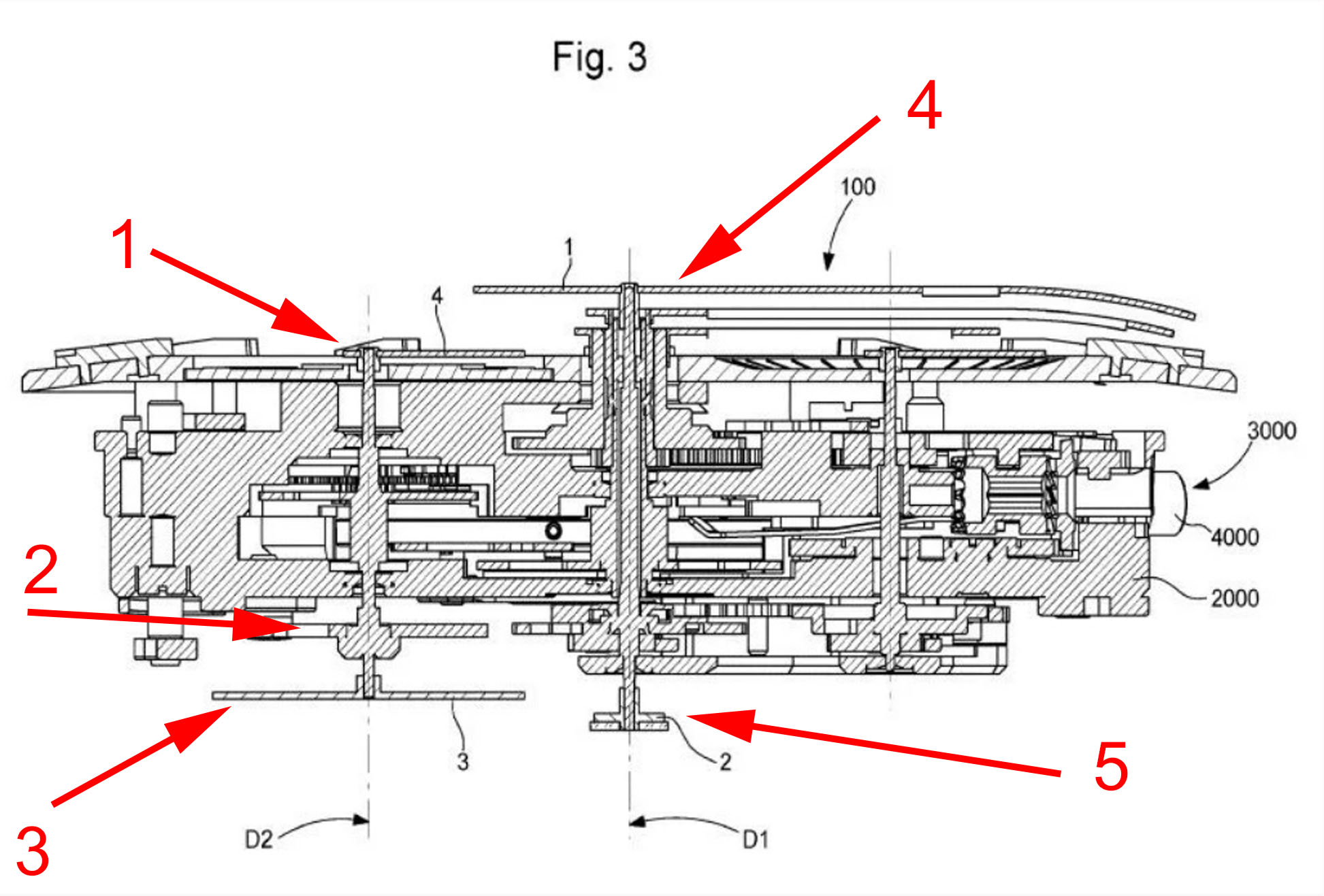

Pretty clear you say? 😟
This is really the only view you need to understand this...
I've added some arrows and numbers to help.
1 - this is the constant seconds hand installed at the 9 o'clock position. This hand is installed on an extended post from the fourth wheel of the movement, which turns at 1 revolution per minute.
2 - this is the wheel that is pressed on the extended post of this same fourth wheel on the top side of the movement (the back) that drives the chronograph on the watch. These two things are the same as a regular Speedmaster.
3 - Omega further extended this post, and then pressed a small printed disk with the earth on it, onto the extended post. Like the constant seconds hand on the opposite end, it runs when the watch is running, and turns at 1 revolution per minute.
The capsule complication (if one can call it that) is similar...
4 - this is the chronograph seconds recording hand, that as the name suggests, records the seconds when the chronograph is running.
5 - the chronograph wheel was modified similarly to the fourth wheel, with an extended post coming out the top side of the movement. The capsule is simply another hand that is pressed onto the end of that post.
So all this animation consists of is extending two posts a little longer than they were, and pressing things that are similar to regular hands onto those posts. I'm a bit surprised it was different enough to actually earn a patent.
Hope this helps.
Cheers, Al
Hope this helps.
Helped a lot, thanks - and probably in line with intuition.
Curious and sure you’d know whether the extra weight or resistance resulting from extended posts, cantilevered Snoopy capsule, etc., may have required any other running adjustments to the watch or chronograph?
30,248
78,088
Nothing is noted in the technical guides, so it appears not.
