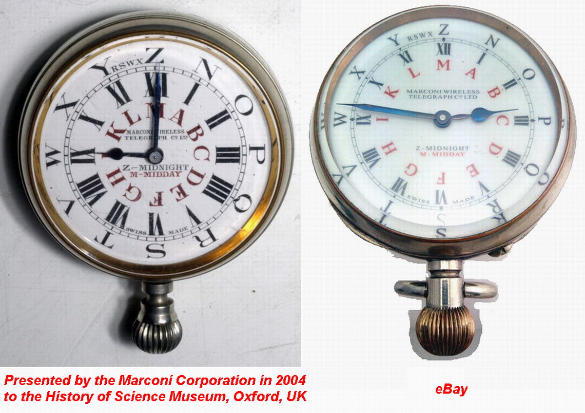

Sadly there are several errors in the posting - but of most significance is the dial, the whole point of the watch, which in my opinion is not original and is a fairly recent replacement: it is a ‘replica’. I am not saying that the seller has introduced this fake dial: he may not be aware - but it is not original.
If the subject of Marconi ‘Morse watches’ is of interest, see a different thread which gives some history: ‘The story of the old ‘Morse’ and Marconi clocks and Goliath pocket watches’.
https://omegaforums.net/threads/the-story-of-the-old-‘morse’-and-marconi-clocks-and-goliath-pocket-watches.121716/
The advertised watch is (in my opinion) not original. Of relevance, in 2004 the Marconi Corporation presented an original of these watches to the History of Science Museum in Oxford, UK (this IS original!). Below is an image
which shows the two watches together:

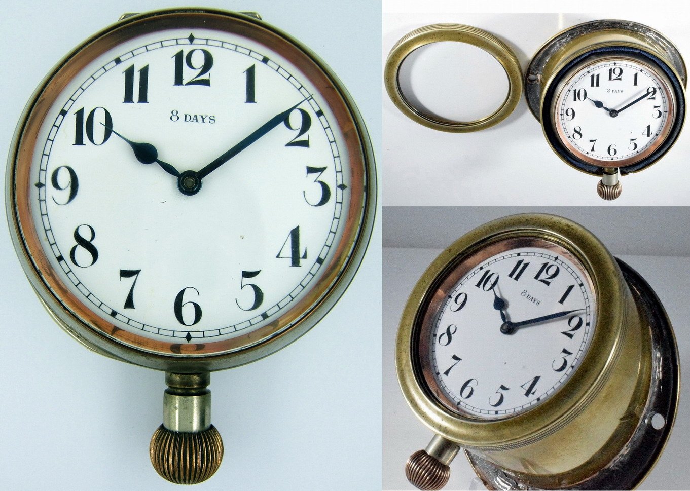

Clearly there are similarities. However, of significance is that the Marconi watch (left) is inverted, has no bow and has the stem at the bottom - and the watch will probably have been mounted in a suitable stand for that purpose. This would be similar to pocket watches that were used in the early days of motoring (around 1905 - 1910) that were also inverted, with no bow but the stem at the bottom: they were mounted on a car’s dashboard and could be wound/set from below (an image of such a watch is below). Of course this watch has nothing to do with Marconi - it is shown only to illustrate a watch from this period which was intended (and mounted) for a purpose.
As we see, the eBay watch started life with the stem at the top - which is why it has a bow - and indeed the seller offers a leather-covered stand which would take the watch with the stem/bow at the top (and then this dial would be upside down!). In other words, a watch with a bow would be intended to have the bow/stem at the top (even attached to a chain): if intended to be ‘inverted’, with stem at the bottom, there would be no bow.

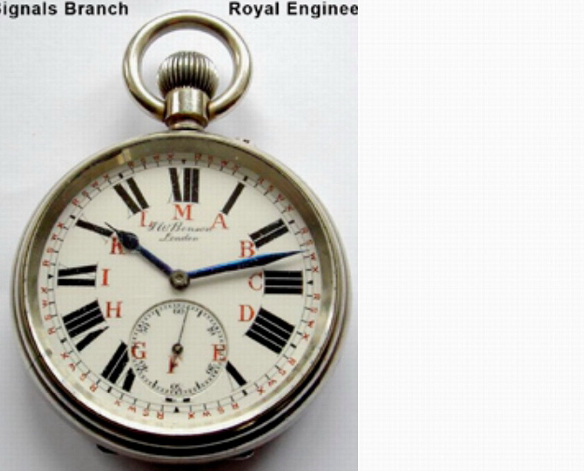

The separate thread referred to above which covers the Marconi story and ‘Morse watch’ in more detail, includes a link to a very interesting article by David Read. He incudes an image of an earlier ‘Morse watch’ (not Marconi) which dates to the period when the British Army (as we see, the Signals Branch of the Royal Engineers) had these special watches, which were intended to be mounted vertically, stem/bow at the top - presumably to be carried by a soldier. But this was how that watch was intended to be.

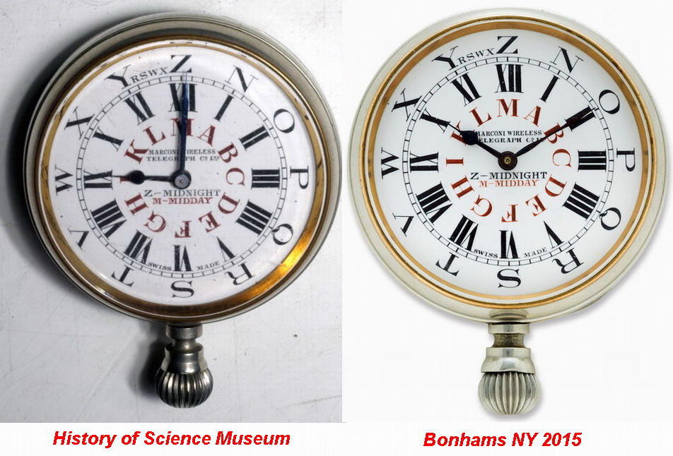

In that thread, @JimInOz highlighted another (original) version of these watches which was sold by Bonhams in NY in 2015. Here’s the link:
https://www.bonhams.com/auctions/22404/lot/7/?category=list&length=12&page=1
Here’s an image which shows the two (I think original) Marconi Morse watches I know of so far, one in the Museum of Science (as shown above) next to the Bonhams watch:
