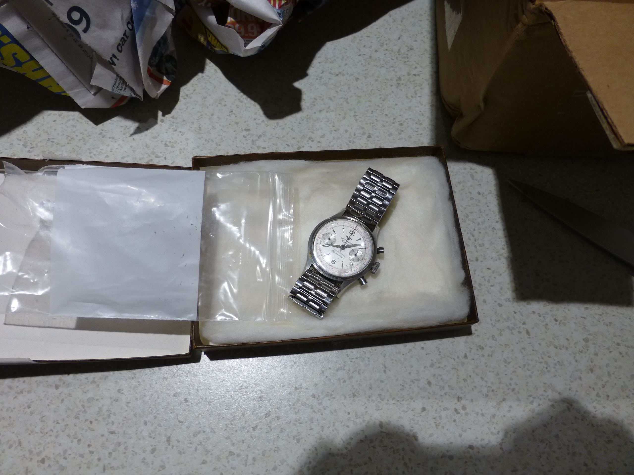

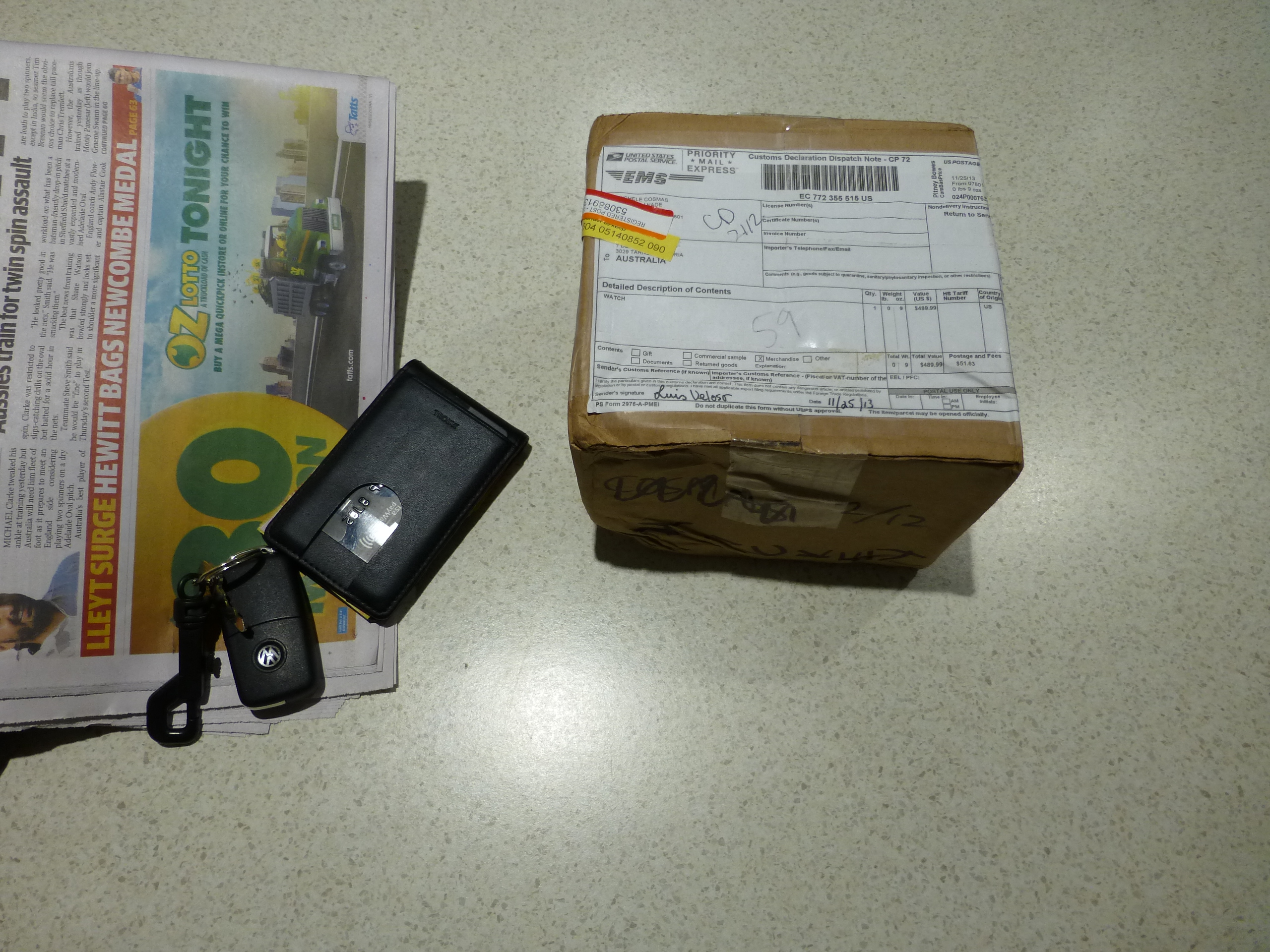

Package collected! 馃榿
Postal Services of USA and Australia competing for handling damage 馃槨
All is well though, packed by the sender in a sturdy box, cushioned by pages from "The Record", a Joizy tabloid??馃摉
And inside, the chrono, resting on a bed of soft cotton wool 馃ケ

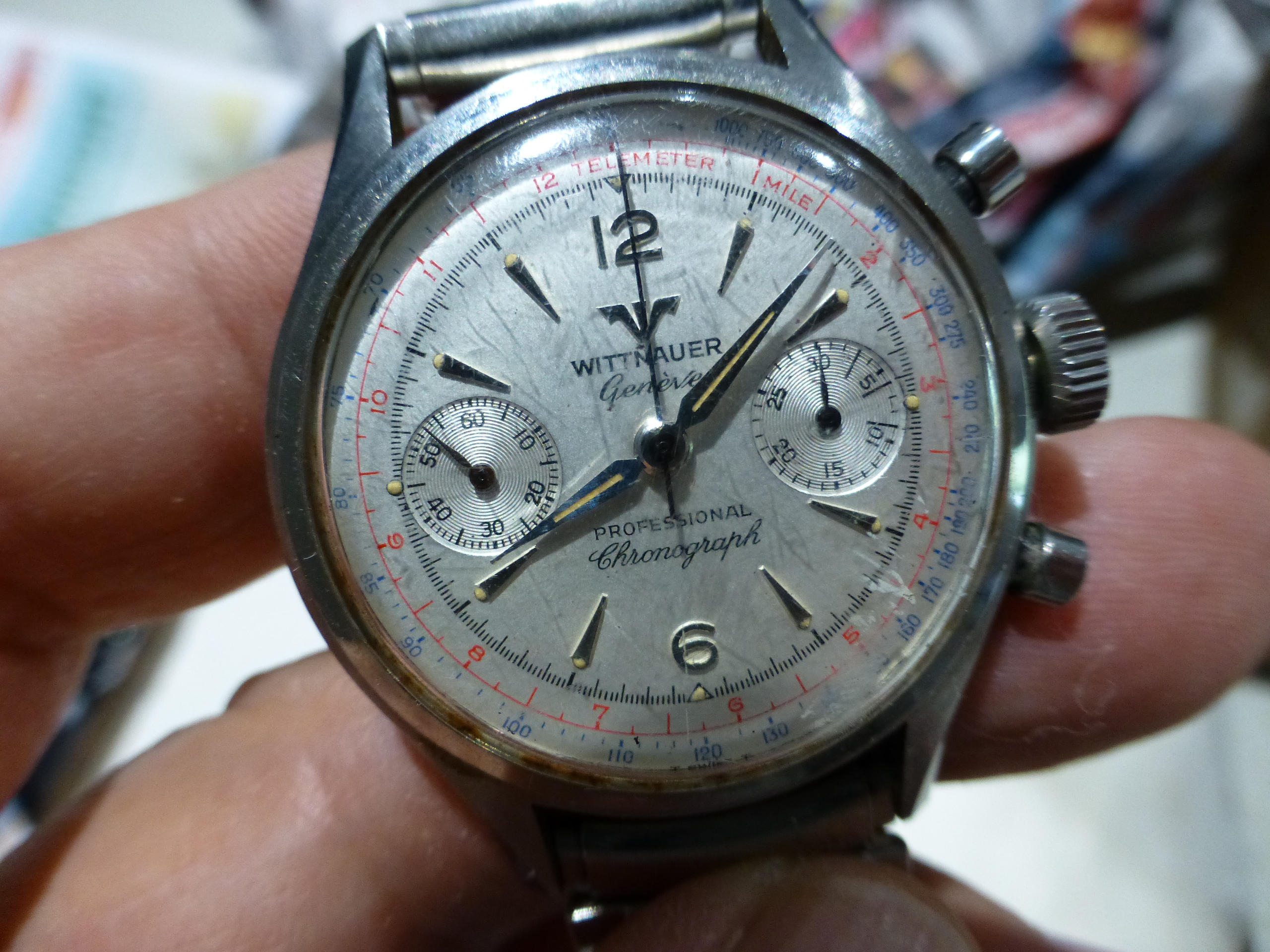

A quick look reveals a little gem in need of some TLC 馃槵
After a cursory buff with Brasso and a quick dust off, it starts to bloom 馃グ
More pics to follow later on after I've had a chance to to a proper clean and polish (no buffing wheels involved though!)

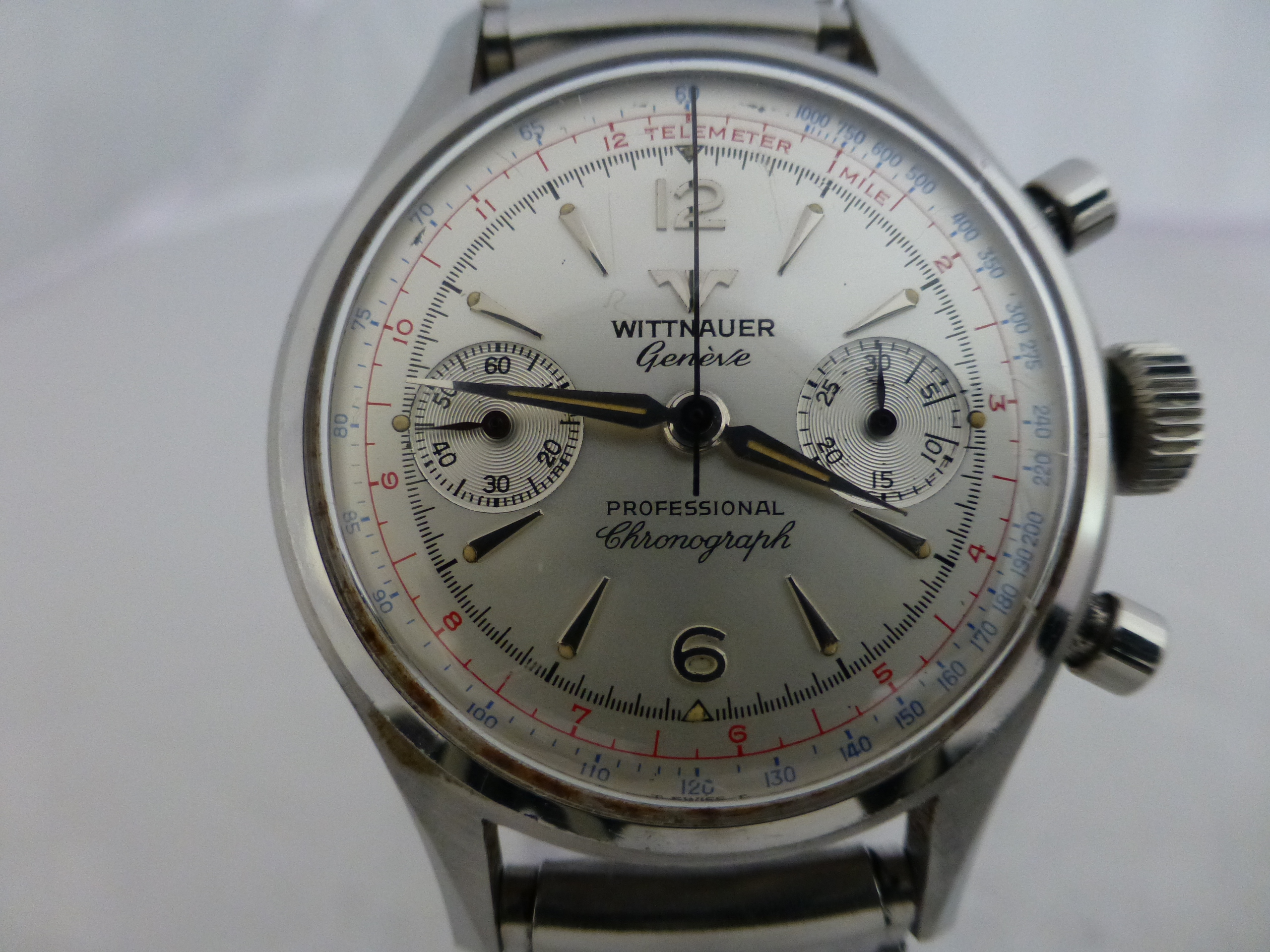

That's gonna look good!
It will, but I need to go to photography school. I can't seem to get a god shot without crystal reflections 馃檨
No, keep a little reflection! It adds depth and gives a little life to the photo IMO.

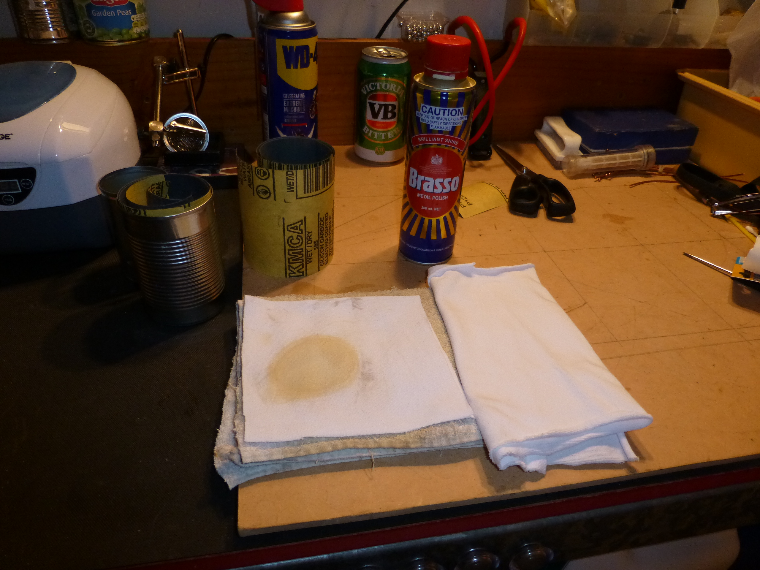

I usually remove the band or strap and leave the watch sealed.
Then.
Extra fine wet and dry (P1200) to reduce any deep scratches, and then on a double layer of old clean cotton (old T shirts) on top of another layer of towelling and the magic ingredient. Brasso liquid.
Pour about half a teaspoon of brasso onto the pad and start polishing, change direction from up down/left right to circular and check every 30 seconds or so.
I do it on my garage bench and then use a clean microfibre cloth to clean off the dry Brasso and dust before I take it back into my watch room.
