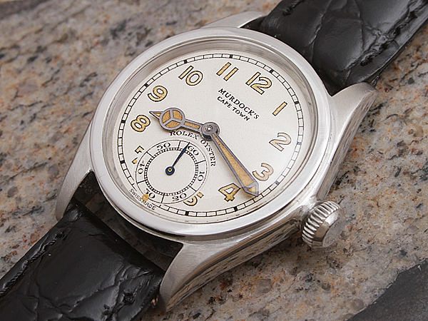

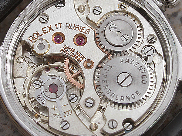

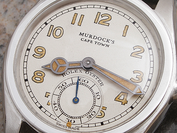

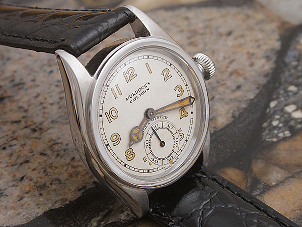

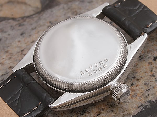

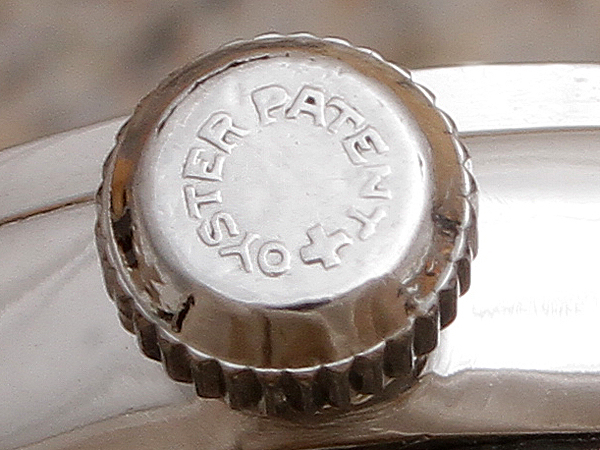

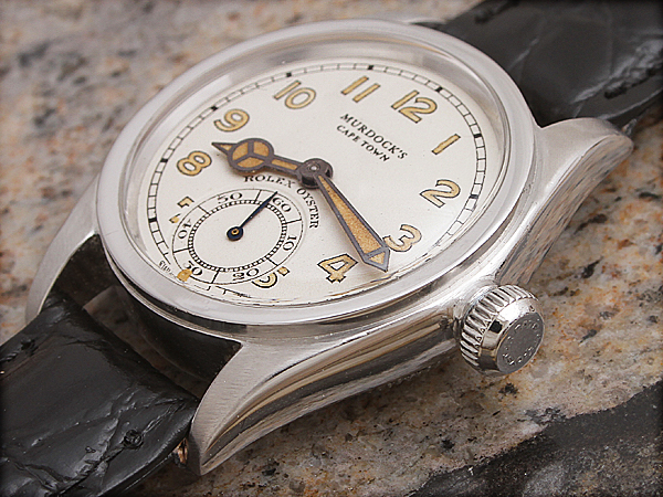

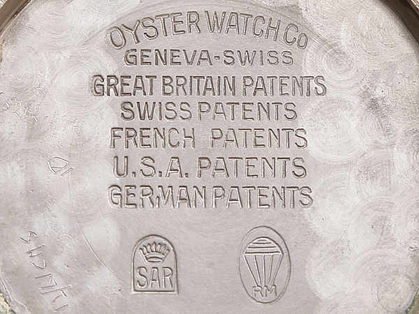

Posts 356 Likes 1,325 obstando ·Sep 2, 2018 Some images from what I believe to be an original 1938 Oyster - any additional information and/or thoughts and comments would be appreciated
Posts 8,742 Likes 69,435 Darlinboy ·Sep 2, 2018·Pratts! Will I B******S!!! Feels like a redial to me, with the Rolex in the subordinate position, perhaps done by the retailer. @adam78 or others know much more than I.
Posts 3,849 Likes 27,363 adam78 ·Sep 2, 2018·Adam @ ΩF I agree. The dial looks suspiciously like the work of Marcus Hardy of vintage-watches-collection.com (in)fame. Even Omegas start to look the same on his site:
