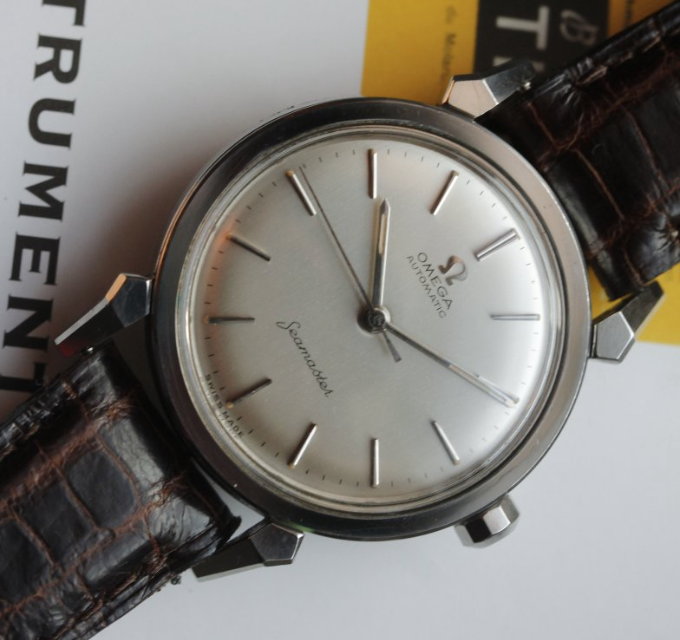

1 watch for inspiration

Absolutely gorgeous. I love the lug design and the clean overall look. What year is that from?
