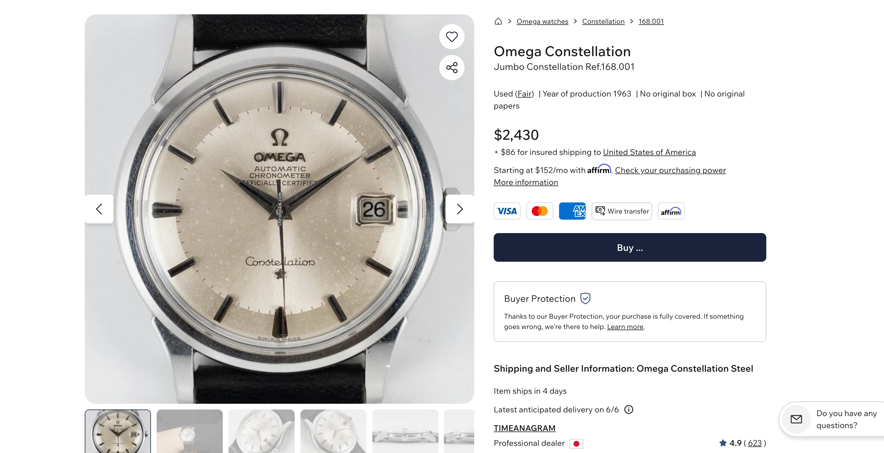

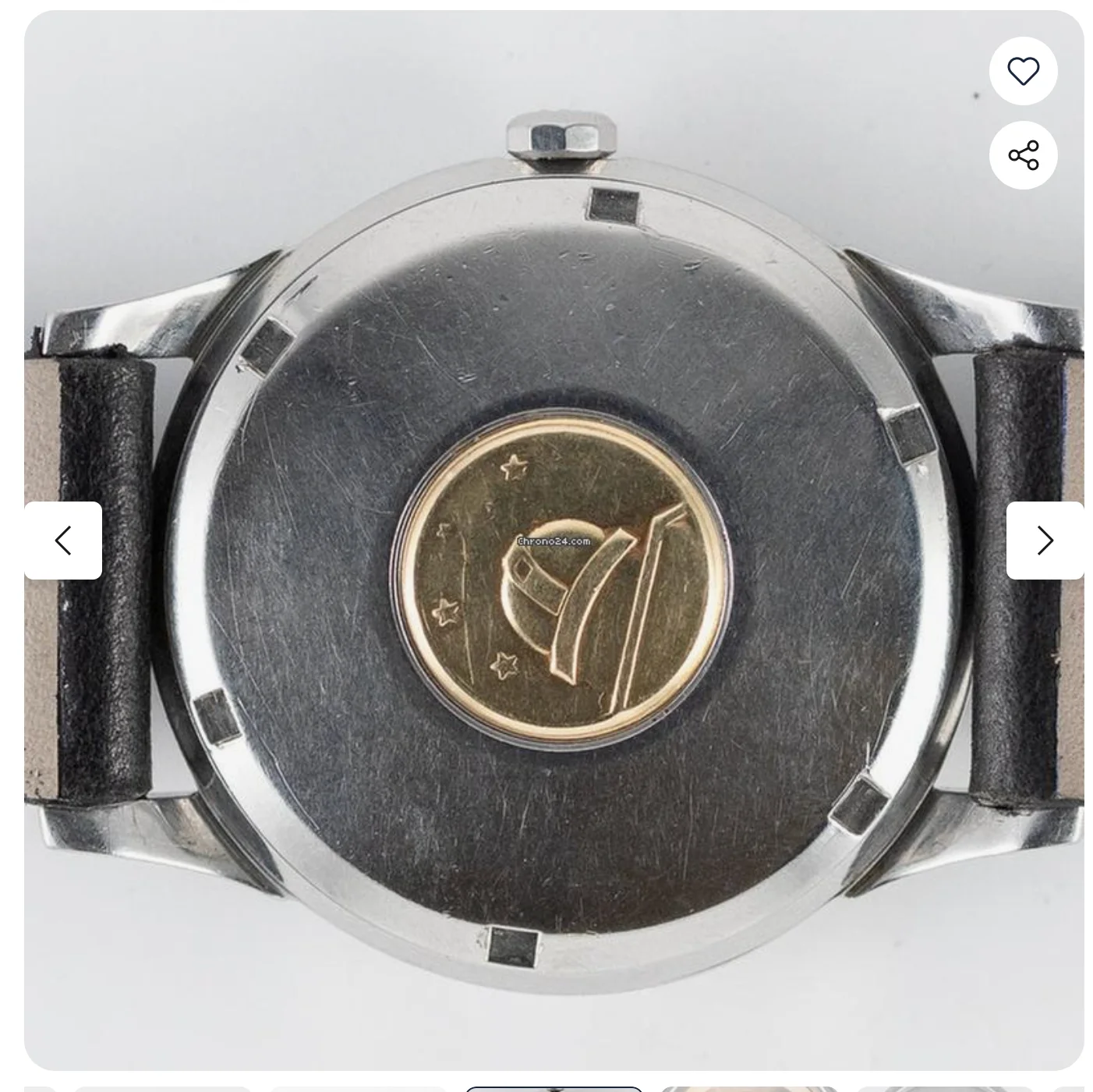

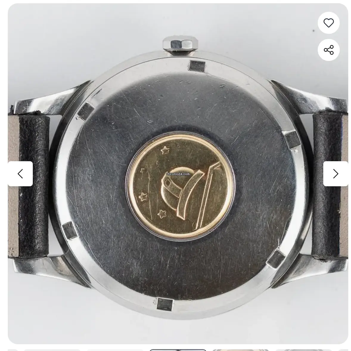

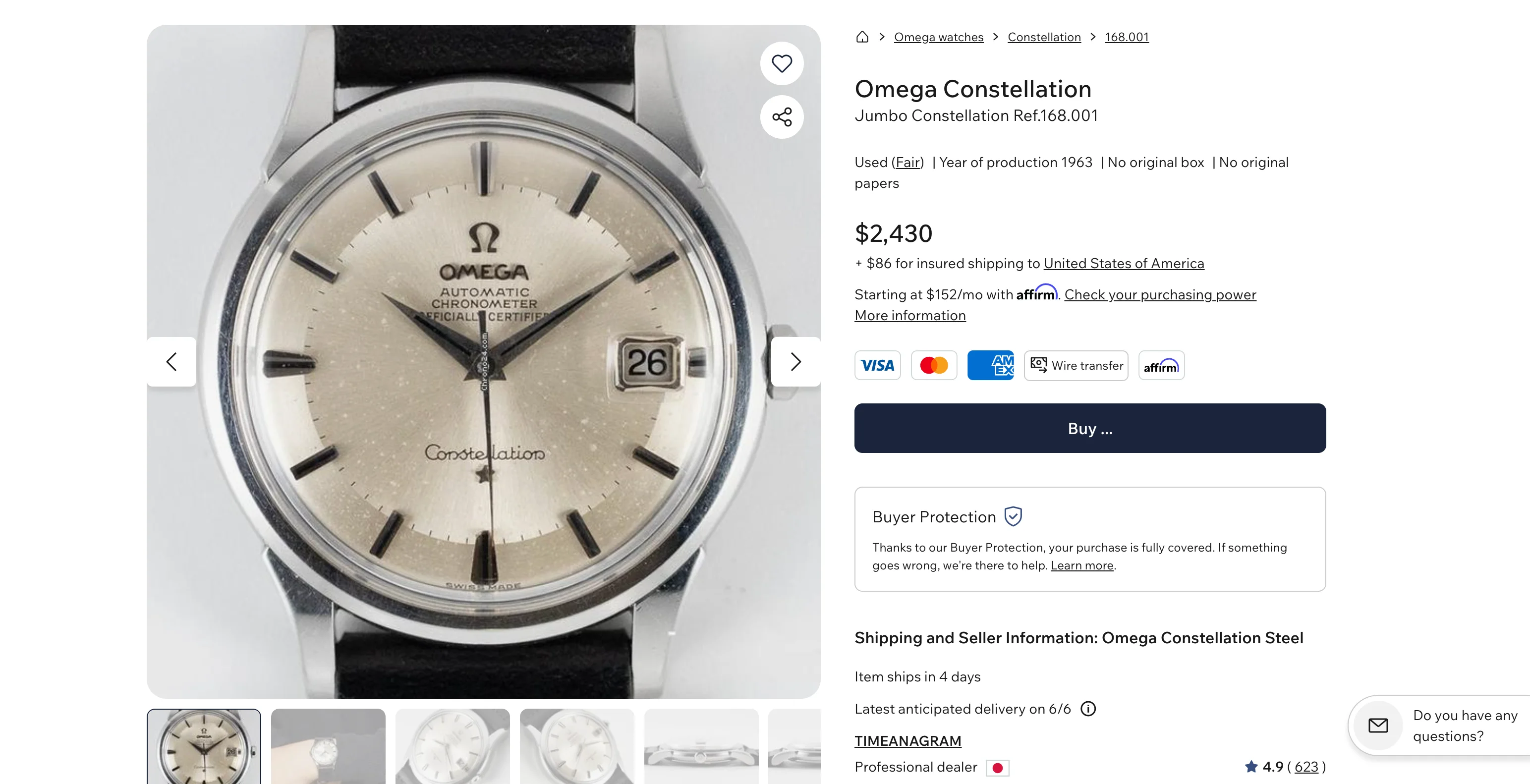

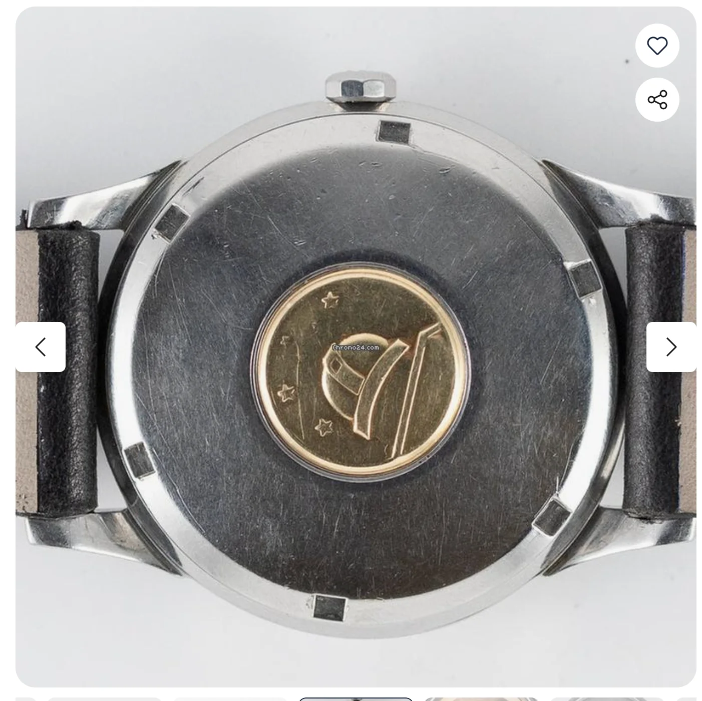

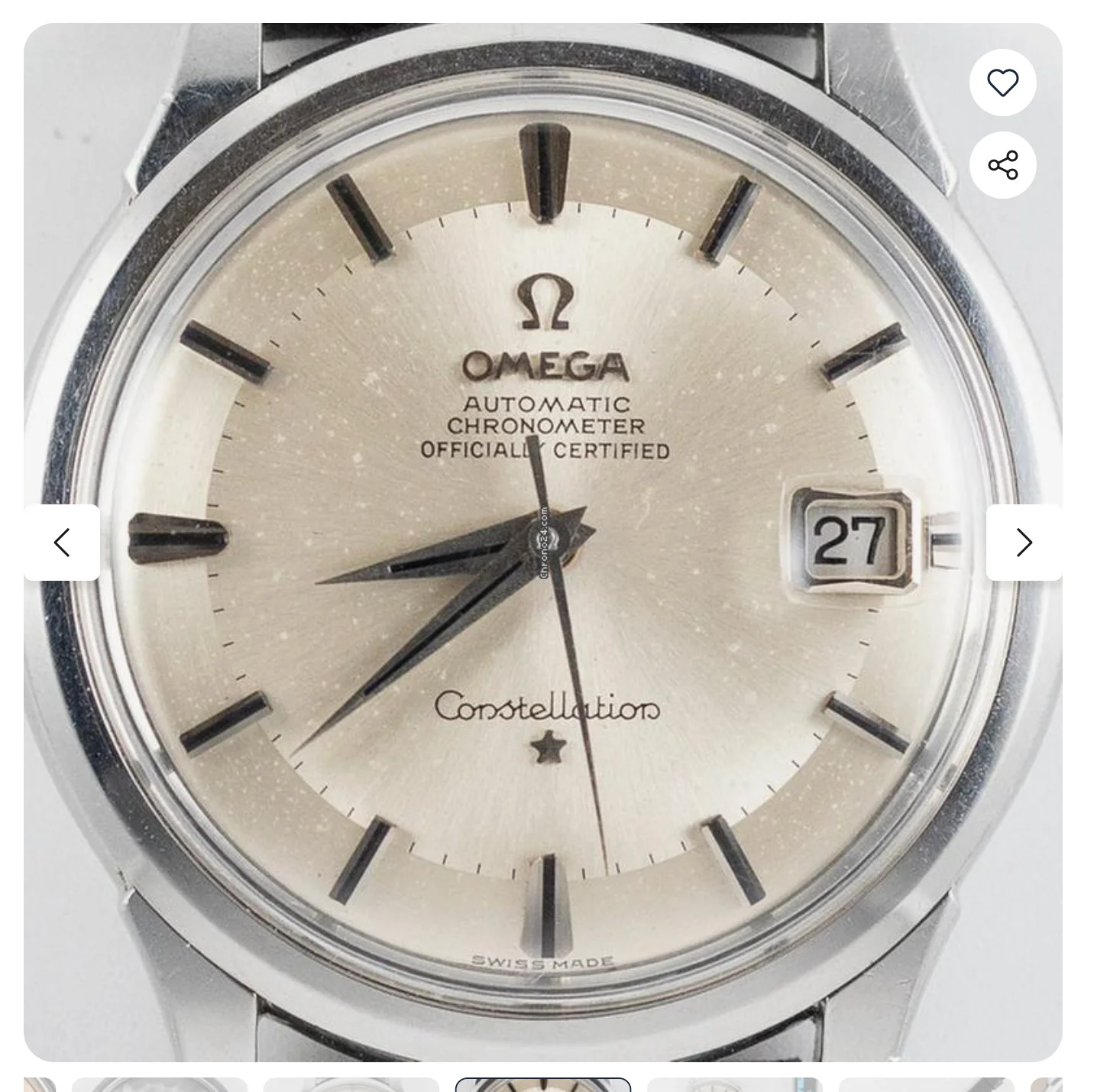

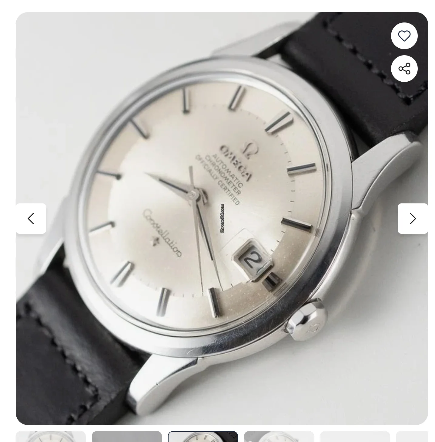

I was trying to avoid buying from outside the US, as I know the import fees can add quite a bit to the price- but I am looking at this option. Any thoughts? https://www.chrono24.com/omega/cons...an-meister-oversized-vws-2903--id39499857.htm
I'm including some screenshots because I couldn't figure out a way to download their pics

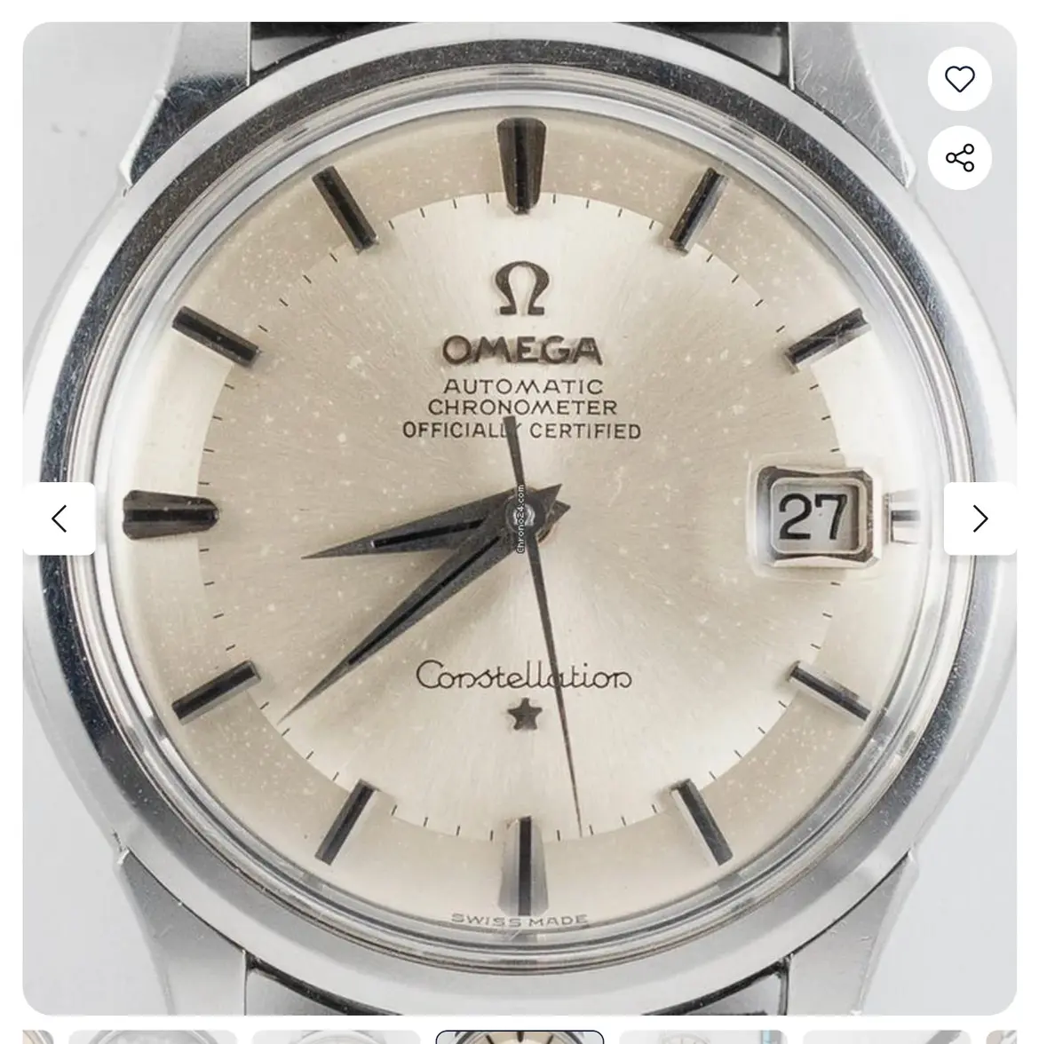

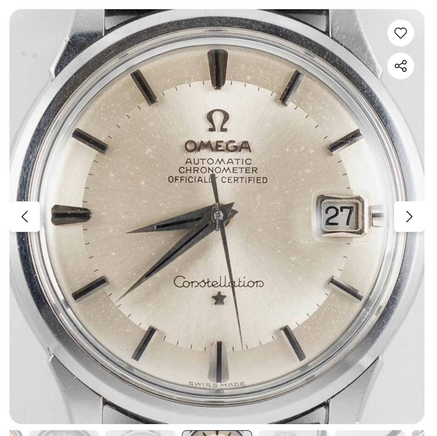

It's good that you are considering different case styles, like this 168.004.
However, the case has been polished and it is a bit rounded and if you look closely at the dial, it has a lot of patination (damage) that wouldn't be very attractive in the flesh.
Plus once again, for a watch in that condition, it is probably double the price it should be.

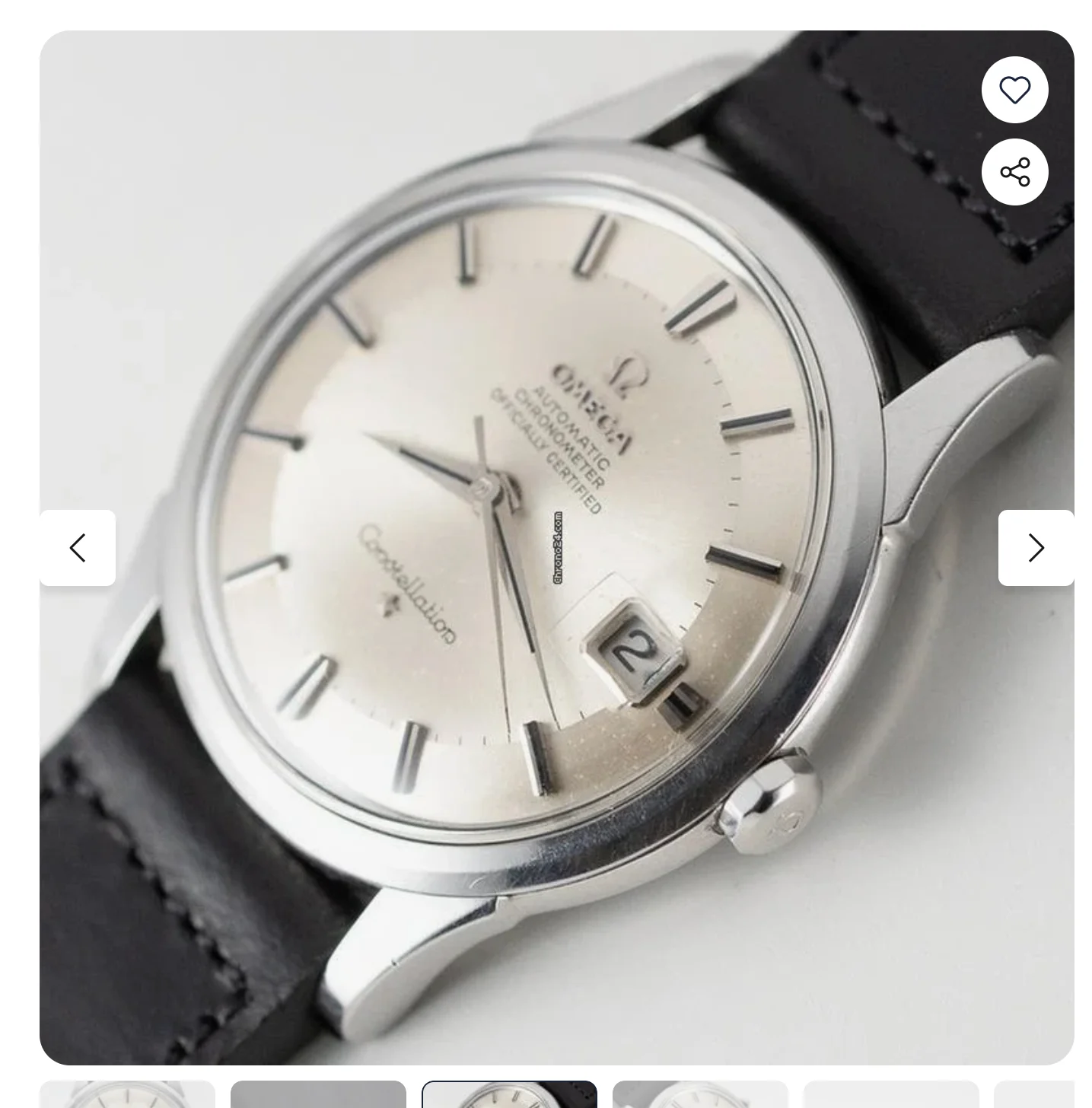

'jumbo' is the designation for certain constellations - produced for the Far Eastern market - and they are slightly larger than regular Constellations at around 37mm against the regular 34.5mm
(this term is sometimes used by unscrupulous dealers to describe the round-cased constellations, like the one you showed previously, as they are a tiny bit [0.5mm] large than a regular constellation)
the jumbo you show above has a very spotty dial, the case is not too bad but it is soft and the stars on the medallion almost worn away.
also it is not a pie-pan if you are set on one of those - it is a dome dial with a different coloured outer ring (to sort of resemble a pie pan)

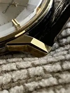

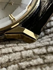

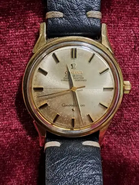

I have a 1963 167005 cal 551. Just want to ask, is the lugs chamfered at that time. This watch's lugs is not chamfer? is it due to polish or otherwise?
6,824
10,496
Yes, dogleg lugs have always been chamfered.
There are two possibilities.
The case has been heavily polished.
The watch has an incorrect caseback.
If you post a picture we can give an opinion on the condition of the watch.

6,824
10,496
As @Dan S says, the chamfers on the lugs have been polished away making it look less like a classic dogleg - but at least we know that it started as one, so the caseback is correct.
The watch has a very unusual replacement crown.
31
21
Yes, the crown is a Speed Master crown, stem and tube. I just send the watch to a trusted repair shop to replace them, also the crystal is not original, needs to be replace. Yes, the 4 lugs show signs of heavy polished till the 4coners of the lug's gold is chipped that makes me doubt about the case. Now I feel at ease about the case, at least is original. All these replace and overhaul will cost me $450. But about the chipped tips of the lugs, will cost me much more. Do you or anyone have any idea how to to repair the lugs tips and what is the cost, or just leave it like that. Thank u all for the comments
