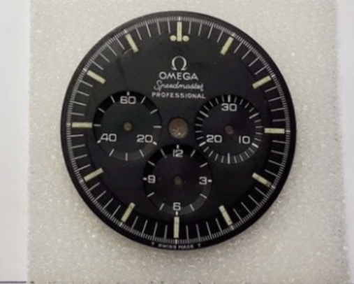

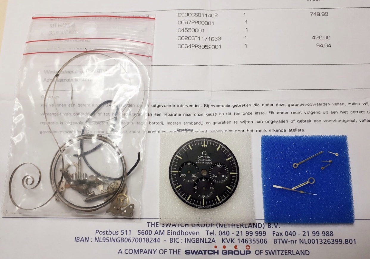

What I need your experienced advice on: the watch got a service from Omega SA - and it was significant enough to remove the step dial. The dial looks quite good overall - with an issue by 11 o’clock. I’m not as concerned with the hands.
I spoke with the seller and he wasn’t overly helpful with why Omega removed it - and stated what I already read/heard - that Omega looks at this as a repair versus a restoration - and will remove anything unless you argue to keep it (which he did not). I don’t know if the tritium is flaking or chipping for example. It doesn’t look like it.
I have investigated restoration - and I see it is expensive. That said - since the stepped dial is super expensive - would it not equal out for overall value to my watch? I wear this watch more for sentimental value than monetary value - but having the original dial does make it more authentic (and again the dial looks good). The watch is on its way - I will have the dial looked at - it if it is found to be in good shape and can be replaced - does it make sense to do so? A brand new dial is in place now.
Thank-you for your help everyone!

Omega will remove any component like the dial or hands if for some reason they feel it may possibly cause a problem that would result in the watch comin back under warranty. No amount of arguing with them will change that. So you need to inspect the dial when it comes in, or have a watchmaker do that for you, to determine why it was removed, and what can be done to prevent whatever issue they removed it for.
Omega will often remove these parts for very minor things, or things that can be repaired, so it certainly may be possible to put this watch back the way it was. I would also look at the hands.
Note that if you do have someone open the watch, it would void the warranty from Omega service.

I think you should double-check that the old dial is actually a step-dial. It's not easy to see in that photo.

Thanks Dan. You are right, the picture is blown up. That said, I can see at the 5&6 o'clock position, the cut between the hour marker (as well as on the right side of the watch). The 145.022-71ST are all step dial to my knowledge. My serial number dates to 1972. I recognize that the dial could possibly be from another watch - so it isn't impossible I am seeing things - but I am very confident it is a step dial.
That all said - if when I receive the watch and parts I have verified it is a step dial - are there any cons besides the cost and quality of work to replace it with the vintage dial?

Omega won't do anything different other than what you already have in front of you - a new dial and hands. They don't do things like stabilize lume to prevent it flaking - that's something only a good independent watchmaker who is sympathetic to vintage watches will do.

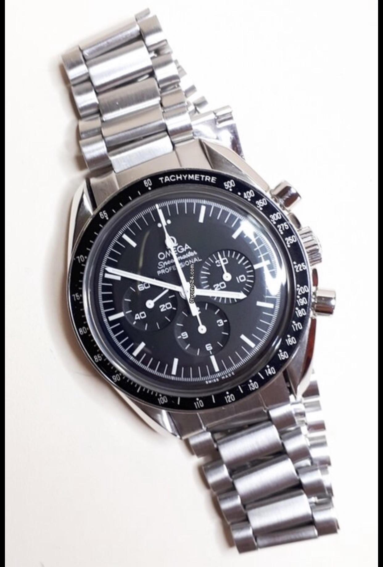

Thanks Dan...the bezel is interesting. I don’t know what the bezel markings are on it now (or where they came from) - but it is accurate for the time period. Dot near 90 and dot beside 70. If it were a 1990+ it would have the e thingy in the tachymetre and the dot under 70 to my understanding (and I know it isn’t a dot over 90 - nor is it supposed to be)...So I don’t know if i will touch that. I am asking the seller what he knows about it. I don’t know that the actual bezel is recoverable. It looks pretty rough.
Thoughts?
