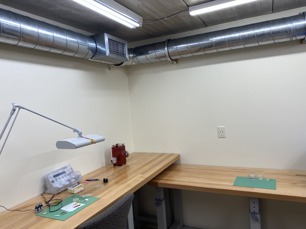

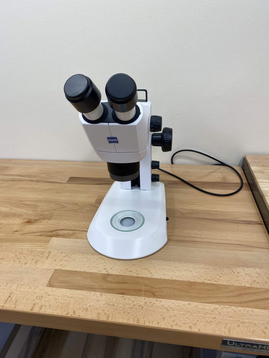

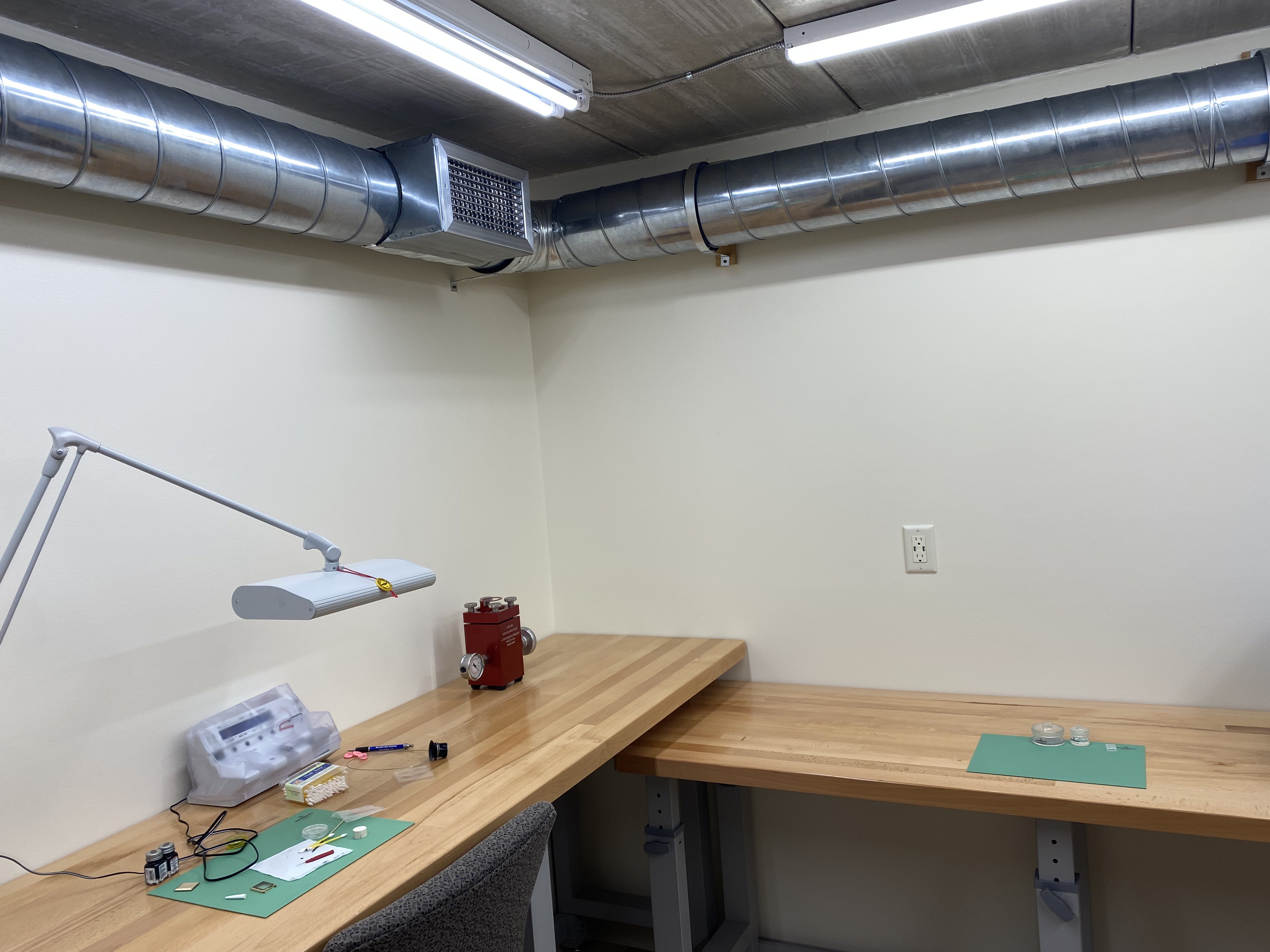

A few minor updates. The grilles are installed for the filtered air inlets:

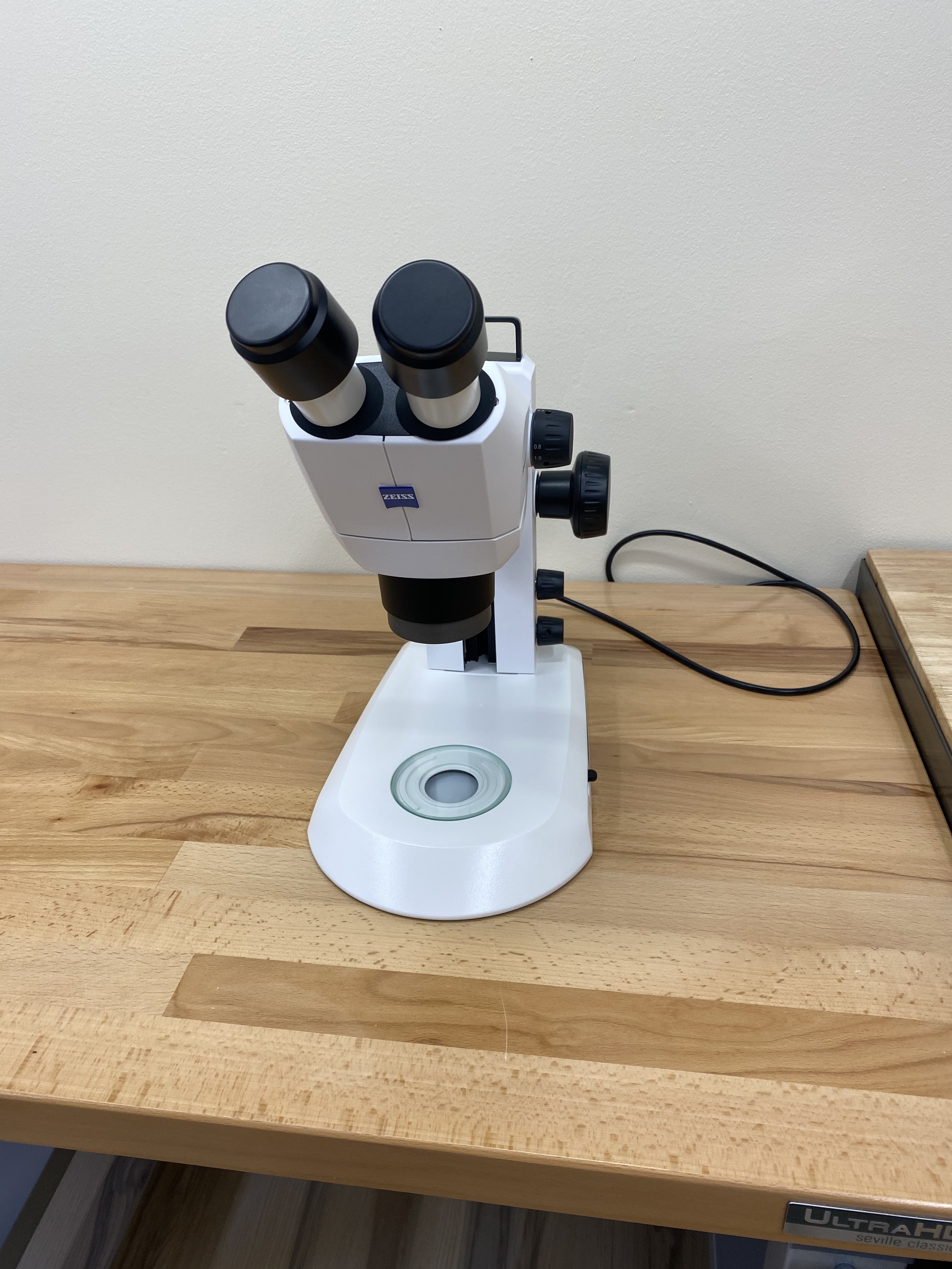

My new microscope arrived:

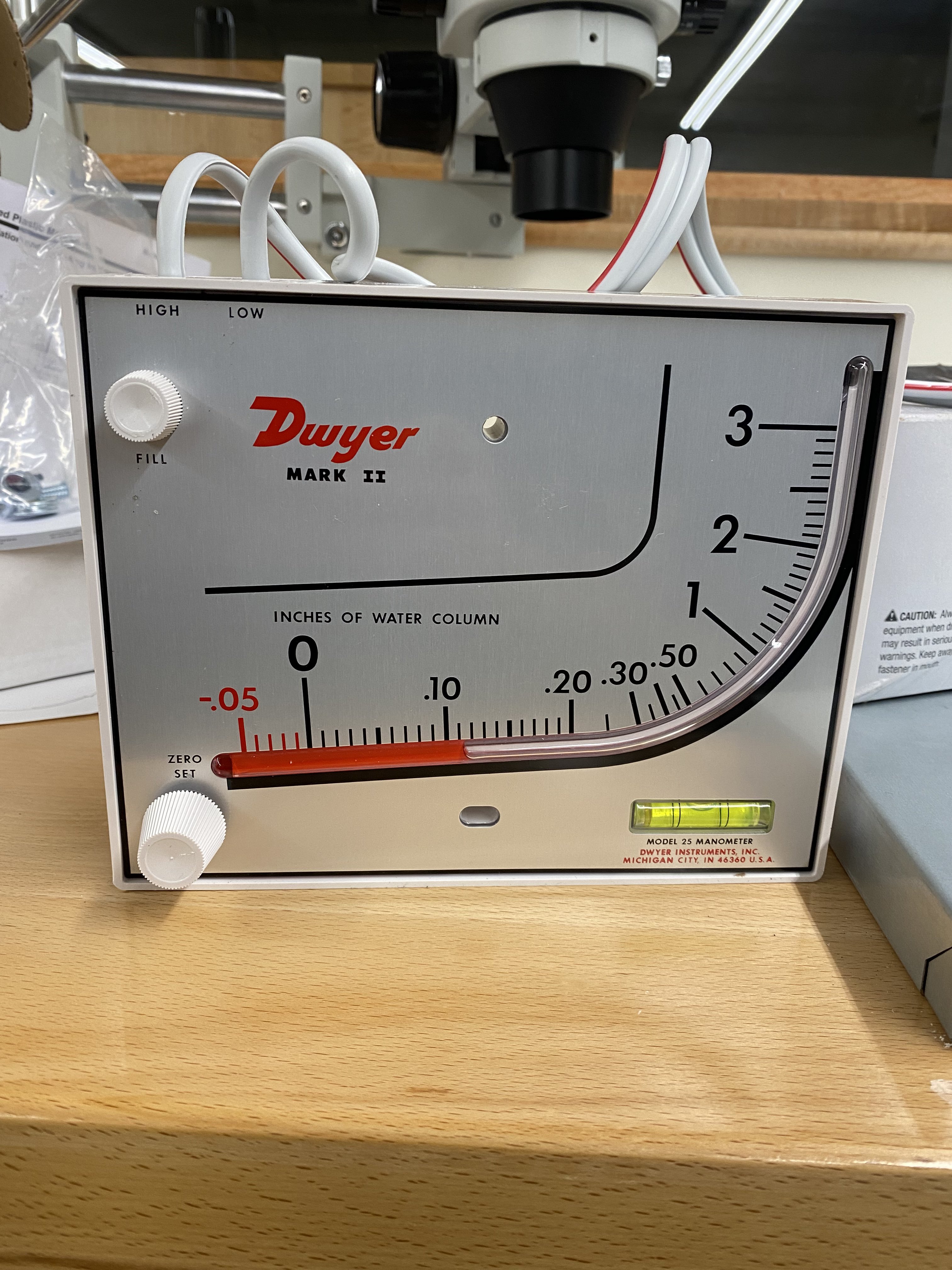

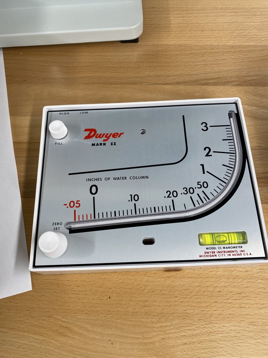

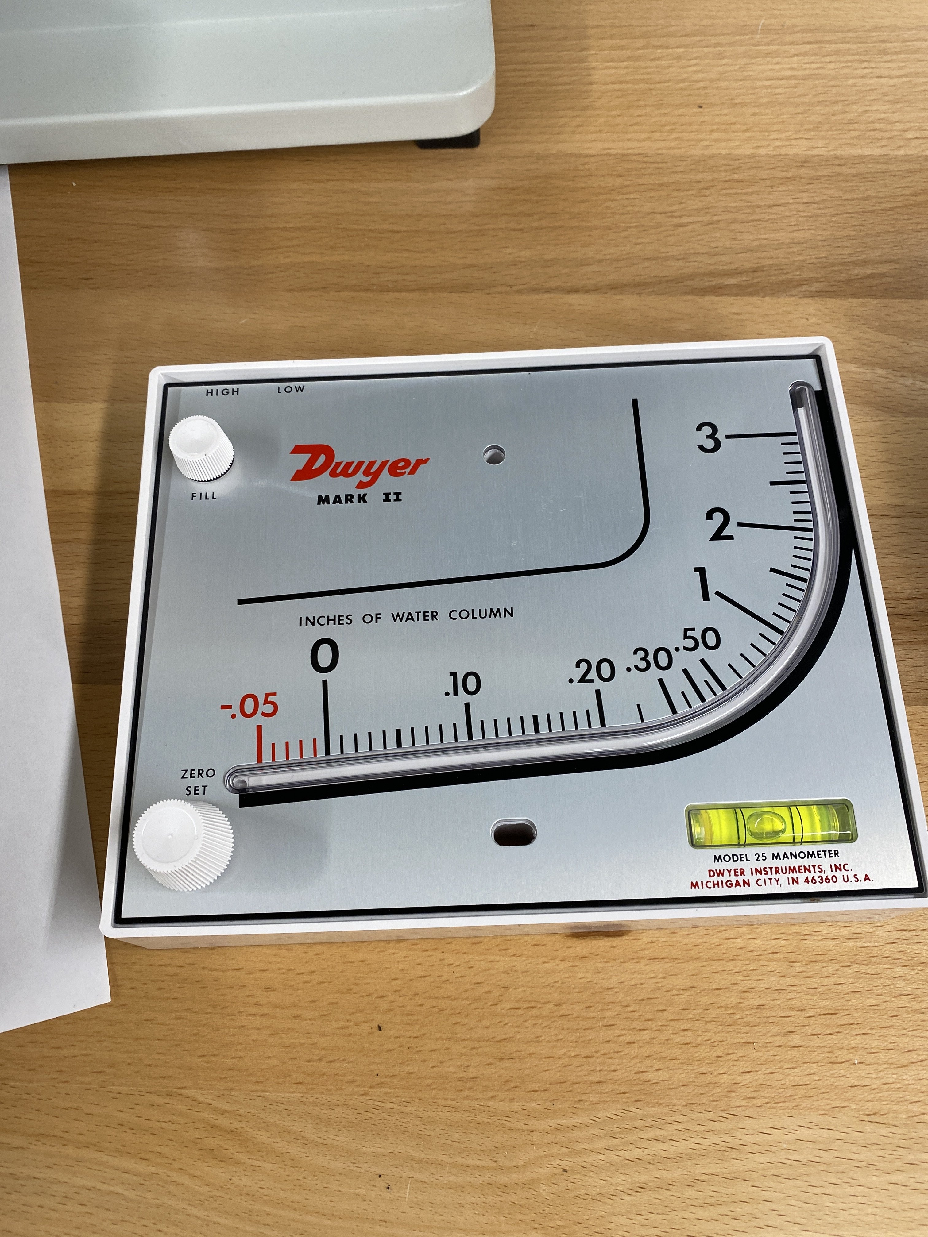

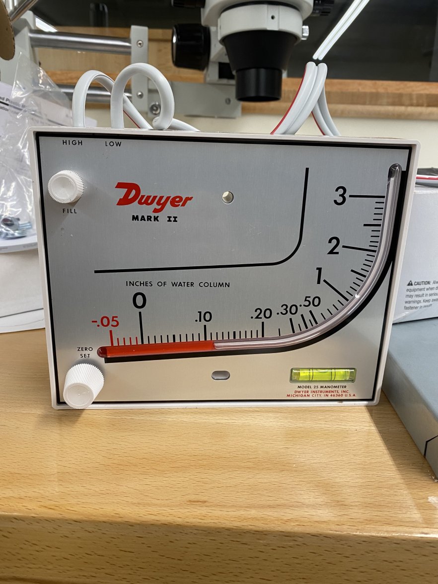

At some point I will get tubing for the manometer run; then I can fine tune the air flow. You want positive pressure in a clean room, but it doesn’t have to be a crazy amount.
With the fan on high the door is self closing:
195
493
The target is .02 to .2 inches of water. I’m right in the middle.

Question of the day.
Is it manometer, or manometer...
195
493
Heavy on the nom, so manometer. Kinda like this, with “eter” on the end.
Not according to my old engineering manager from Czechoslovakia (as it was called when he lived there). He also had great trouble with "Connecticut", and "eavestrough" so for that one he just started saying "gutter!" 😁
His most famous one was "atomotitive apprentences" when trying to say automotive apprentices.
Dwyer makes good stuff - bought a pile of these back in the day, mostly for measuring furnace atmospheres. Thanks for the Muppet clip - brings me back to my childhood!

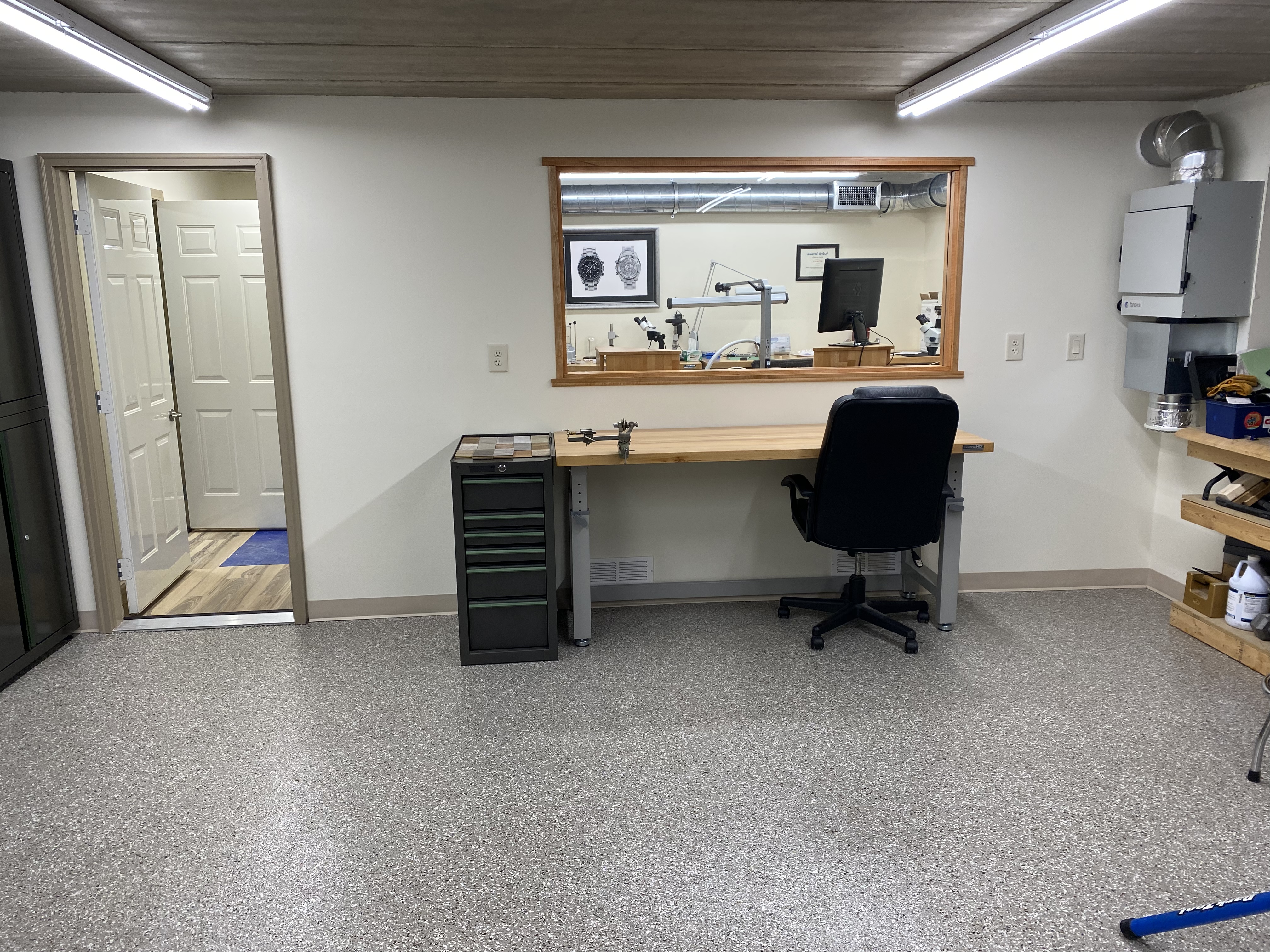

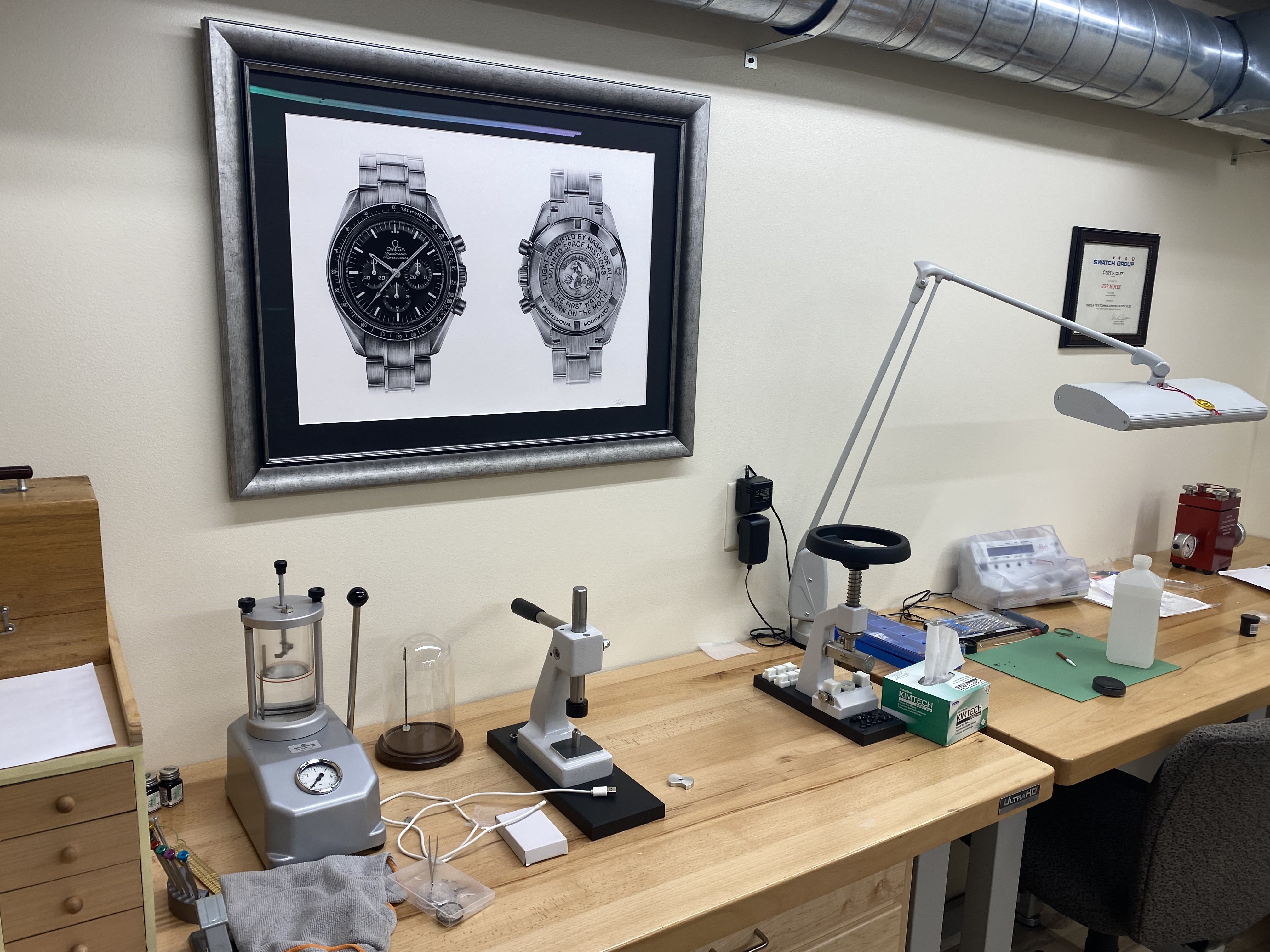

Wow, that is super professional looking, nice work. I like your choice of various wood tones.
195
493
Thank you. I’m quite happy with how it turned out.

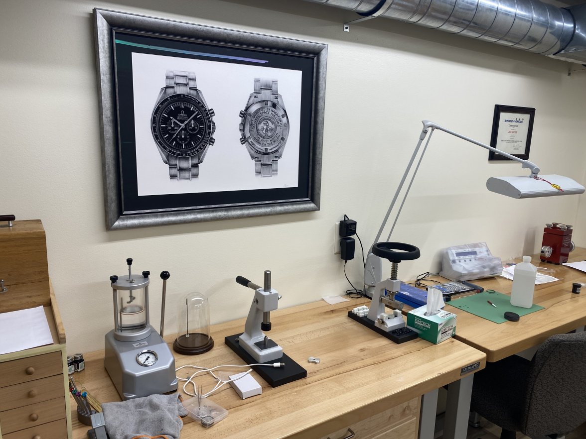

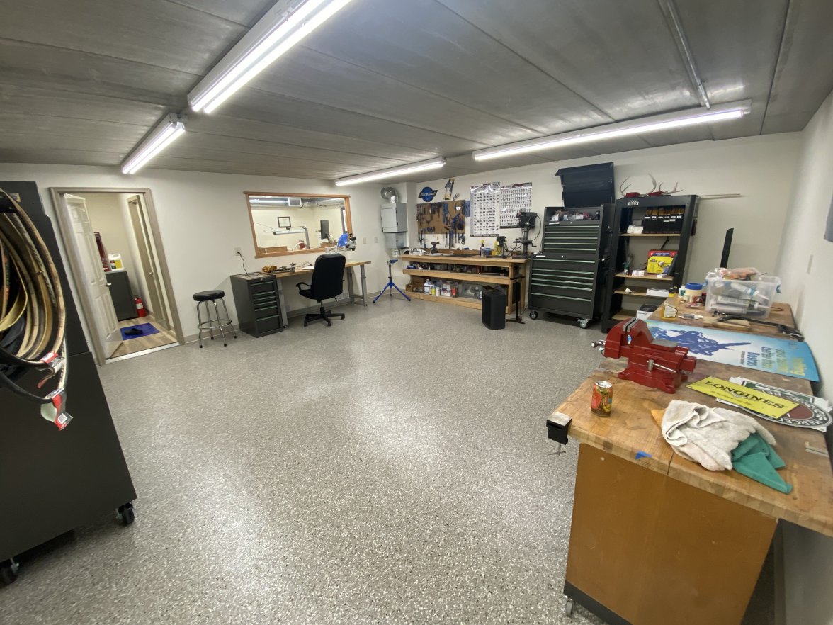

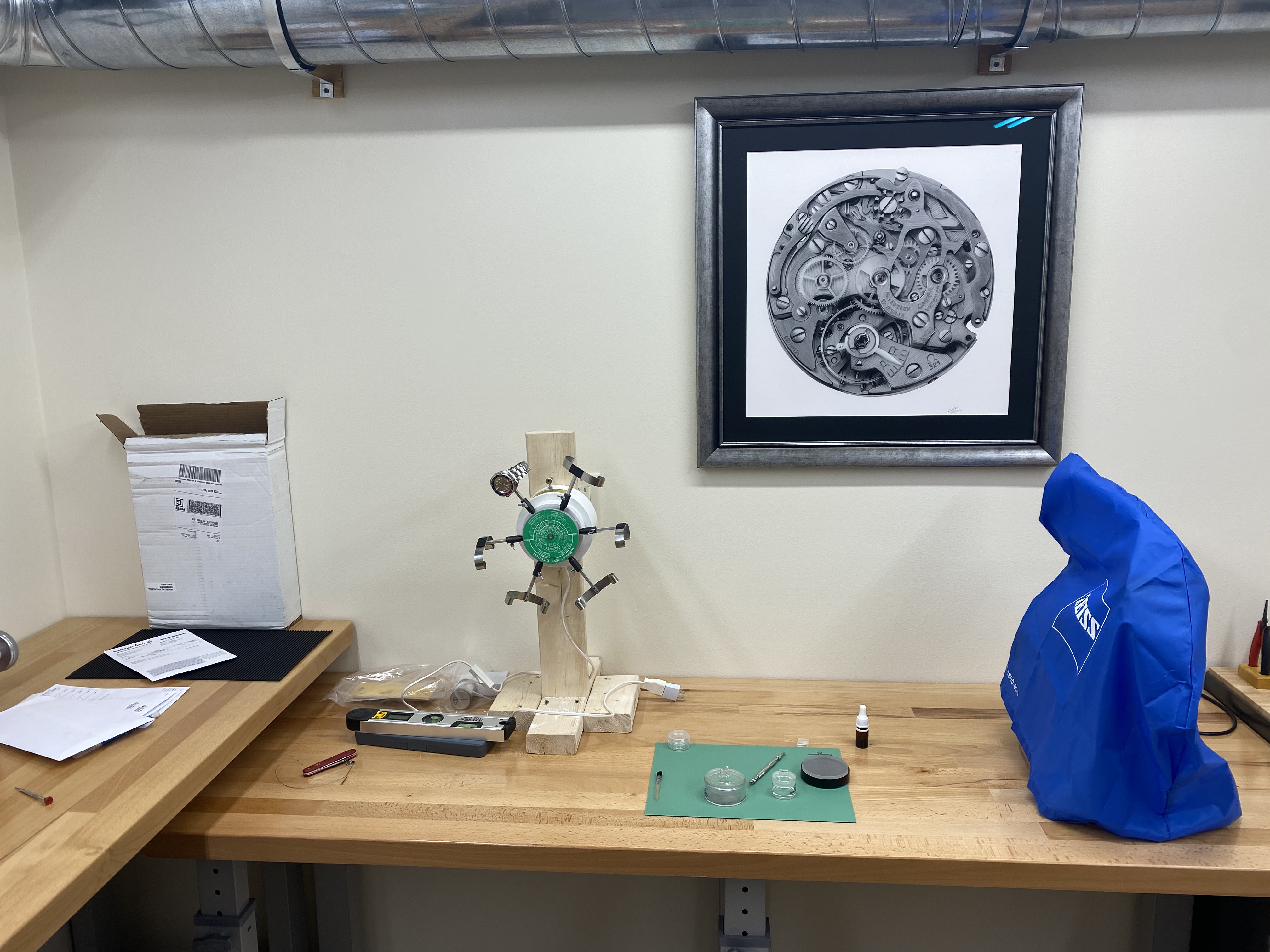

The artwork is framed up in the cleanroom:

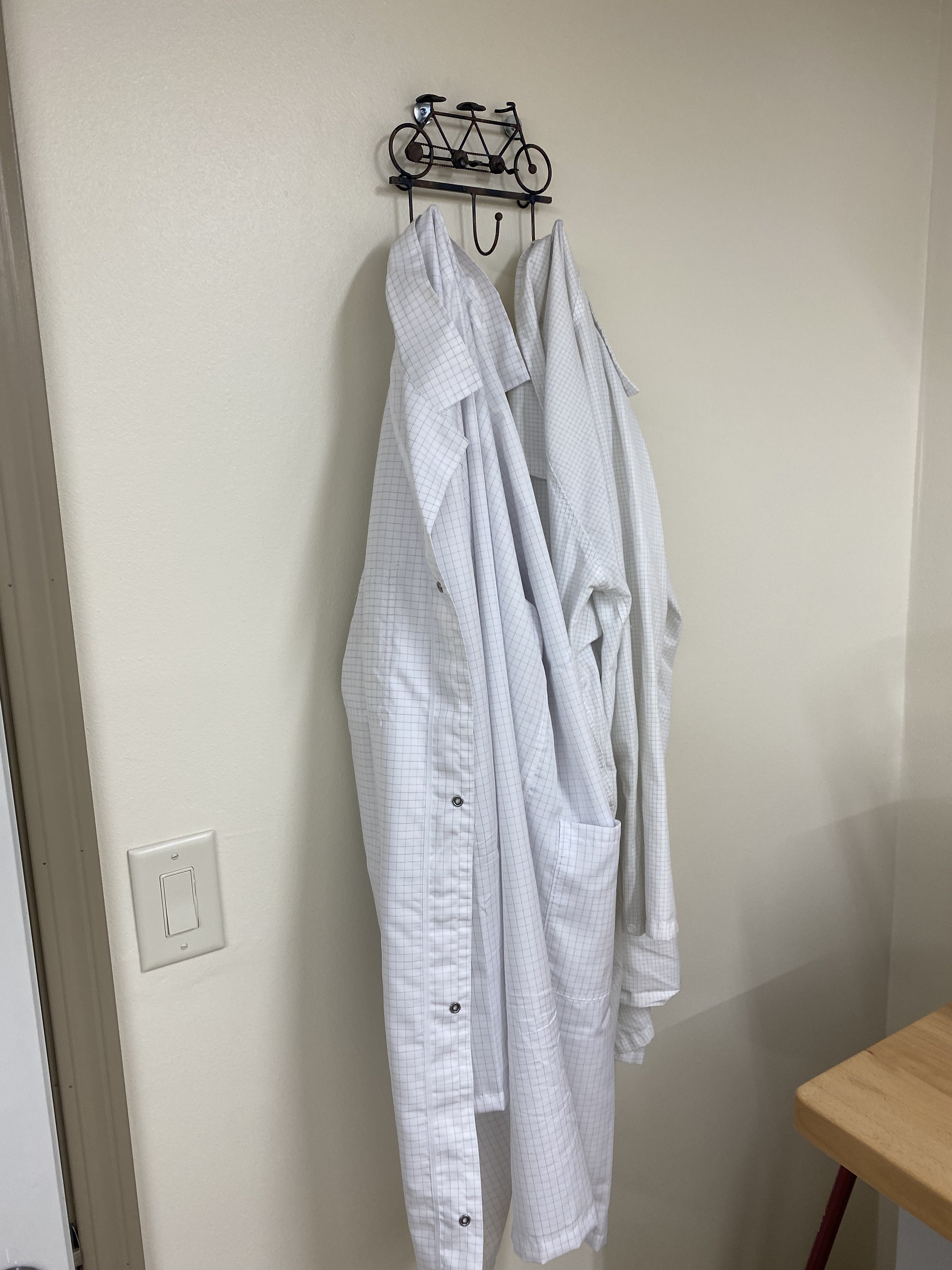

I found a good hanger for my lab coats:

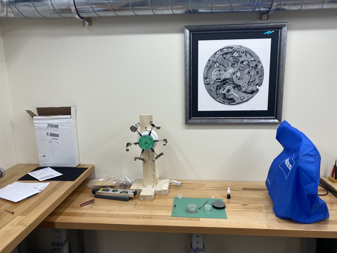

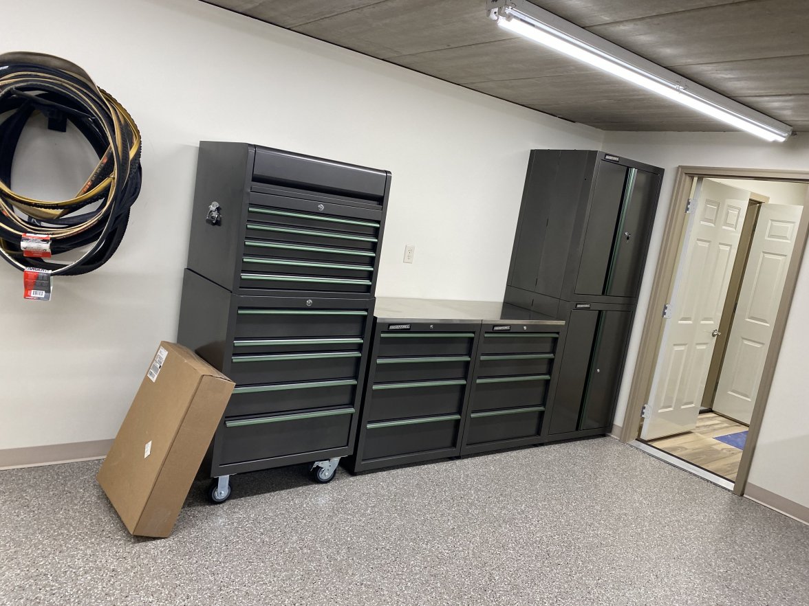

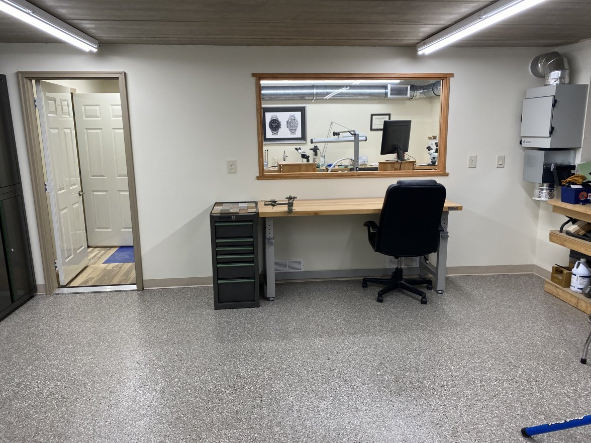

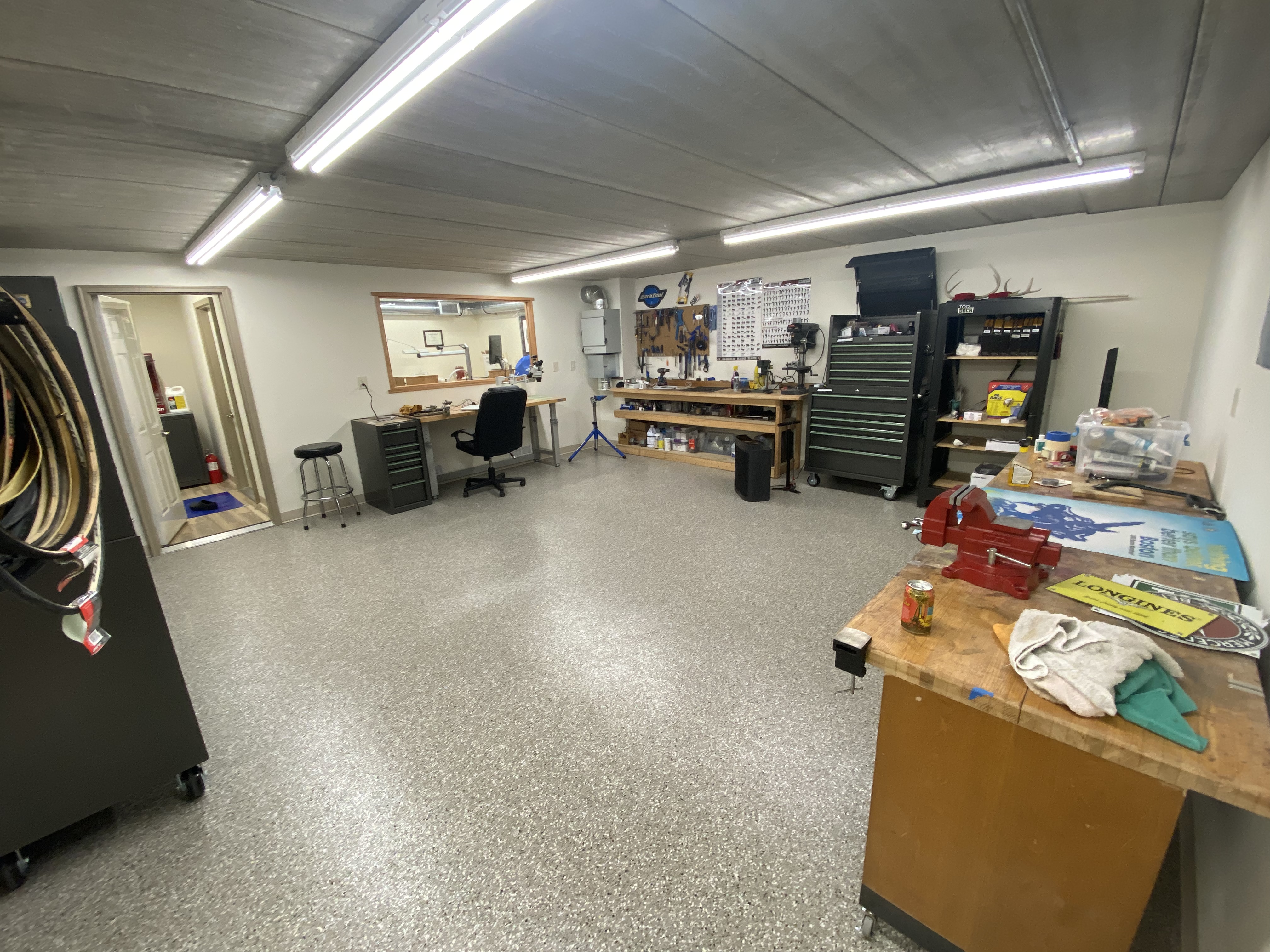

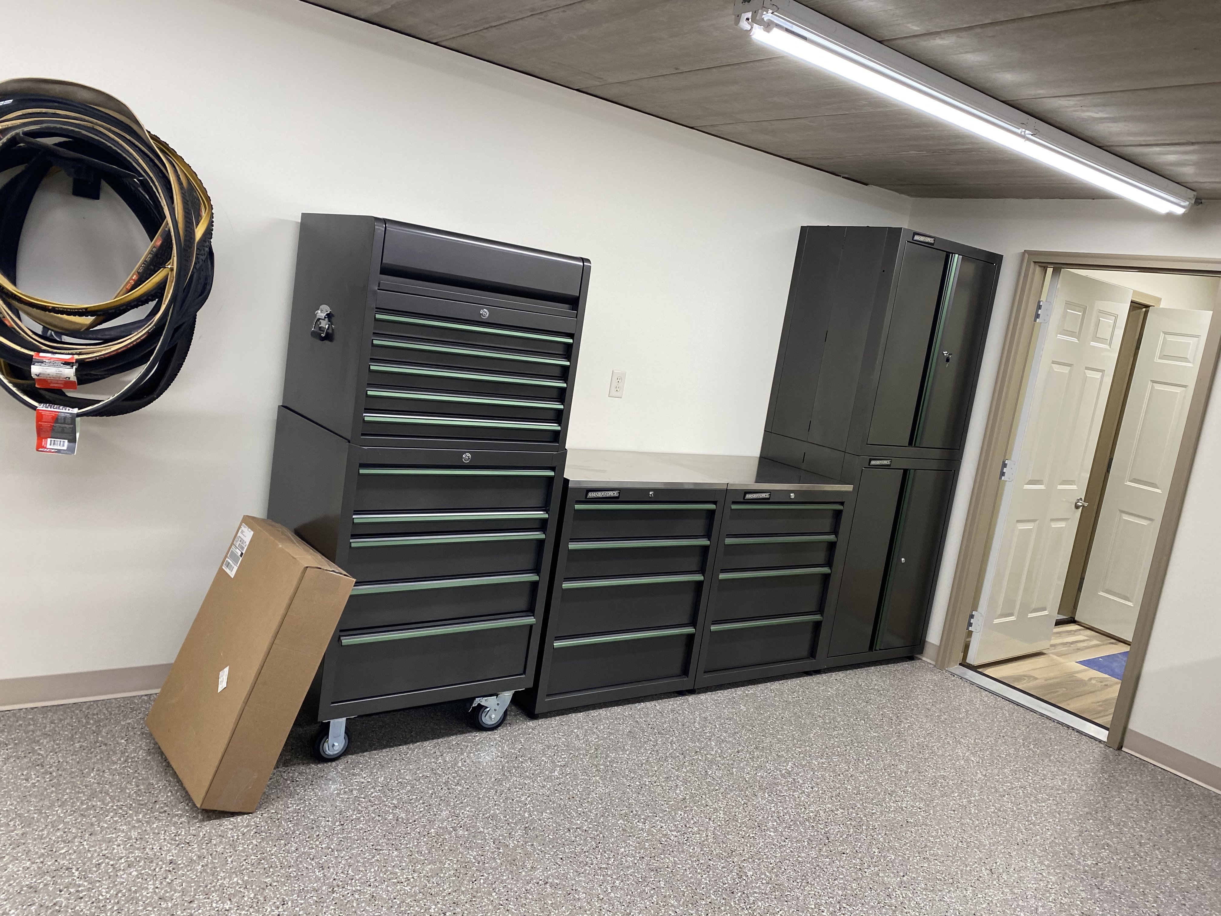

The epoxy floor is done in the main shop:

Insanely jealous of your setup.

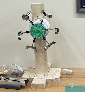

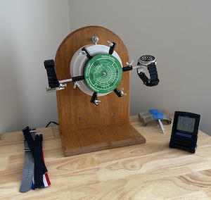

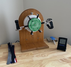

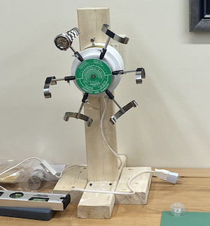

But at least my winder stand is better than yours!
195
493
With the cost of lumber, I had to use that 2x4 scrap for something. That’s probably $20 worth. 😀

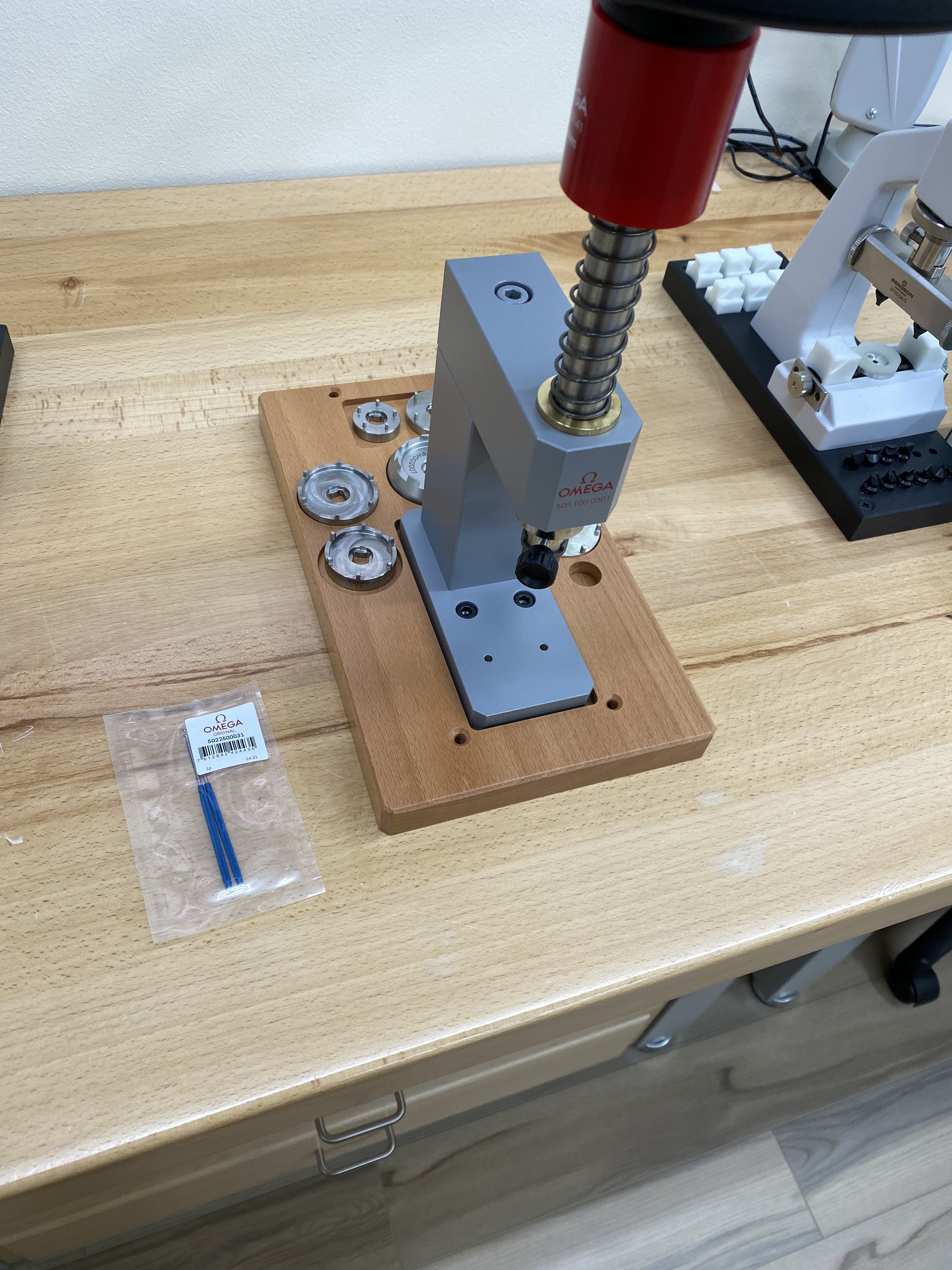

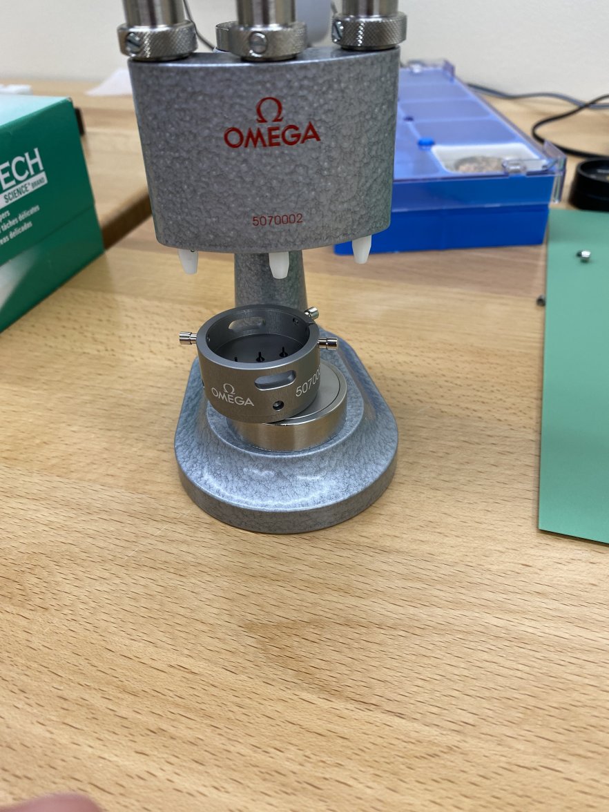

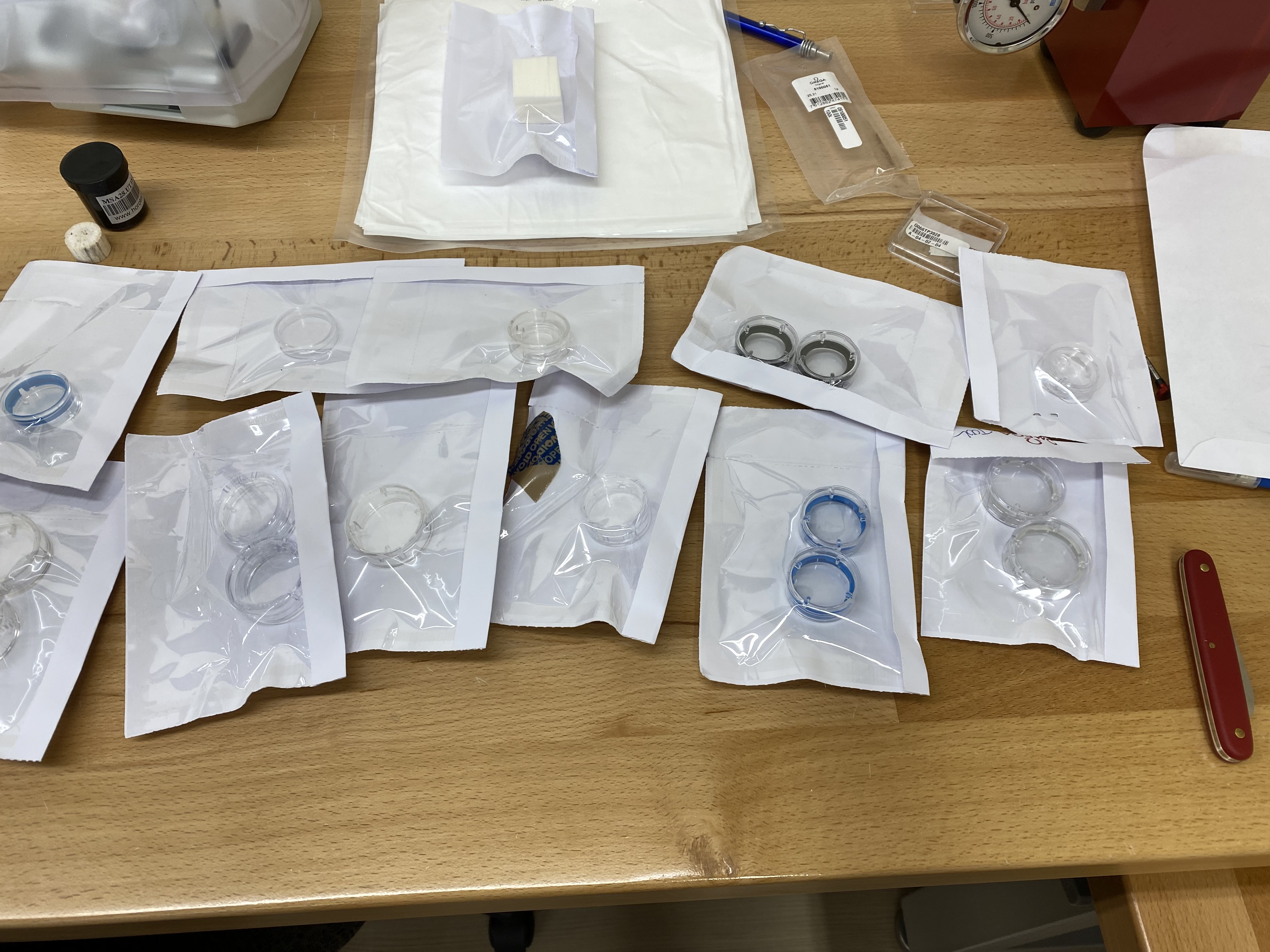

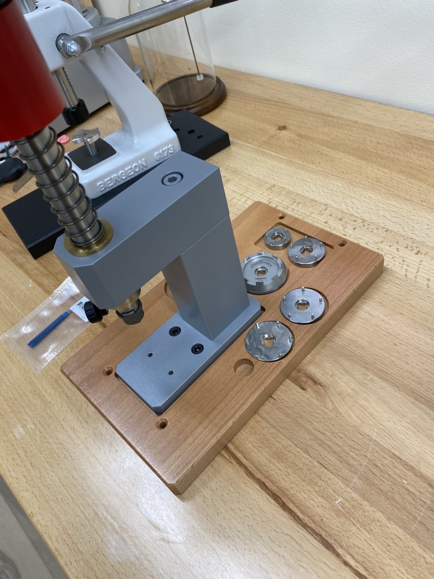

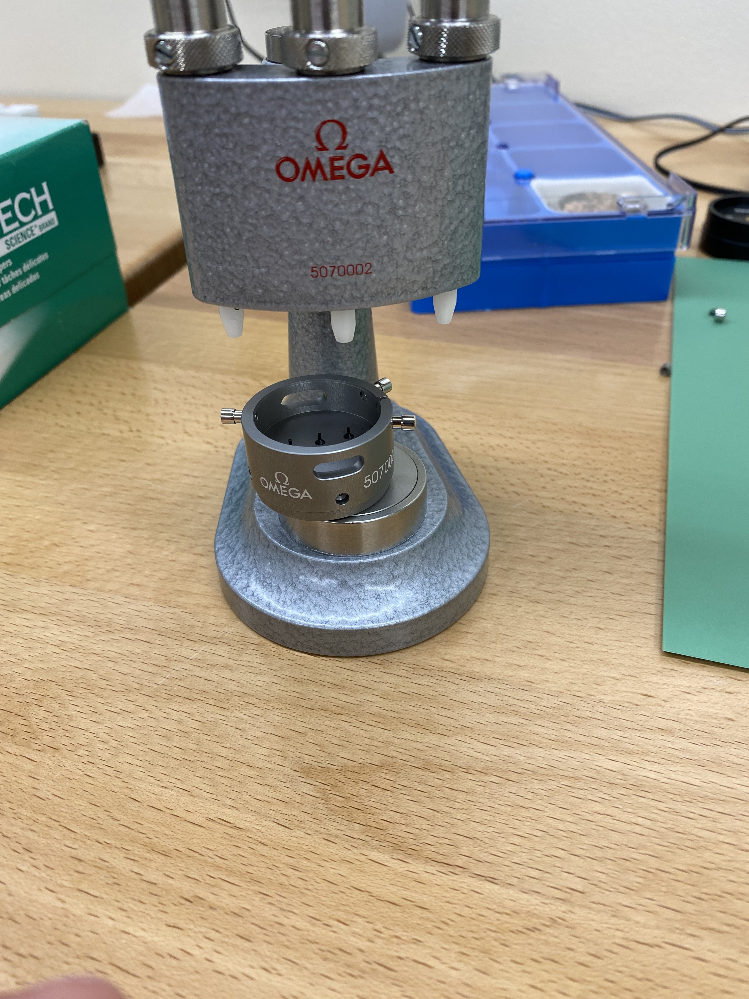

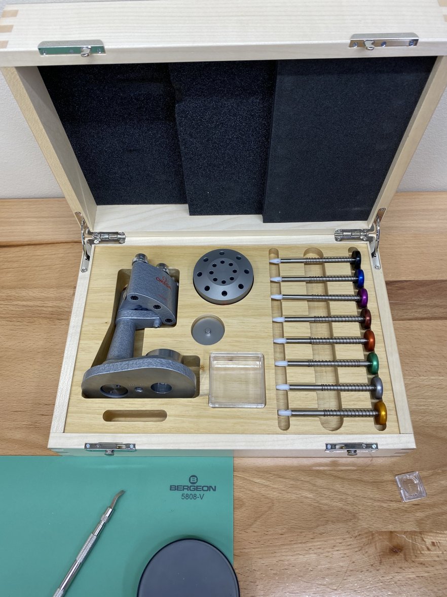

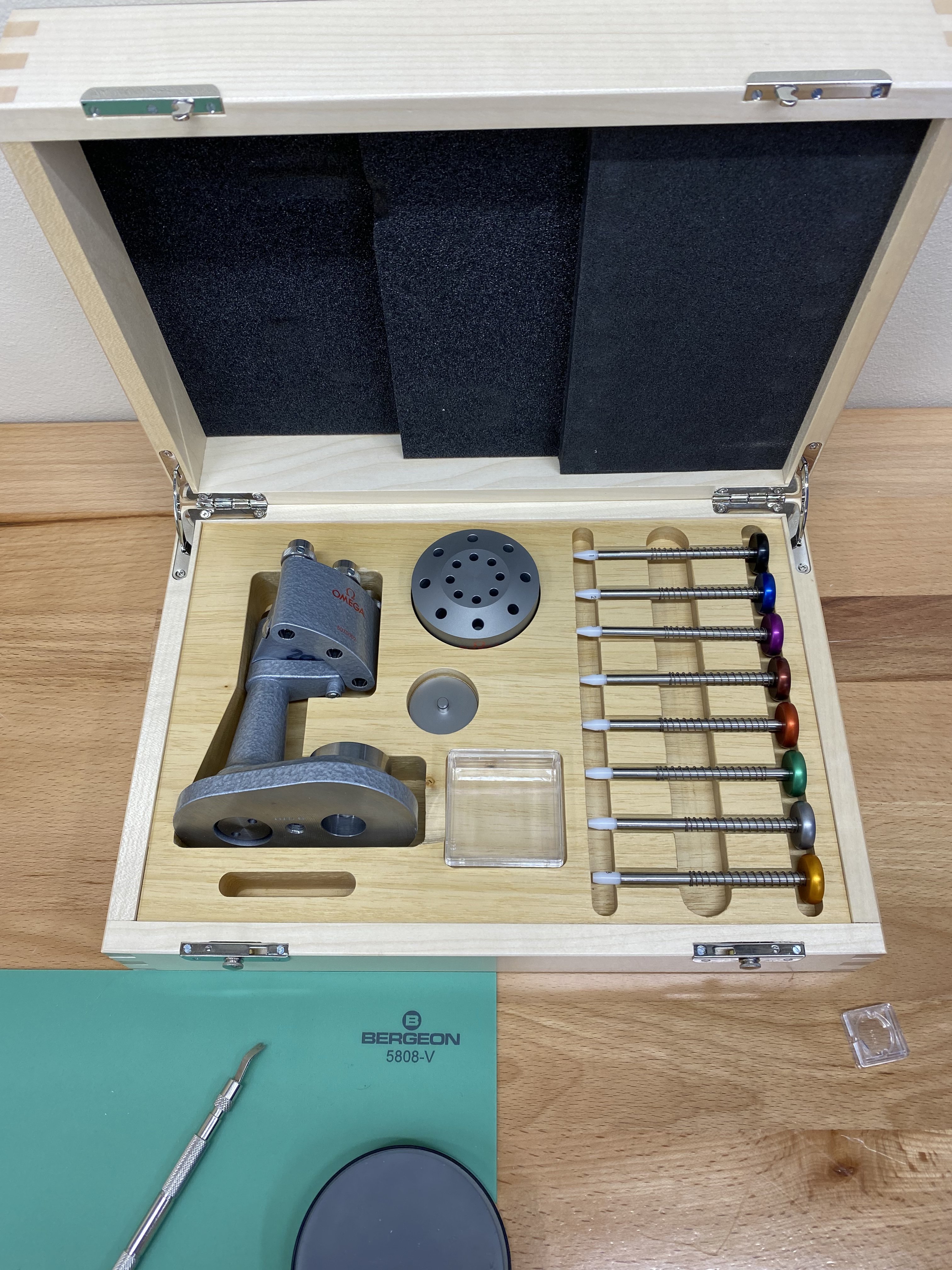

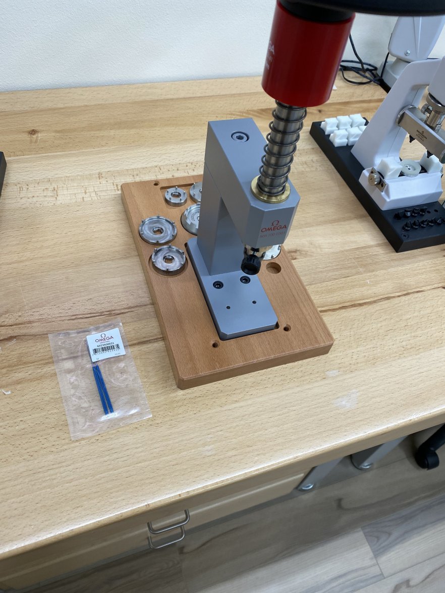

More tools arrived yesterday. I already have a case back opener and hand installation press, but not Omega ones. The case back tool will torque the back to a specified level.
I’m still waiting on the case holder that installs into the lower part of the tool. Most of the case back took was made by VOH, which makes some of the finest tools available.
I used the hand installation tool while at Omega training. It was nice having the charts which tell you exactly which runner to use:

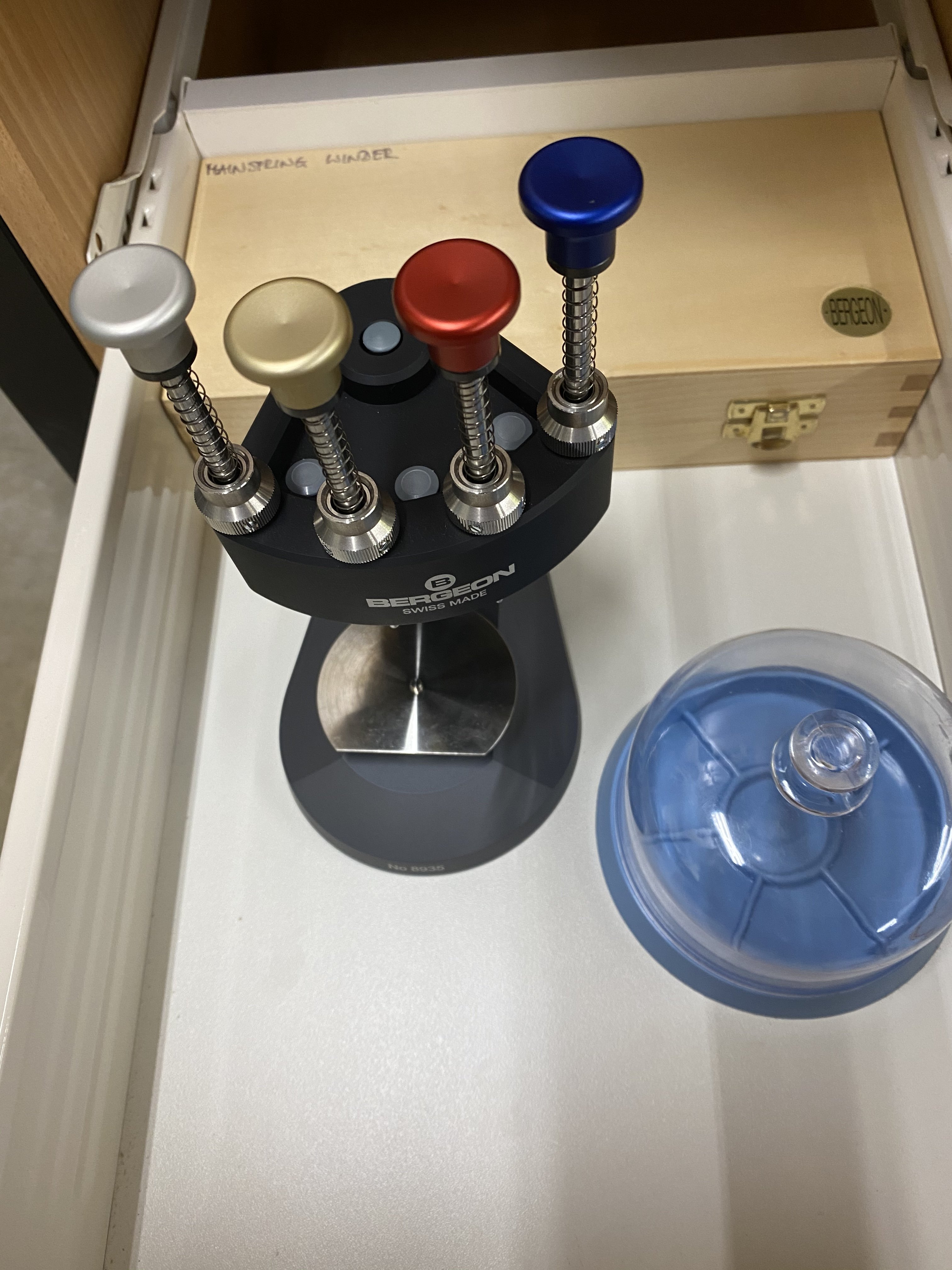

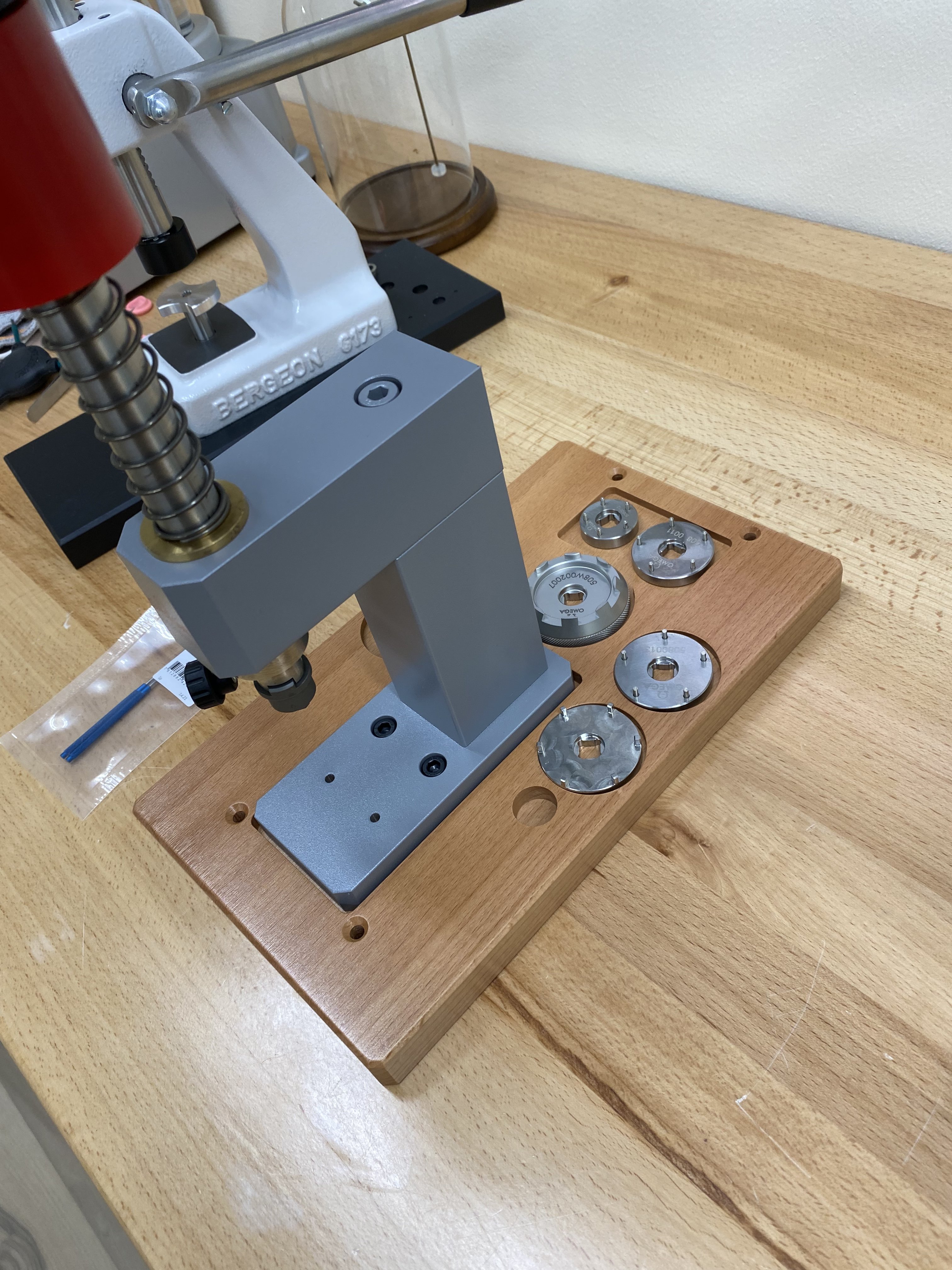

The Bergeon version hand installation tool is very nice as well. It is always nice to have options.

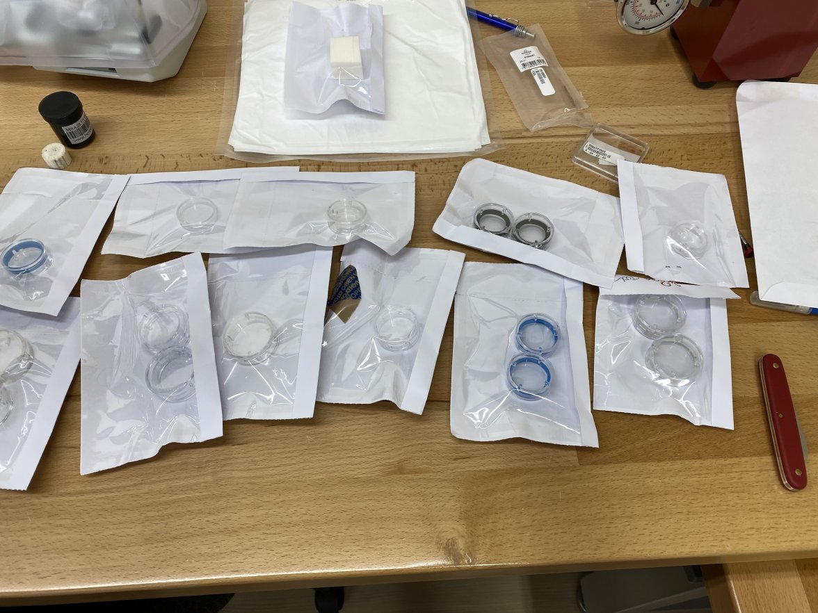

I also now have movements boxes for the most common movements I service. These are nice to have as it protects the movement while it is on the timing machine when initial results are being checked before final assembly and casing.
