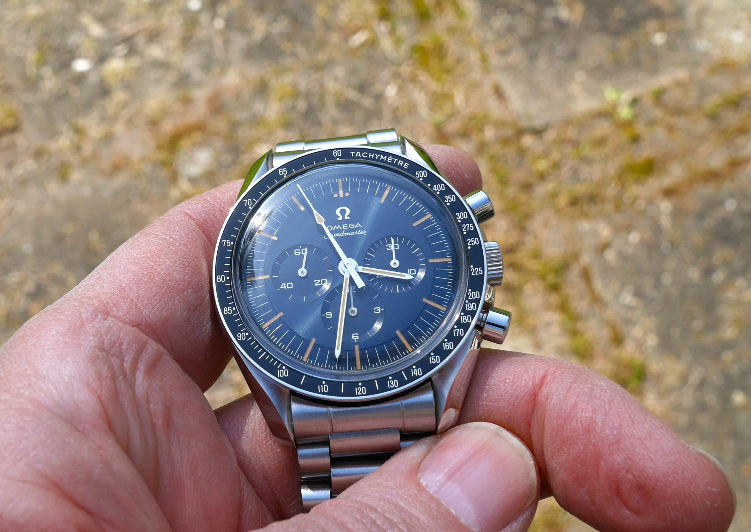

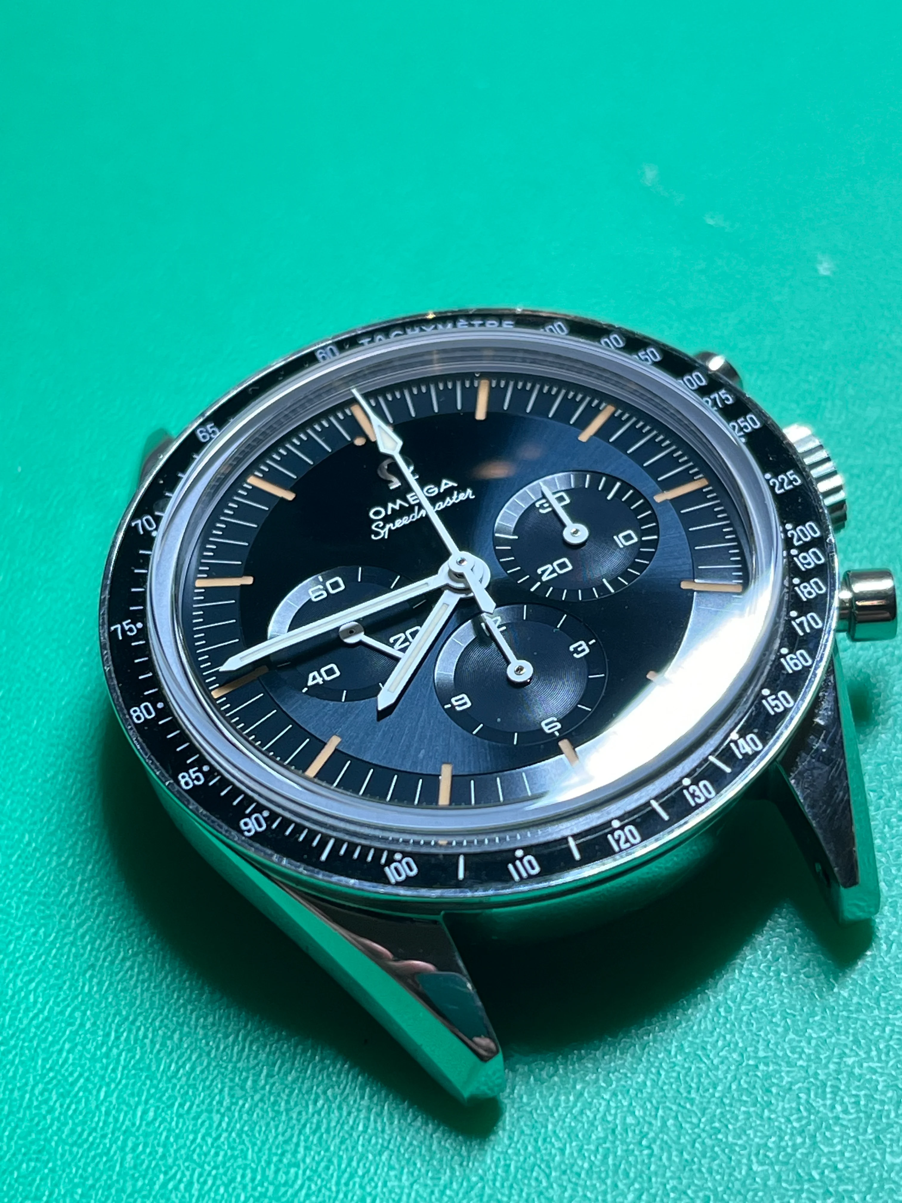

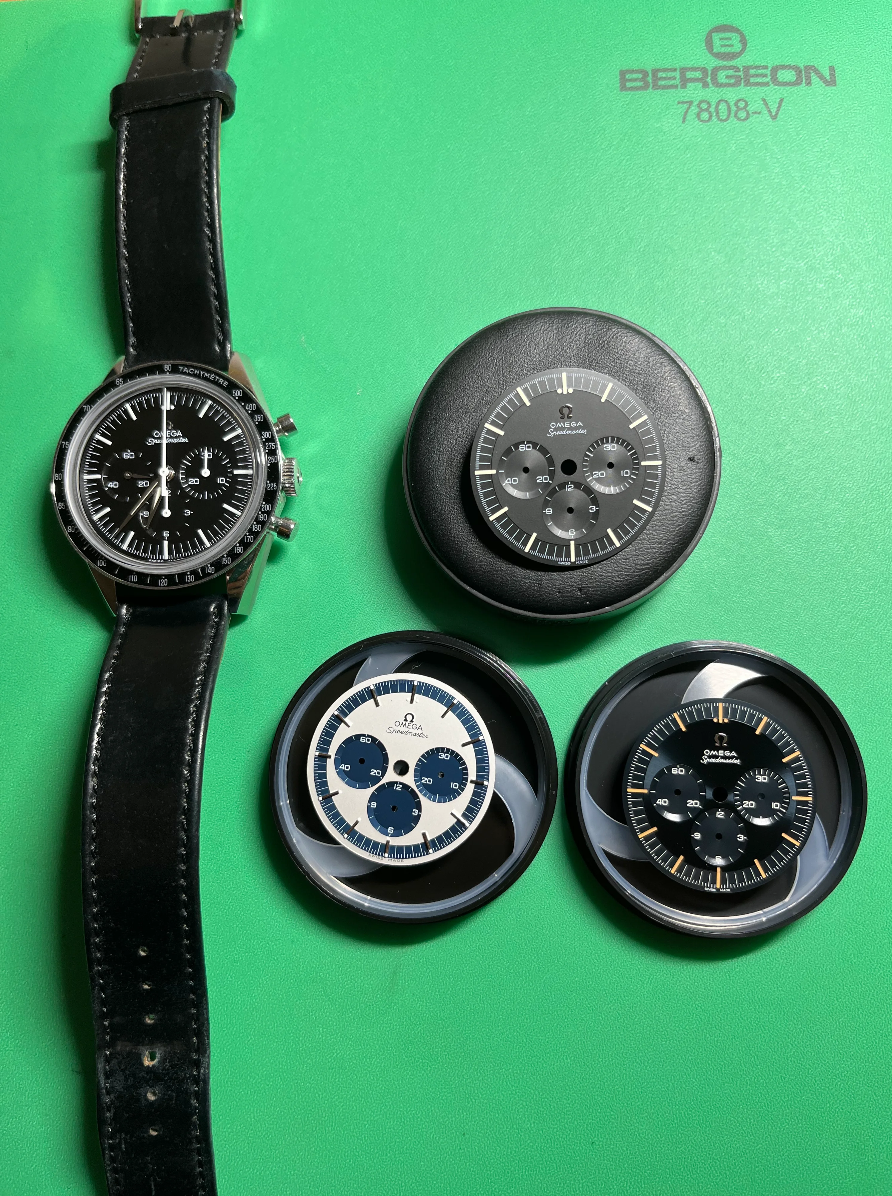

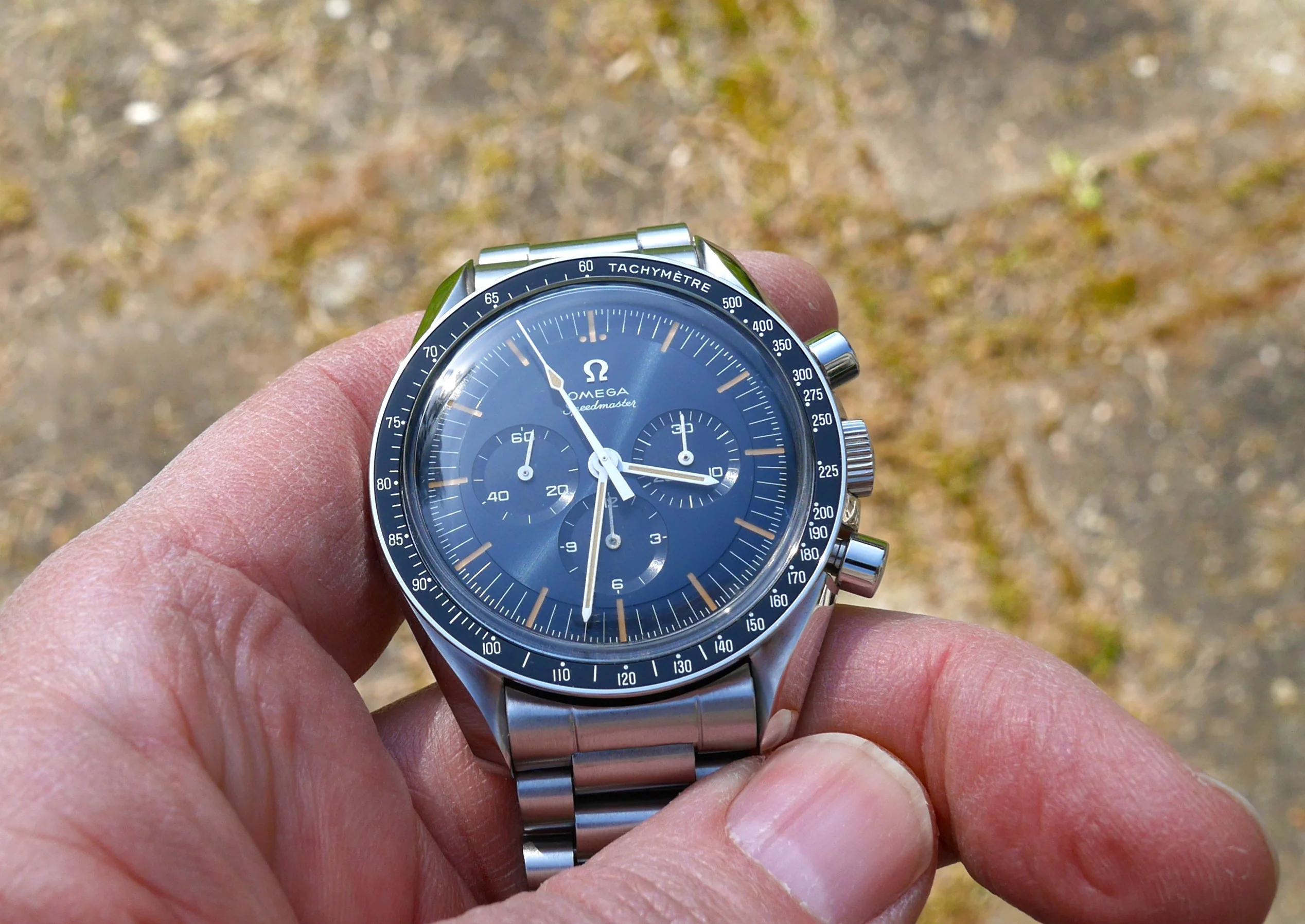

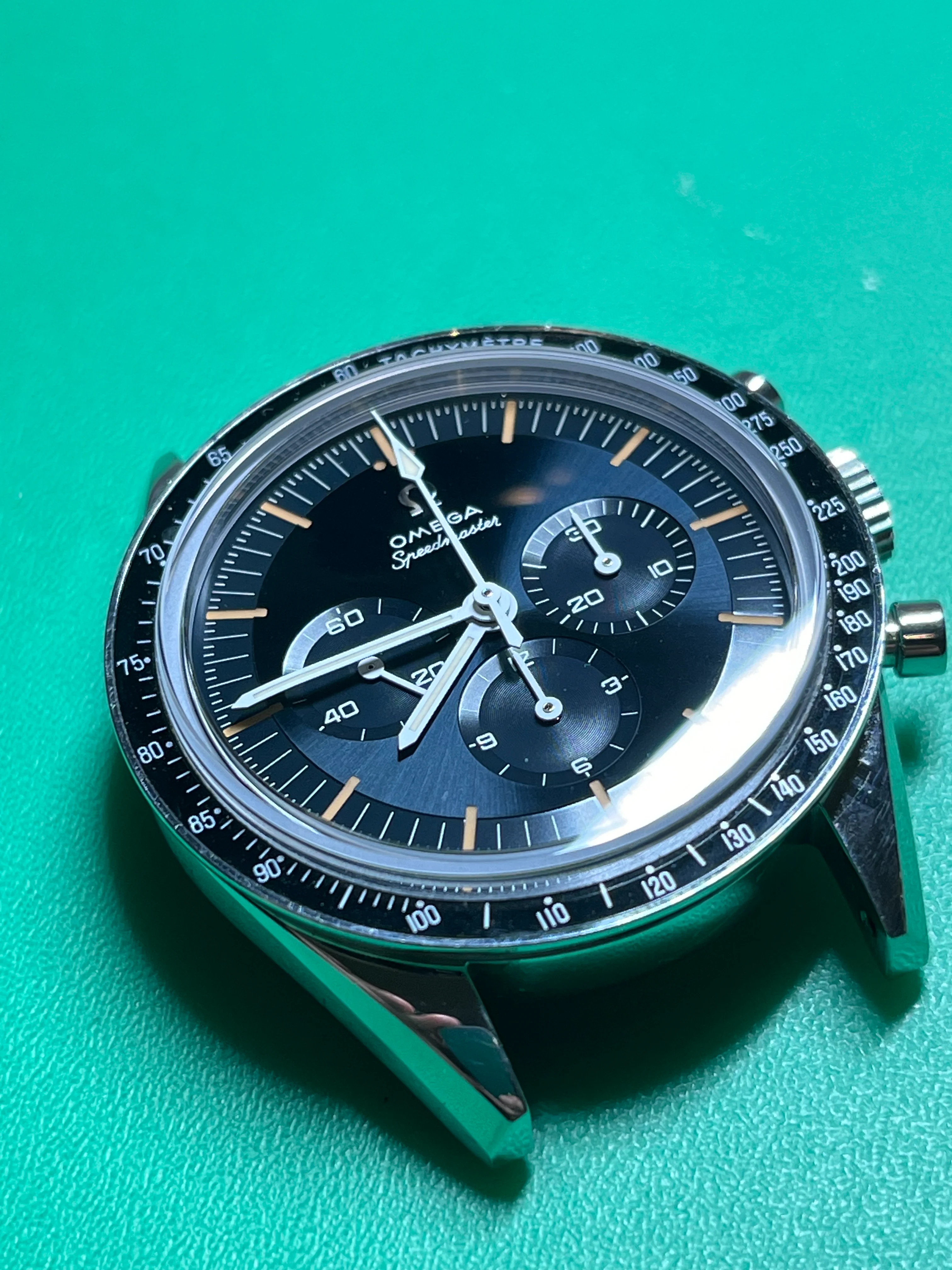

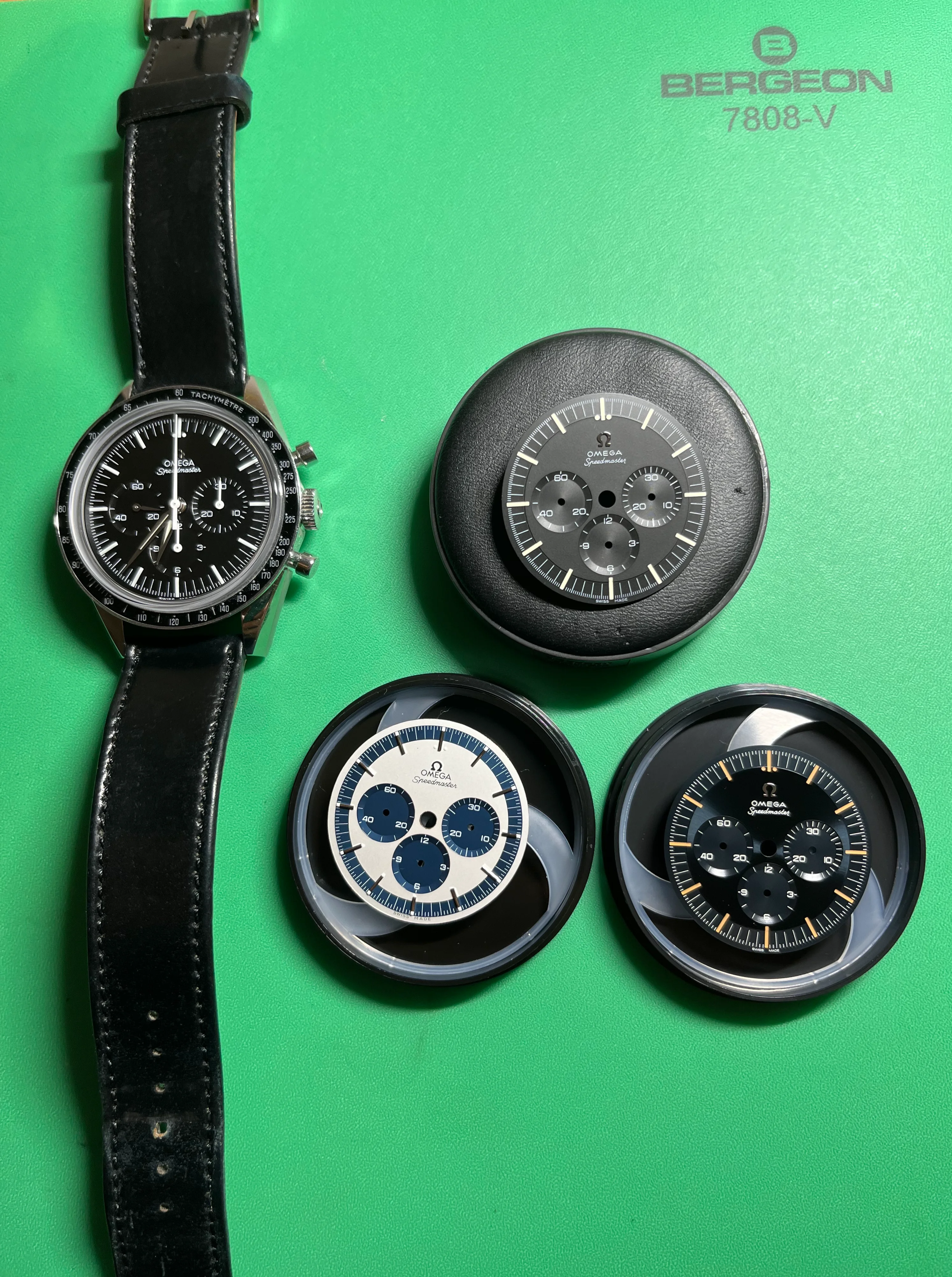

I only tried it once to fit the gen2 FOIS dial on a gen1 FOIS. i had no problems. Back then i couldnt find any information online so took a risk teying it out myself.
I havent measured the exact dial diameter or concave shape of the dial. So i dont know if there are any limitations in this respect.
Here what my watch looked like:
next to other dials for comparison:
