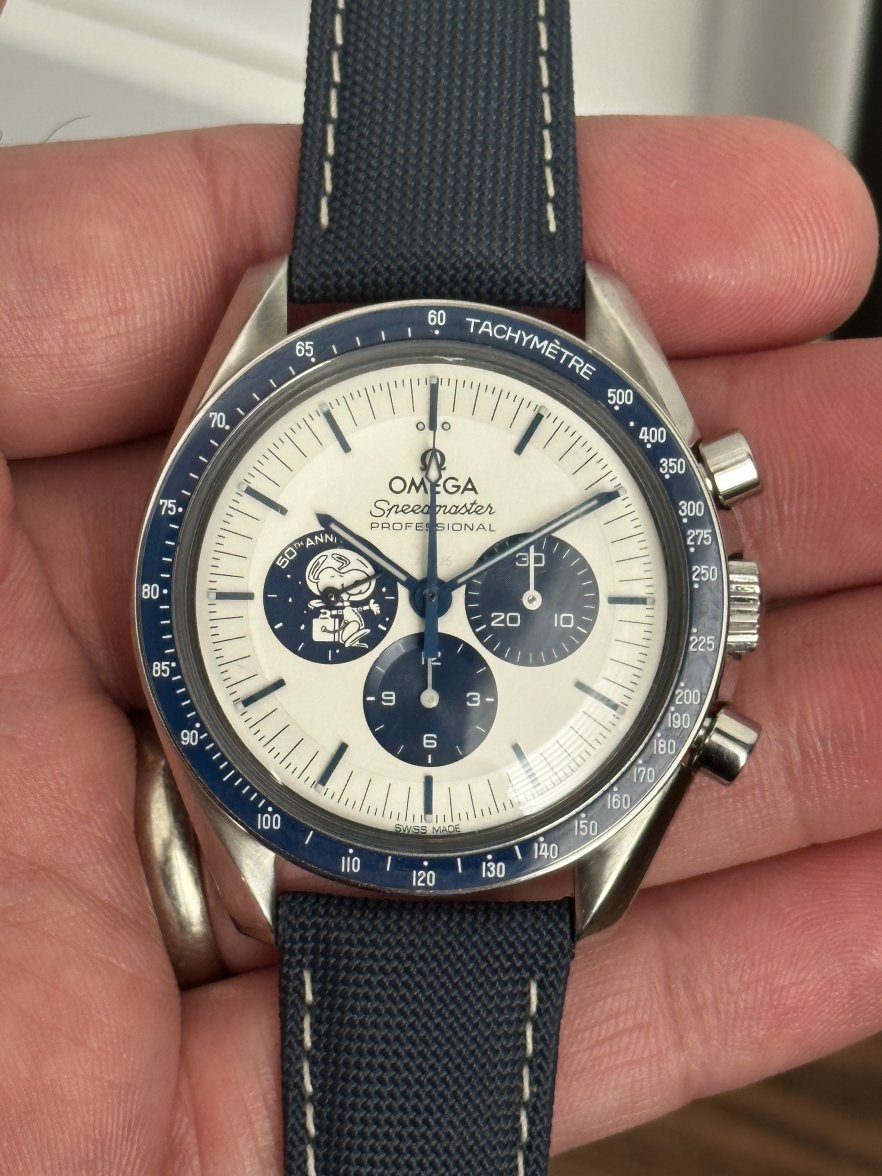

And not too long ago, there was a listing here on OF that went the other direction- 3861 (Snoopy) dial on a 1861 movement/case. According to the owner, the running seconds hand is a 1861 hand painted blue as the 3861 hand wouldn’t fit.
https://omegaforums.net/threads/ome...al-bezel-mod-chronograph-caliber-1861.158445/

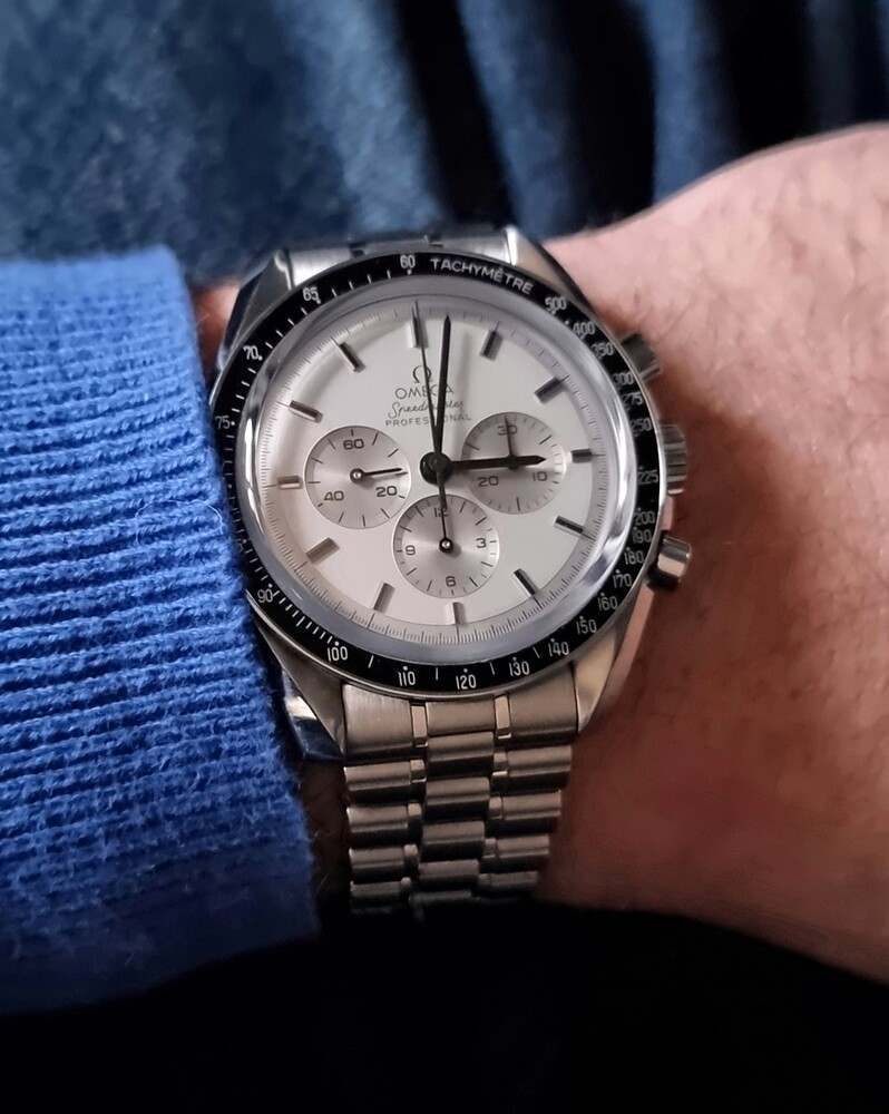

On a local forum a member modded a 3861 with a WG A11 10th anniversary dial and hands:
7,791
14,390
The feet fit according to this Panda dial mod on a 3861, but it is not pretty as there is a gap between the edge of the dial and the case, and the second hand issue. Currently on C24 asking 11K ????? , not my watch nor interest....
Yeah, that gap is a loser. I'm wondering if the conversion was done right, you usually won't have a gap like that. But maybe the lighter dial just exposes the ill fitment of an 1861 dial on a 3861 movement/case whereas it would be less visible with a black dial swap.
1,959
3,792
Looks to be a better fit.
