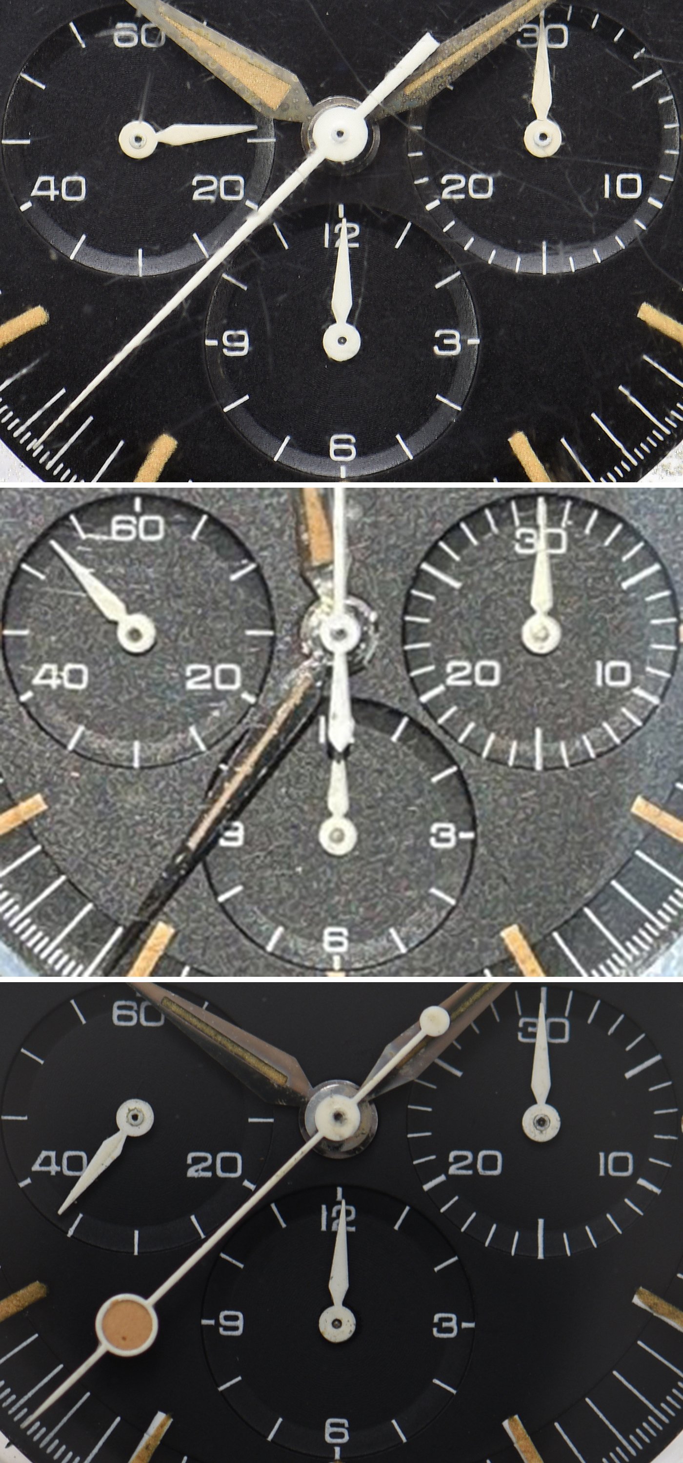

2,318
5,713
It's a nice example.
Going by the (partial) serial number it should be a CK2998-61.
Case has been polished.
The chrono hand is lacking the bent-down tip which could suggest it is a later service part rather than original period OEM.

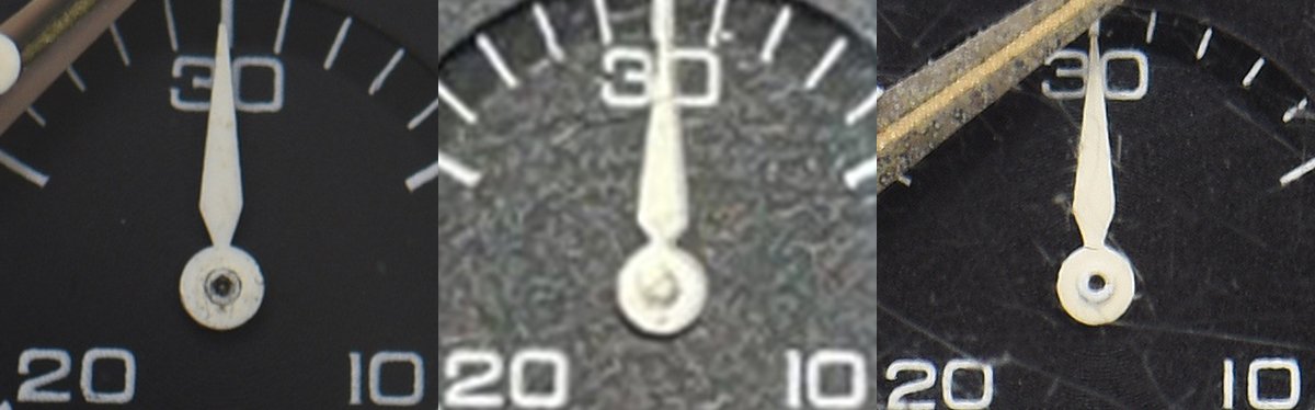

The subdial hands are not original. Their shape is not correct for period OEM.
Picture comparison with a 2915 & a 2998-3 below (OP's watch in the middle).
5,729
9,515
Excellent comparison for future questions!
532
2,317
Great Comparison - Thank you ; )
Caseback comes off today when I visit my watchmaker but your comments appear spot on
Chrono hand tritium matches well but the tip is not bent and I suspect it was service replacement
I love these subdial hands so while I suspect they are not correct, they are staying ; )
Will have some better photos on the case, too. Yes polished, but perhaps not as badly as the photos in the sun amplify
I am glad you chimed in ; )
