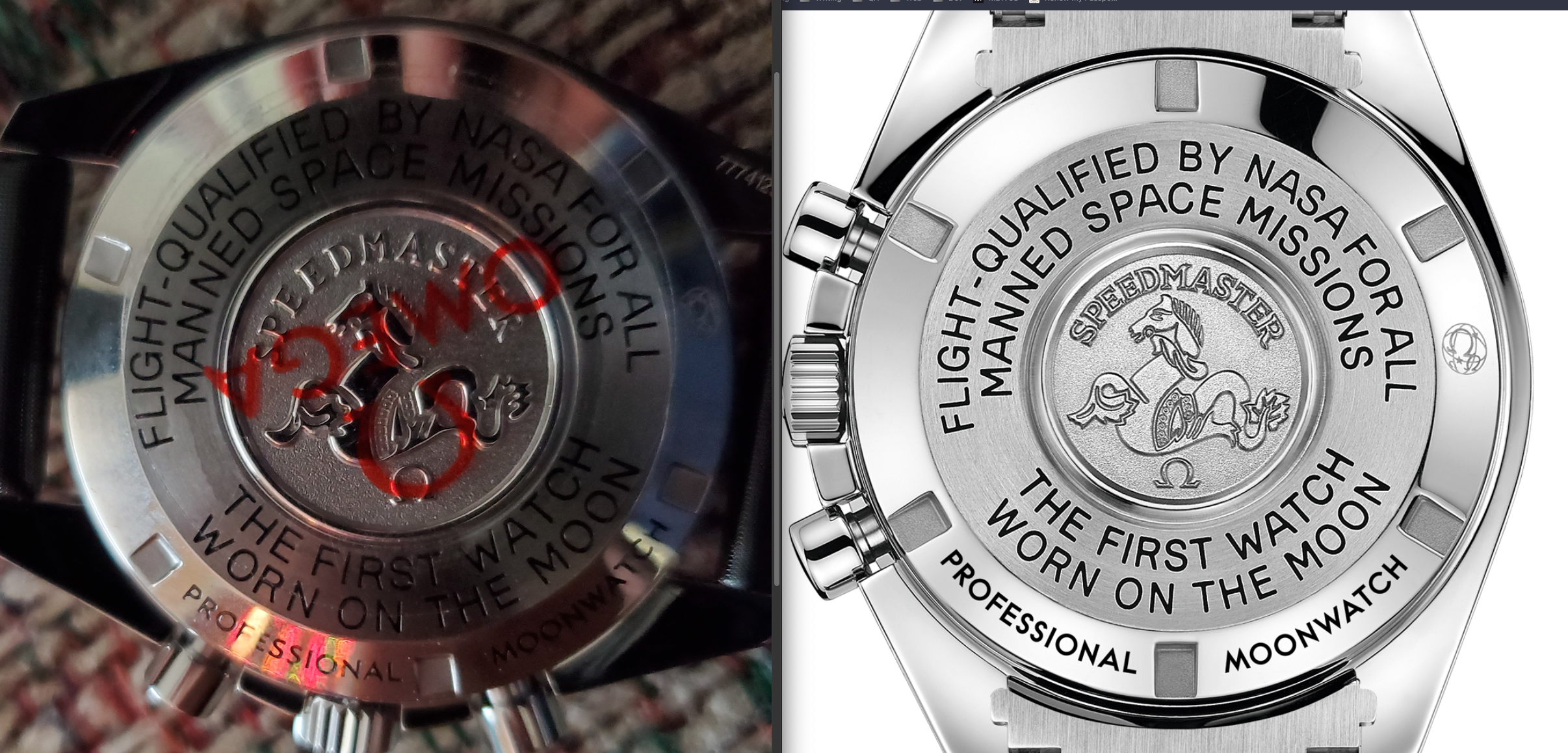

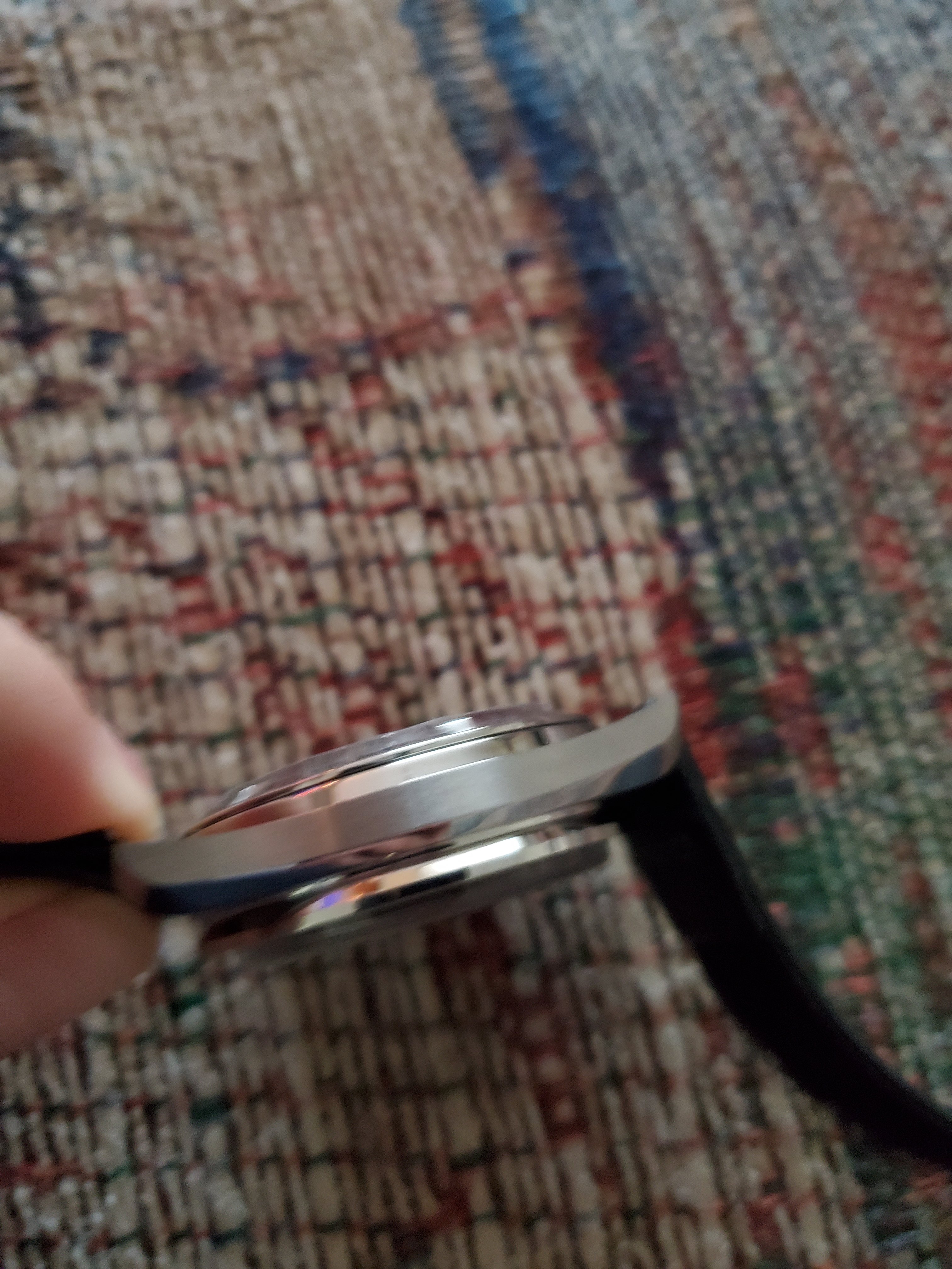

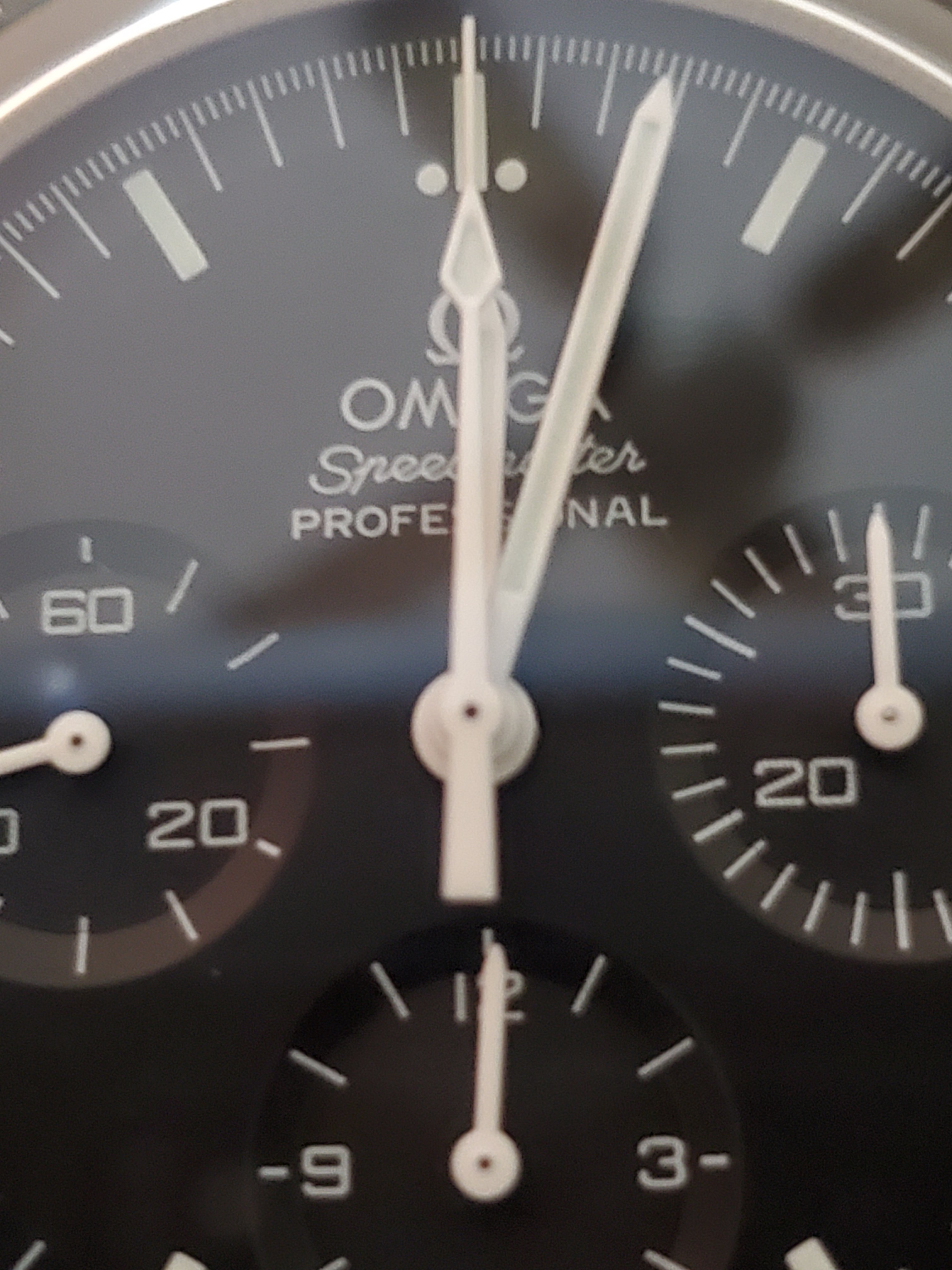

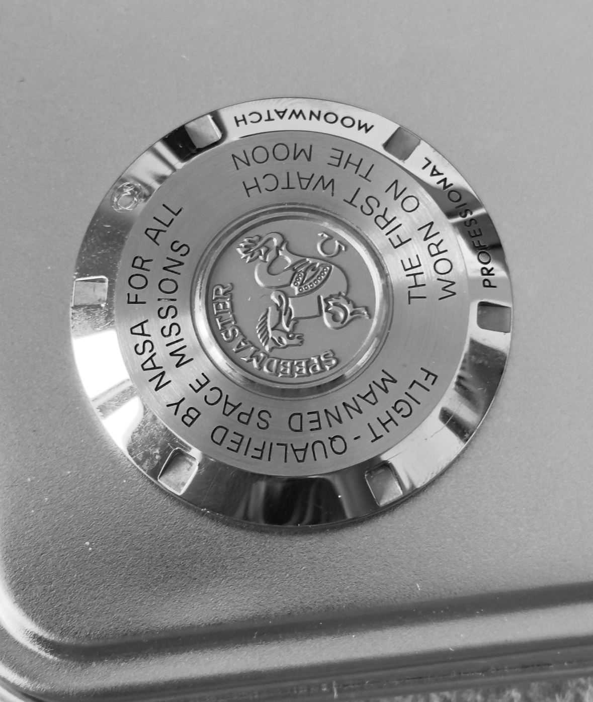

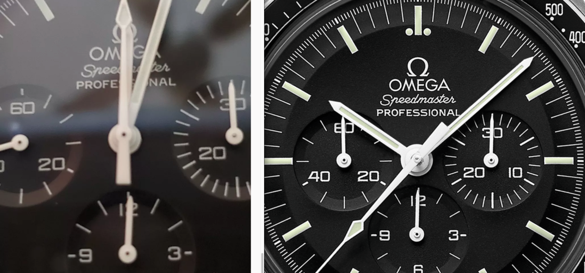

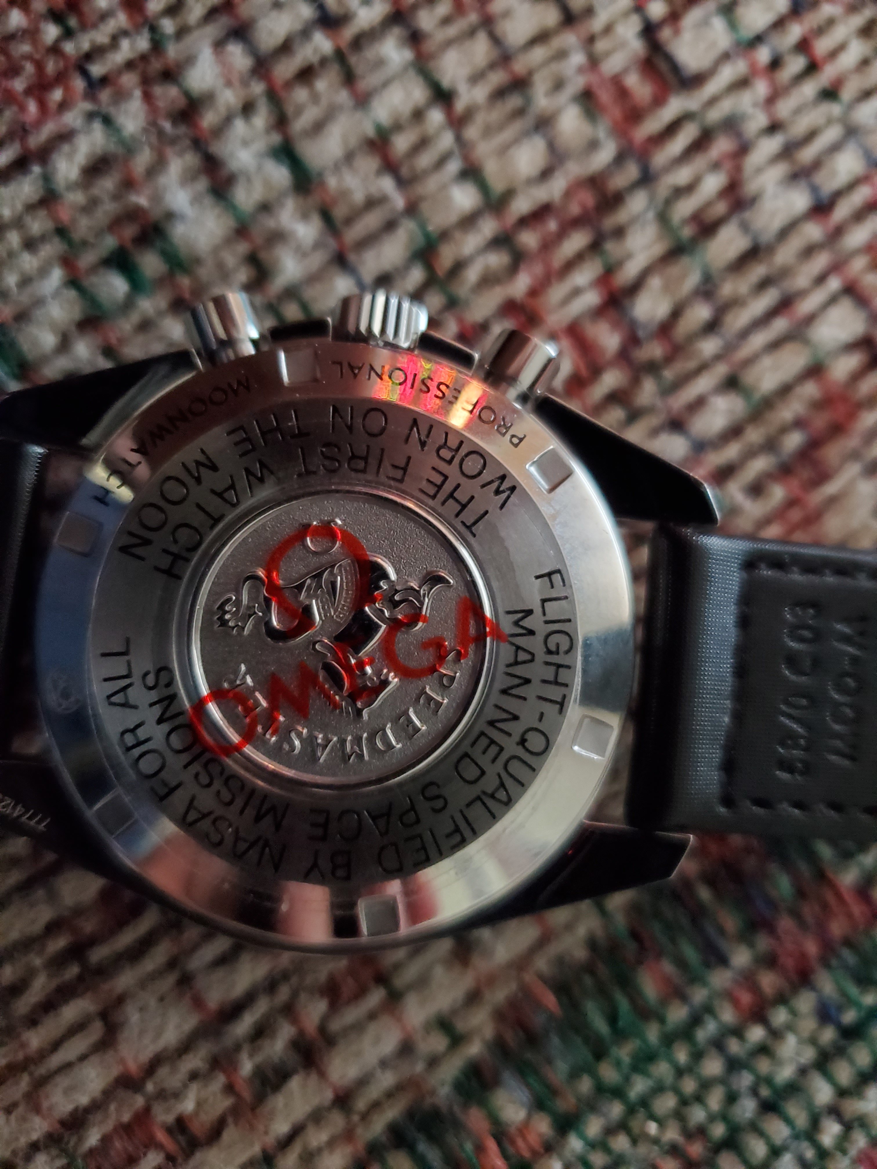

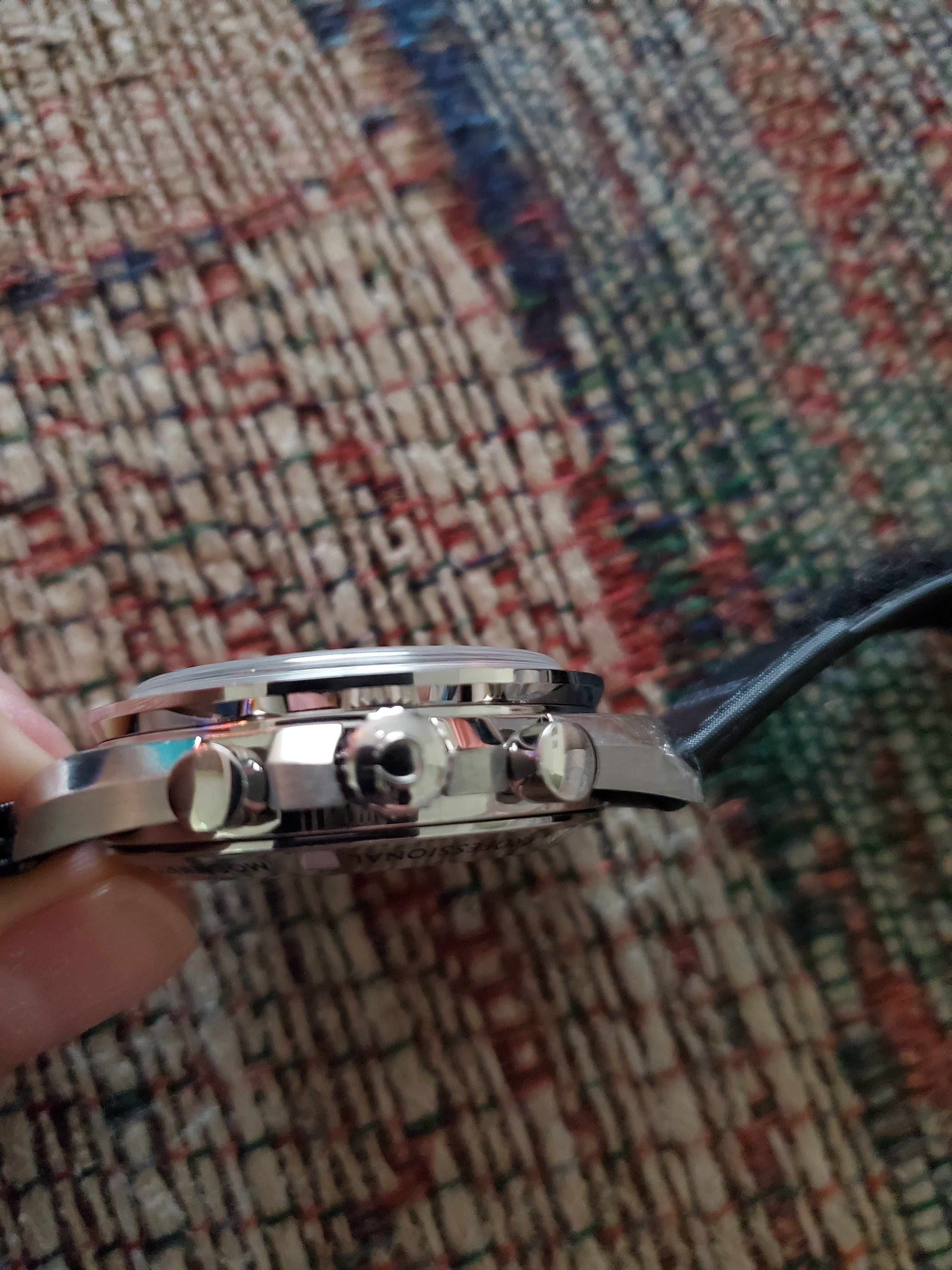

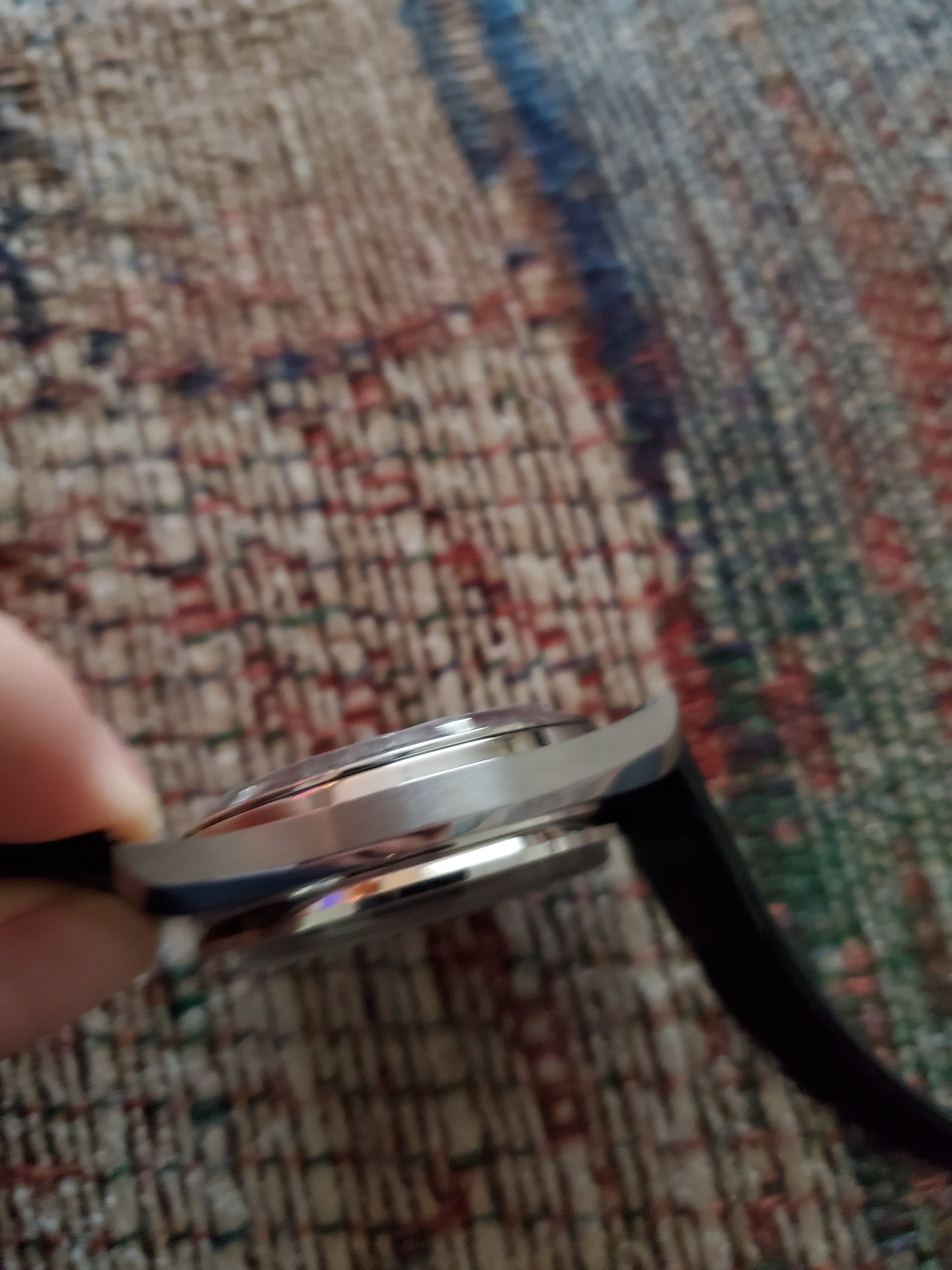

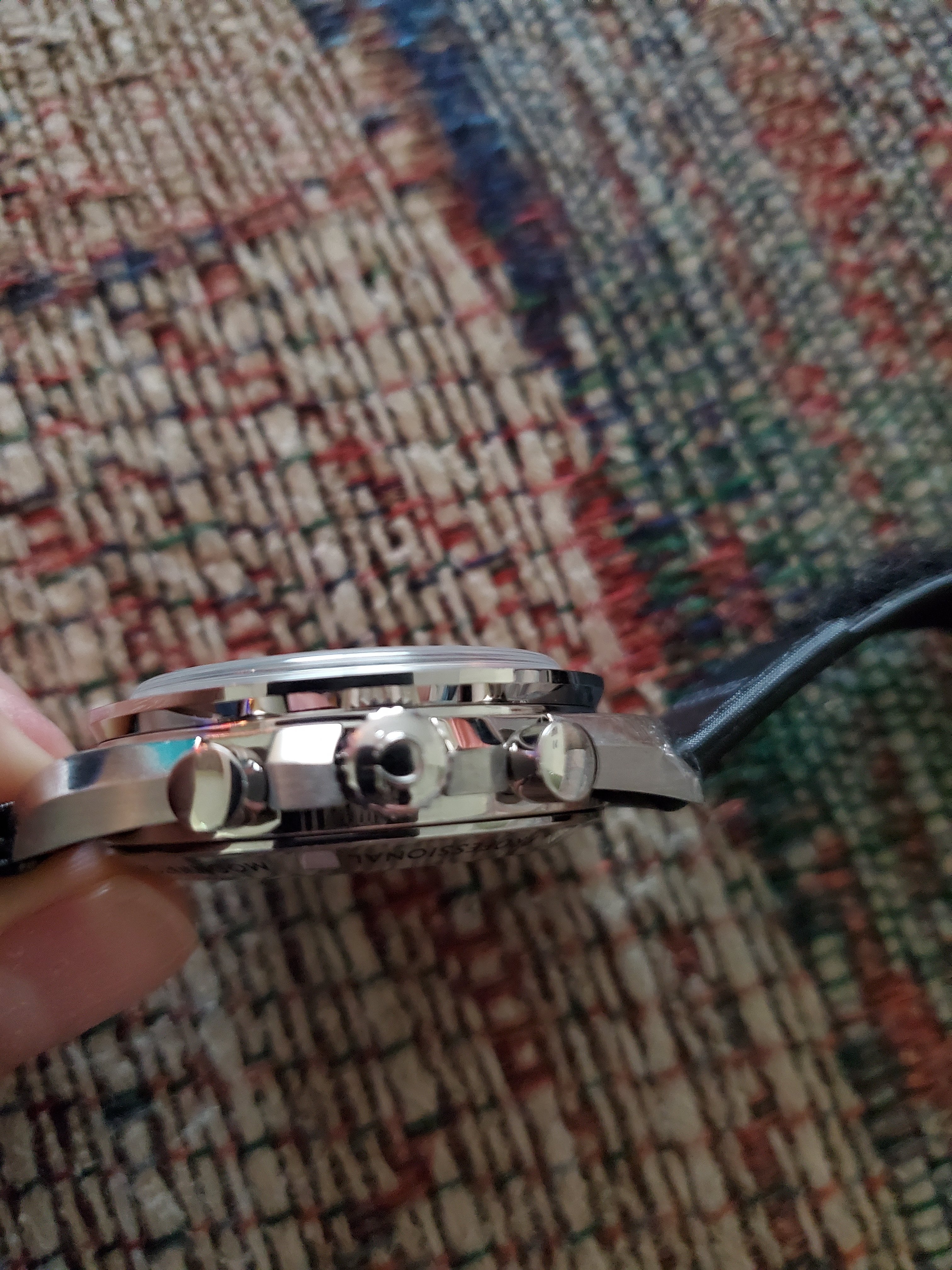

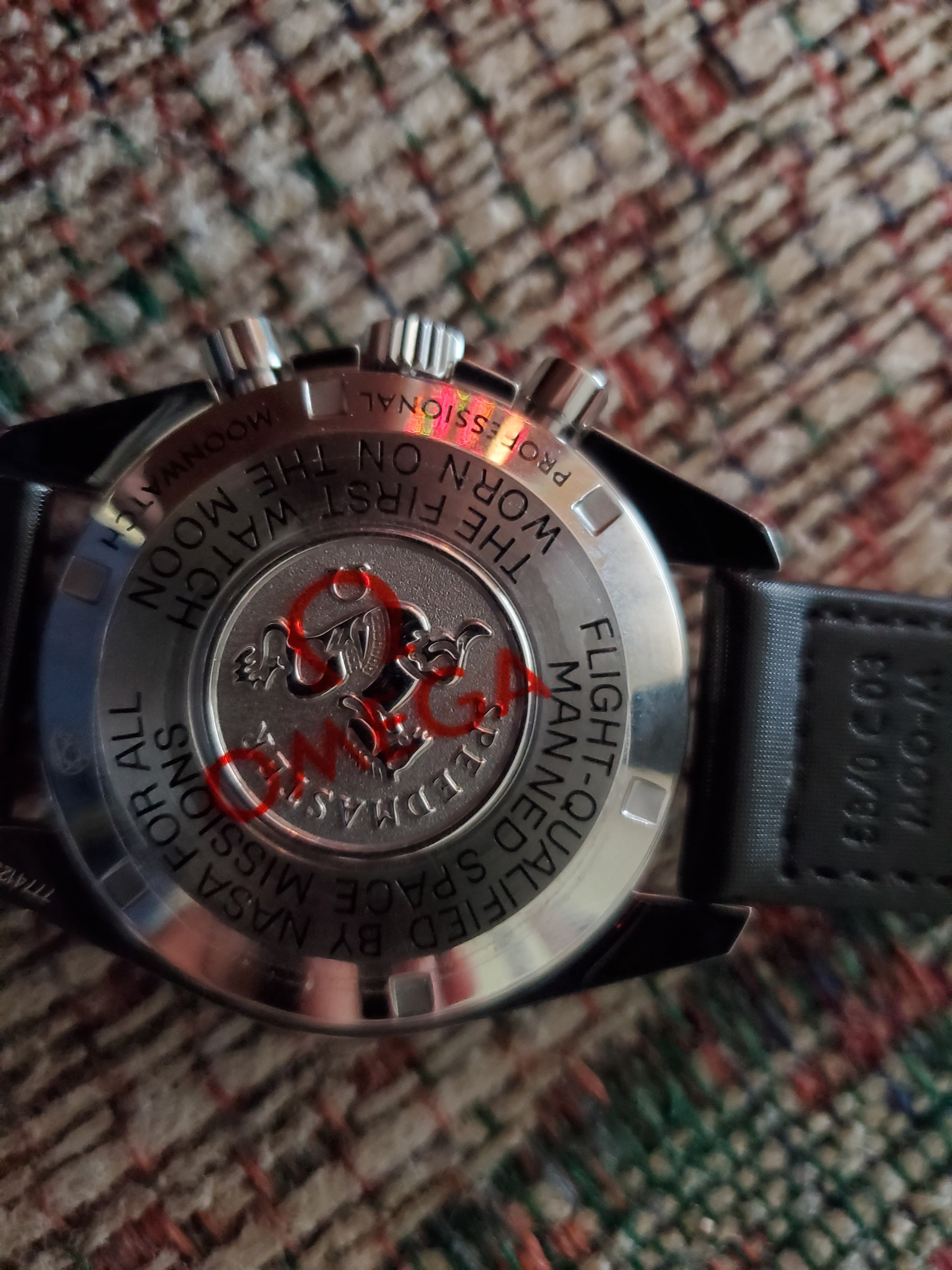

Well finally received my speedy the seller sent an 1861 solid back and hesalite crystal instead of sapphire. I n the grand scheme it could have been worse
6,609
26,780
This is, unfortunately, a fake watch. I’d return that immediately.
881
2,228
As part of my learning process... would you mind sharing the signs of it being a fake
6,609
26,780

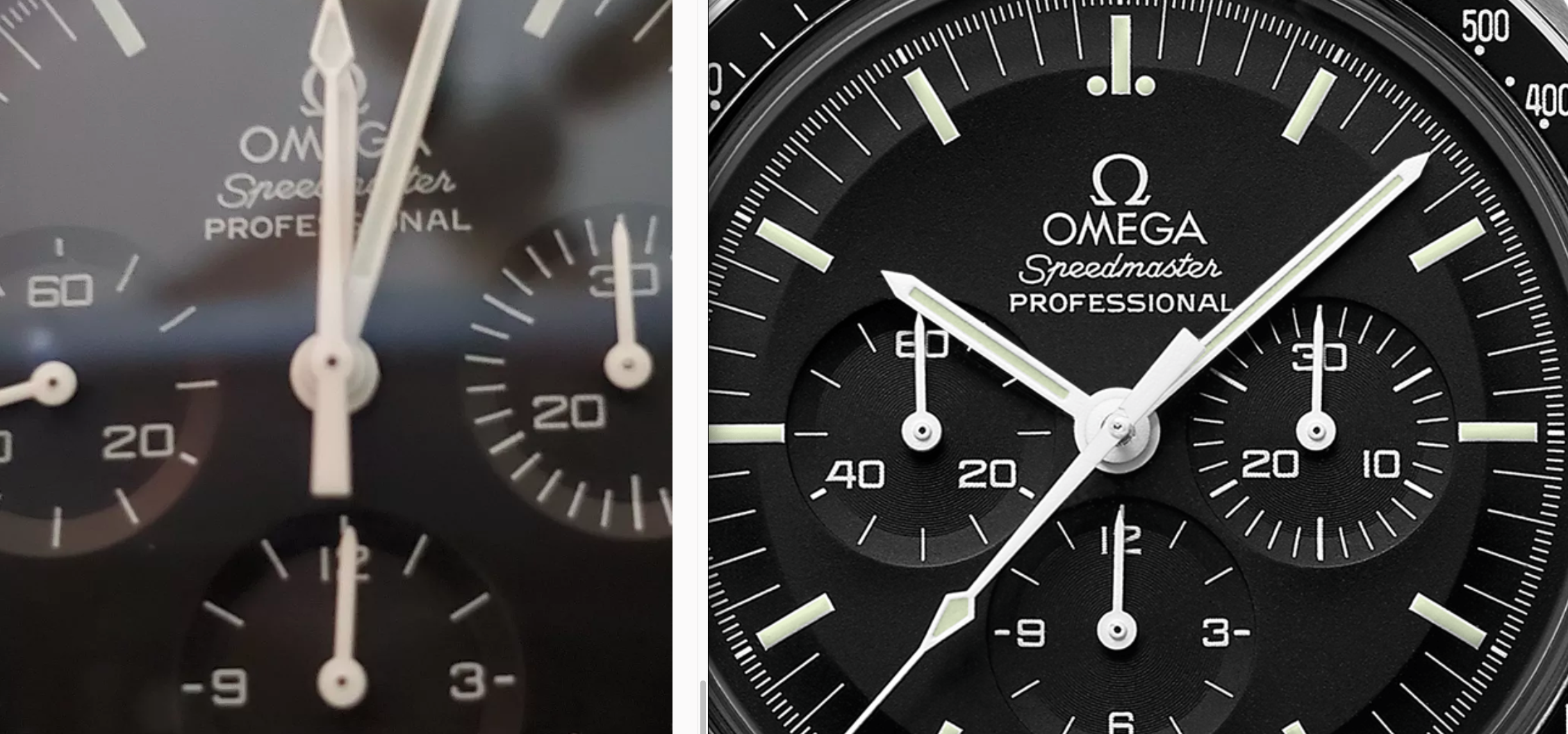

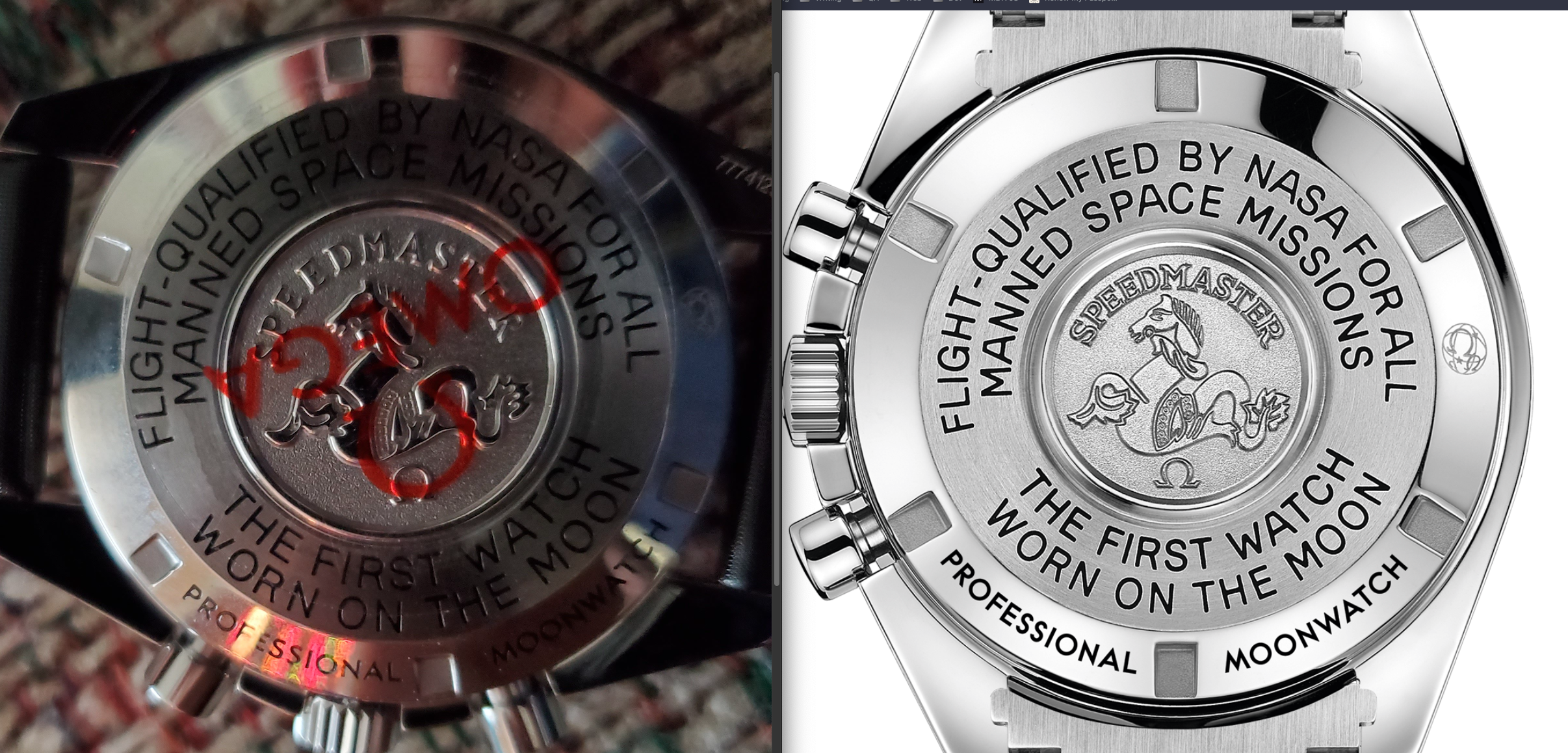

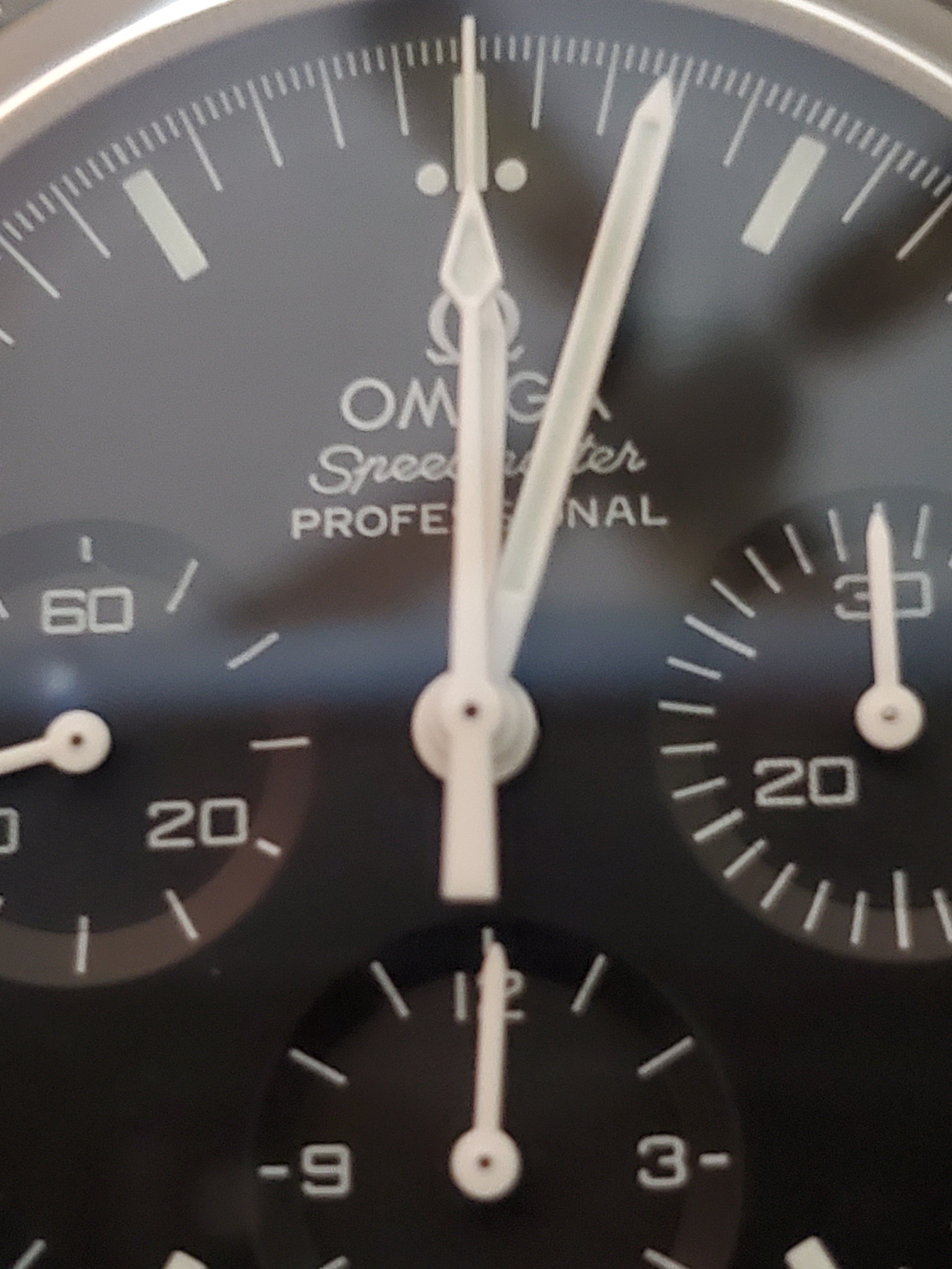

Well, everything about the watch is wrong. The case- it has the wrong shape and is also too tall because it has the wrong movement in it. The pushers and crown aren't on the same plane/in line with each other, because of the movement. The pusher/crown orientation is like that of a Speedy Reduced. The case back- has the wrong font, spacing, engraving, and the hippocampus (along with being incorrect) is huge. The dial- font is wrong, the sub dial spacing is wrong, and all of the hands are incorrect. I'm sure there would be other tells but the suspiciously tight cropped dial photo hides them.

I need to work on my eye because the red flags didn't jump out at me. I had to look at some side-by-sides and the differences became clear. As mentioned, the spacing of the sub-registers and the sub-register hands are very different. On the back, the hippocampus is way off and the grooves for opening the case are much different.
