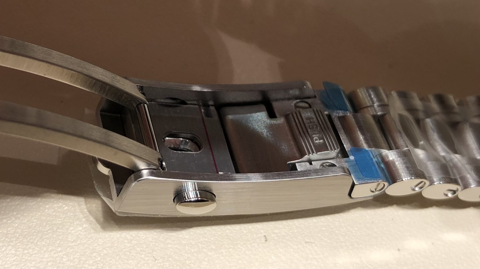

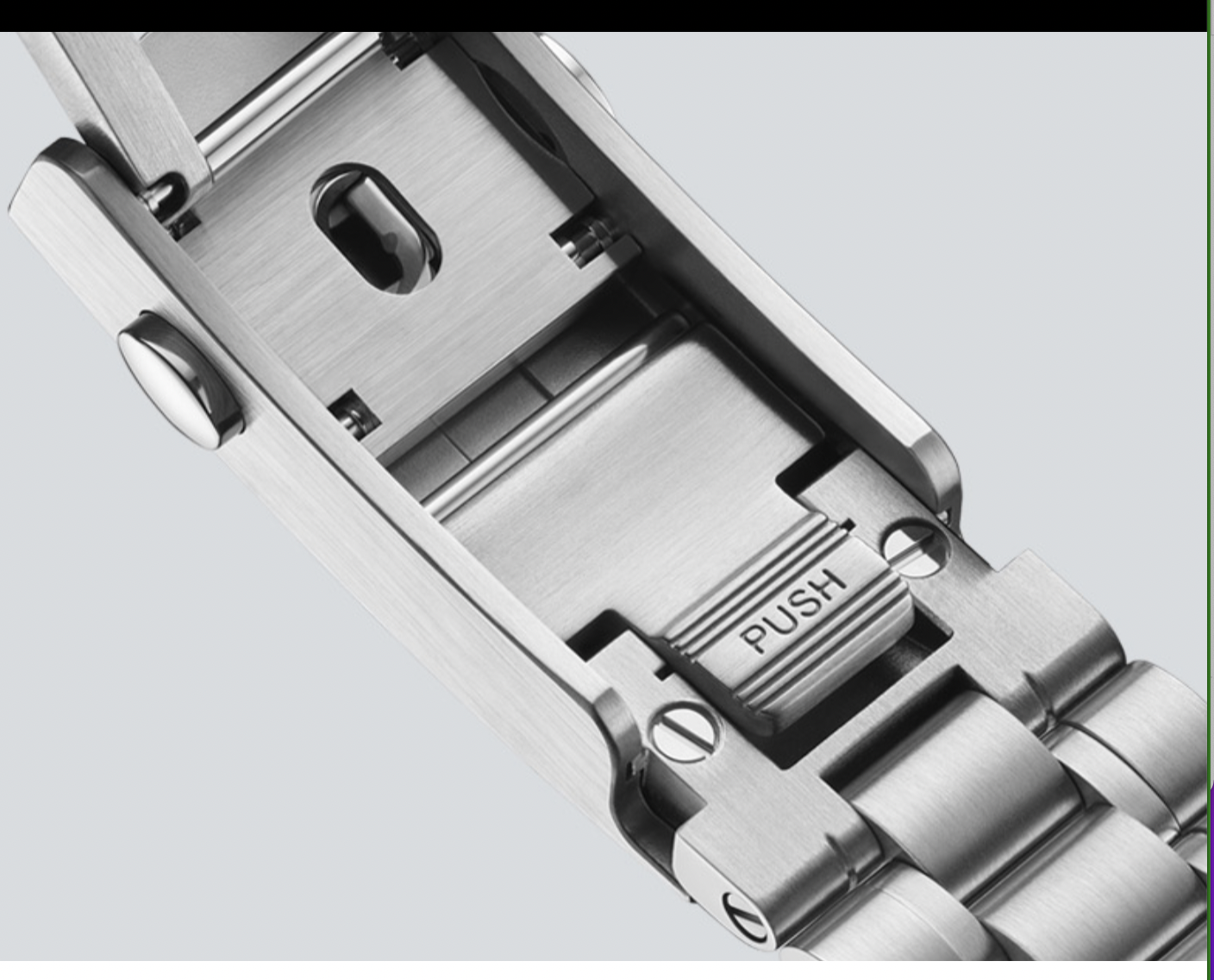

I'm seeing there is an adjustable clasp on the new Chronoscope that Omega just released. It says it's a 21mm bracelet but tapers to 15mm at the clasp. Soooooo I'm thinking you can fit this on the the 20mm moonwatch that tapers to 15mm.......they look identical at the clasp. So might need a new end link or two but it should work..... Anyone have any insight into if they think this will work?

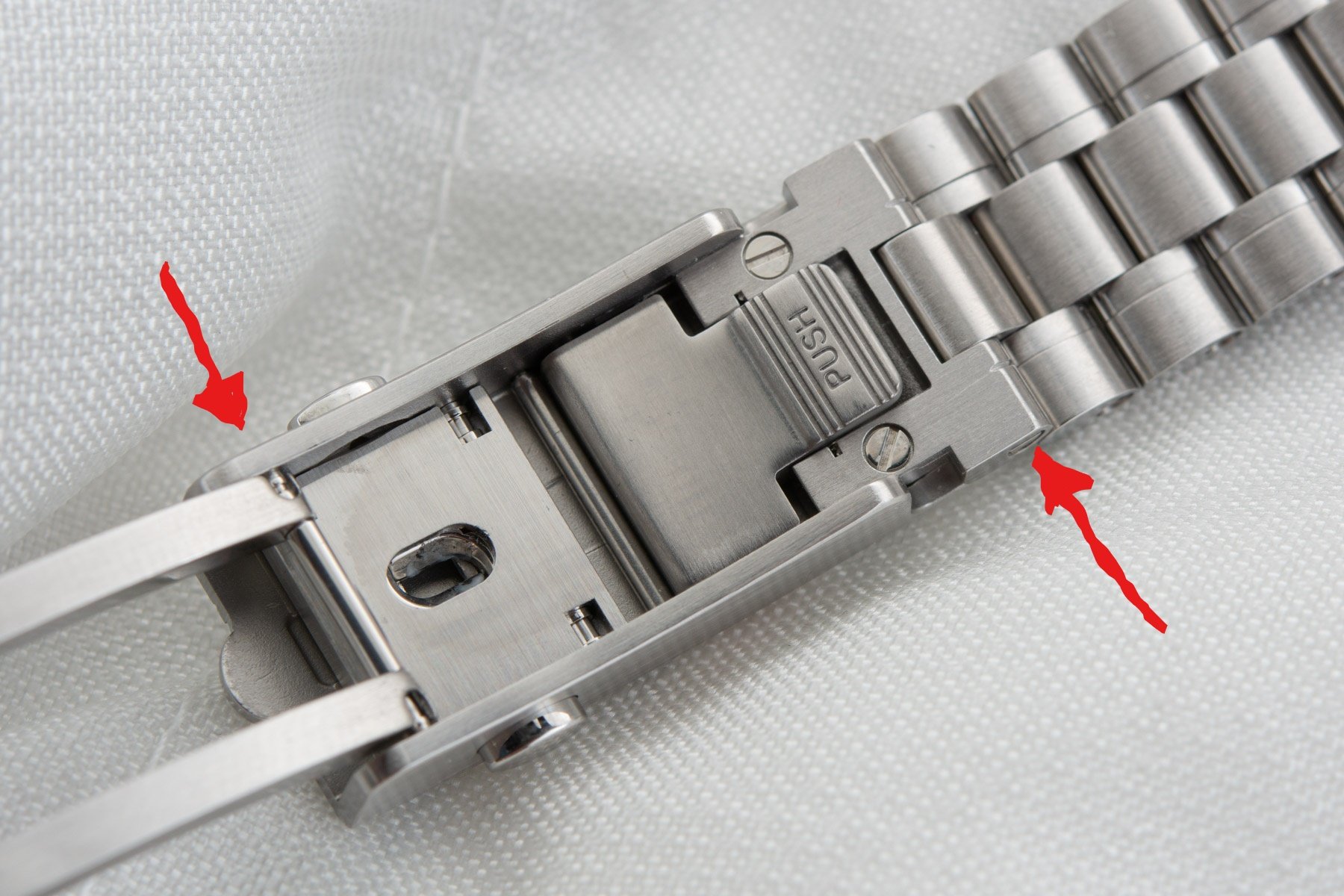

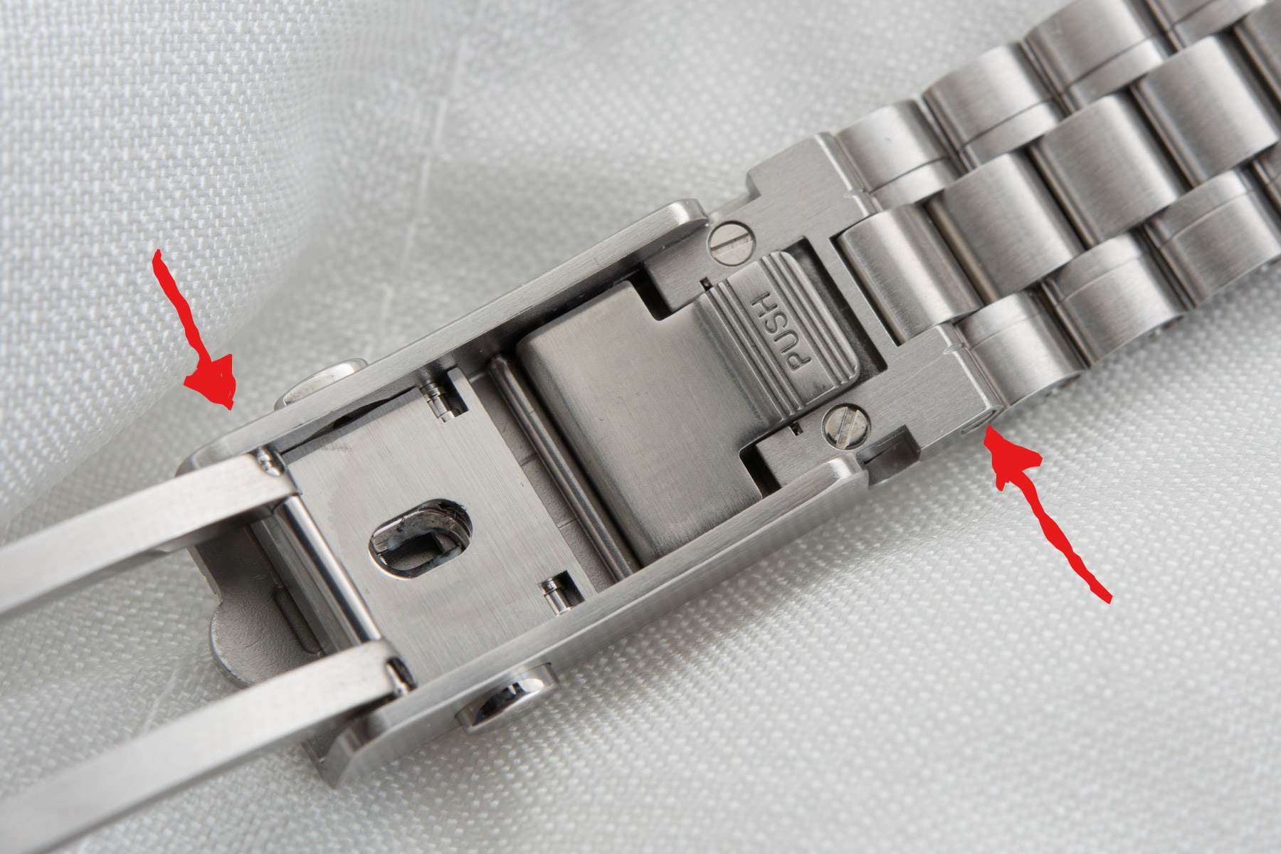

my guess is that you remove the 3861 clasp where the arrows are (see pic below) and that is the micro adj clasp part you order from the Chronoscope bracelet and install it on our Moonwatch bracelets....
241
278
I think you have to buy the whole clasp, attach it at the link shown with your arrow, and attach it to the swing arm to the end link that isn't shown.

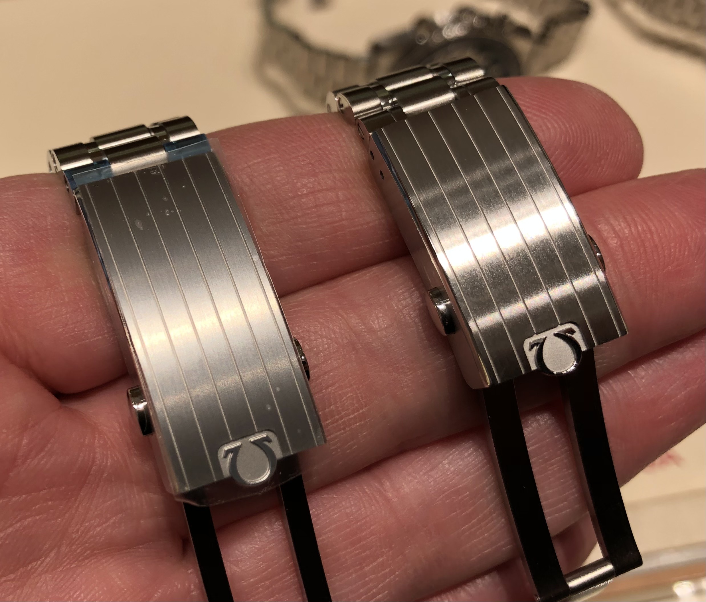

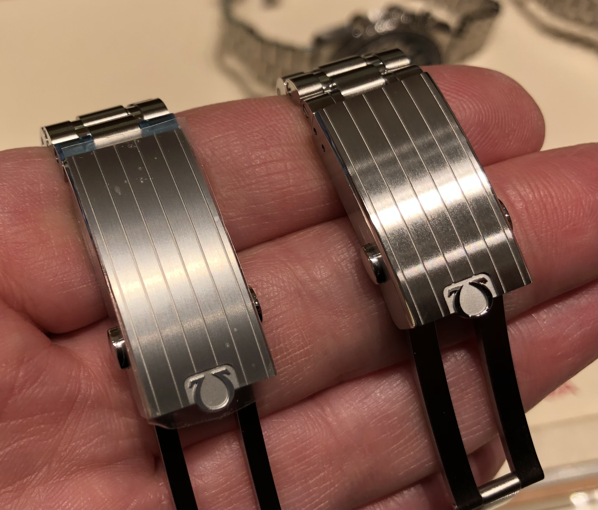

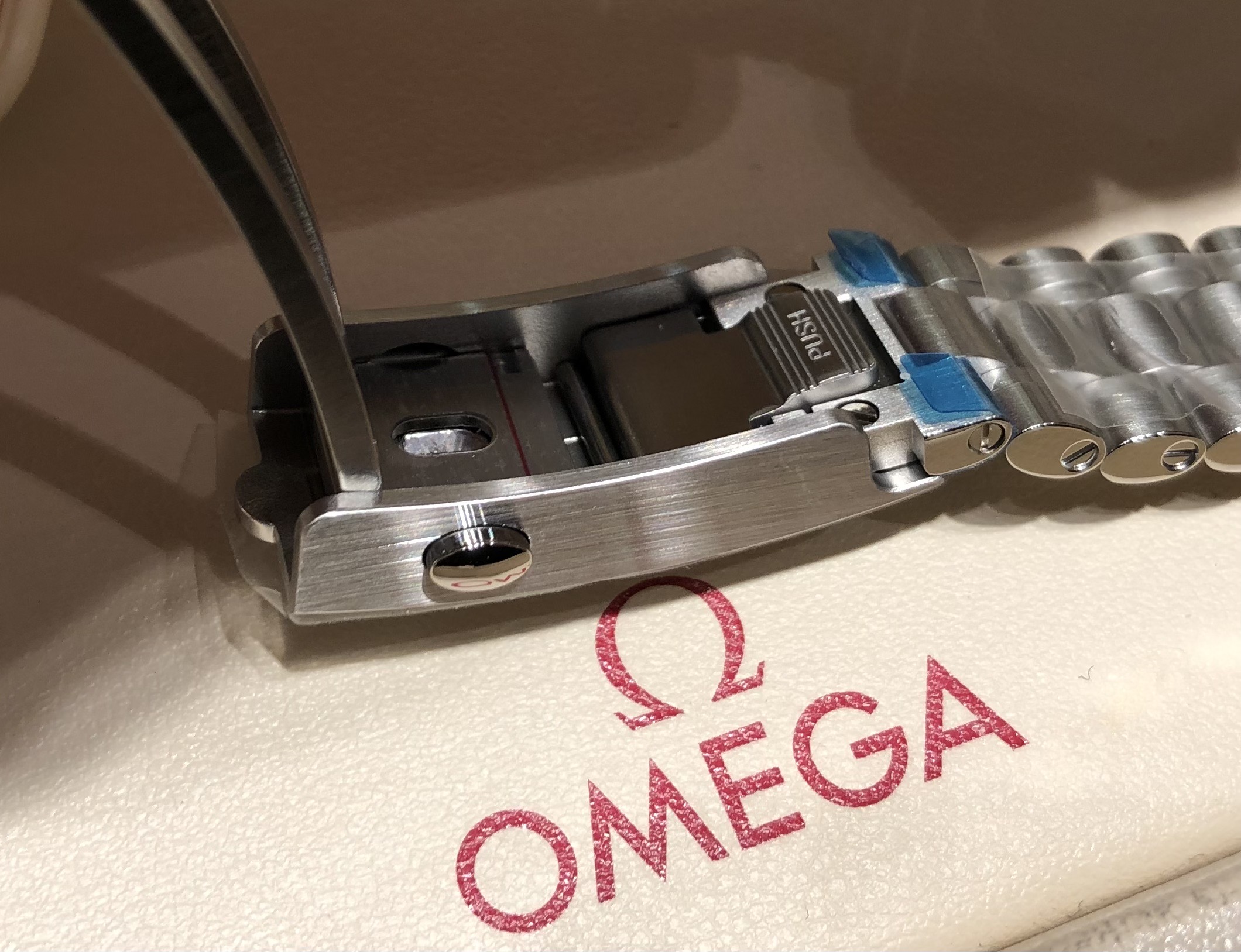

Went to the Omega Boutique in Hamburg to also check out the above clasp swap. The Chronoscope clasp is definitely the same width as the regular 3861 clasp (15mm). You don’t get a huge amount of adjustment though; probably even less than on the Tokyo 2020 micro-adjust clasps.
Chronoscope on the left, regular 3861 clasp on the right.
7,784
14,378

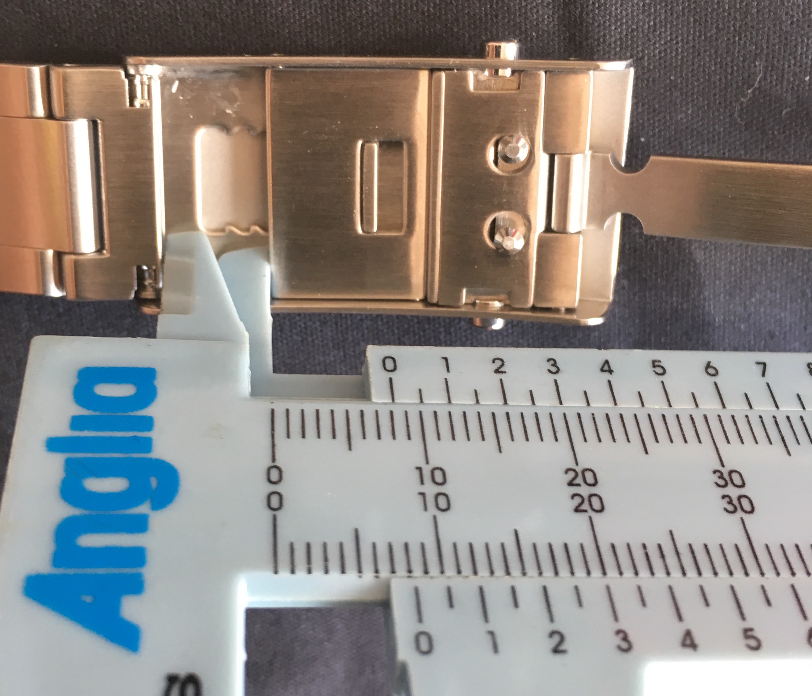

IIRC the adjustment gap on the Tokyo 2020 Speedmaster clasp is 3.8mm, the Chronoscope looks similar, maybe a half link. Handy if your wrist is just that much out of adjustment for a good fit.
