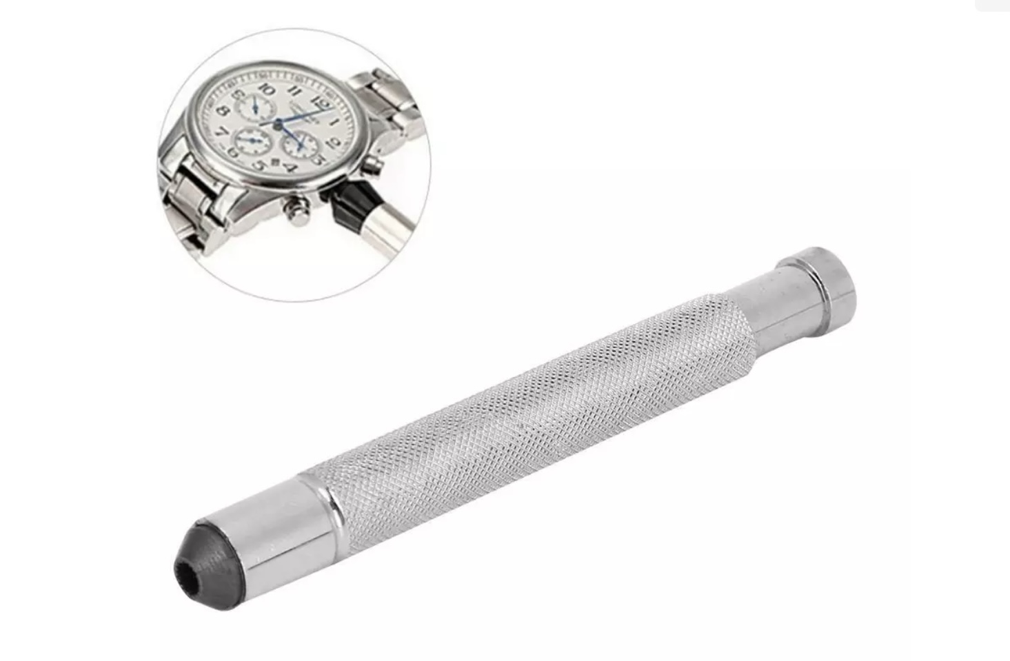

When @Walrus suggests that you wear it for '3 days in a row’ he means actually wear it not take it off and put it on your bedside table overnight.
You might also buy a a watch crown winder

When @Walrus
....You might also buy a a watch crown winder
Very useful tools. I have 2 for different crown sizes. You do need to be careful how you fit it to the crown - metal jaws and easy to catch on the case itself. I find a bit of plastic bag over the crown helps avoid that. (I assume you have one and know that anyway).
Some automatic watches are next to impossible to wind manually. Worst I have is a 1960's IWC drsss watch with a small crown manufactured to be nice and smooth......This tool makes it easy.
