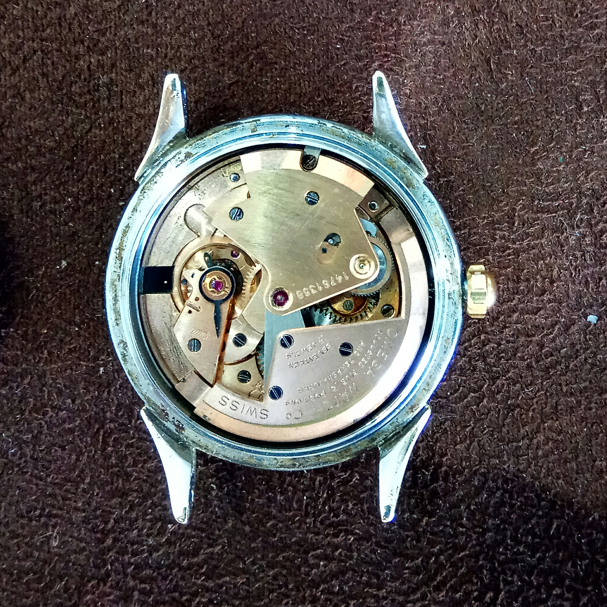

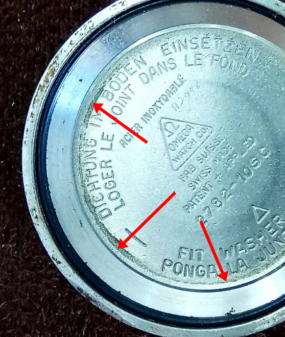

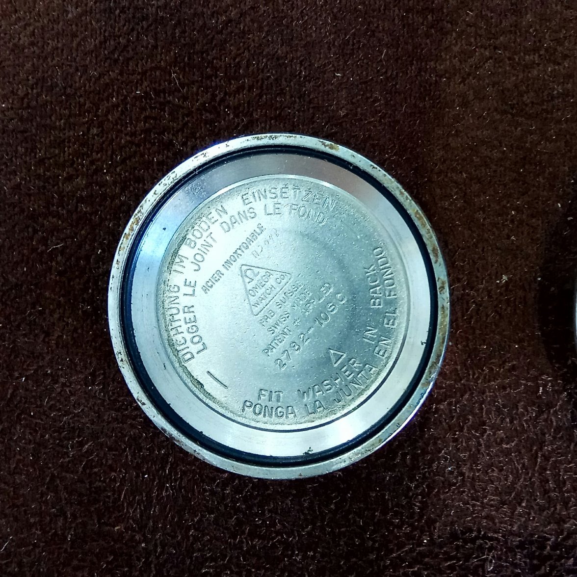

An update on my Dad's Constellation...S/N 14761358 I dropped the watch off at Shant's Watch and Clock in Pasadena... Shant says it's in excellent shape but because it has never been serviced (I see a scribed number on the inside of the back) he will replace the the mainspring anyway. Very dirty inside. True to my recollections the watch dates from 1955. The serial number is 1954 but it was probably something that had been held in stock for awhile.. I remember my dad saying that the black face was not as desirable as the others but he thought it looked better with his black Captain uniform...
S/N 14761358
I asked about the crystal being original (no logo) and he said the early watches did not all have a logo on the crystal.... I'll keep it anyway...
I asked about replacing the crown and he said that it wasn't necessary... Did they ever use the type of crown the watch now wearing?
He is going to have several bands for me to choose from when i pick it up next week... I'm leaning towards a pebble grain, matte leather...
Lovely place, delightful young man... And so it goes on living for a few more years... Ken

The movement number is unfortunately not visible in the photo as it is behind the rotor. The guy servicing the watch has a different perspective than the collectors on this site. He's telling you that it is in good shape and doesn't need to be replaced. Others here suggesting you replace it want you to have a period correct crown that goes with your otherwise immaculate early Constellation. That's for you to decide, of course, but since the cost is comparatively minor I hope you'll follow the advice given here.

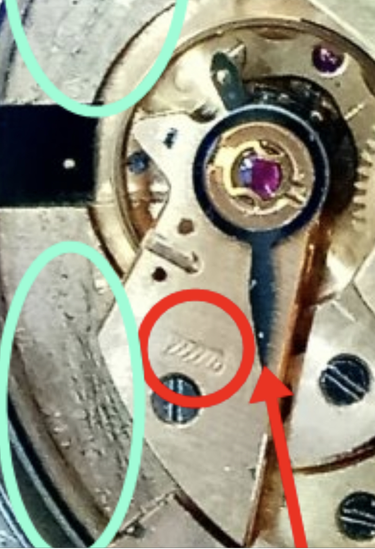

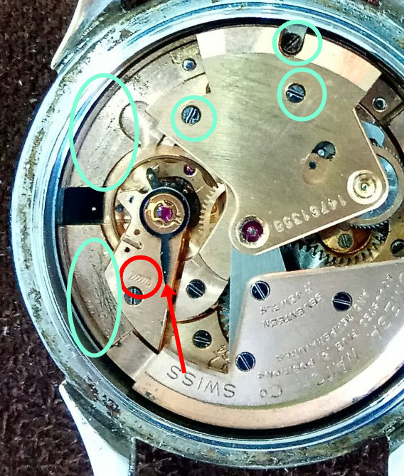

It certainly has been serviced before, and not by the best of watchmakers...

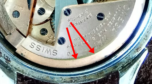

Also, there is evidence of the rotor rubbing. This should be fixed. Welcome to the world of vintage watches! 馃榿

The swan鈥檚 neck regulator is missing. I think those parts are available from Ofrei.com or other suppliers. Your watchmaker should fix this.
This is a cal. 354 movement. No question on that.
@Deafboy is correct in pointing out the shoddy job done previously. And the running rotor is clear. But fear not, this is not uncommon with these watches and can be corrected by a competent service.
Have him polish the screw heads gently
