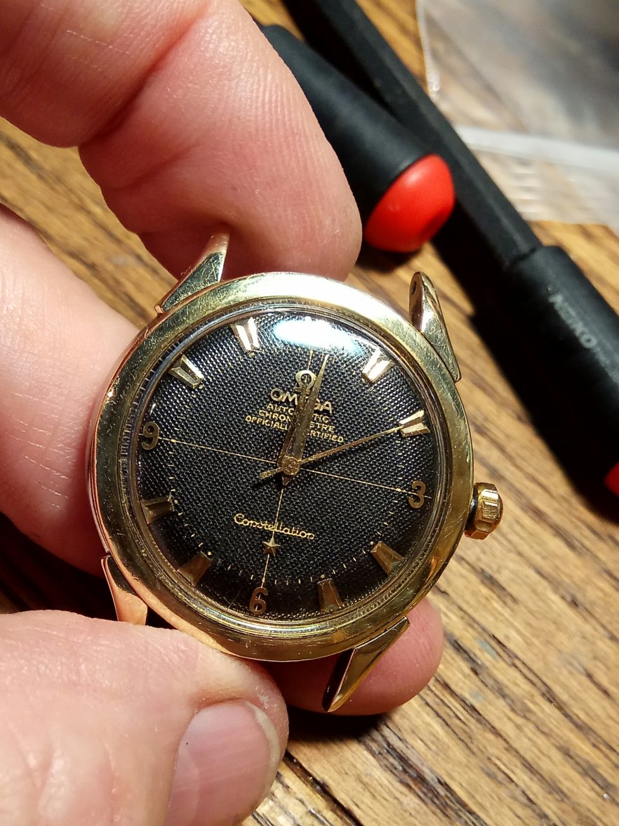

    Greetings, thanks for accepting my application for membership. I was recently given a box of stuff that was my Dad's. He was a pilot for PanAm in the fifties and sixties. Attached is a photo of a watch he wore as he traveled the world. I'd like some information about it's age, collectability, etc. Obviously it was well "loved". I'm in Pasadena CA and would like to have it cleaned up and get a new strap... recommendations? Thanks in advance. Ken

    Looks great. You might want to take a look at this thread about watch repair in LA:
    https://omegaforums.net/threads/trusted-watchmakers-in-los-angeles.79352/
    There are a few in Pasadena proper too, but I haven't used any of them so I can't comment.
    Standard advice on this forum is to avoid polishing the case, and not to run the watch before it's serviced. If a watchmaker opens it up for you, you can photograph the movement and the inside of the caseback, which will give you a unique serial number and a reference (model) number. These make dating and comparison easier.

    That's a lovely watch. It doesn't need to be "cleaned up" in any way as it's just perfect as is. It only needs servicing by a watchmaker experienced with vintage Omegas and who is sympathetic to its originality.

    Probably a 354 "bumper" movement under the hood. If you gently rotate the watch with dial facing you do you feel a slight tug?
    Nice watch. Like others have mentioned you should get it serviced by an independent watchmaker.
    Service implies complete dismantling of the watch, cleaning of the watch movement parts, reassembly, lubrication, adjustment.

    The dial on your watch is in outstanding original condition. Better than 95%+ of what you will find online.
    I’m guessing your watch is this one:
    https://web.archive.org/web/2016042....com/index.php/data-watch/omega/caliber-5/430
    Black dials on these were uncommon.
    Original crowns are available for this case. A watchmaker knowledgeable with vintage Omega should be able to find one for you.

    I get a "bump, bump, bump..." thanks for the information. The watch runs but gains time ... Ken

    Thanks for the heads up.... I planned to leave the case as is.... the crystal is pretty heavily scratched but serviceable so I'll let it be for now and just wear it as is..... Thanks again... Ken

    There’s a sticky thread entitled « watch strap ressources » with tons of recommendations for where to get straps. A shiny alligator would be too shiny IMO but I agree a FLAT matte alligator strap with large scales would look beautiful. Personally I hate padded straps and would find one overbearing on an elegant vintage watch. It would clash.
    One question is whether you’re looking for an Omega branded strap.
    Other great (and cheaper) options for this watch would include:
    - black shell cordovan strap (with thin black stitching). Several members here make cordovan straps.
    - black vintage style saffiano strap from Massimiliano aka Glc straps. I like them a lot but must admit I never bought from him. He does get consistently good reviews though.
