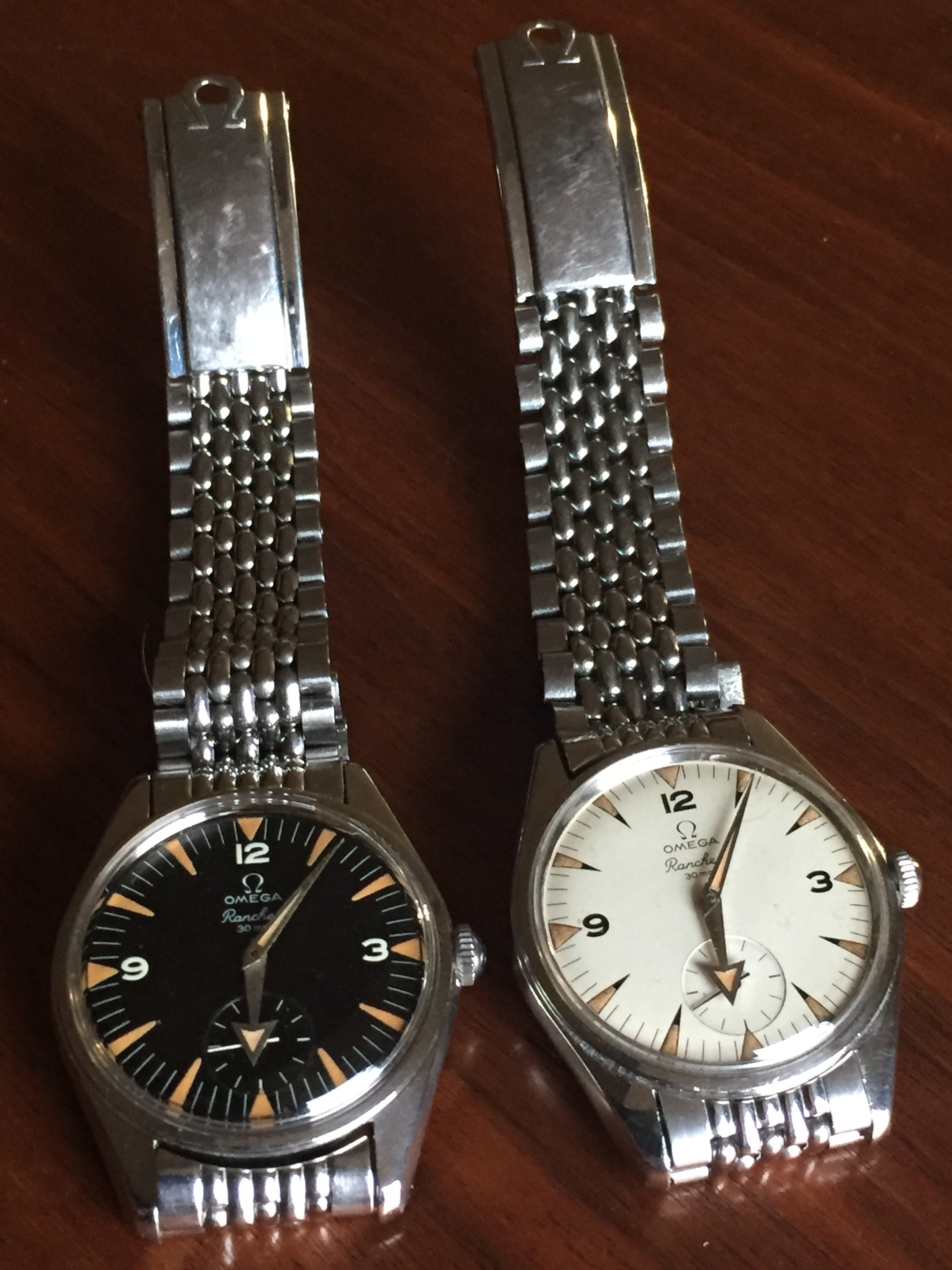

new here with my new omega Ranchero, near pristine
5,861
16,791
I defenitly see the difference in the subdial where markers touch the edge.

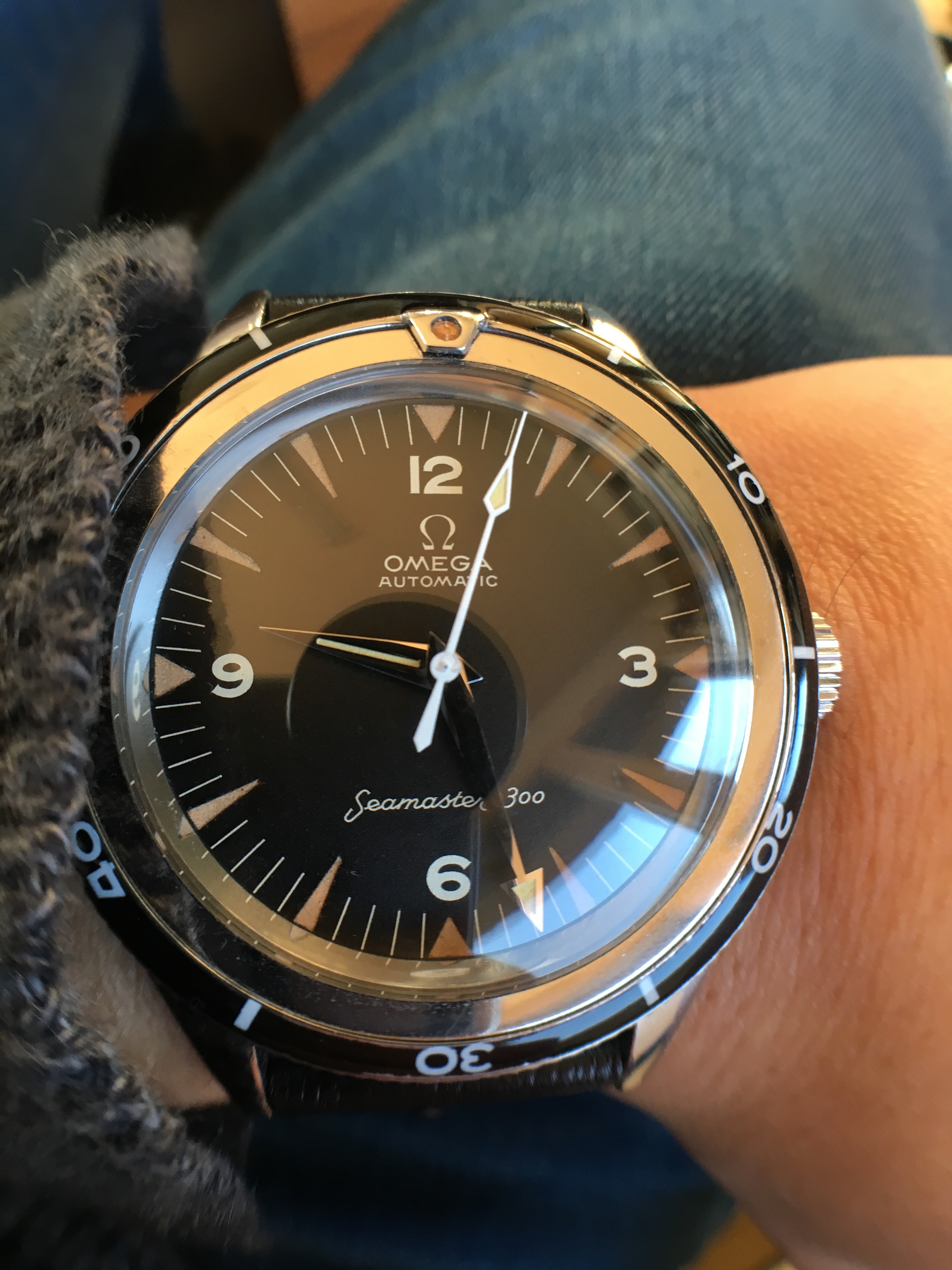

how about this solid gold sea master 300 unique franken watch

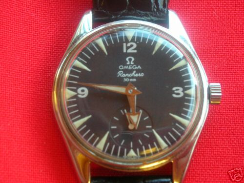

Hello everyone, I'm not the expert. I'm looking at the photos from cell phone and I see that the dial is repainted. First of all the dial has a different color than original Ranchero. To the right of the Omega symbol there is a scratch. It looks exactly like in the repainted dials, not like on originals. Ranchero 30mm was printed from a bad made cliche.
In addition, the dial has a very thick lacquer layer, which is not usual for this type of dial. Look how the lacquer cracked at the bottom of the dial.
My opinion is that the dial was redone many years ago. It'a a good repaint exept "Ranchero 30 mm "

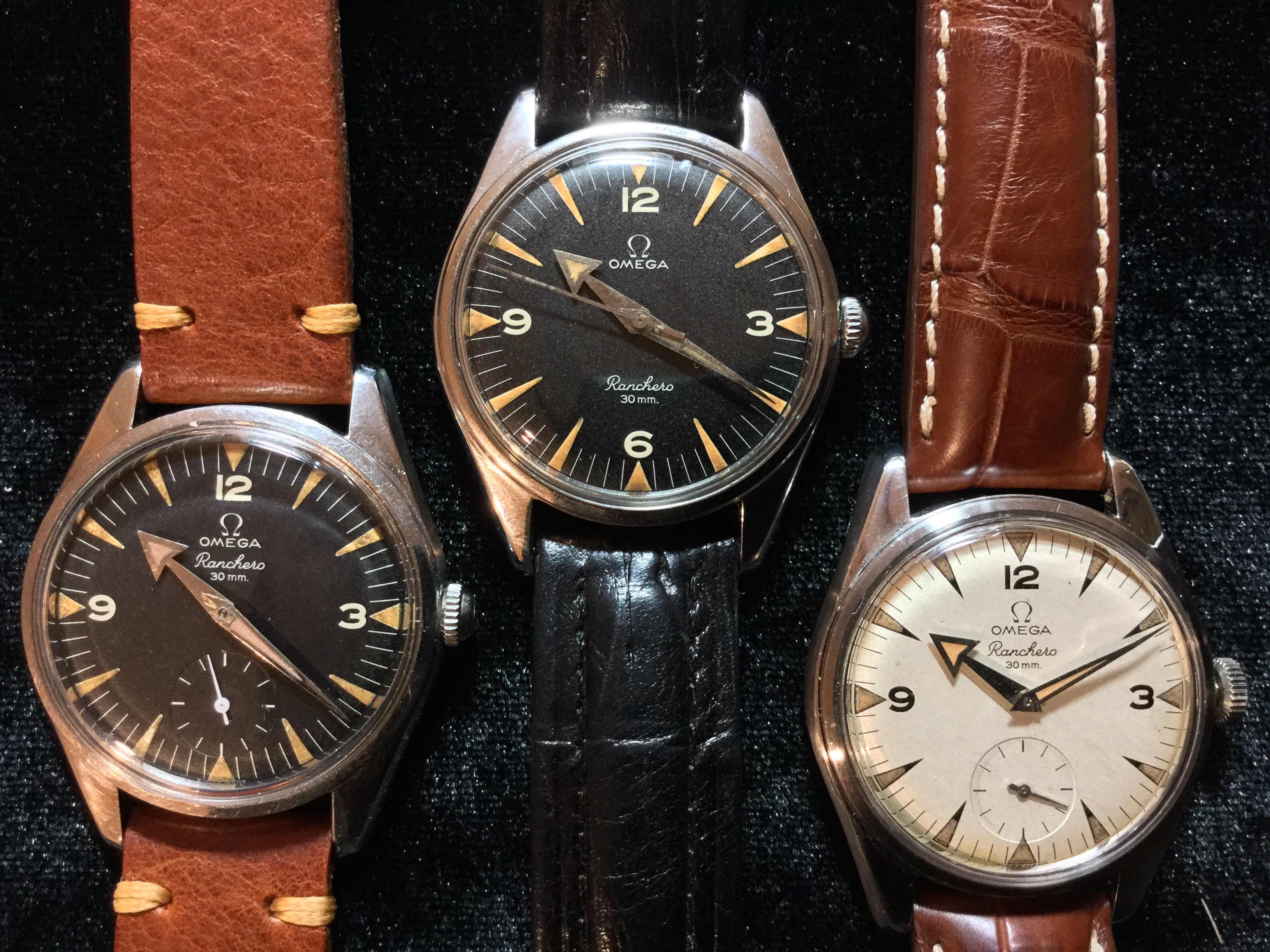

i am sorry but i think your ranchero is redone . I have checked with antiquorum catalogs no " swiss made " on the dial eighter.
The dial in this book seems to be repainted. Or am I wrong?

That thing is killer! I didn't event know omega made it in gold...But you did you mention it was a fanken watch? How so?

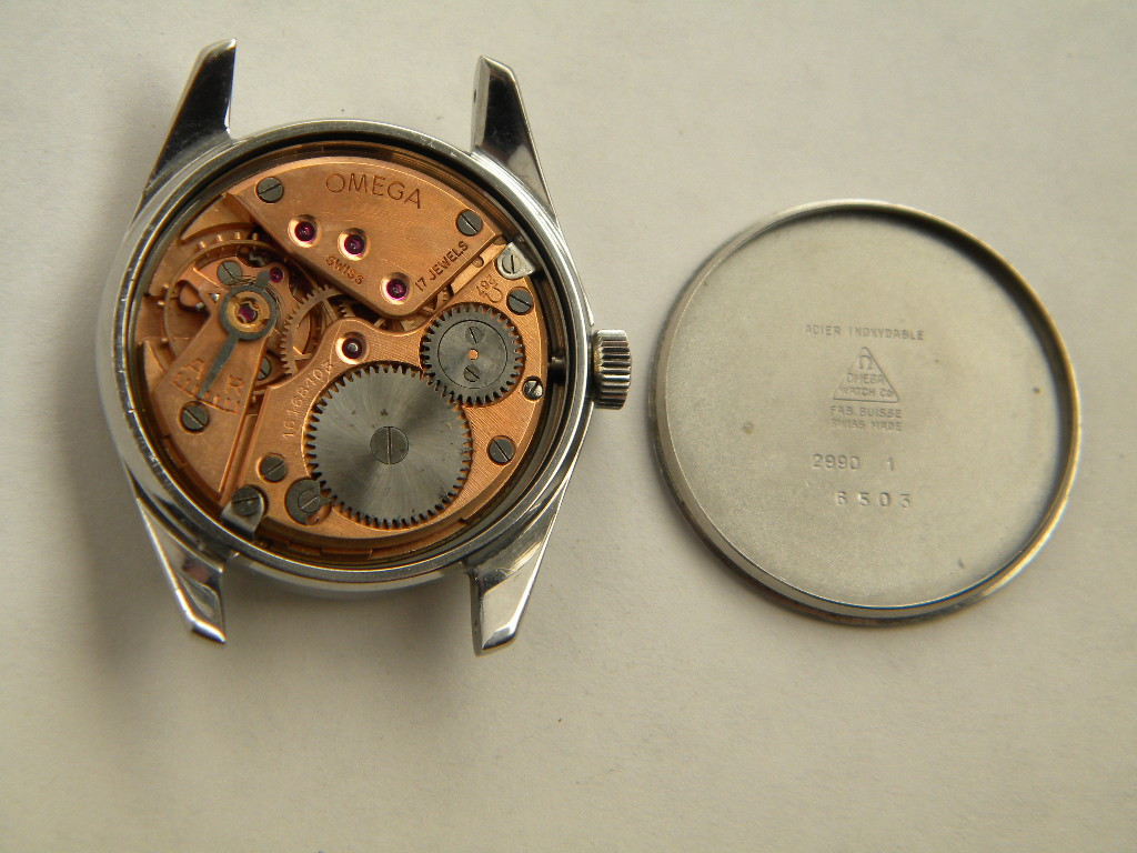

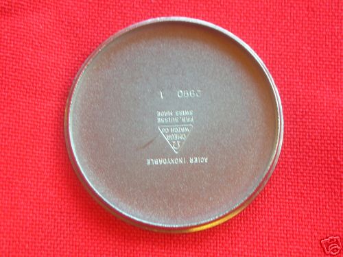

I have never seen 6503 stamped in the caseback on any of the 2990-1 I have seen.

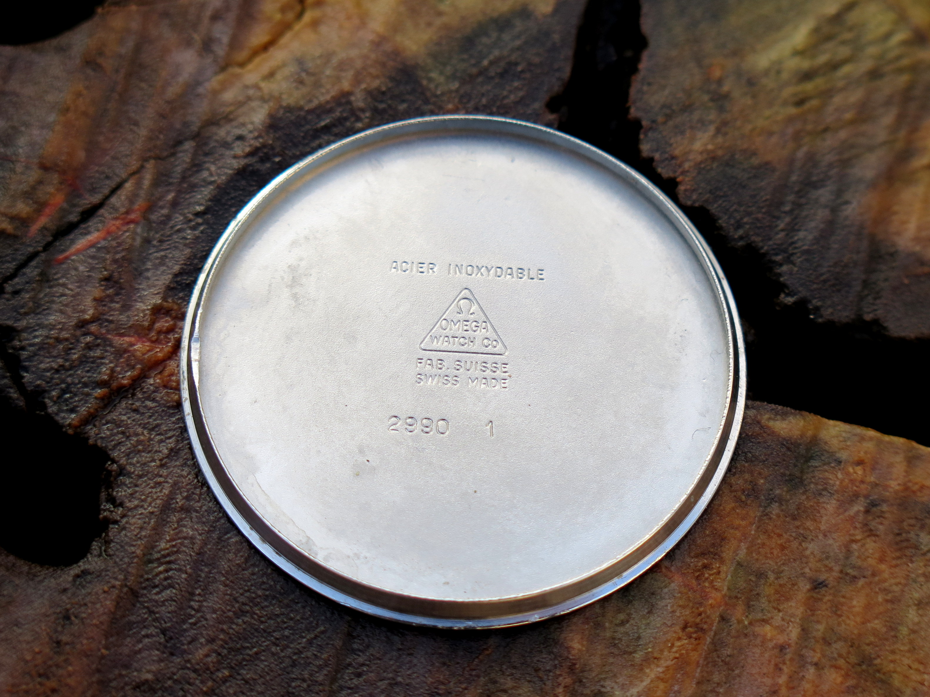

Normally they look like this:

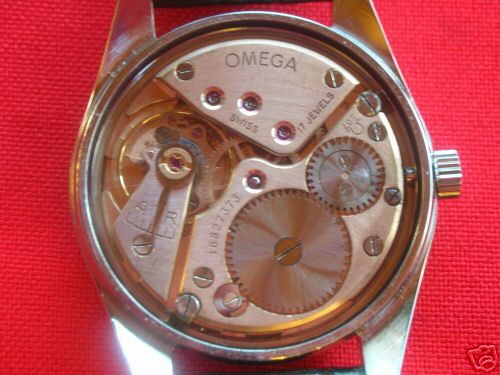

I recently found these photos on an old laptop, so let me share my Ranchero hunting tale from a decade ago...
I decided I loved the look of the SM300s and Railmasters but couldn't afford those at those lofty 2006 market prices 🤦, so I started to learn what I could about Rancheros. It took me a good year of "research" - there was a collector who had a webpage on Rancheros that I can no longer find. I studied his page, Timezone, the Omega forum on Chronocentric (anyone remember that thing existing?) and several other references. I didn't have as many trusted contacts in those days as I do now, so it was basically me trusting what I saw there and comparing to the examples that came up for sale. Finally I pulled the trigger on an eBay auction, and won this for $700:
Ugh. I determined it to be a redial within about 3 seconds of holding it, but I don't know how I determined it was worthy of a bid in the first place???🤦
I spent a good year looking for an original dial, with no luck. So back on eBay it went, where I clearly described it as a redial.
Now between the time I overpaid for this lemon and put it back for sale, the Omegamania auction happened, and prices for Rancheros and many other vintage Omegas spiked. The winning bidder of this gem paid me like $1,300. 🤦 Not proud that I profited off of this watch, but just pointing out that it was only very fortunate timing that saved me from losing money on a bad example. I was frightened off of vintage watches for several years since I felt burned even after I had spent months of what I thought was due diligence.
So do your research, but even that will get you only so far. Ask here first. I think if OF existed then I wouldn't have made this mistake.👍
