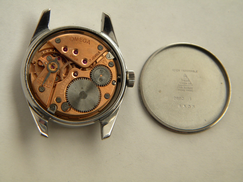

    this watch has lay in a drawer for half a century without use . enjoy

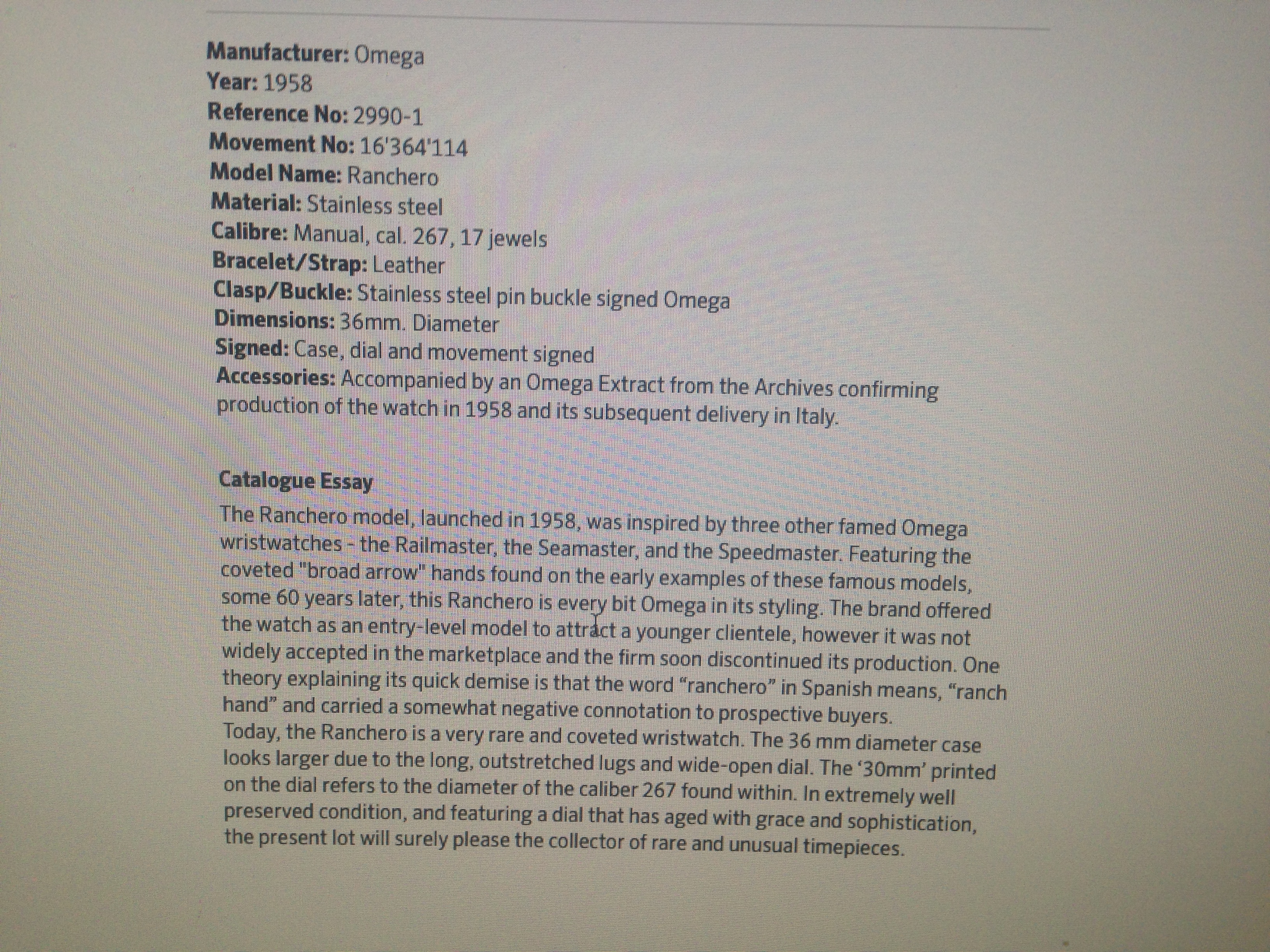

  4. gatorcpa ΩF InvestiGator Staff Member Jun 1, 2017
    12,204
    15,718

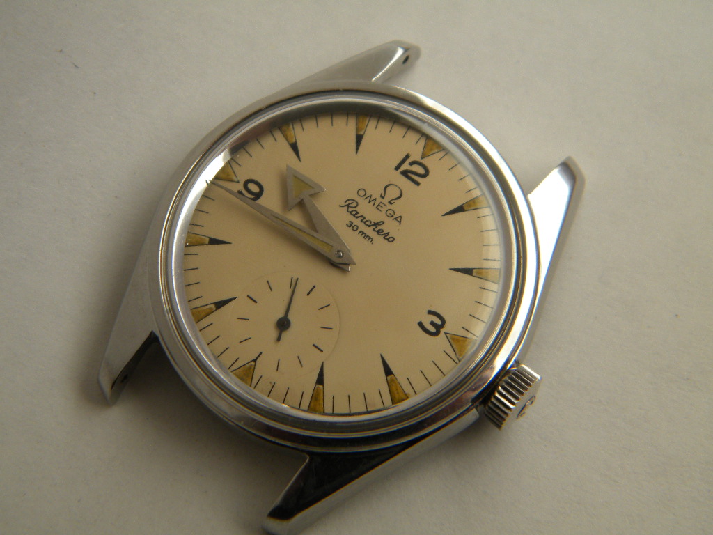

    I have questions about the dial, specifically the printing on the subdial. Here is an example that I know to have an original dial.
    [​IMG]
    Note the following:
    1. The sharpness of the indent for the subdial.
    2. The seconds register markings. Nice and even, out to the edge of the subdial.
    3. The location of "Swiss Made" at the bottom of the dial.

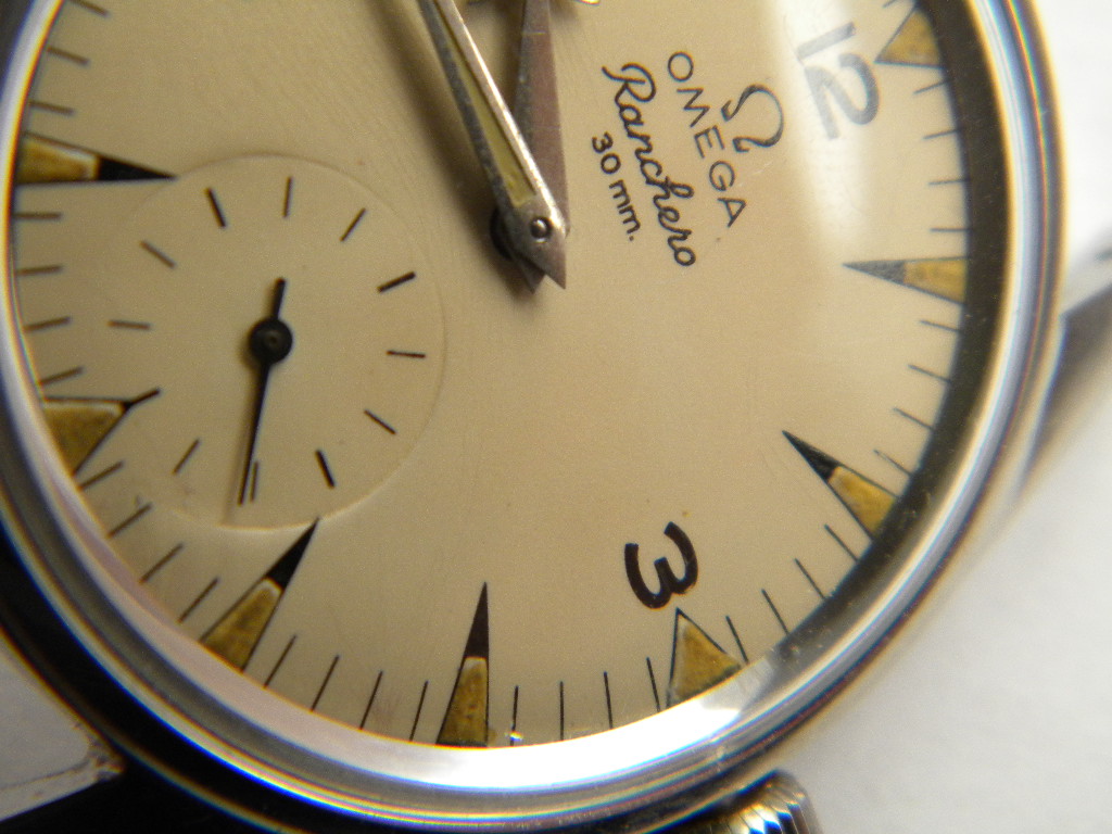

    Here is one of the OP's pictures
    [​IMG]
    See the differences? ;)

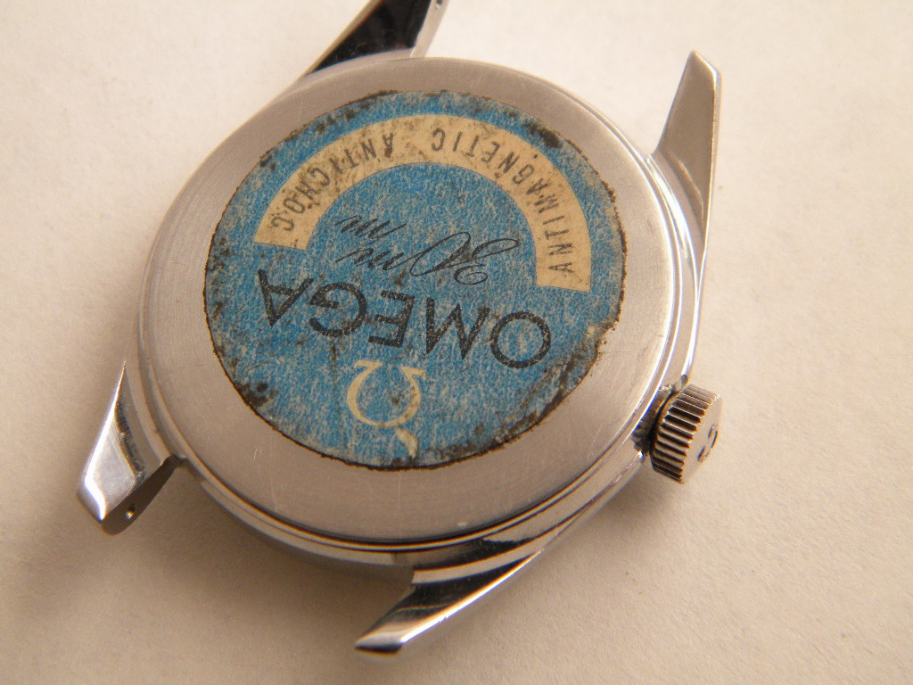

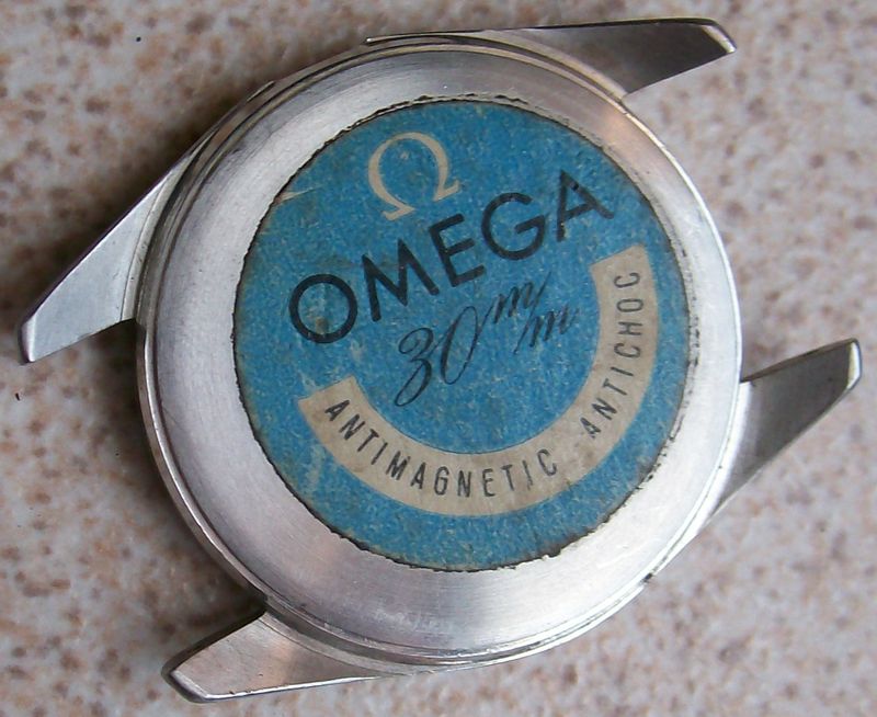

    It could be that the back is a NOS replacement. I've seen a couple of those over the years with the sticker.

    Is it normal to see the ink sitting thick on top of the letters? I can see it in OP's photo. Is that normal or a sign of redial?

    Interesting....I also note the 5 & 7 markers intersecting with the sub-dial too ?
    Best - Neil

    Hmmmm.
    I see red flags I'm sorry to say.
    Please show me another white dial Ranchero
    with the subseconds dial that has hour hashes
    that far away from the subdial edge.
    There are other red flags I see also.

    is the ranchero i ever bought besides what is the point of selling a dial would cost 150 dollar i paid less for it.
  9. pitpro Likes the game. Jun 1, 2017
    3,073
    3,552
    that's another
  10. pitpro Likes the game. Jun 1, 2017
    3,073
    3,552
    Ranchero and 30mm printing too heavy
  11. pitpro Likes the game. Jun 1, 2017
    3,073
    3,552
    off ebay a few years ago
    gemini4, flame and kreyke like this.

    The "G" in Omega is wrong too.
    Fakers never get it right

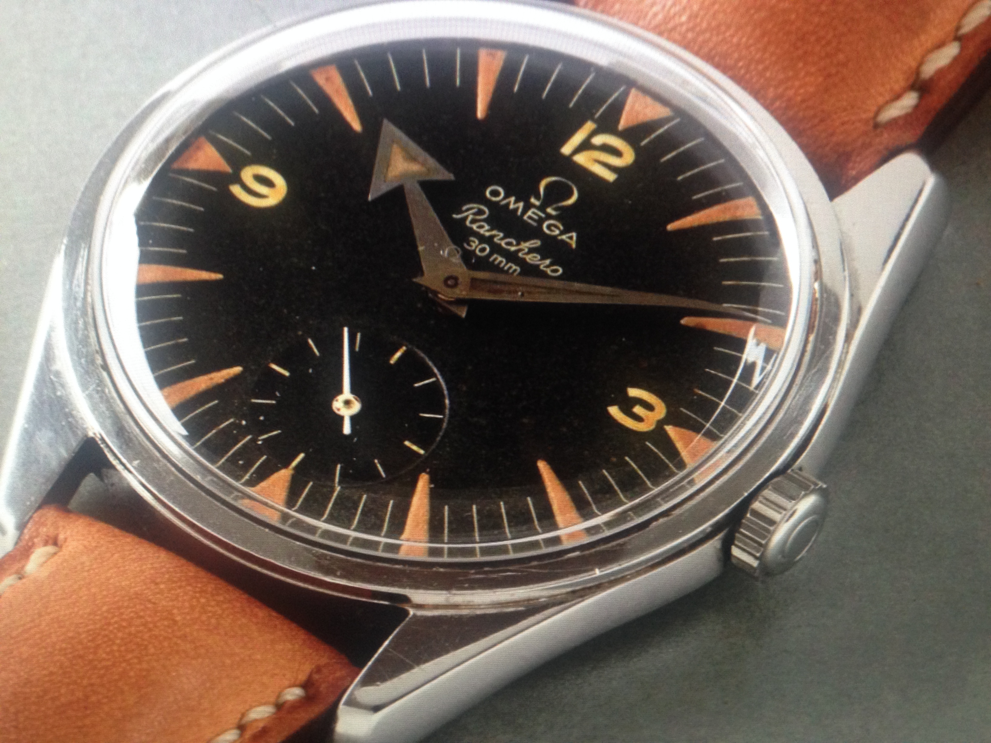

    i am sorry but i think your ranchero is redone . I have checked with antiquorum catalogs no " swiss made " on the dial eighter.

    Compare apples to apples please.
    SHOW US ANOTHER RANCHERO WITH THE HOUR HASHES
    THAT FAR AWAY FROM THE EDGE AND THE 5&7 HOUR MARKERS
    HITTING THE SUBDIAL EDGE. Please

    phillips auctions with extract of the archives , note different crown . note no swiss made on the dial

    The OP's dial is redone/aftermarket
    The crown is wrong (if it was a NOS watch why put a wrong crown on?)
    It is easy to se the difference compared to and original dial just look at the subdial and the 5
    and 7 hour index the length and how they are placed to the subdial.
