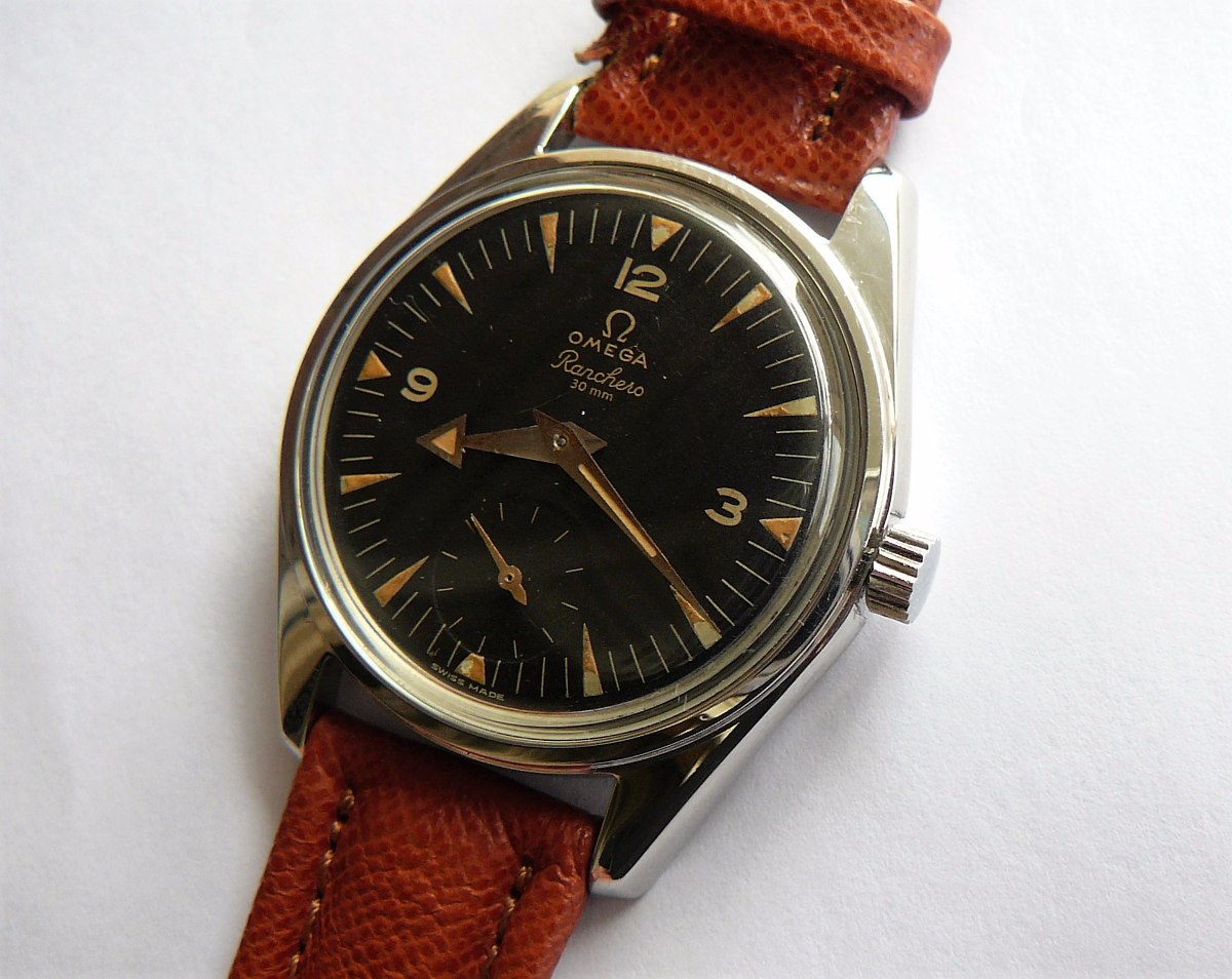

new here with my new omega Ranchero, near pristine

phillips auctions with extract of the archives , note different crown . note no swiss made on the dial
That one has a replacement crown, too, but a different one. The one in the OP is a typical replacement crown, available today. The correct type of crown is a bowlerhat style crown, as can be seen on the other examples provided by tdn-dk and others in this thread. It is common on fifties 30mm Omegas...
And that photo from Phillips is worthless, as "swiss made" would be obscured by the rim of the case, when taken from that angle. Notice how it has almost disappeared from tdn-dk's in his photo?

i see your point about the subdial , some examples on the net show subdials which touch the register.
Anyway I am happy i just buy an original dial , still a great bargain for less the 150 dollars.

I did some googleling it appears that some black dials touch the subregister , but i do note that the markers in the subdial don't touch the edge.
I also checked some auction catalogs not all Ranchero dials have swiss made on them . why would that be ?
i just don't get why some family would sell me a watch for 150 dollars, which according to yourselves is redone.

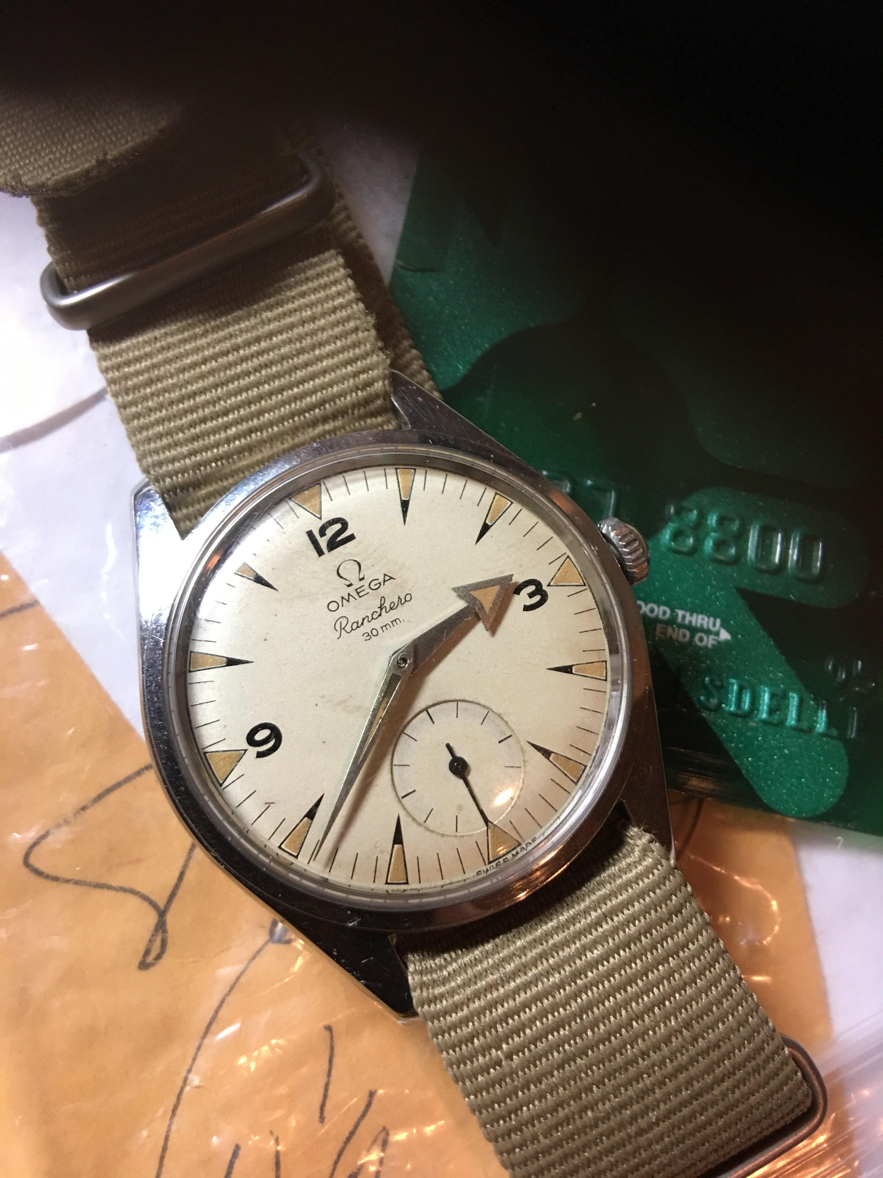

This is mine, so we can compare.
I defenitly see the difference in the subdial where markers touch the edge.

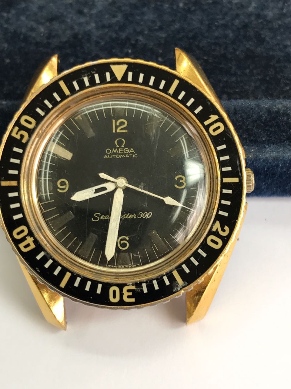

how about this solid gold sea master 300 unique franken watch
the markers are of radium ? and also there is sort of greenish stain on the dial is that because radium affected the dial ?
