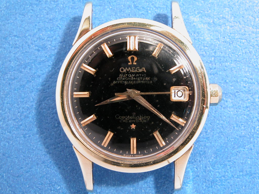

Hi,
I don't think so, dial is OK IMO (despite that I don't know about the "Calendar" question)
Desmond wrote:
"Looks reasonable. Some work done to the movement by the looks of it."
IMHO I have not come across cal.504 Connies without "CALENDAR" script.
1,921
2,659
Hi!
I don't have so much knowledge about this early constellations...
I just wanted to tell that IMO the dial that is actually on the watch is legit itself..
Maybe they took it from another reference watch and so it is wrong on this reference. 馃榾

Hi!
What did you base your opinion on?
A few signs to the contrary:
The letterings under the logo are not centered.
The whole dial is too clean for the watch, with messy green lume to boot.
There's no dial from any non-504 constellation models that would fit on cal 504, unless it's glued to the movement.
1,921
2,659
Hi,
thank you very much for your comment to my post.
I based my opinion mainly on the quality of the lettering (T-Bars and, I Dot of "Constellation", Boxed A in Automatic)
and a passed MOY test.
To be honest I did not pay attention to the question of centration of Logo and text :-(
As there are only pictures taken with an angle I'm still not 100% shure about that.
I agree that the dial is by far cleaner than you would expect at this age.
I don't no anything about the possiblities of exchanging a dial between 504 and other models.
I would like to thank you again for discussing this with me so I can pay attention to more points in the future.
I'm aware of the fact that I still have to learn a lot 馃榾
