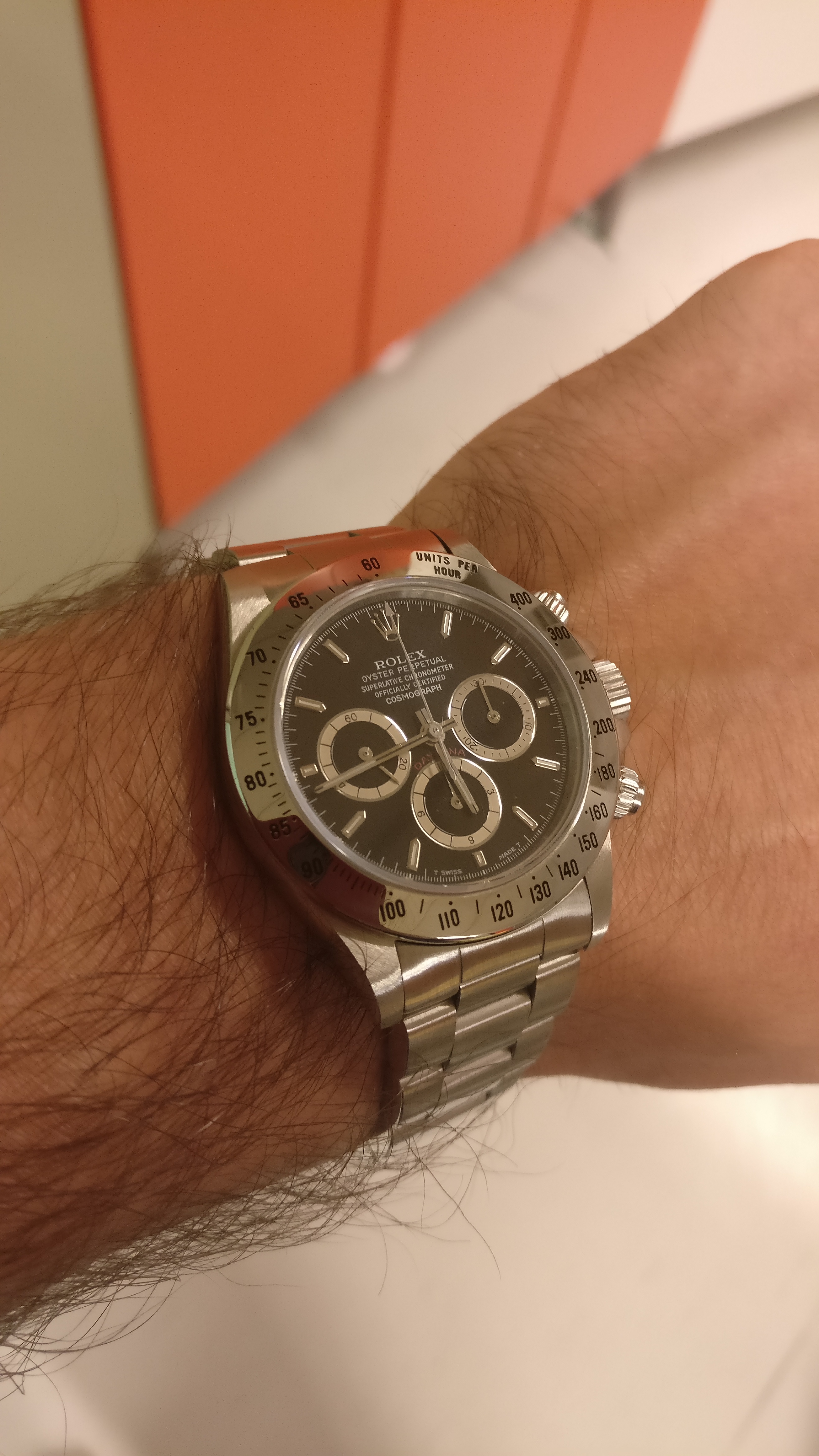

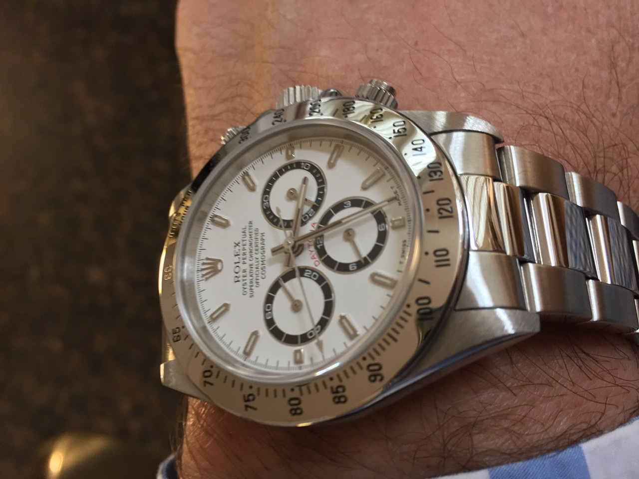

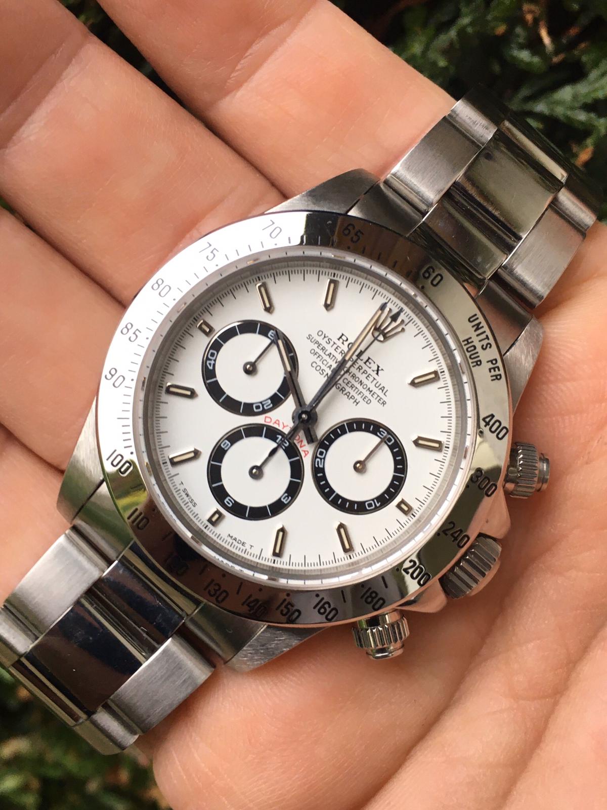

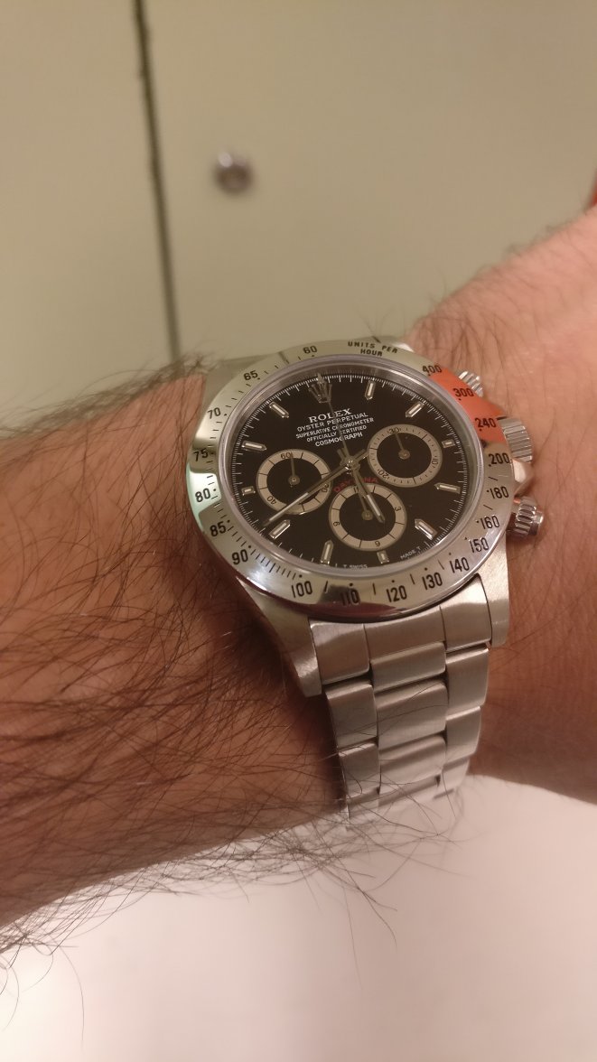

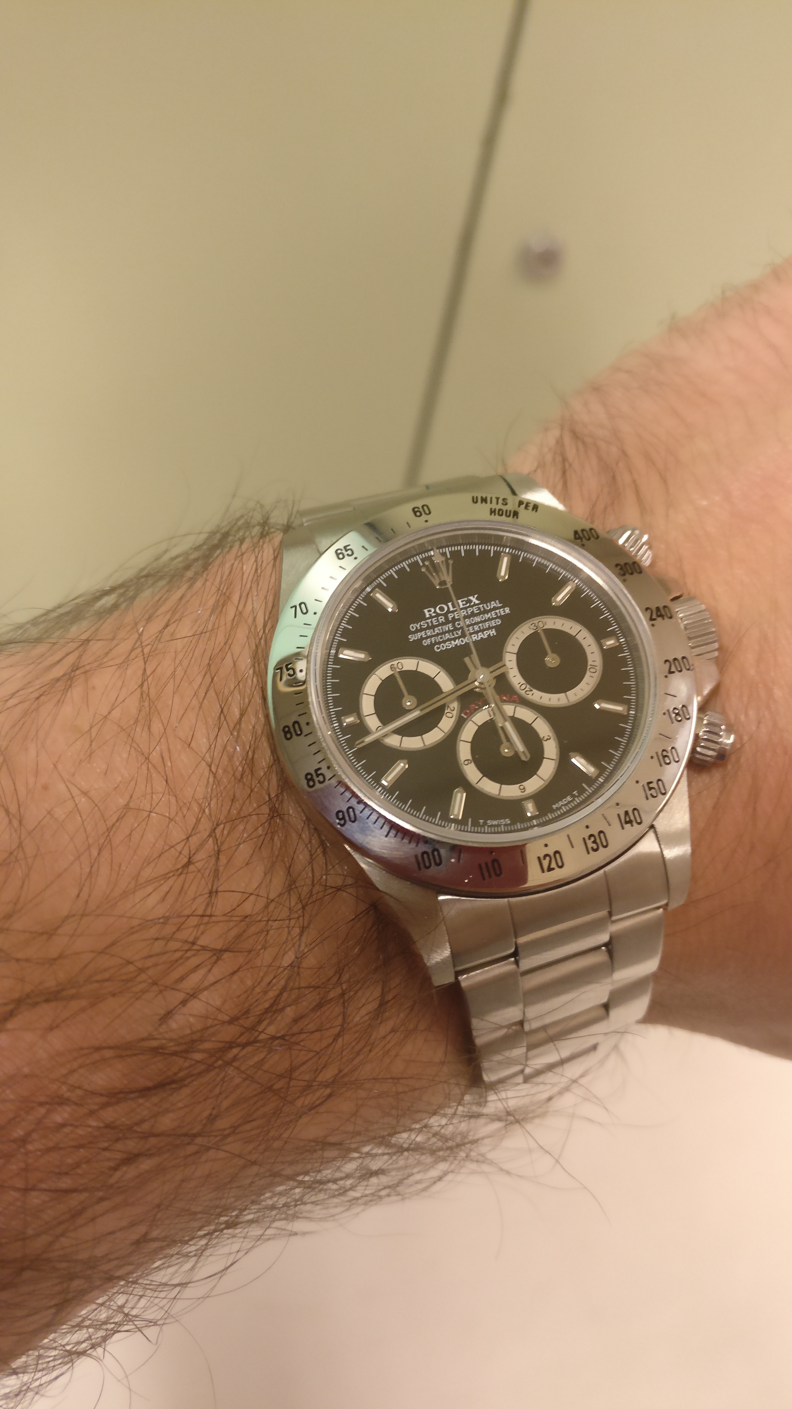

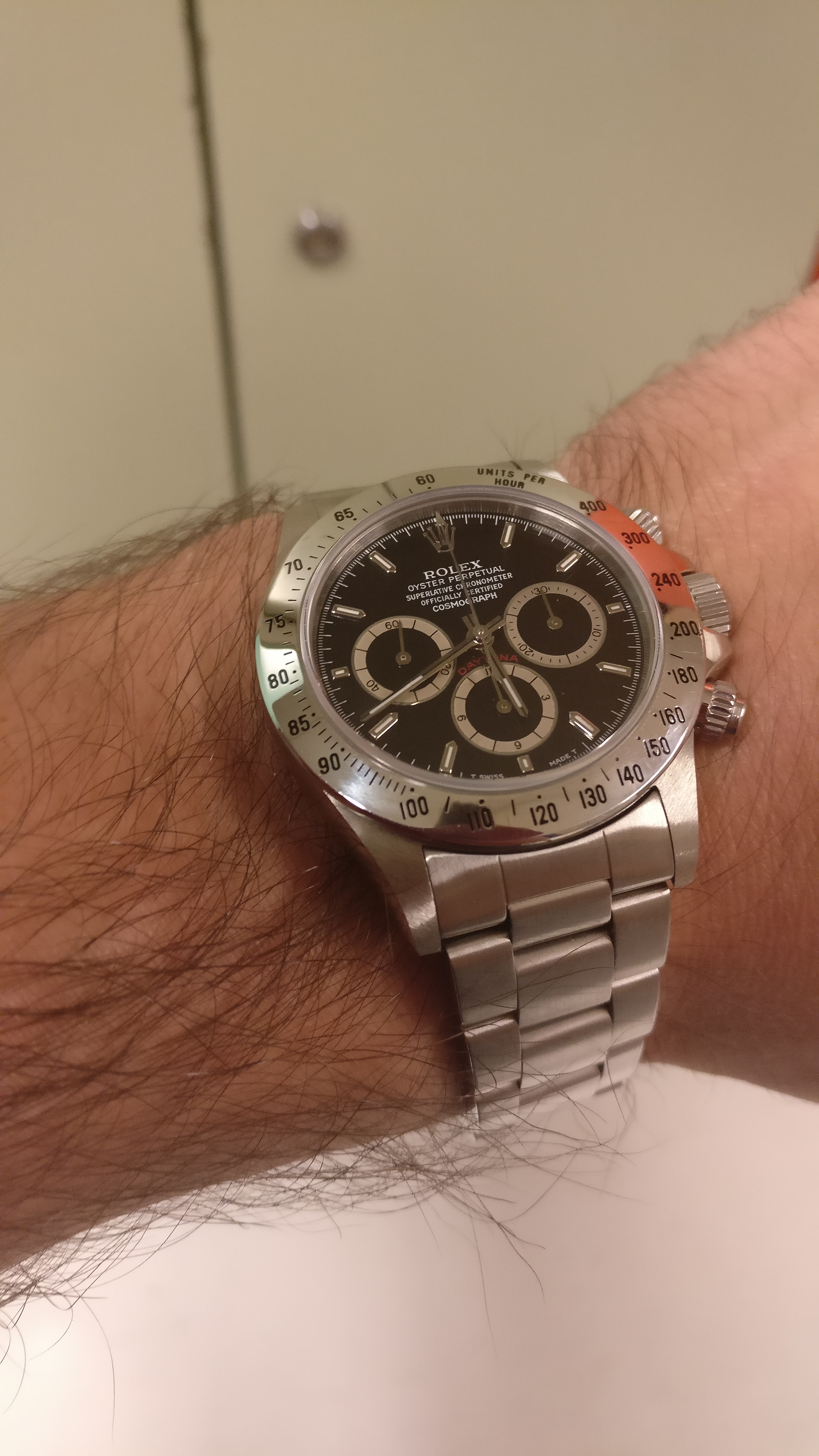

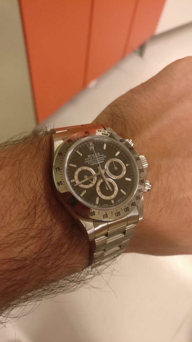

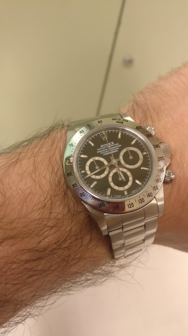

After a somewhat arduous search and one slight overreaction on my part 🙄 I have found a new addition to my collection.
Enough with the chitchat, on to the photos:

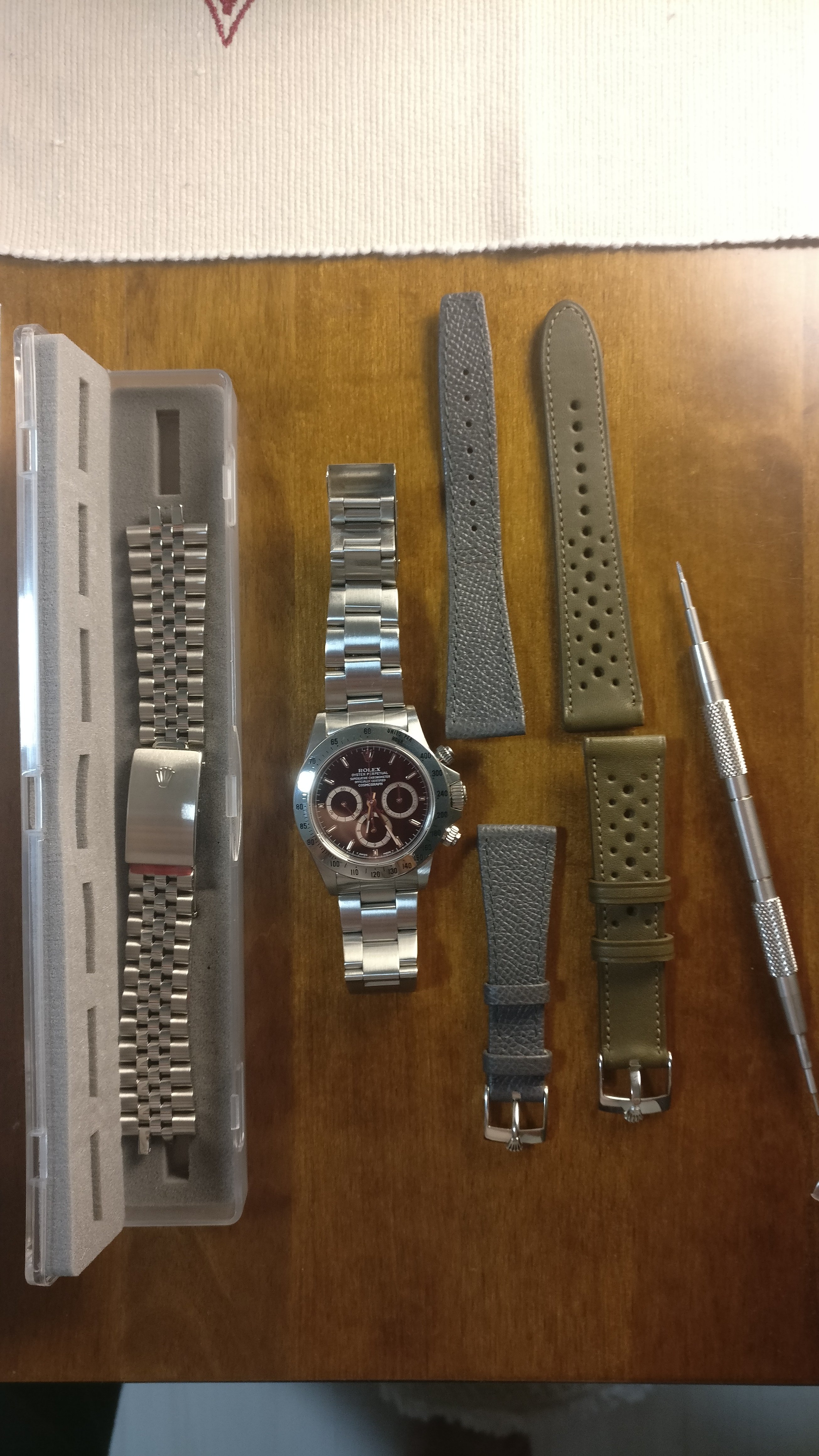

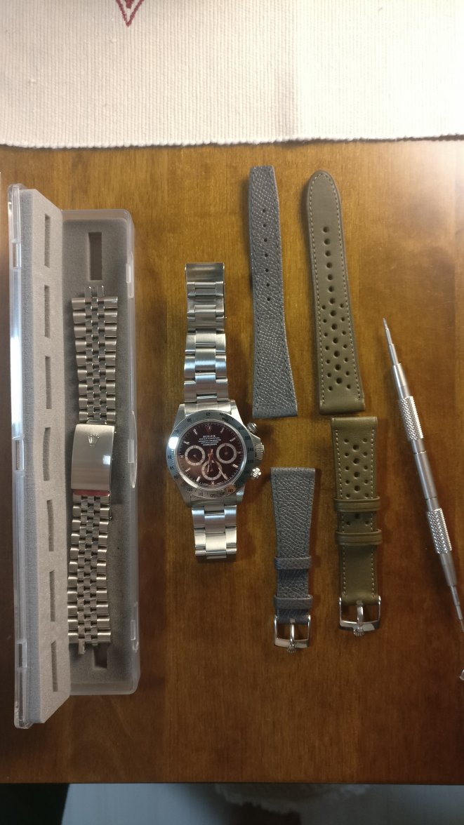

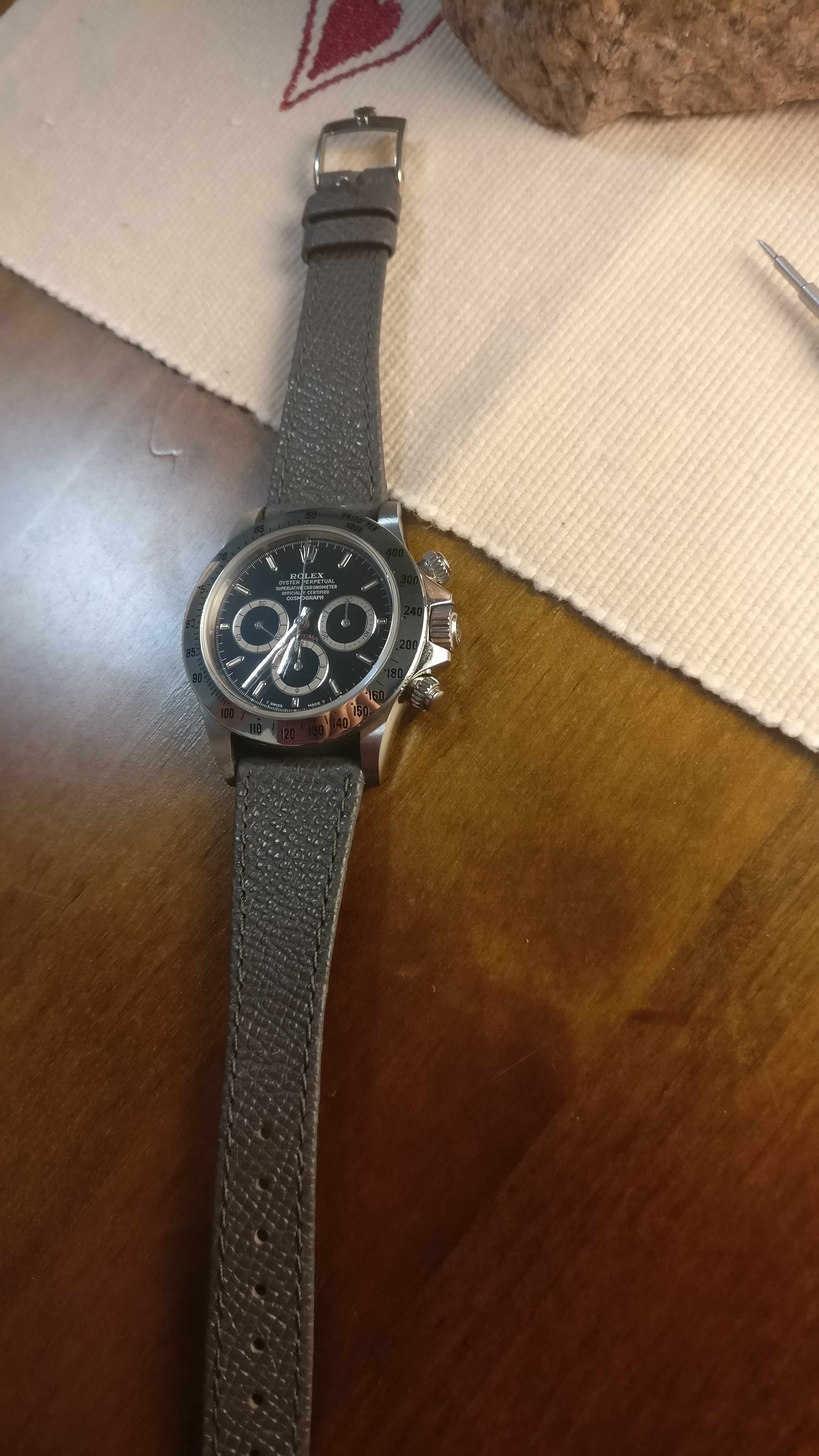

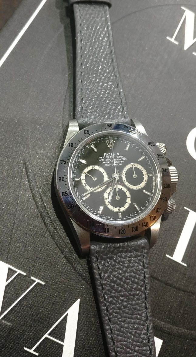

For keeping it fresh I purchased a 62150H Jubilee and a couple of Joseph Bonnie straps to go with it.
Tested power reserve ~53h, amplitude 285° , +6s/d (face up)

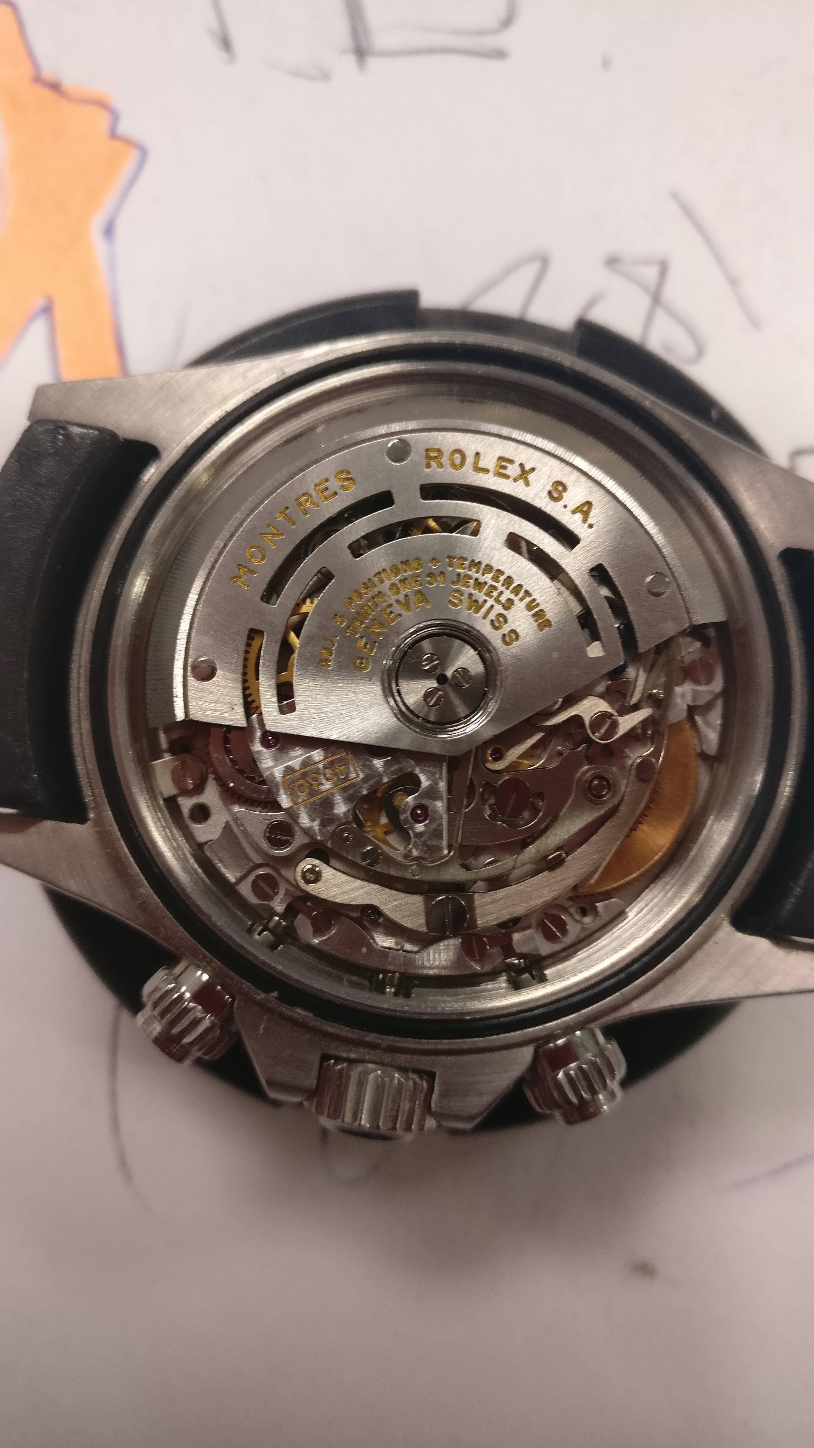

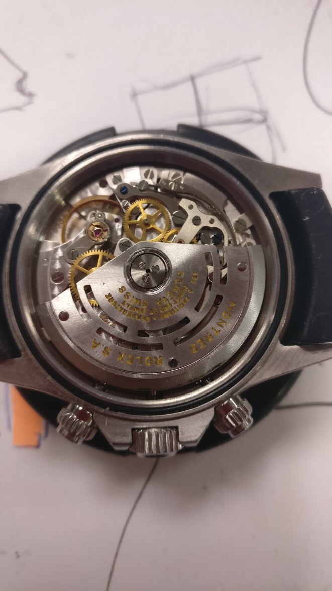

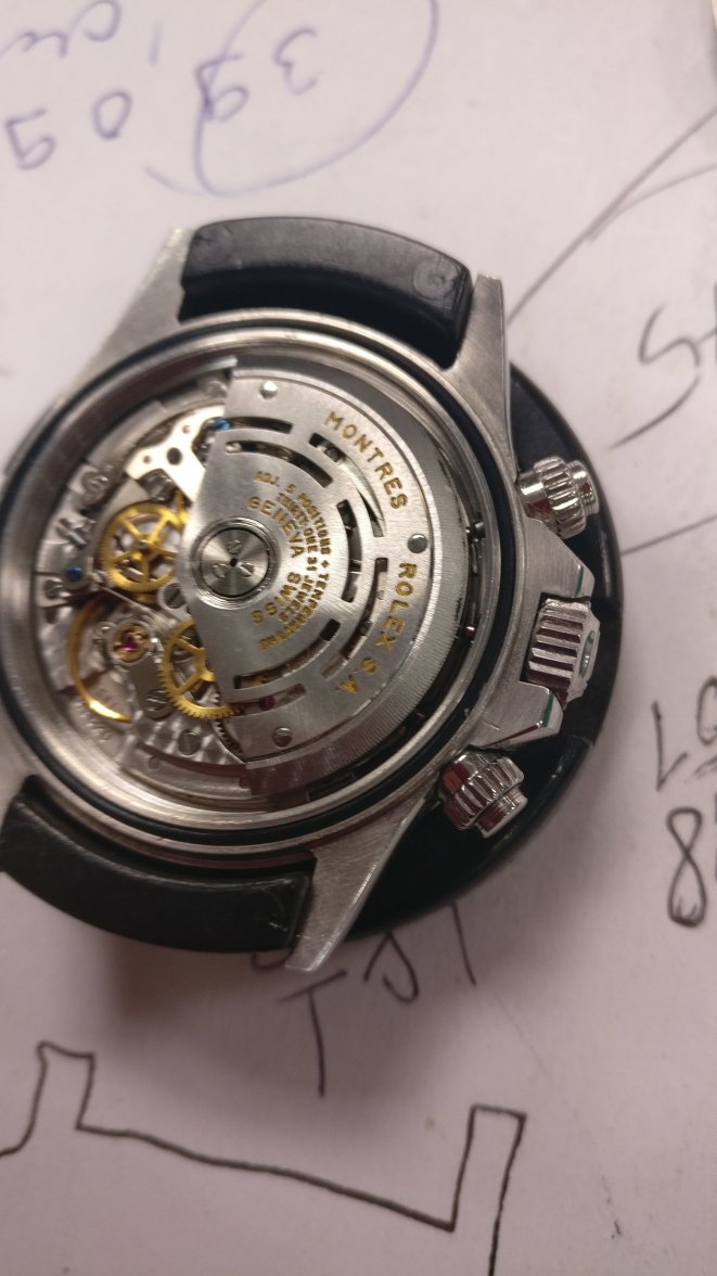

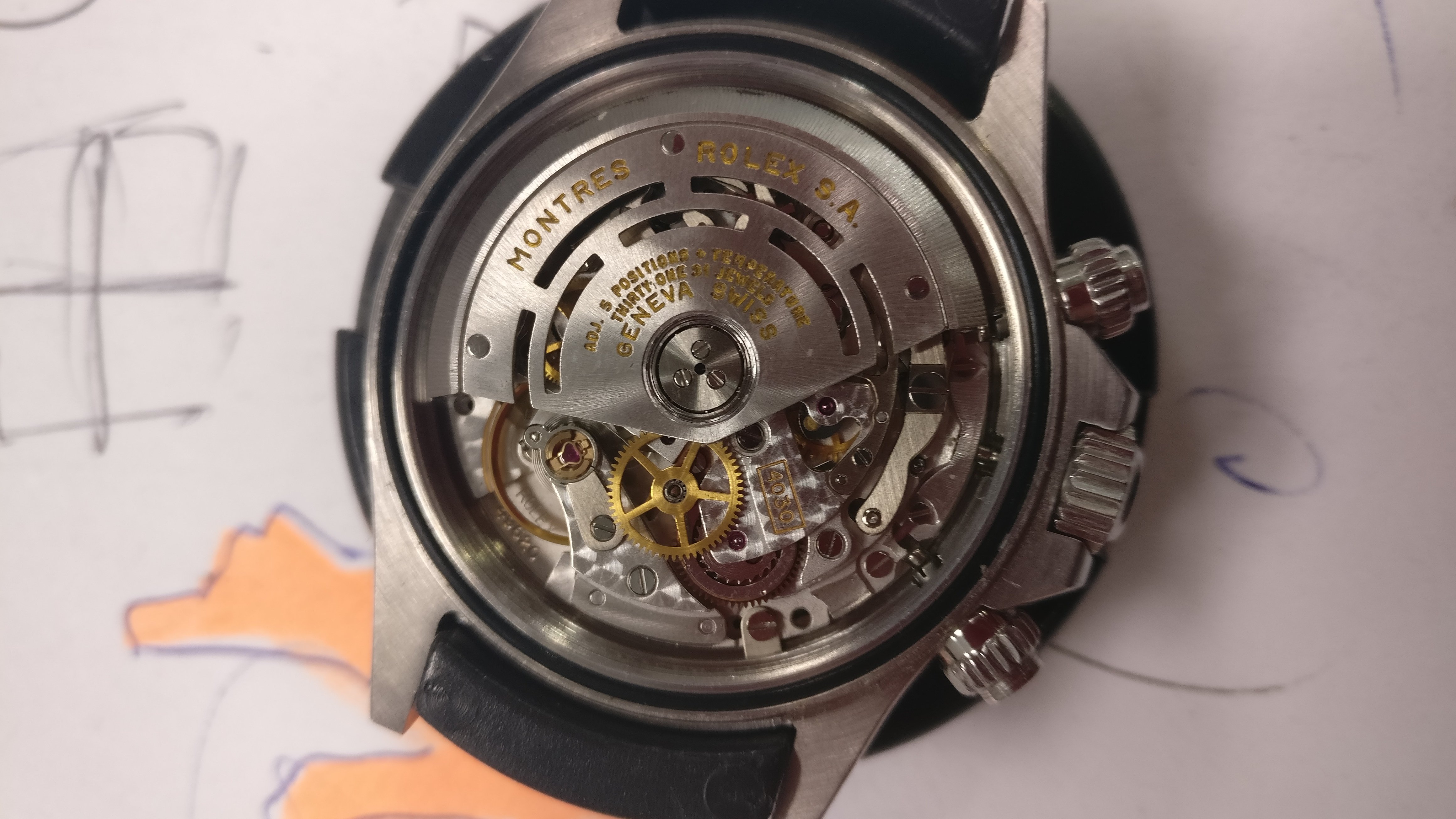

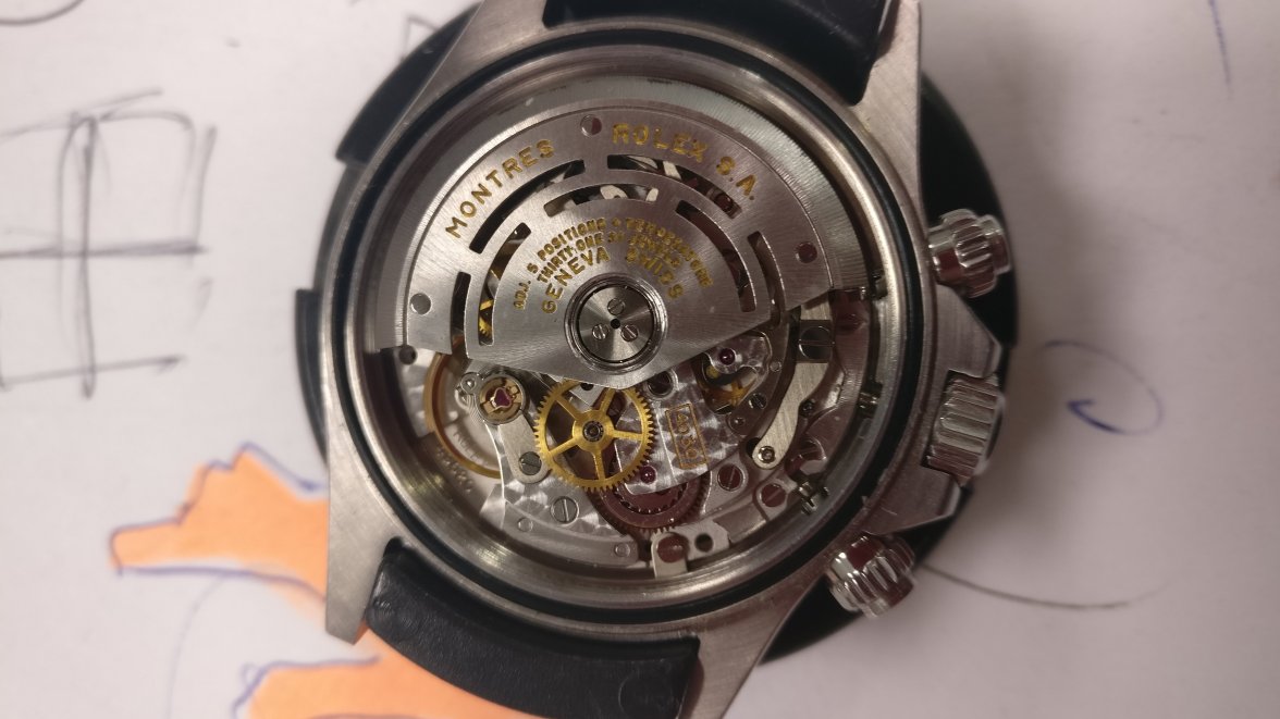

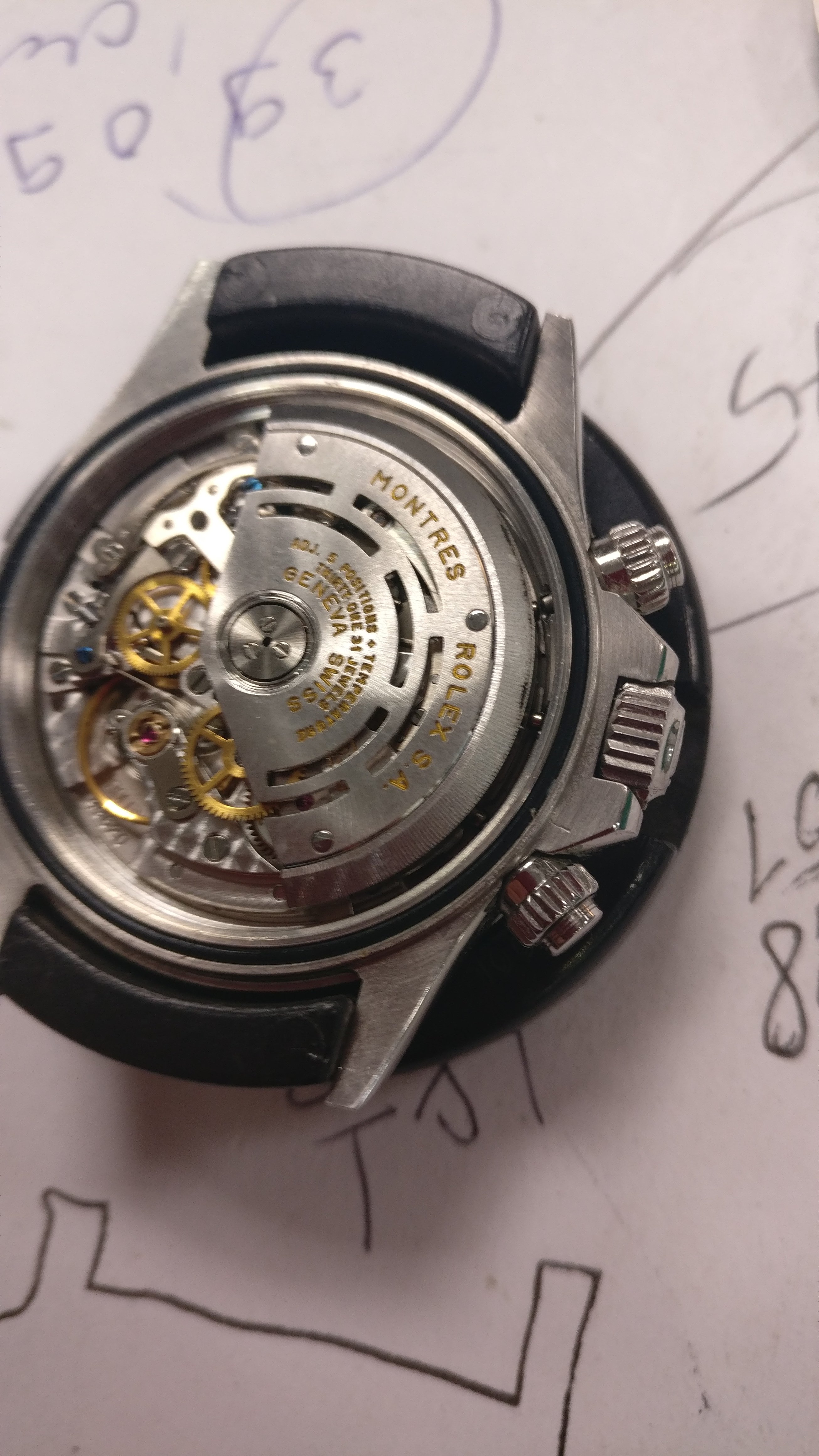

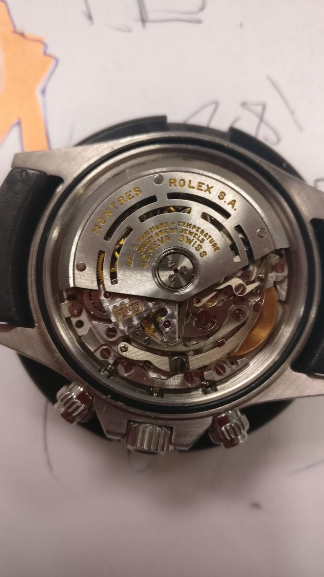

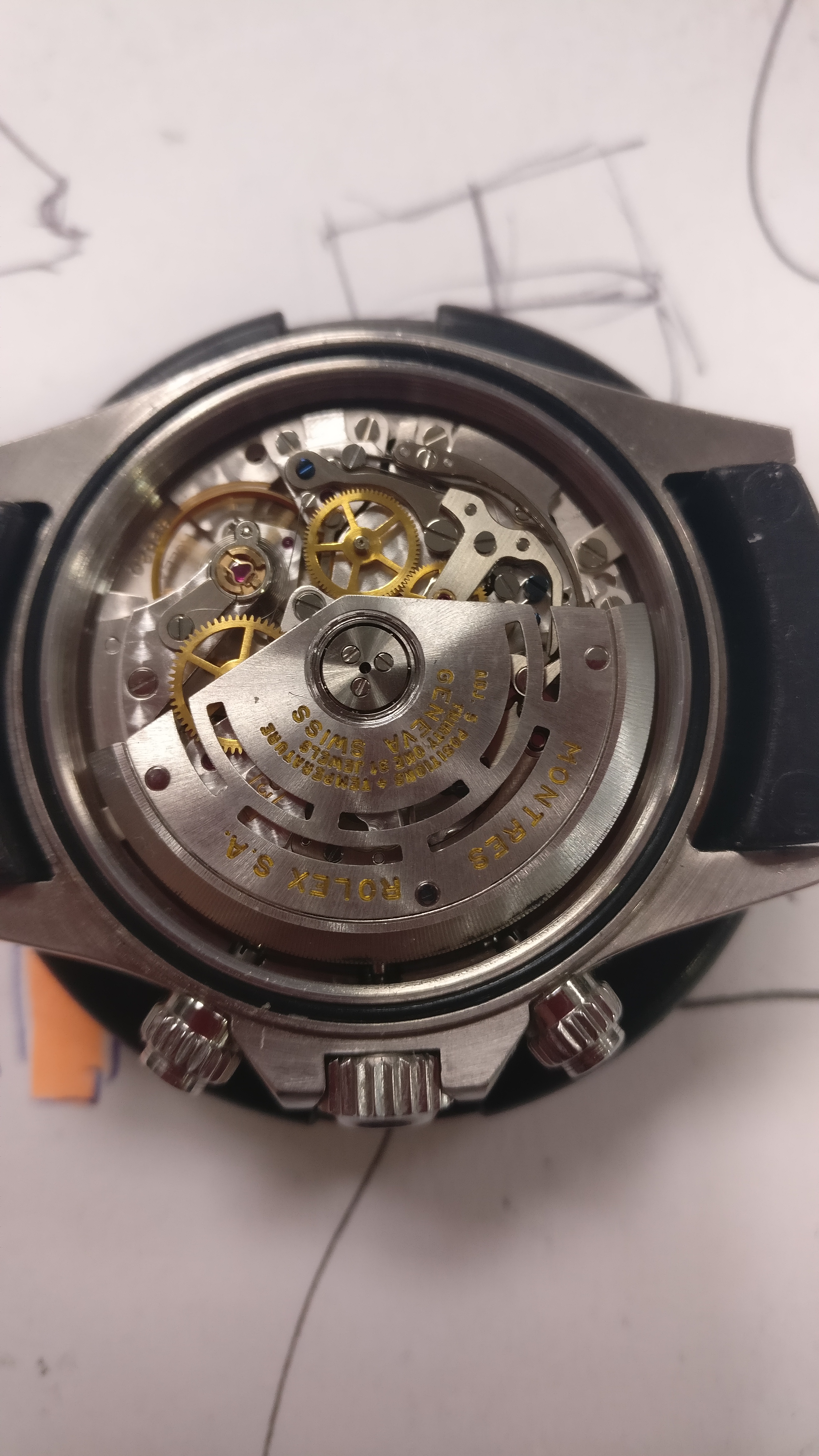

Movement shots:
And for a small question / opinion matter:

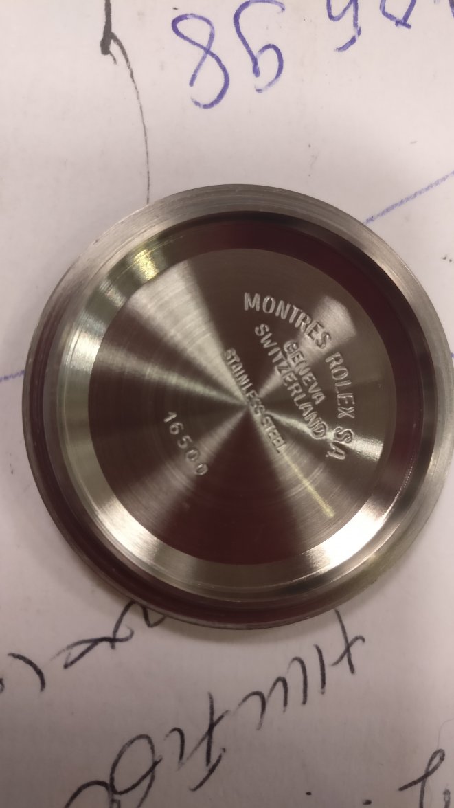

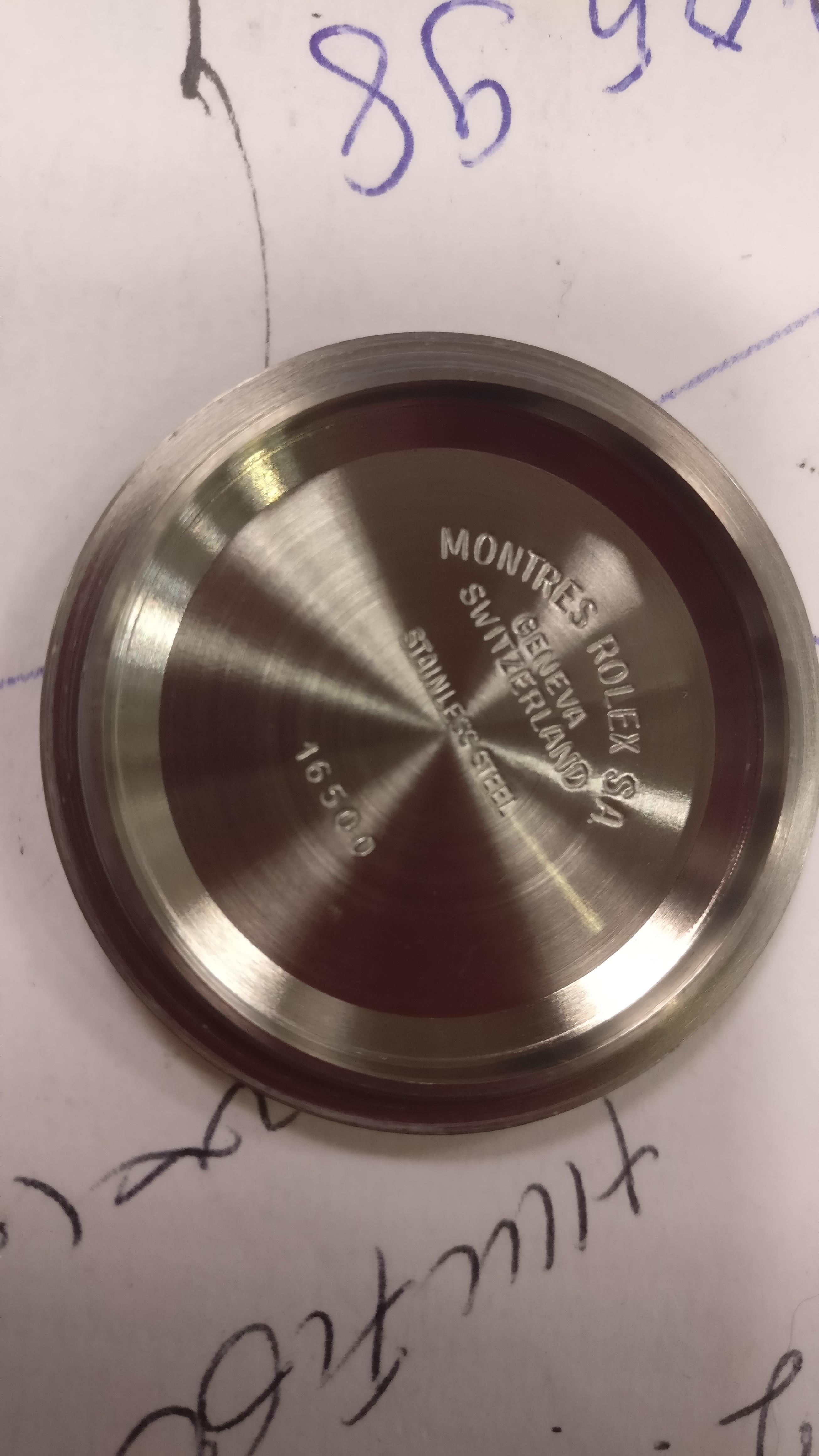

Should I take it straight to service or can I enjoy it for a little bit? 😬 The rotor has some grime on it at periferal edge and overall there seems to be a small residues on the rotor. Additionally does the inside case back show rotor rub signs at the point where there is that black/grime on the rotor? The rotor itself in my eyes doesn't exhibit other signs of damage.
All functions work good, manual winding feels a bit tight/rough though when comparing to my 1655. 😒
Tl;dr Should I take this in for immediate service or can I enjoy it for a bit? opinions /advice appreciated.

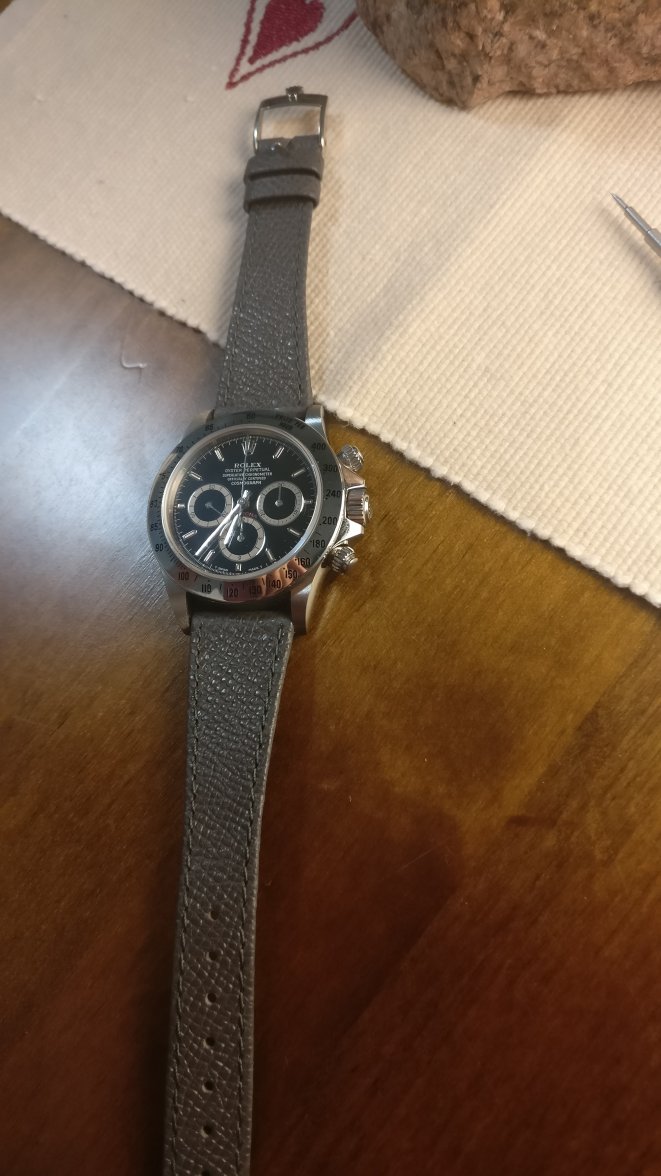

Great looking watch! Looks really nice on that grey strap.

I know to be safe many members will recommend a service...
But I never open a caseback (aside from speedys because I have the tool) and then inspect the rotor if there are residues.
If I did that, I think I will end up servicing almost every watch I have because they are all vintage...
So I would just enjoy it. But hey I'm probably gonna get rekt by members here with more technical knowledge..

Nice find! Would love to see on jubilee. As to service, I’m torn, given you can hear some rubbing.
Edit to add- I just bought an EXP II White 16570 that I could hear the “whir” of the rotor. I took it to my watchmaker who adjusted that part, added a new screw, and sent me on my way for $50. I’ll enjoy it for awhile then maybe take it in for service in a few months. Runs like a top.

Thanks for the input. I decided to wear it "sparingly" 😜 until I get it to my watchmaker for a service in about 4 weeks. He mentioned that the rough/gritty winding is probably due to wear in the automatic winding gears, or it's just dry.

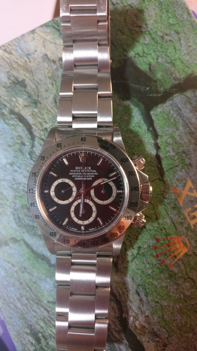

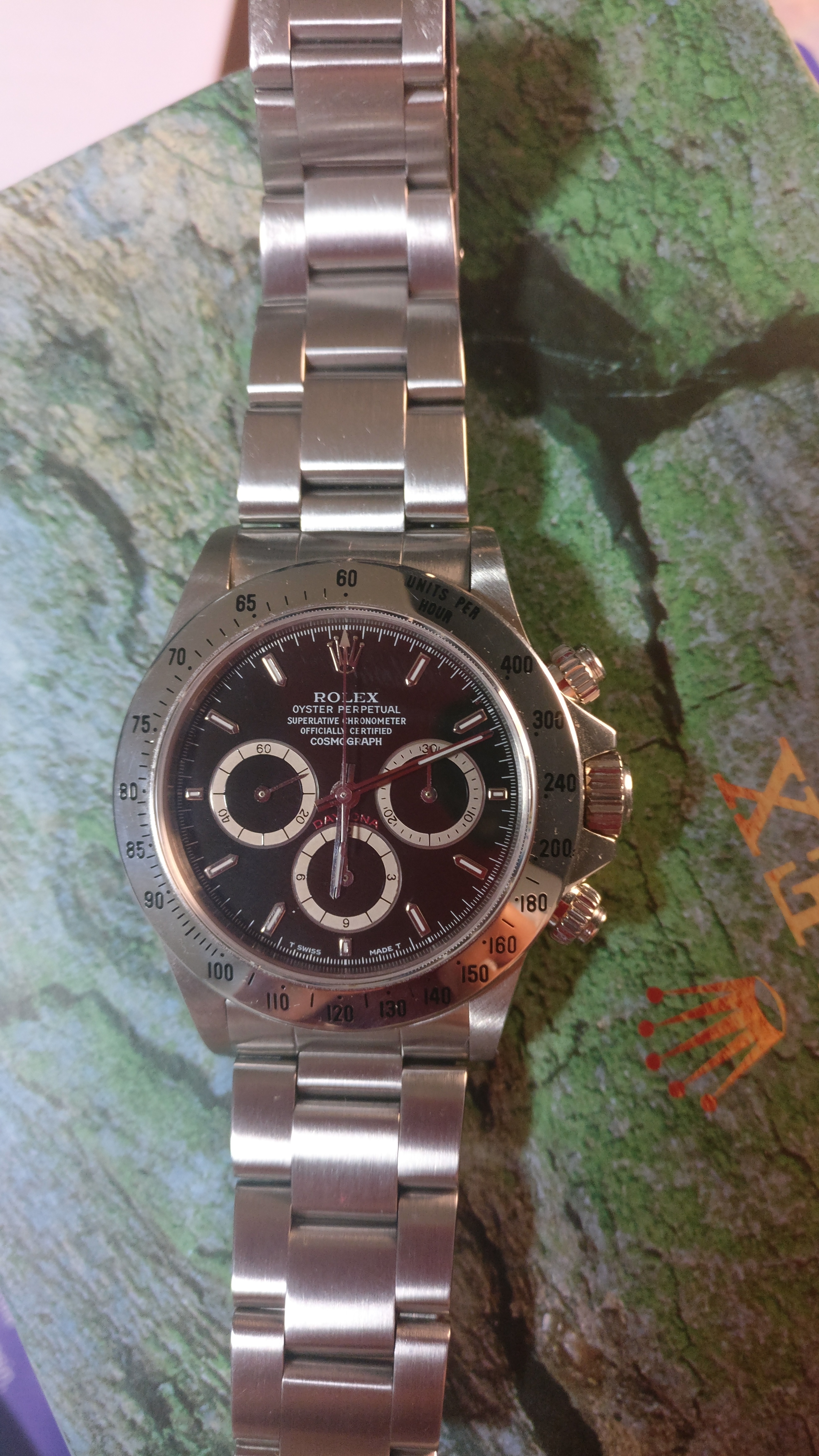

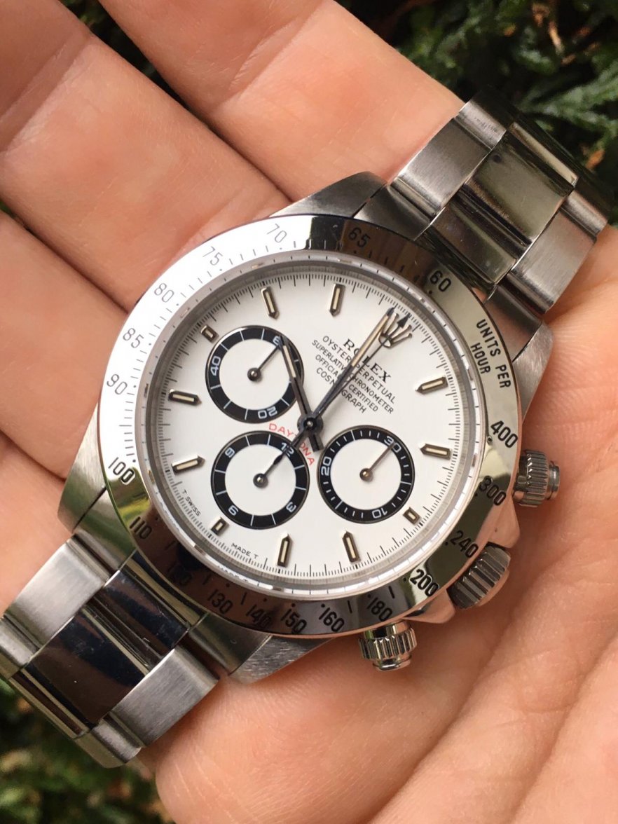

@WatchCor, I found mine ! 😀
Mint, full set.
look at this patina ! 🥰
Absolutely wonderful, massive congratulations. Magnificent tritium aging and you're clearly a league above me in watch photography. All the best to you 👍
