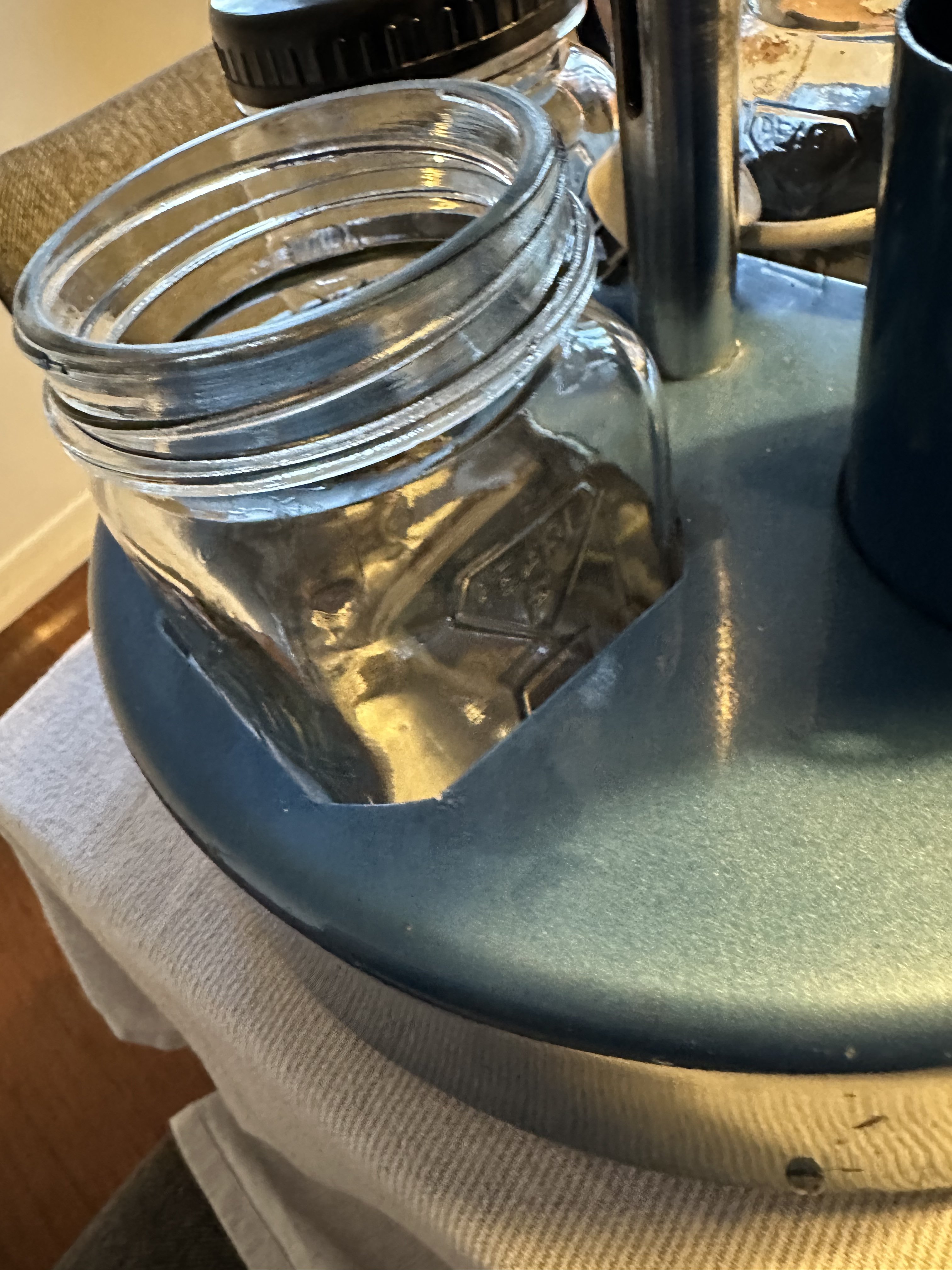

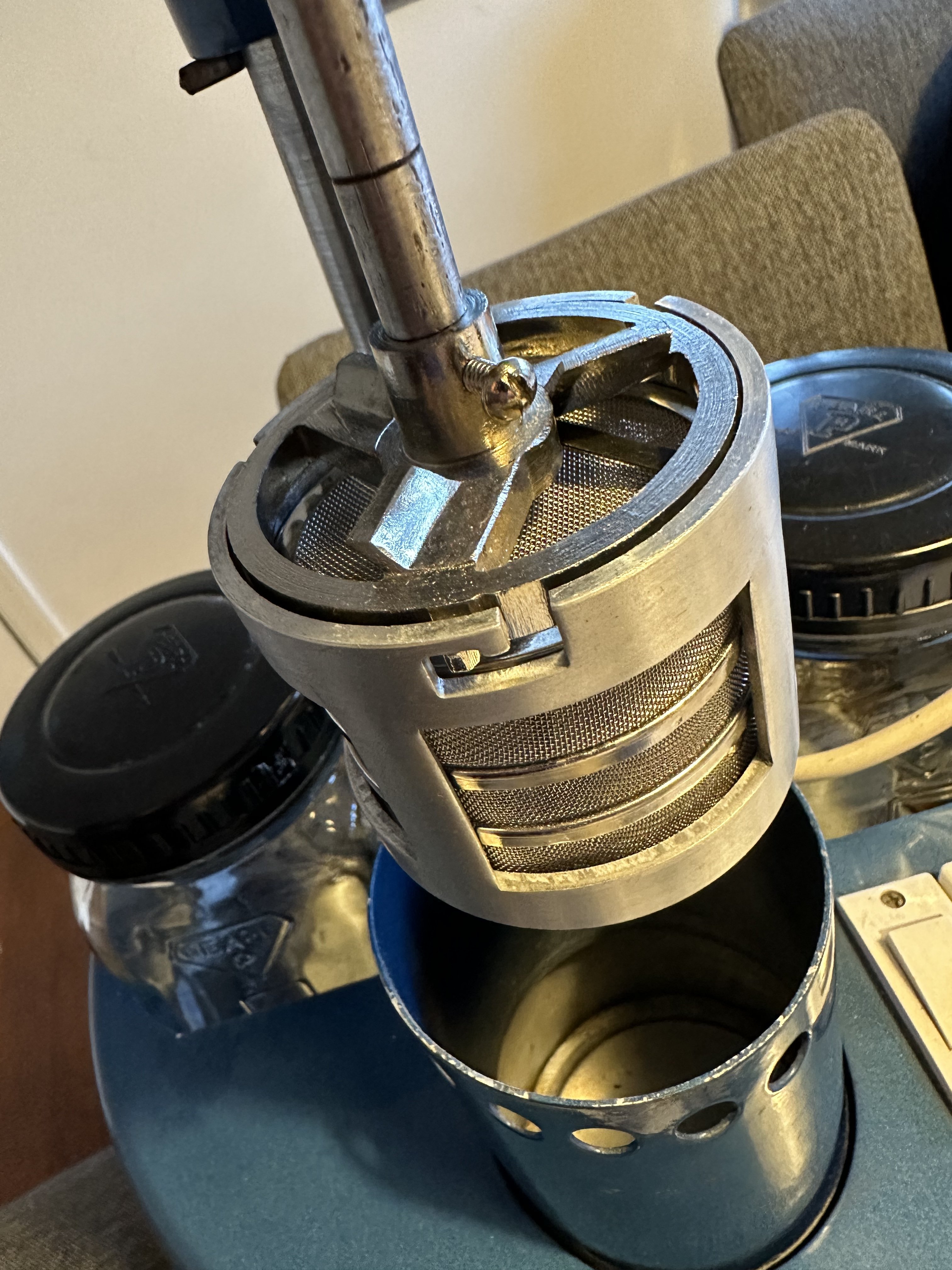

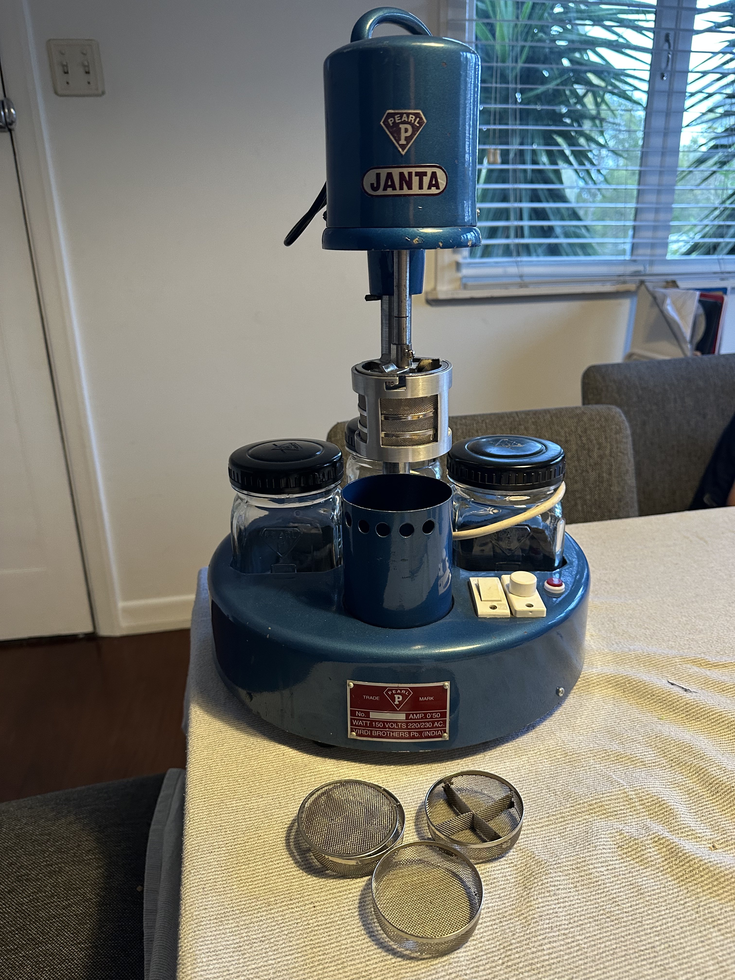

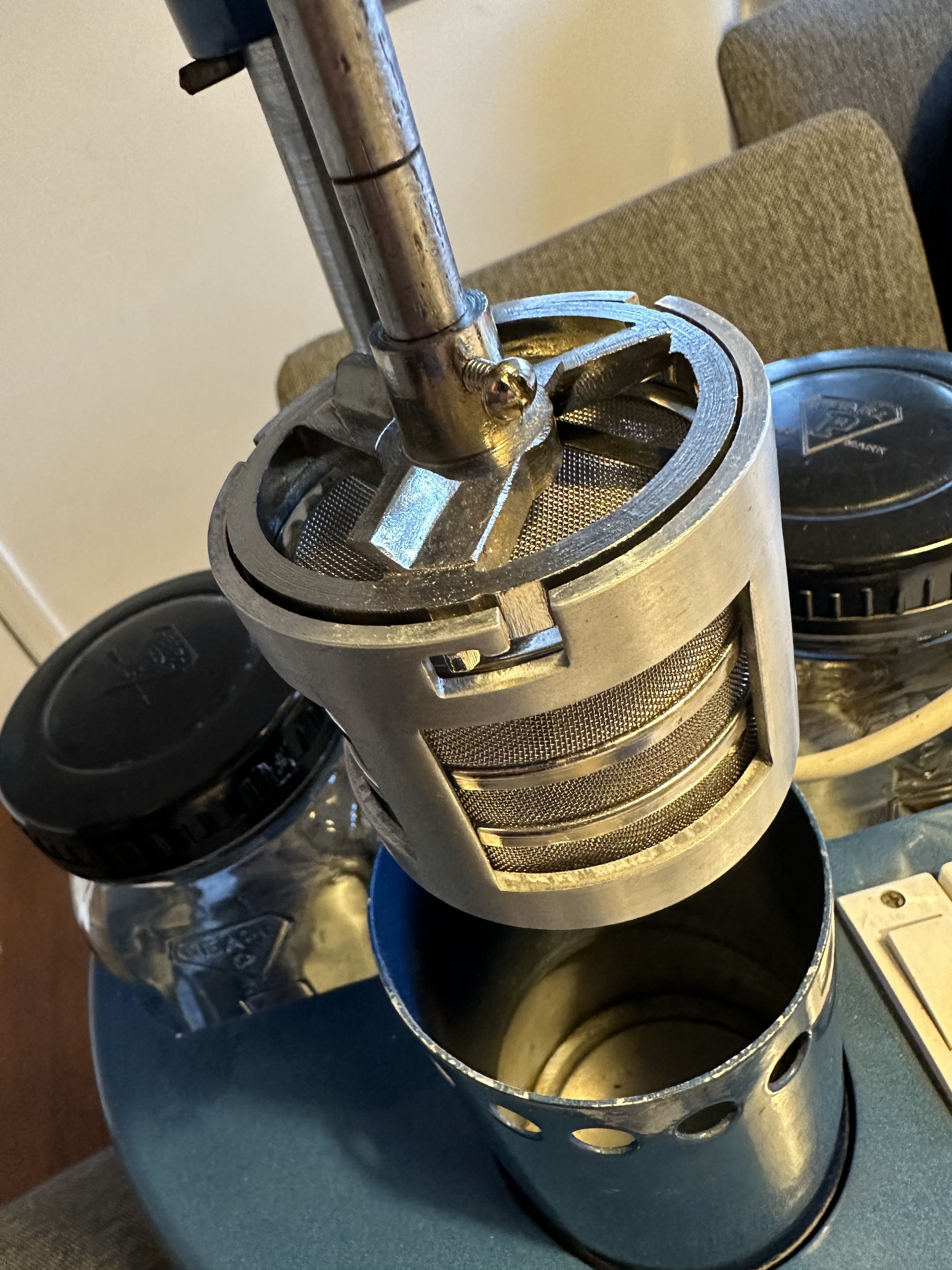

My father is 80 and has been playing around with getting old pocket watches working again. he was building his own parts cleaner when this one showed up locally and I was able to get it for a good price for him as it had been listed for a while. Looks like an Indian copy of the L&R type.

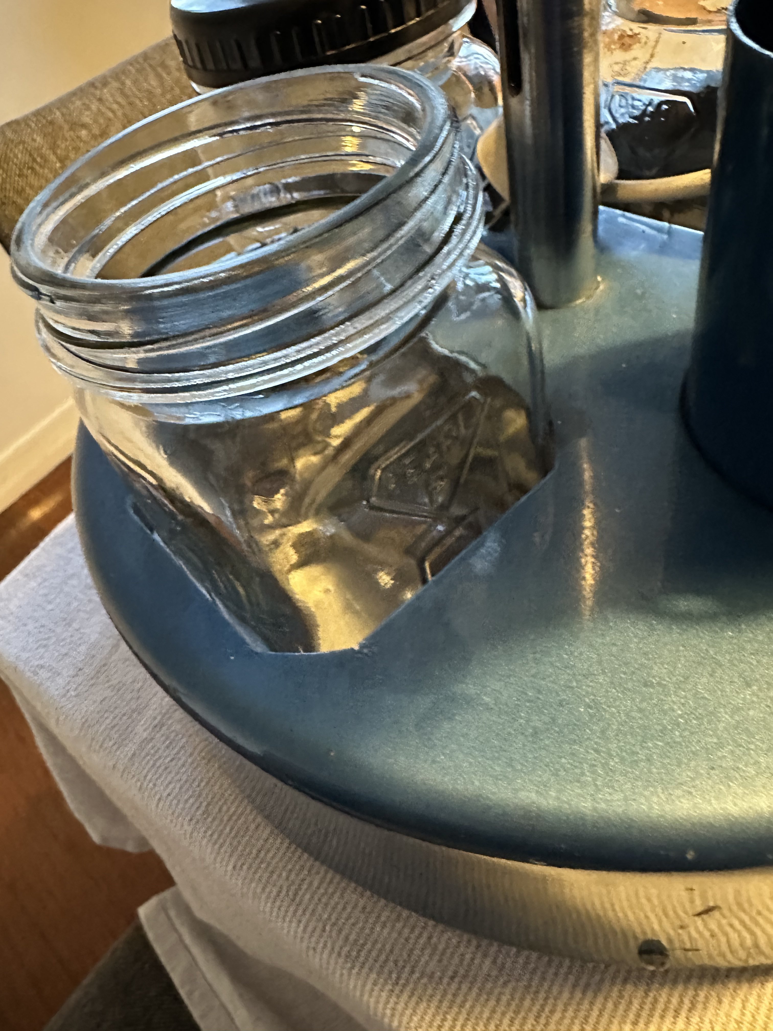

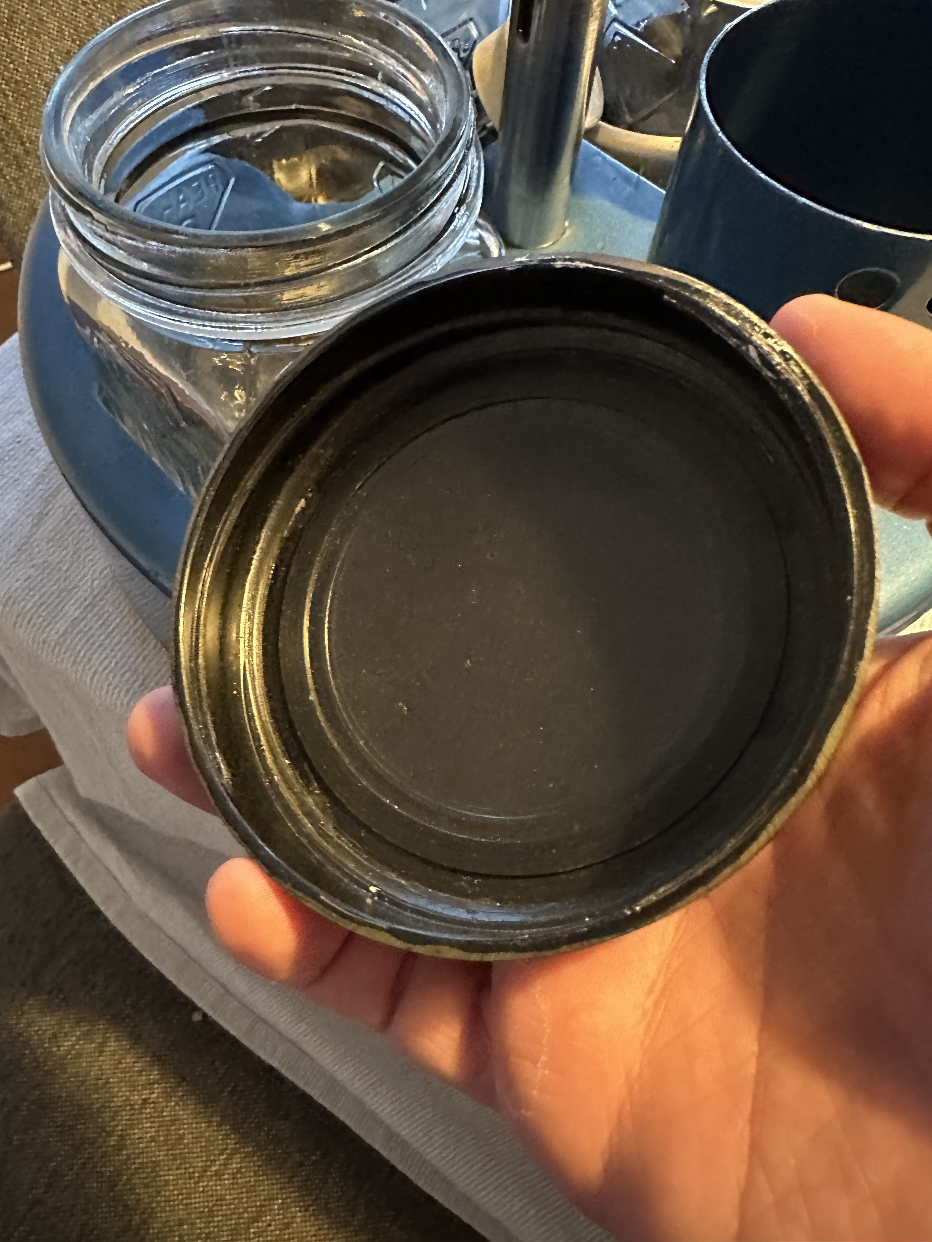

I think I’ll put a seal around the edges of the holes where the jars sit so they are more snug and some seals inside the lids before I drop it off to dad.

Actually it's a copy of the early Elma machines.
I had a similar version and it did a great job. The only drawback is the manual operation (can't see a timer).
My new machine is an Elmasolvex SE which is still manual operation and probably does the same job as the Janta.

Good pick Arancio ! These machines do a great job. I have an old and similar Elma Record machine that I still use every day.
For some jobs, manual machine allow you a better control somehow.
Depends on the type of parts your Dad will clean but on my end I usually got the best results with :
* 1st Jar with Elma Red 1:9
* 2nd and 3rd Jar with IPA (Isopropyl Alcohol 99,9%)
* Drying (basket in upper position)
Alternative with Elma Suprol rinsing solution in the 3rd bath. Stinky product but making a good job on fine watch parts...
Timing between 5 to 9 min in each Jar.
I can highly recommend few upgrades like finding some additionnal mini-baskets (Ø20x13mm). It will help you to secure your parts integrity during the process. I got better results by installing wave-breakers in my jars too.

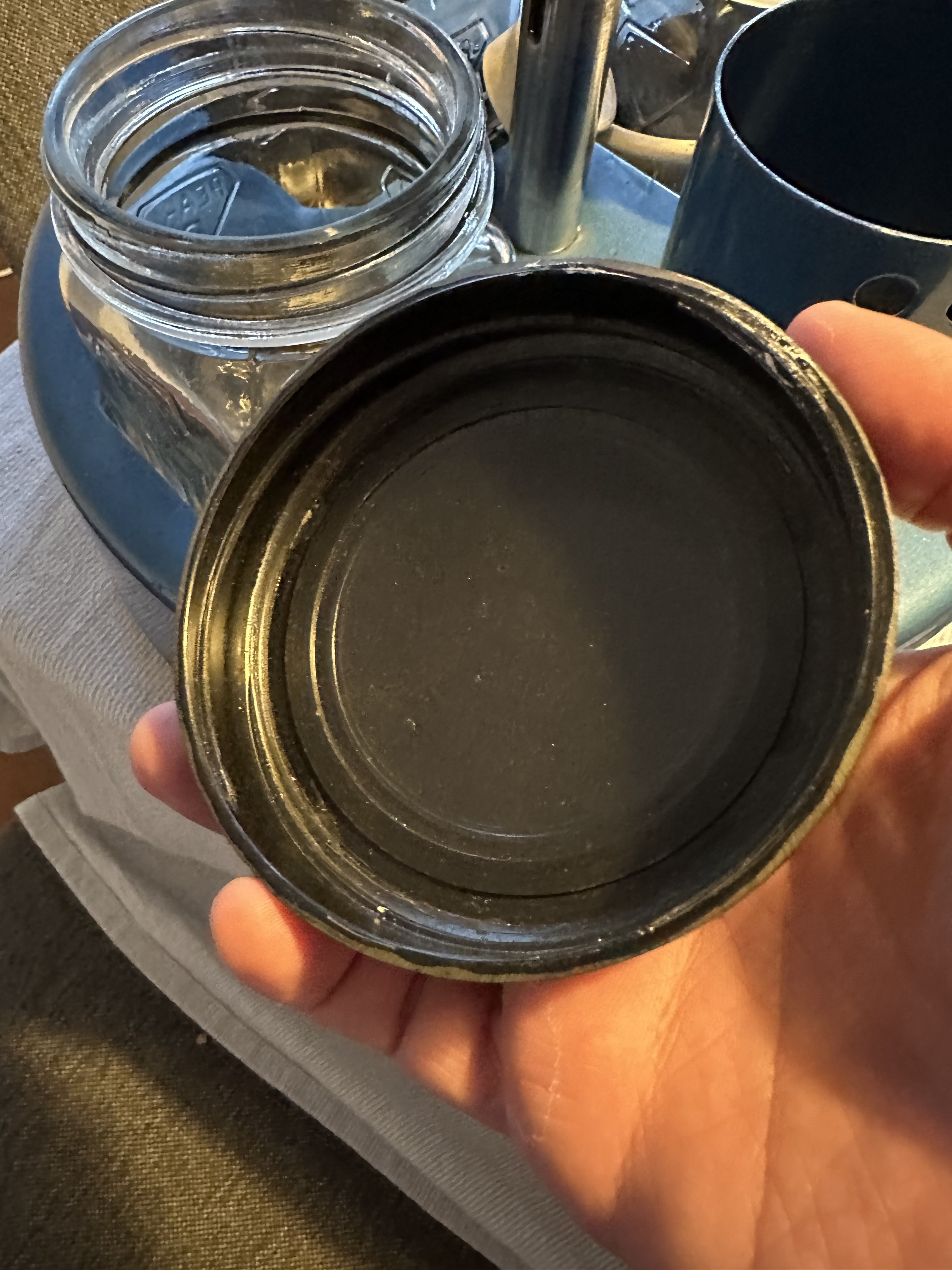

Also, improving the tightness on those Jar lids. IPA or Suprol solutions are very versatile and the room could be easily full of nasty vapors. Original Elma machines had some cork-gaskets. I guess you can easily find them online.
Cheers.

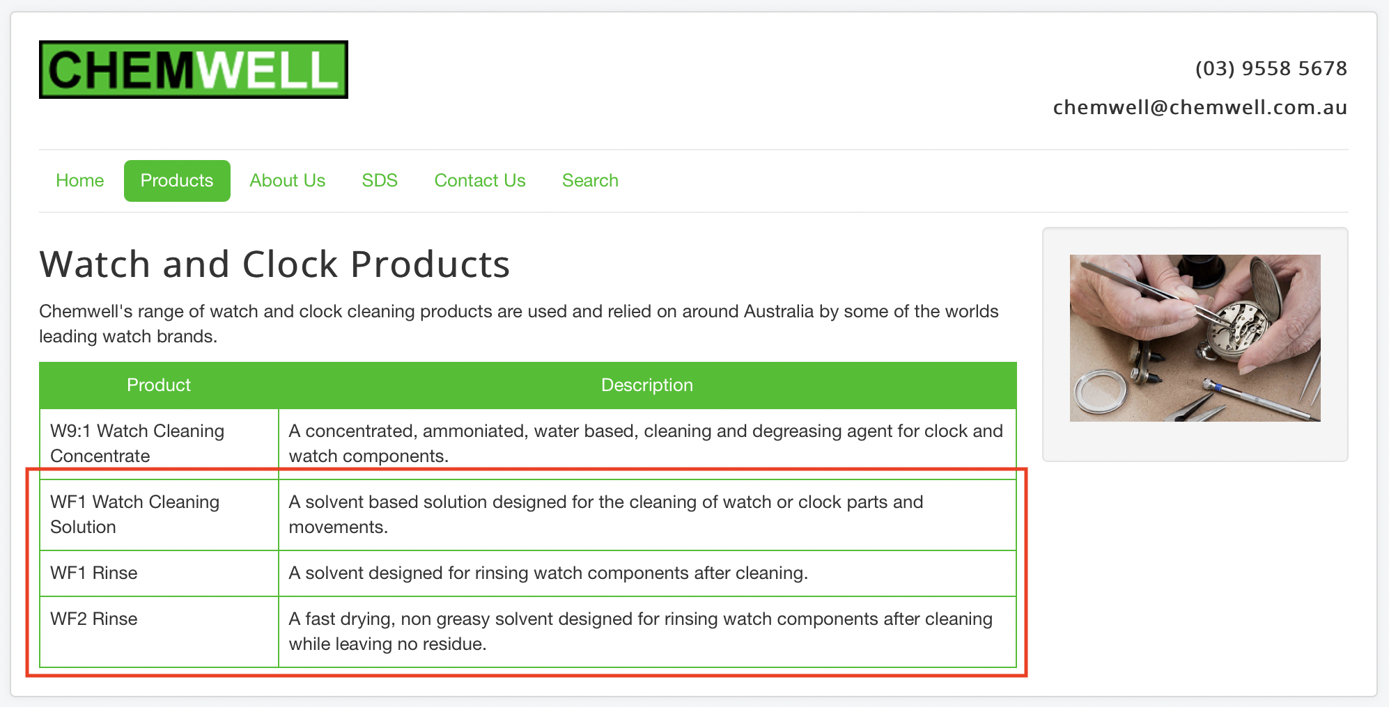

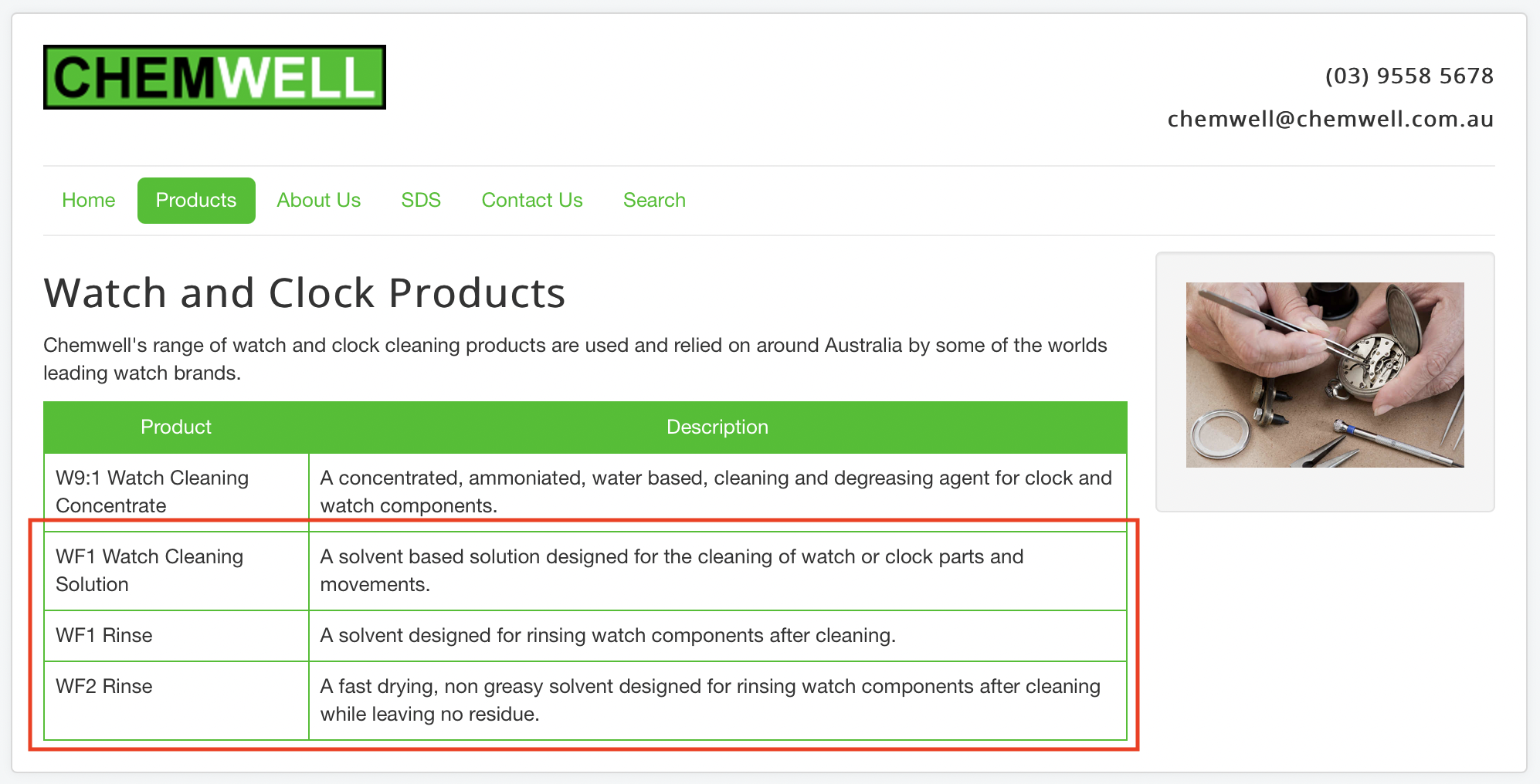

Check out Chemwell Australia for watch cleaning fluids.
https://chemwell.com.au/products/watch-and-clock-products
I'd recommend these.
For your gaskets, I had some composite rubber/cork sheet and cut lid gaskets using a downlight cutter. I still have some somewhere so if you give me the dimensions of the inside of the lid I can cut some out for you.

Thanks! I’ll contact them for some prices.

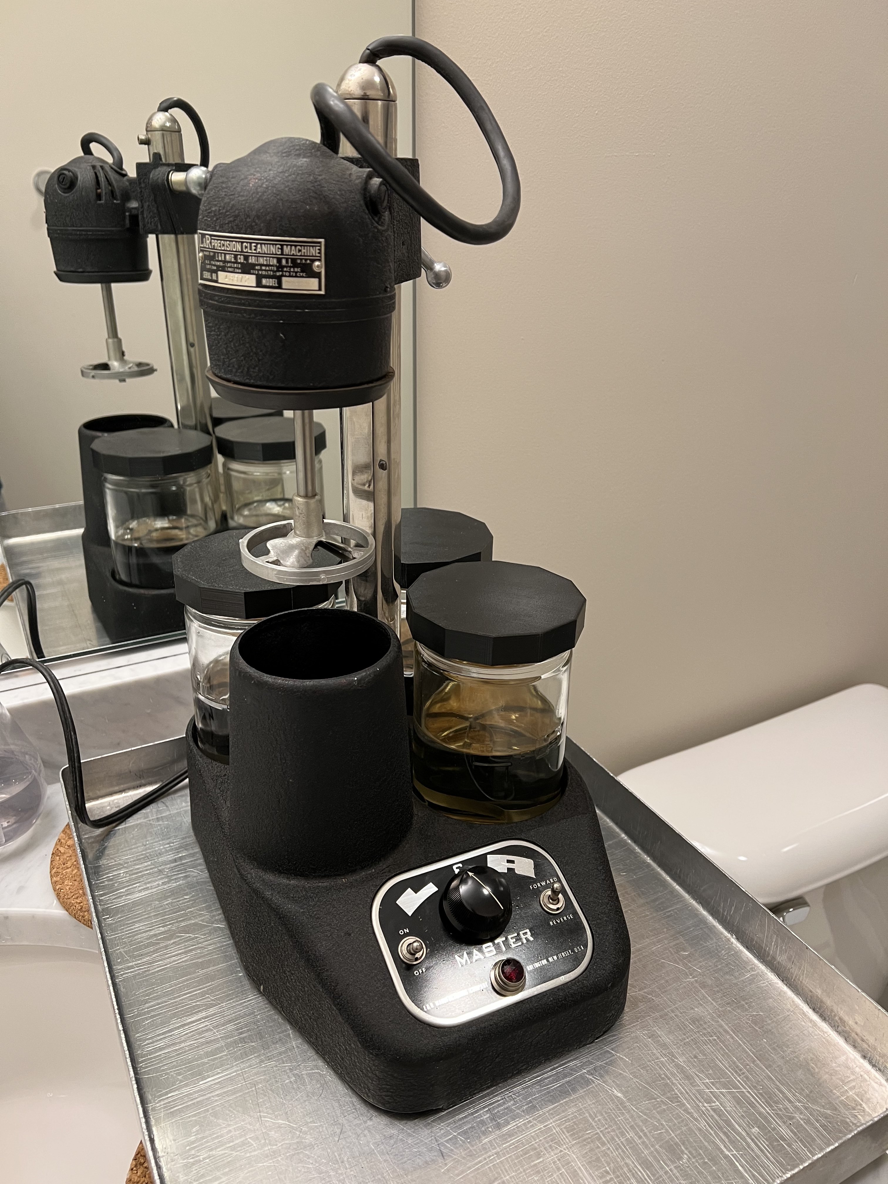

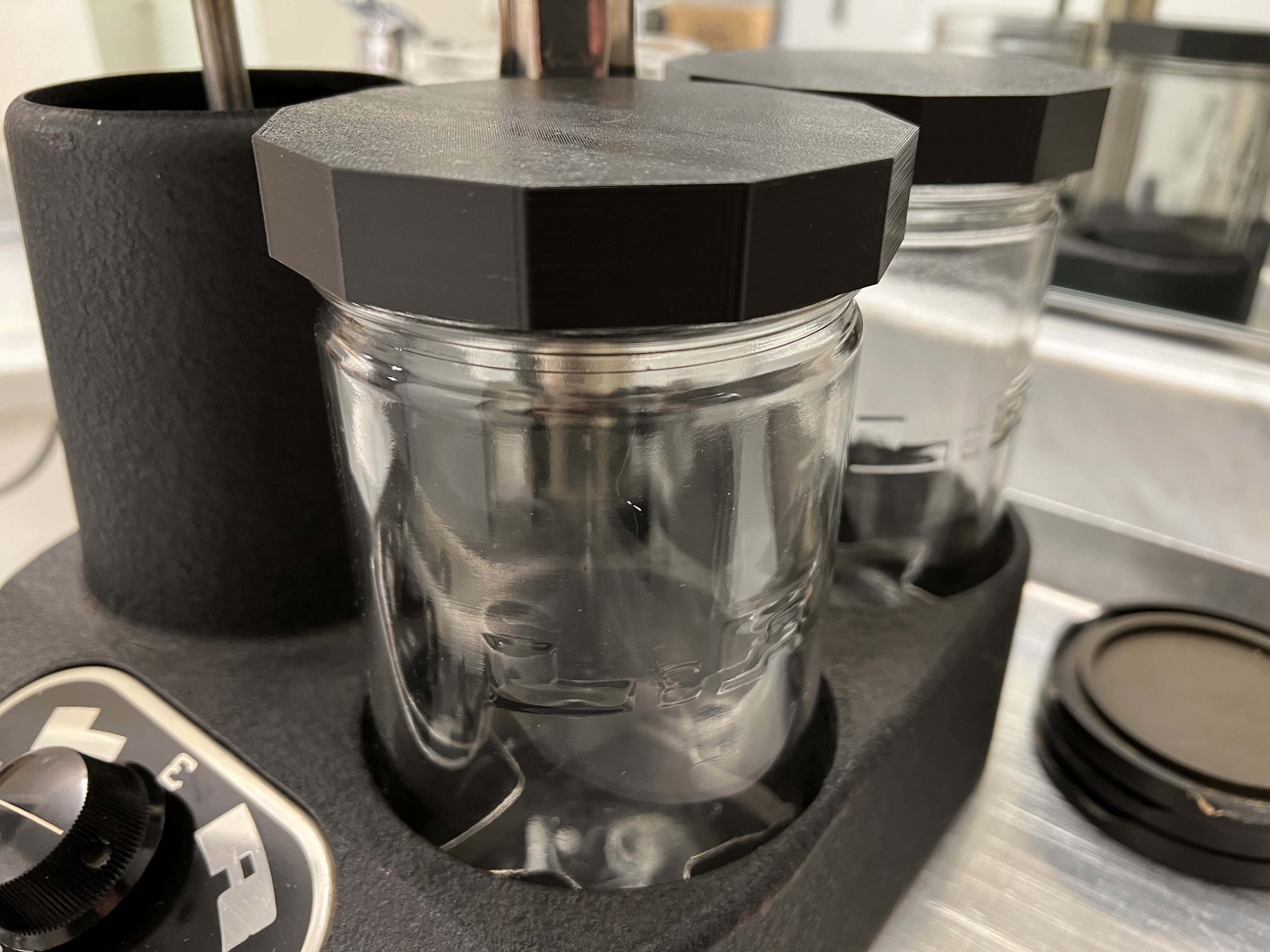

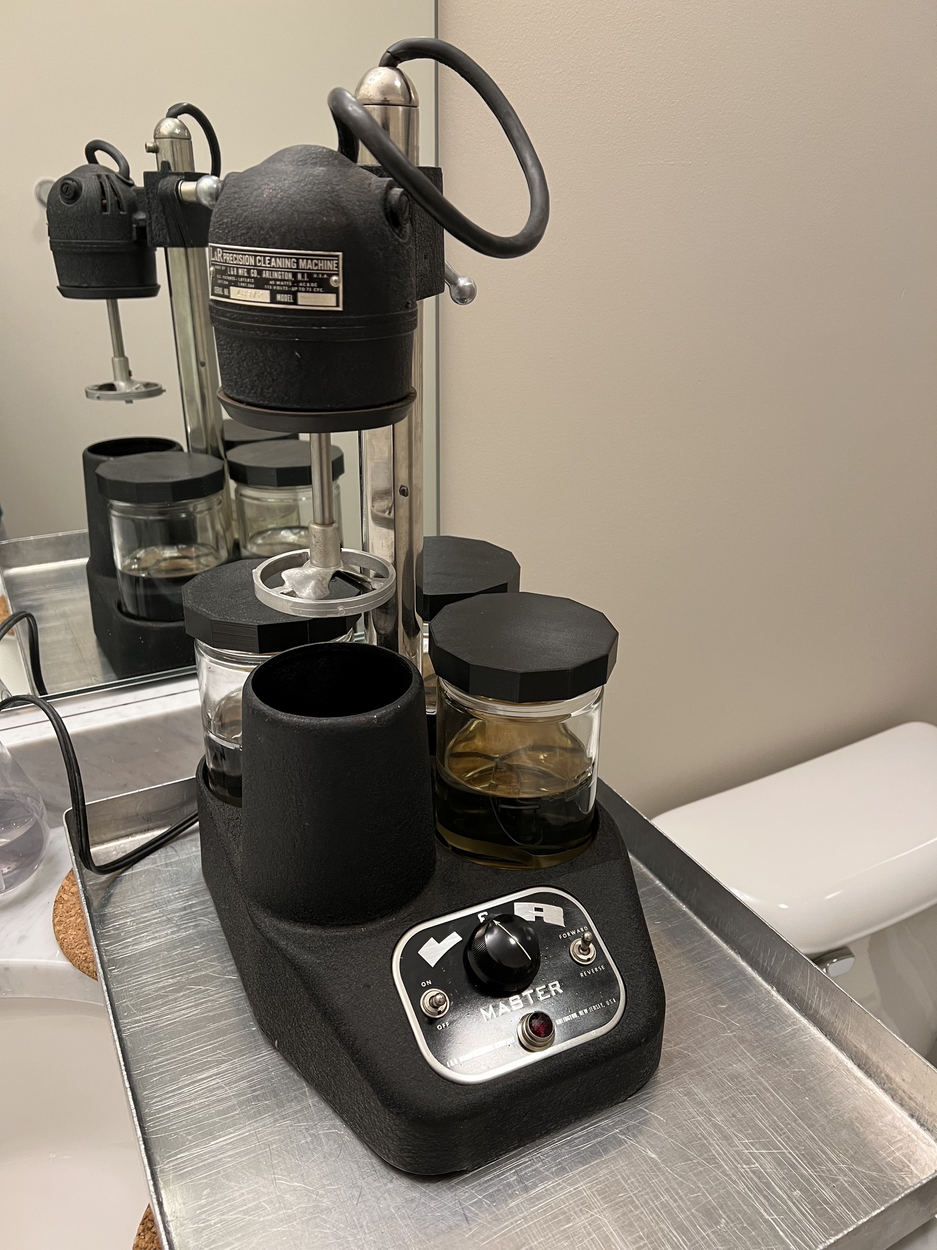

I have an L&R Master that looks similar, but I like your basket setup better.

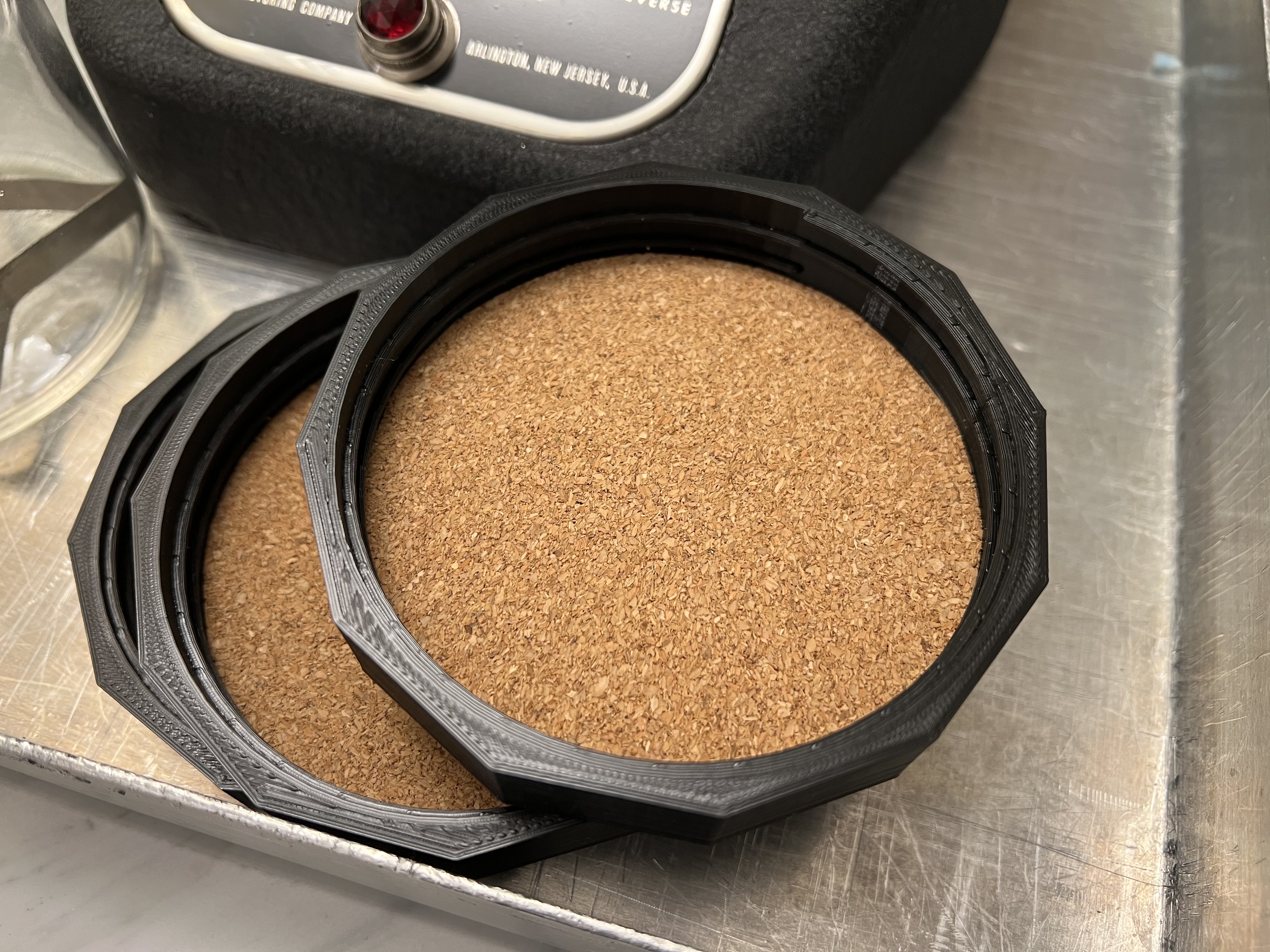

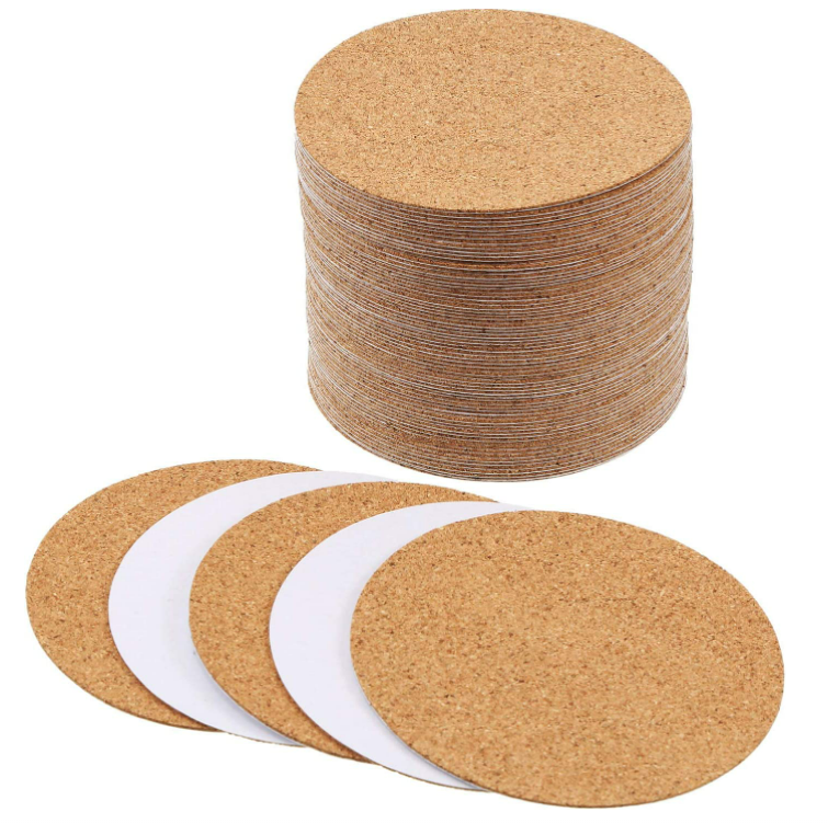

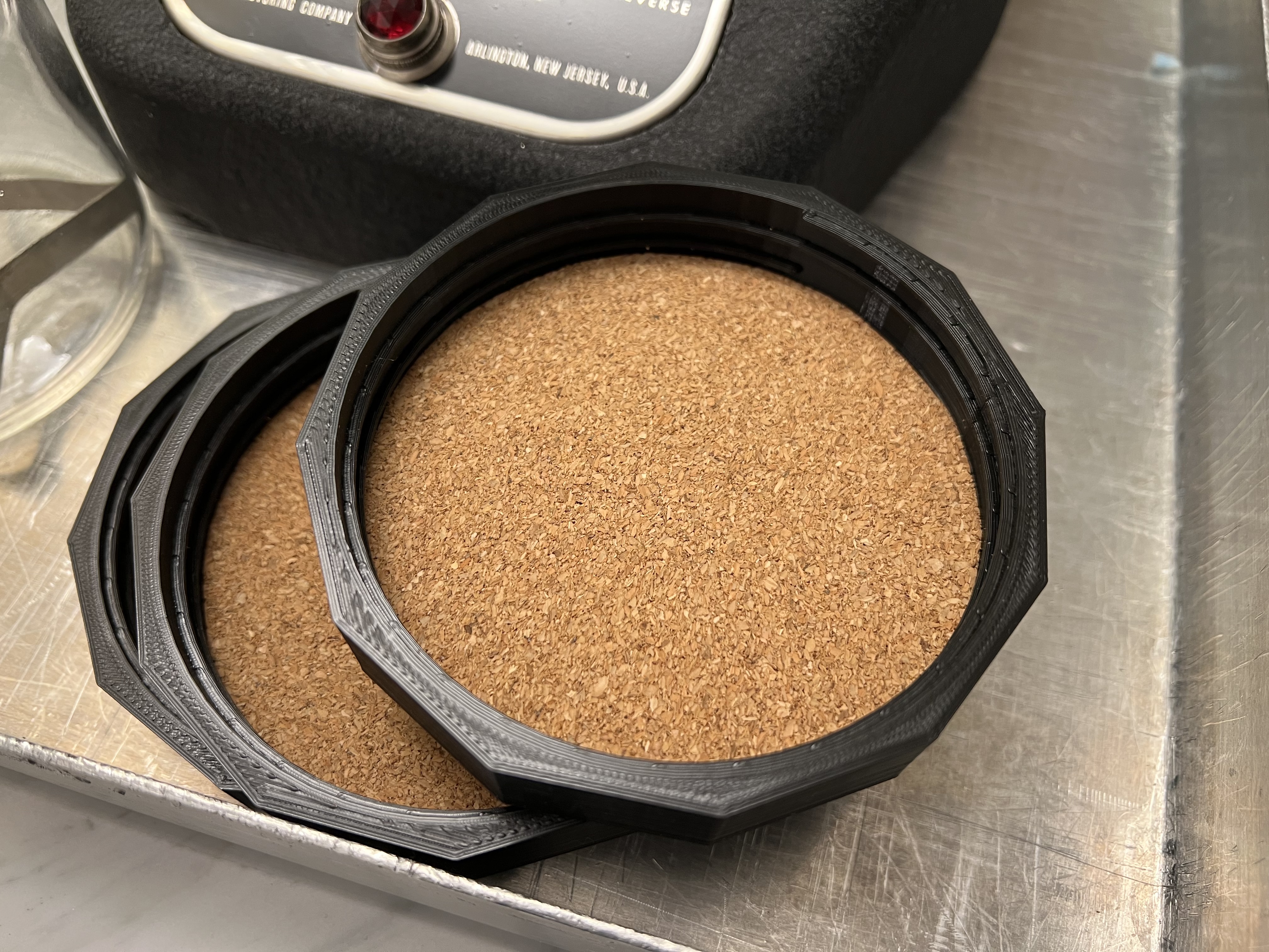

Mine came with lids that do not seal or screw in. I found a lid drawing online and had a friend 3D print new lids for me that match the thread on the glass jars. Then I bought self-adhesive cork pieces for the inside of the lids and they fit perfectly after cutting about 1mm around them. My machine also came with a broken rheostat that did not work well, so I ended up replacing that as well. I eventually want to redo the wiring one day.
Overkill for me to have a machine, but it's just another project.

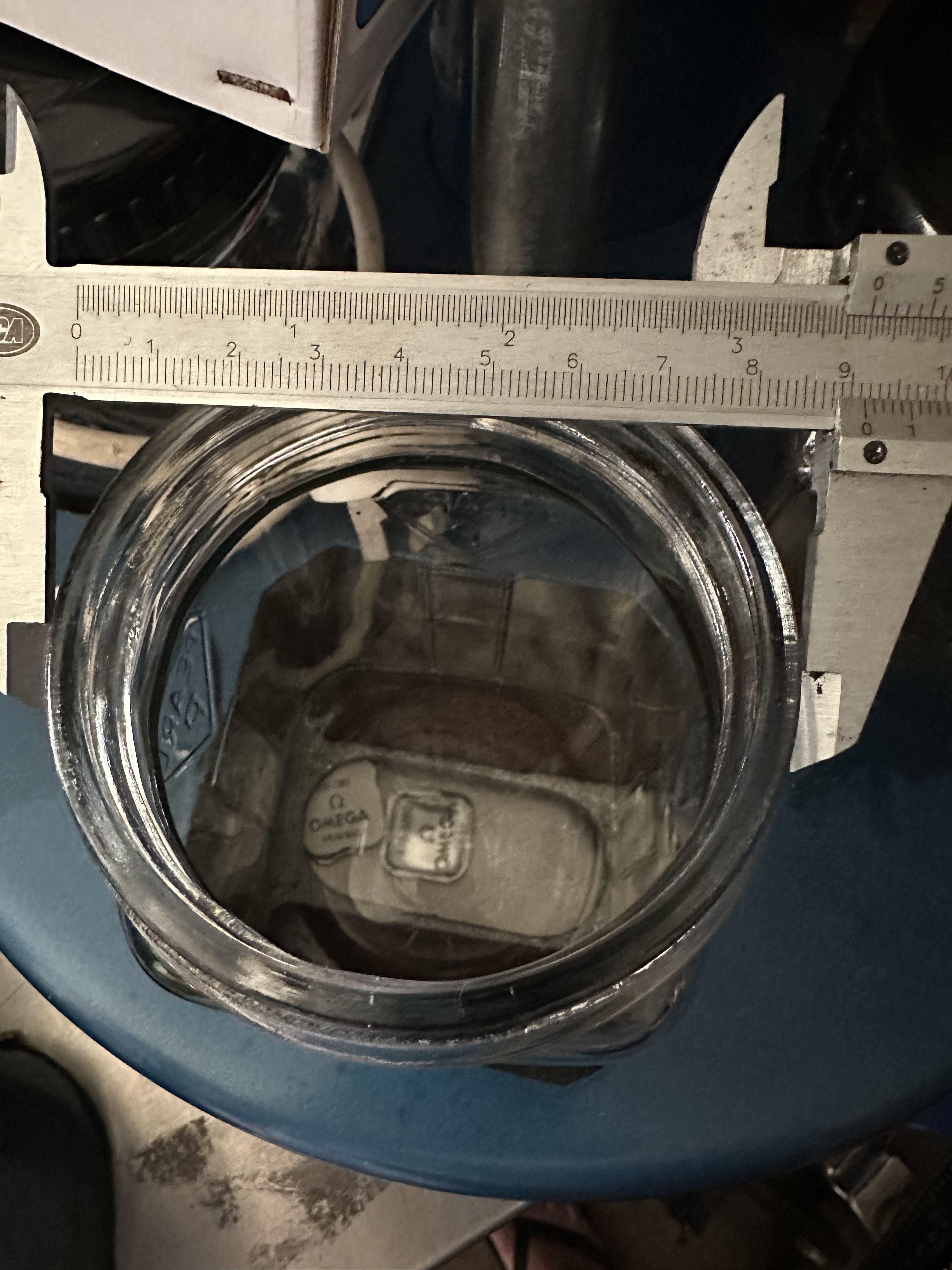

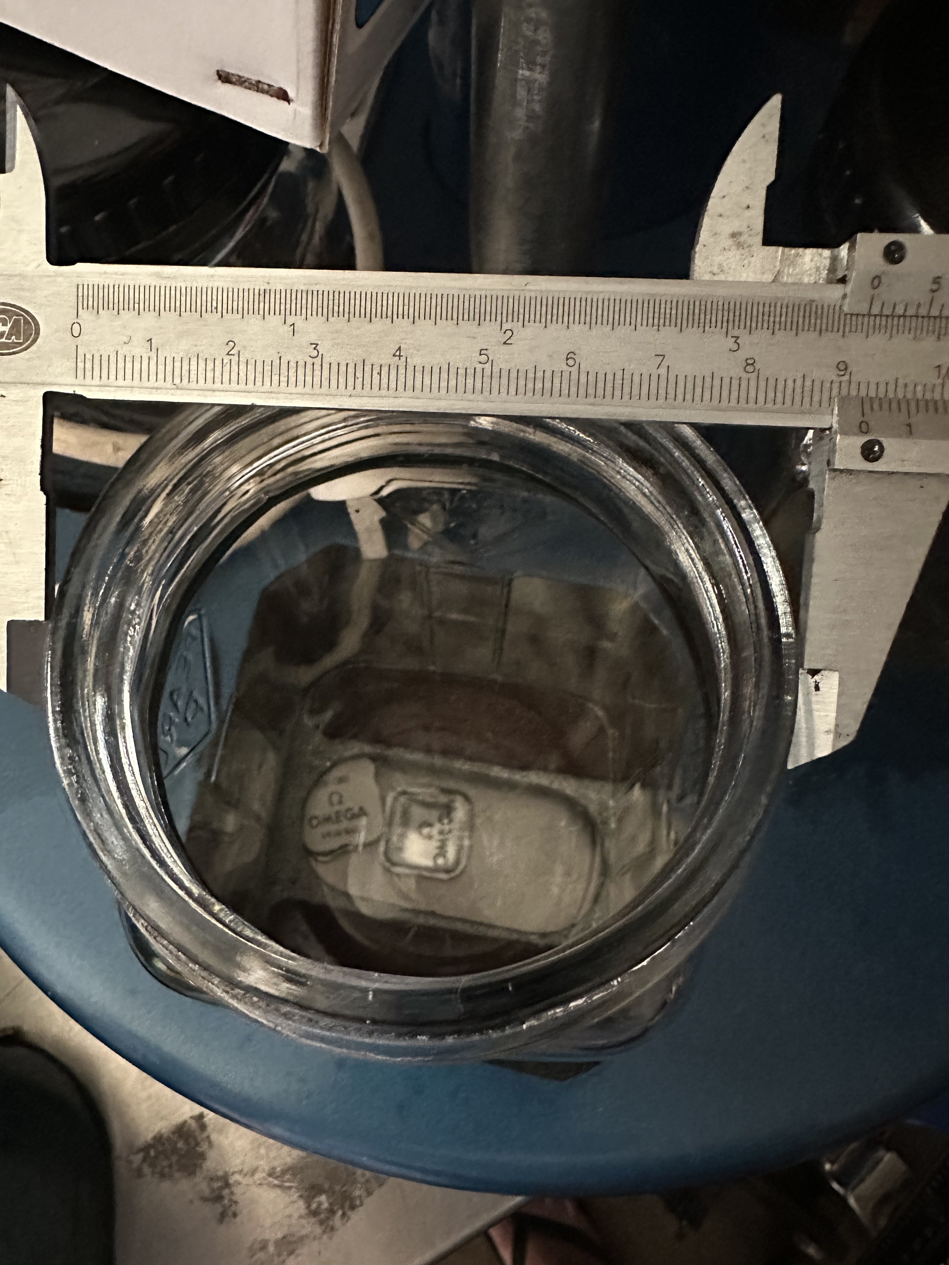

A bit slow on the reply I know, but I just measured the inside of the lid/to of jar and it’s about 91mm diameter. I’m still keen if you have any surplus. I’d so let me know and I’ll swing you some dosh.
