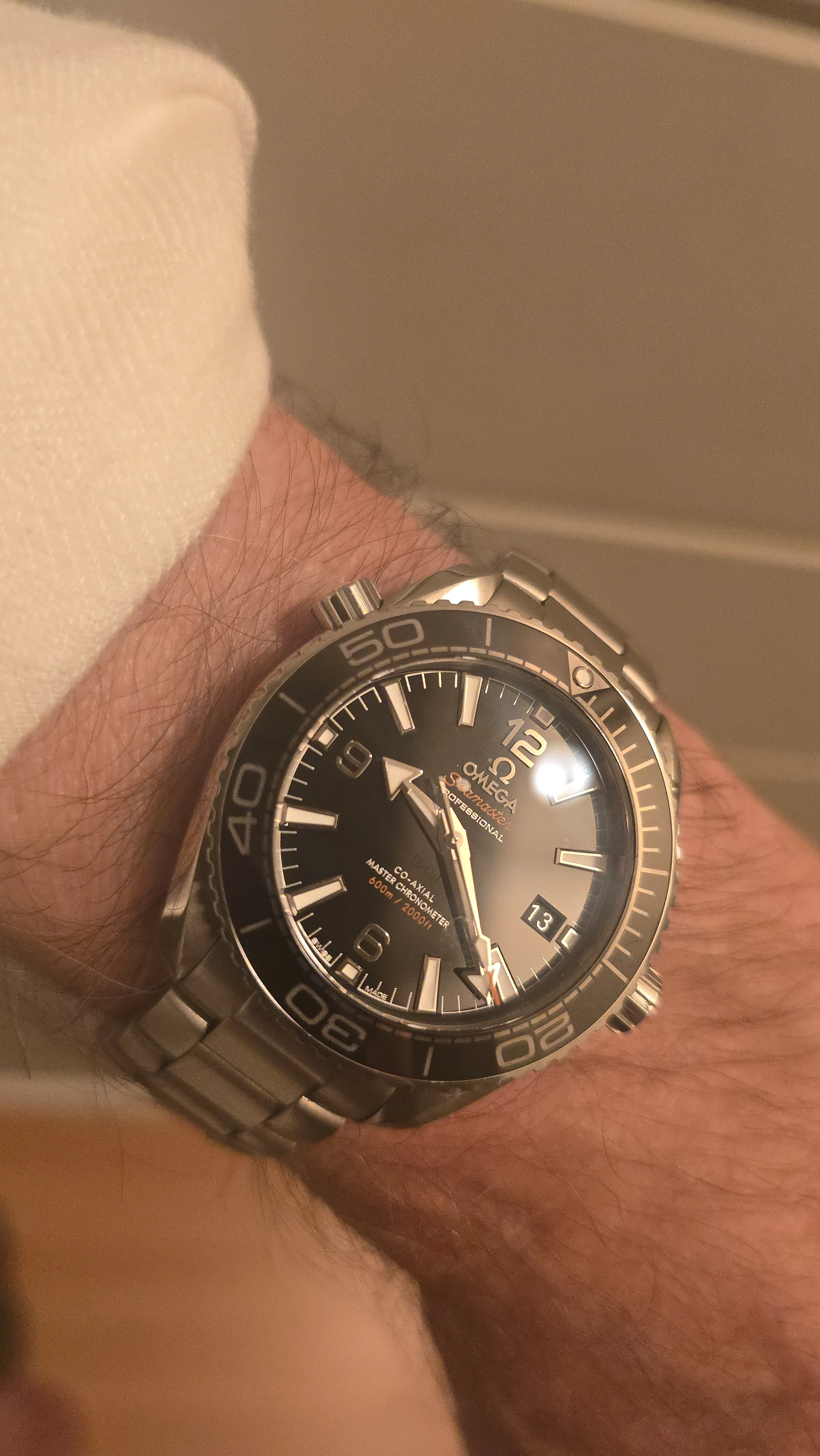

New 3861 runs in the negative

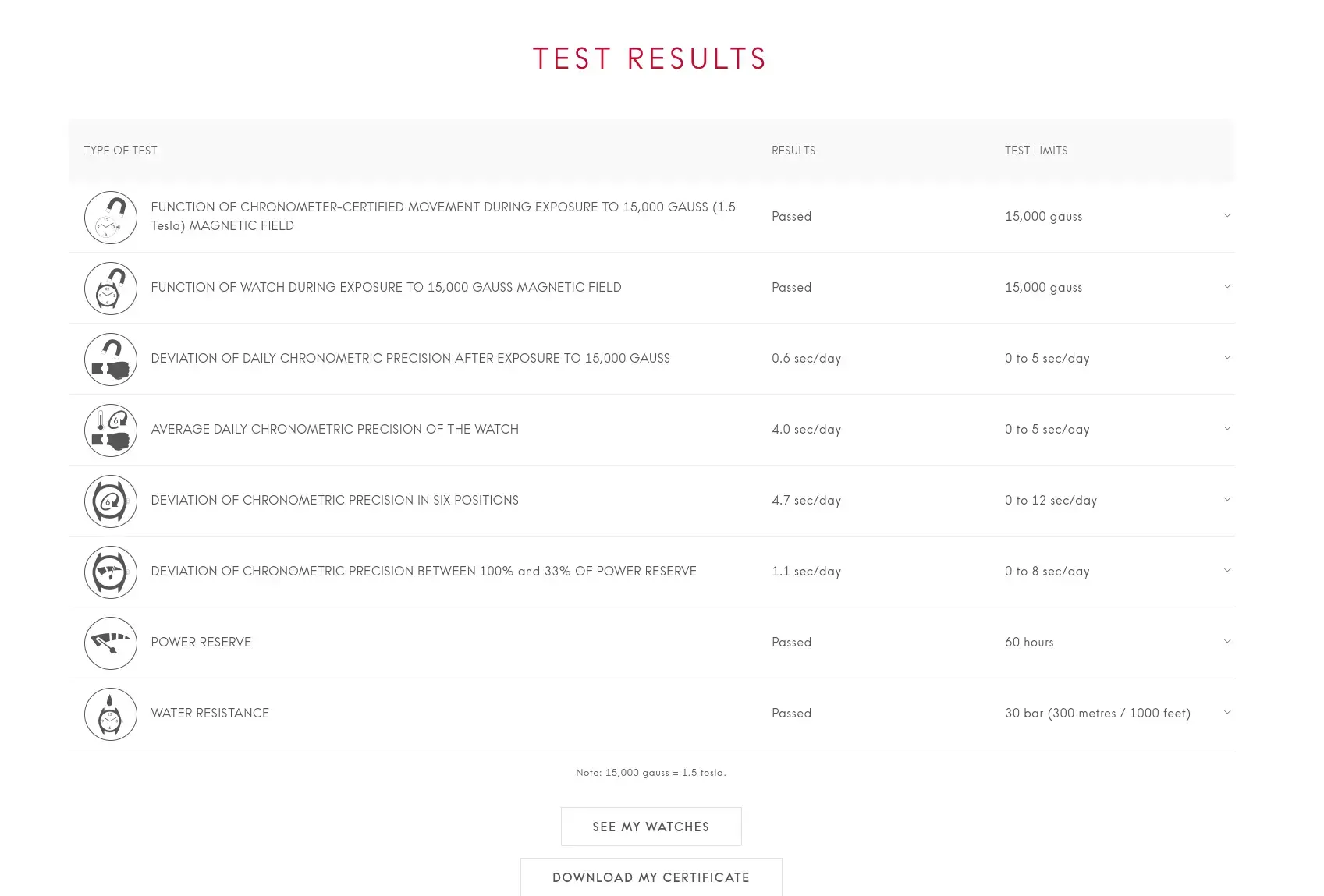

Its a bit sad that the Master Chronometer page doesn't show per-position, though it does show the difference between the highest and lowest as well as shows how it did.
Interesting to see that the difference between 'fastest' and 'slowest' is 12 s/day! SO if you had your watch in the 'wrong' position, it could be quite a bit slow, as long as there was a position that was equally faster.
That said, I presume there is a min/max each position can show, but it isn't listed on that page of course( which again, I wish they listed the 6 positions...).
This is the one from a card I had handy, my heritage 300.

The internal specifications that Omega uses ensure that the watch meets the METAS requirements. Those constraints are the average rate and the Delta - that's it.

I found out whatsup. It’s the power reserve. When fully wound, it goes + 0.5 second in the first few hours, then after 12 hours, it runs slow by a second in following 12 hours, so a net of -0.5 seconds loss per 24 hours. I discovered that by fully winding it every 12 hours, and now i am getting a second faster per day. Compared to full wind one time per say with -0.5 second.
What do you think?

See my chart above, that is consistent with the Master Chronometer checks, full wind-to-33% wind is allowed to have up to 8s/day deviation. The one on my Heritage 300 is 1.1s/day, so that is roughly consistent with what you're seeing.
That said, the top ~5-10% of 'wind' always runs quite a bit faster, and it settles in after that.
