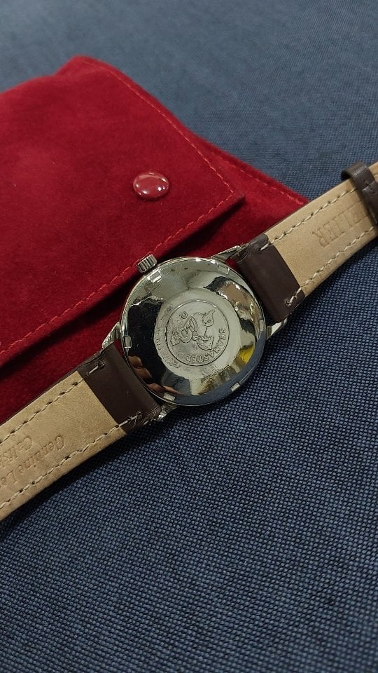

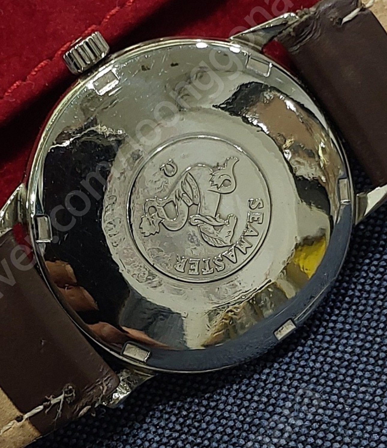

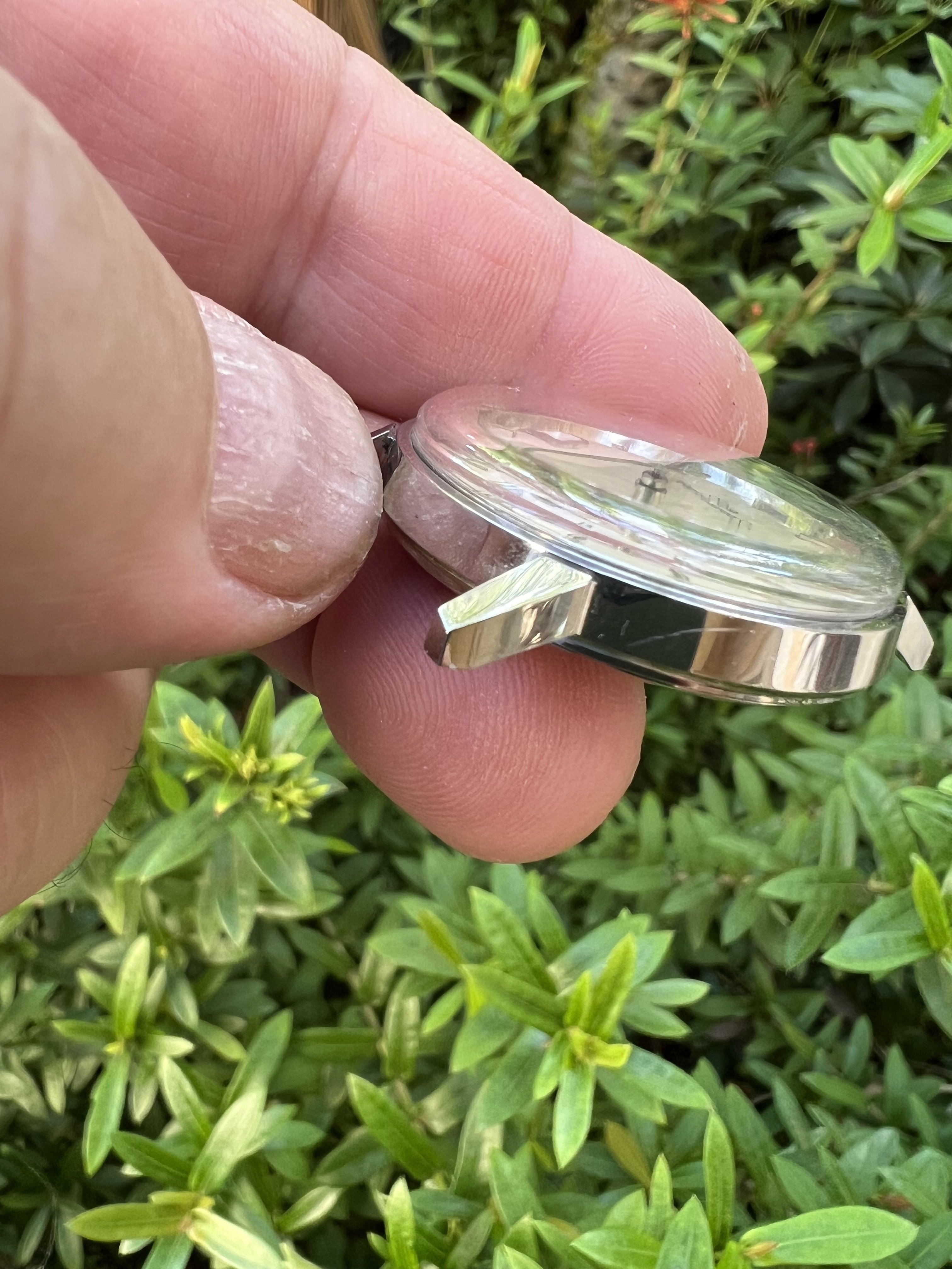

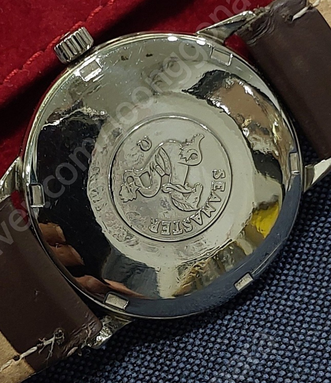

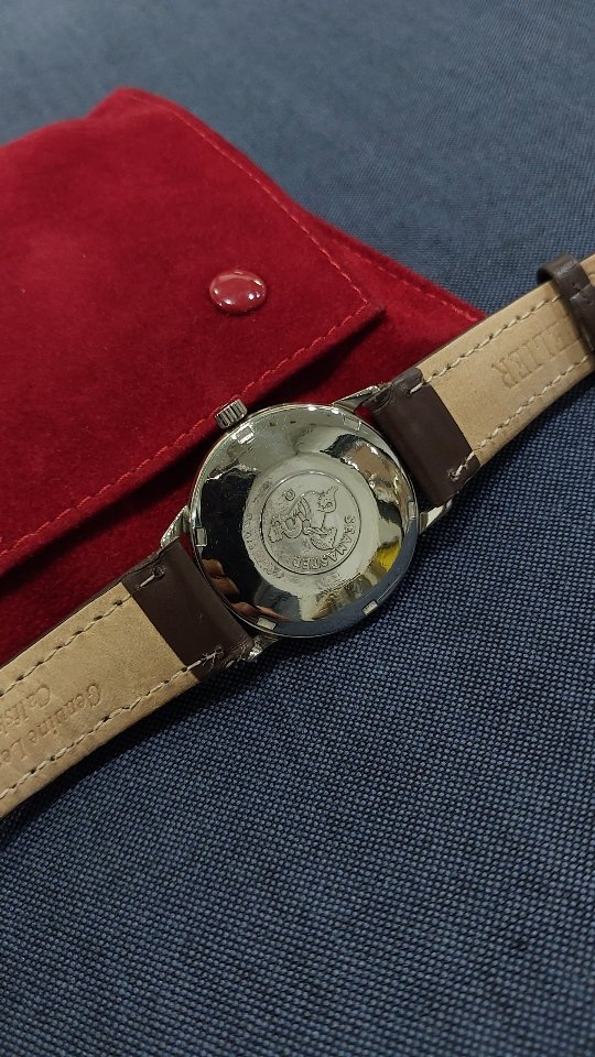

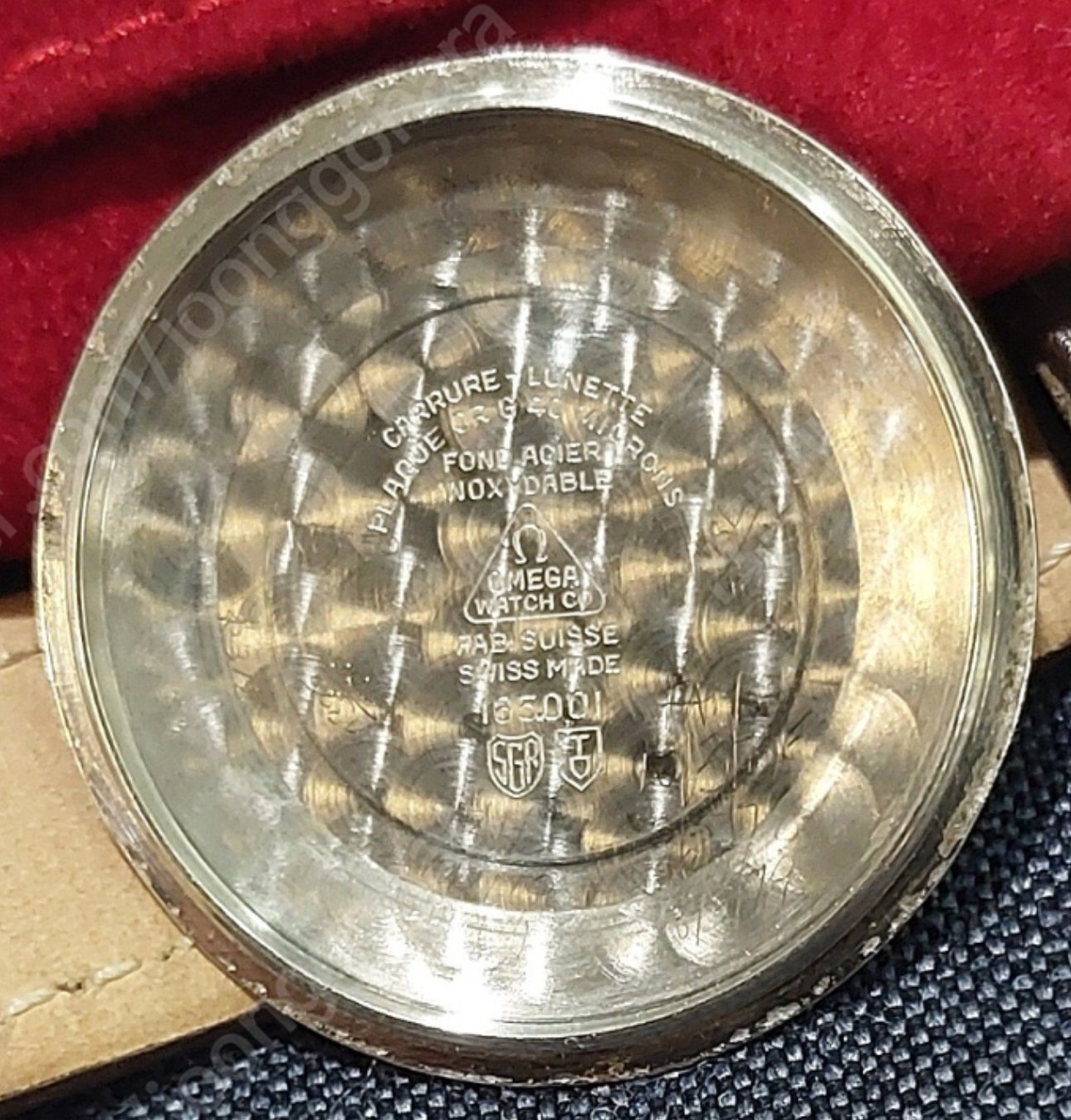

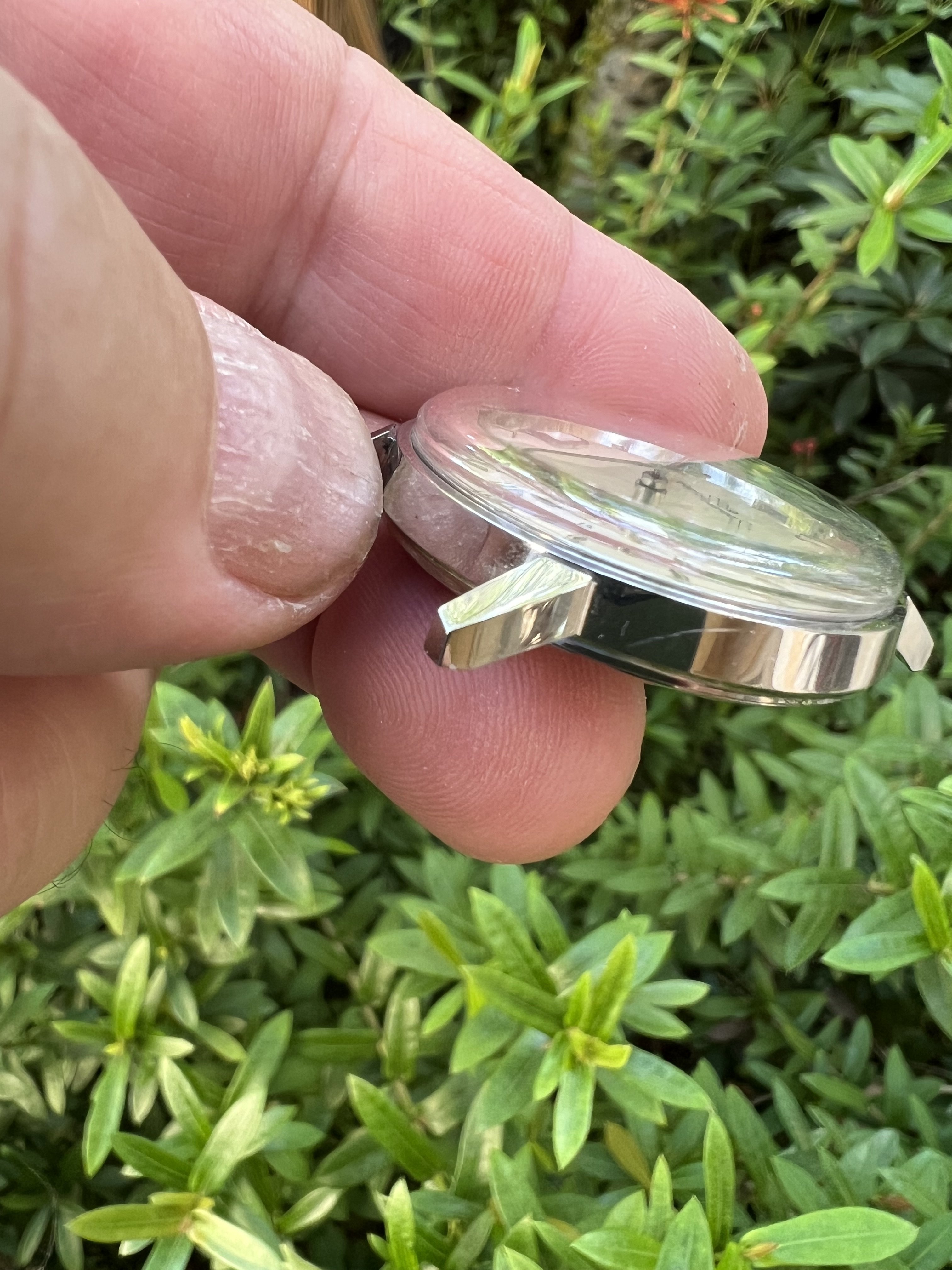

Ask for better pictures of the back. Current looks like someone polished it with a metal grinder
Based on the case number of 165.001 (can't really make out the middle number, but looks like a 6?) and crown looks to be a replacement based off images of this model
Did you already buy it?

You are correct, ref. 165.001
I am very close to pulling the trigger, the asking price is low and we’re supposed to meet at a third party professional vendor to check if things are authentic and correct working order. I’m looking at < 600usd

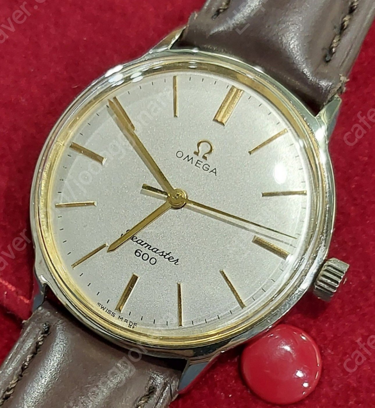

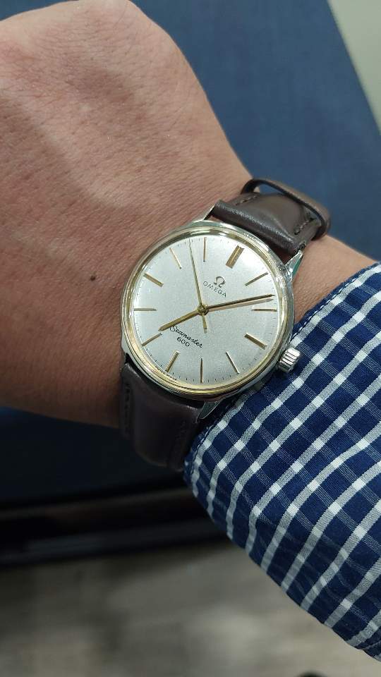

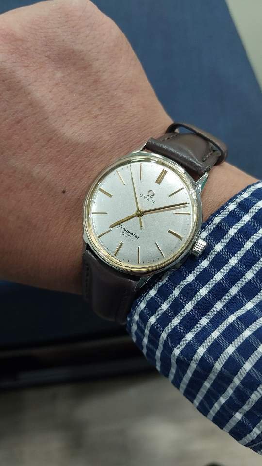

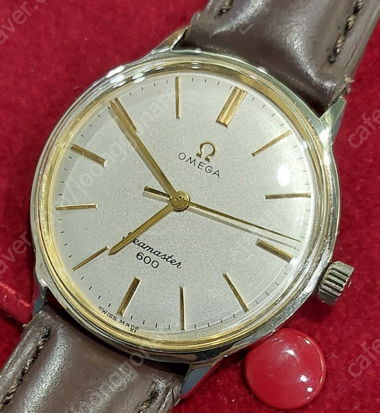

I am very concerned about the back of the case, it looks awful. Also, I am not sure about the dial. Can you post a good straight on photo in natural light with the hands moved so that they don't obscure any printing,

Mr. Man isn’t home atm, but he had a few more photos on his phone.
I’m not looking to flip, if that factors in on your advice. (Price is around $550) Just need a old-classy dress watch.

Really appreciate all your time and effort to help me out. Y’all got me worried over the dial now!

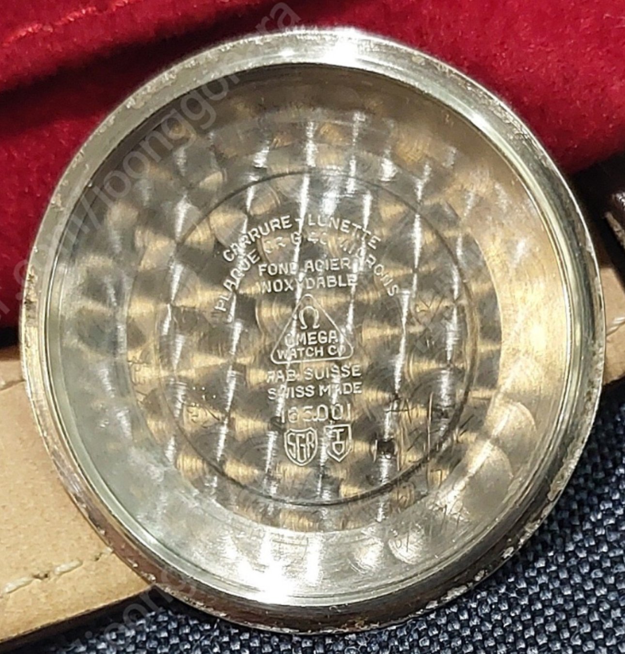

Certainly something wrong.
is it missing its bezel?
Case back says plaque or G 40 microns.
where is the gold plated case?

Don’t be hasty. I’m likewise on the fence with the dial. 600s come up regularly and finding it here is your best bet, frankly. The price is good, sure, yet I have hand-hammered cymbals that look better than that case back.
Think of real estate’s golden rule; instead of ‘location’, substitute ‘condition’. You’ve waited this long after all.

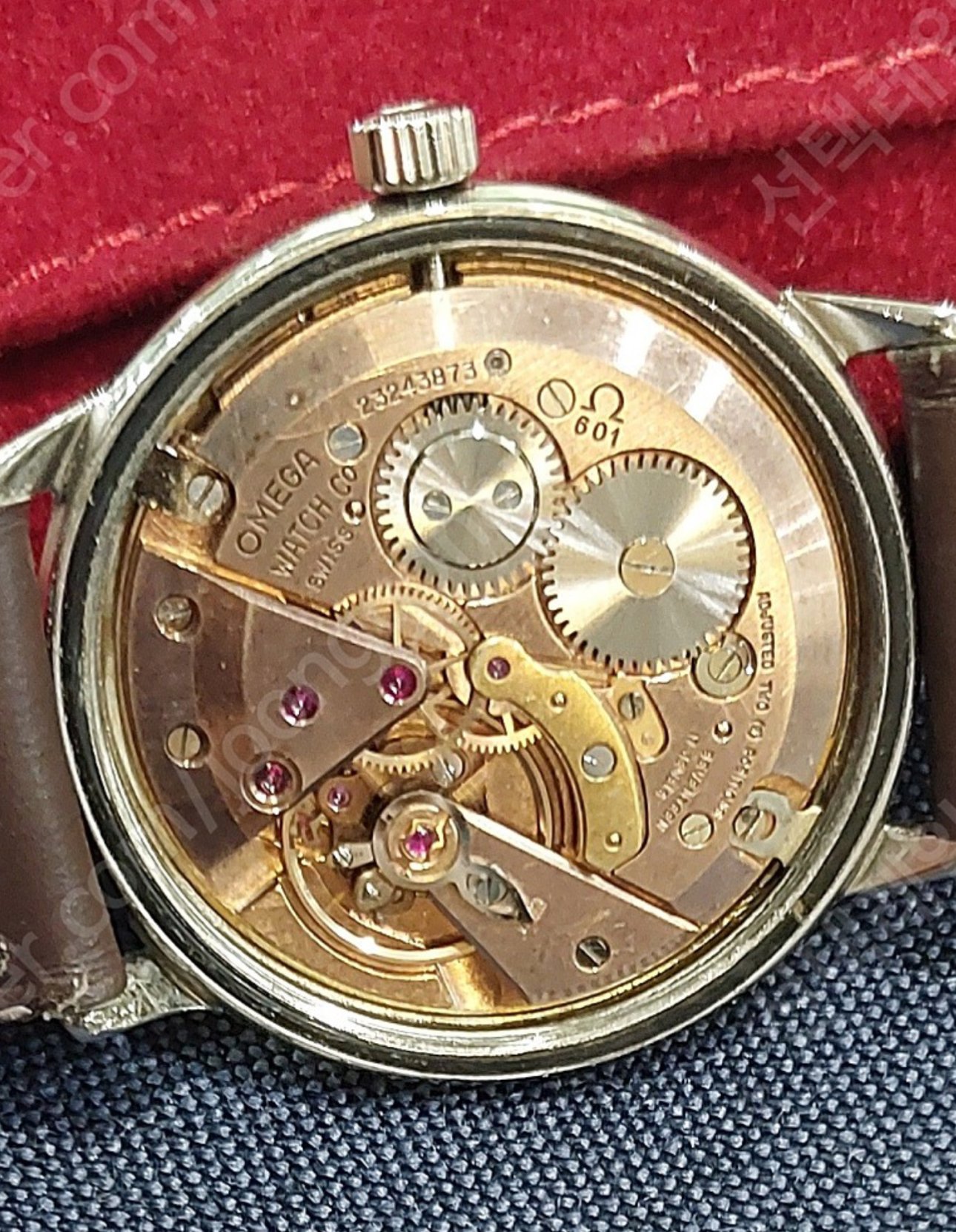

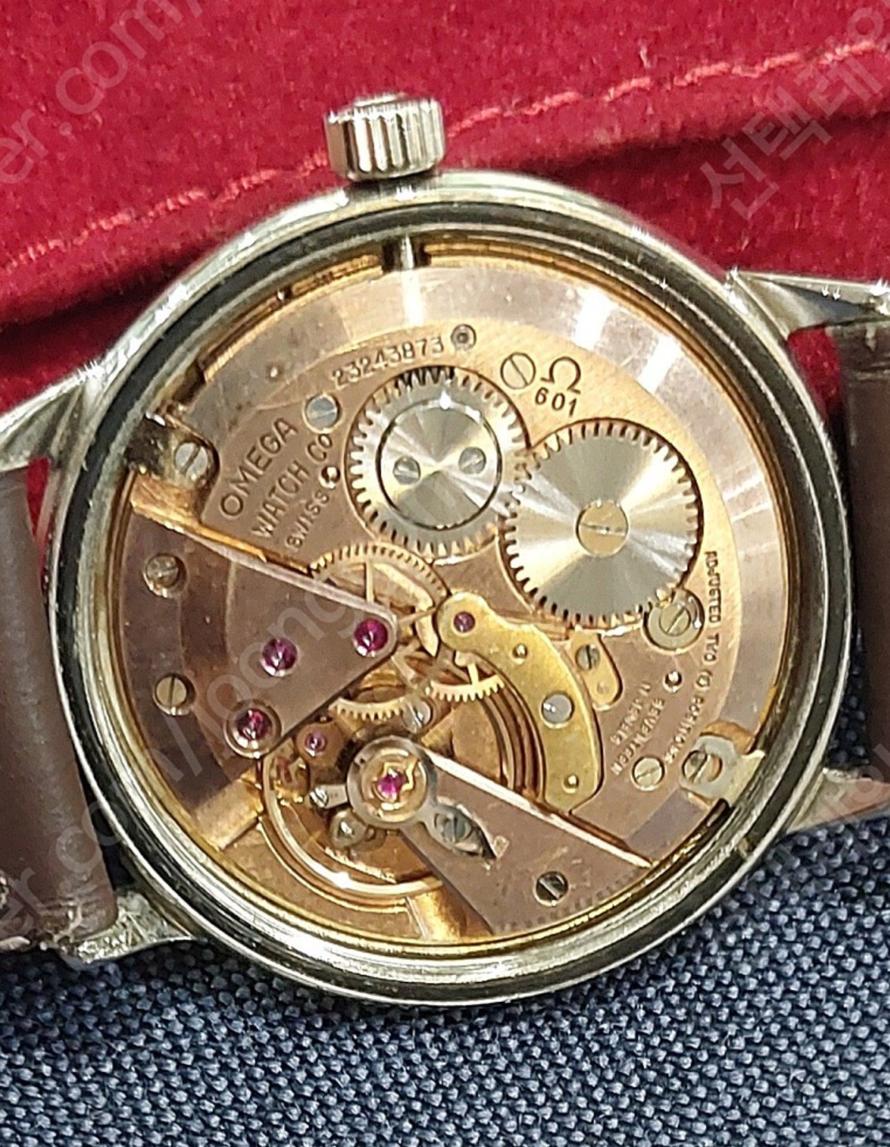

It appears to be a franken watch. Case back interior to deep for a manual wind and a search shows it to be an automatic movement.
Avoid this like the plague

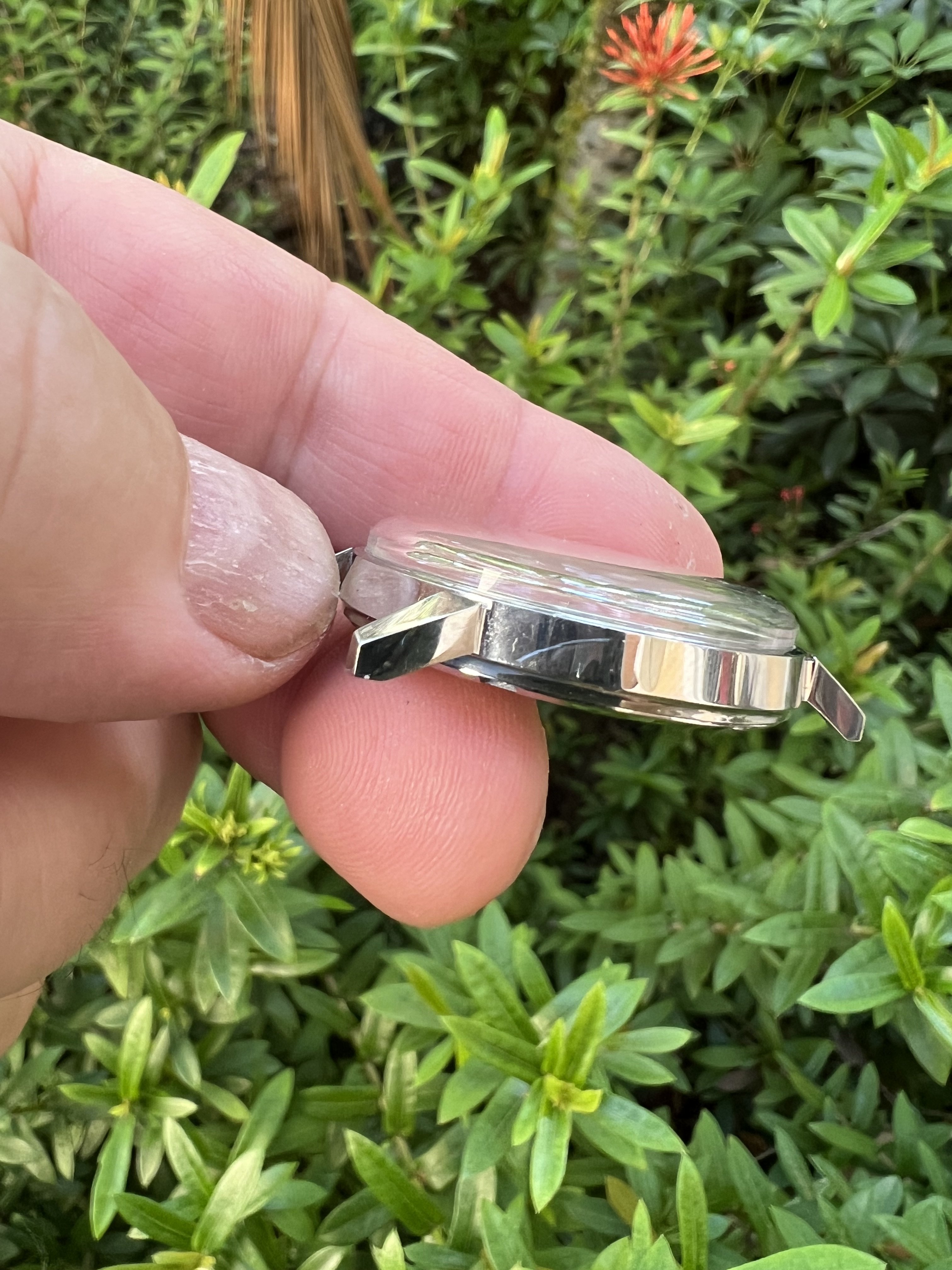

This model doesn’t have a bezel. Here’s mine If it did mine is missing too!

Dont buy this one OP- there are plenty of decent ones out there at this or lower price. Its a nice basic handwind watch with solid movement- take your time and research the reference. Be aware there are "mid size" versions which are not often disclosed by sellers

PS that case back does look awful.

That is not a seamaster 600 case, nor is the hugely overpolished caseback a seamaster 600 caseback.
As the Sam600 is manual, the ref no should start 13x.xxx, not 16x.xxx. Generally it should be 135.011 for a 34mm no date.
Finally the dial is certainly refinished.
Huge pass, even at $250
