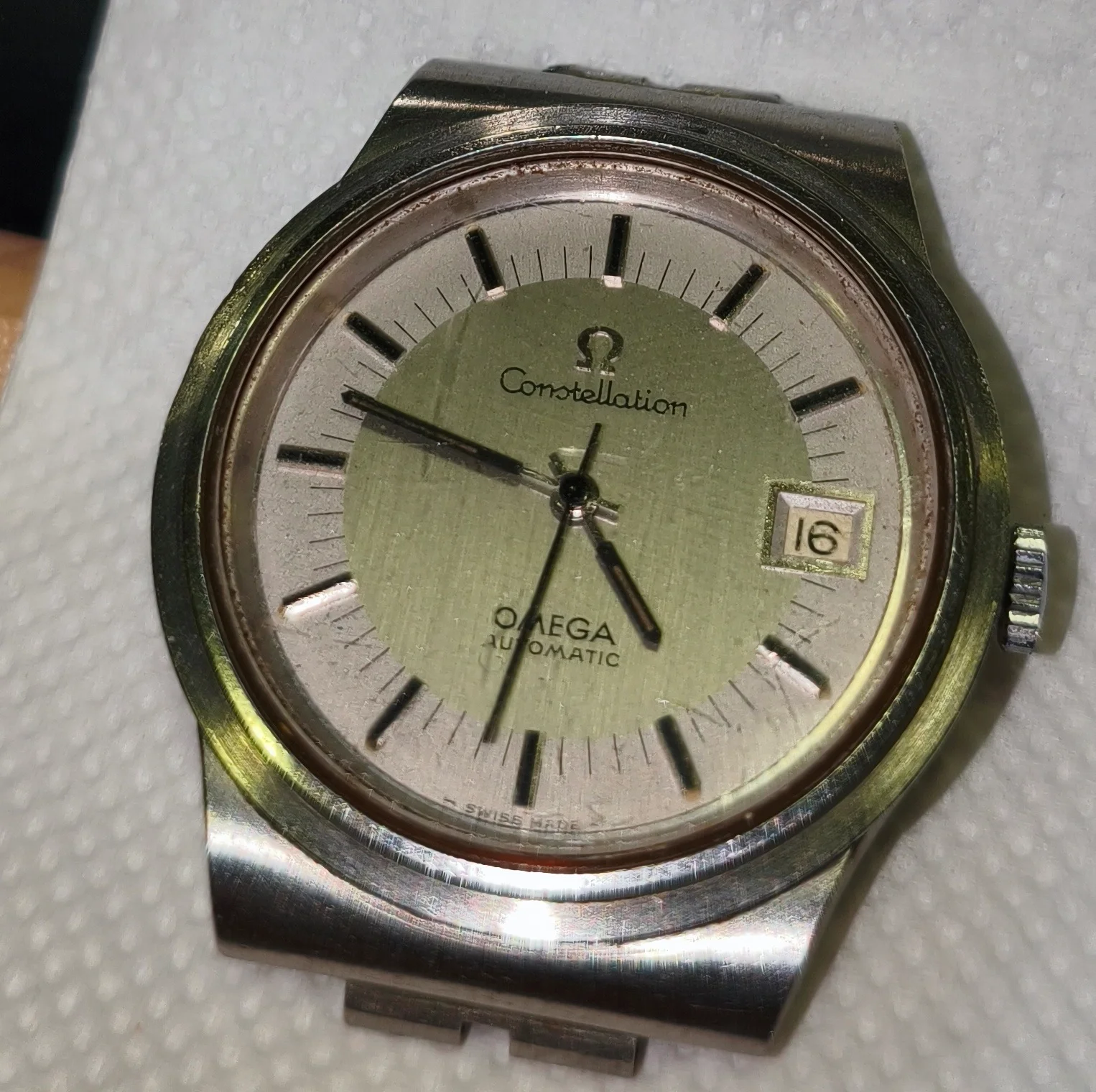

need some info about this watch
8
Hey to all !
I need some info about this watch,
Does it worth restoring it and buy a bracelet ?
If yes anyone who can sell me ?
I live in Athens, Greece.
Atm it works perfecty as it is automatic.

Hi hammerd79 welcome to Omega forums. If its worth restoring a watch is up to you. If the watch have sentimental value most people feel that a restauration is worth it. If not, I think most people on here would say no.
A restoration could be had cheaply from a watchmaker or expenciely from Omega in >Switzerland. Prices from app. $ 300 to $ 800.

You should confirm that it is authentic before investing in a repair.

How can i do that ? who can confirm it ?

Post better photos and provide some context about the watch. Where did it come from? Does it have sentimental value? What do you want to do with it?
Finding a bracelet for that type of watch is difficult and even if it is authentic, Omega watches from that era aren't terribly desirable.
8
This watch is a gift from my uncle, it has sentimental value as my uncle has passed away, i wanna use it as a daily watch.
I do not know any info about this watch, i destroyed as small kid its bracelet as far as i remember 30 years have passed since, maybe more...
I will take more photos and post them so it will be easier to find a bracelet for it even if is not authentic, i do not care.

That fact that it has sentimental value makes a big difference. You will need to be patient, gather information about the watch, and search for a bracelet. It's possible that you may need to find another example of the same reference with a good bracelet, and scavenge the bracelet from that one. Unfortunately, some of the bracelets will be in poor condition, stretched out. But with patience, you will find one.
2,684
2,872
Finding a bracelet is definitely going to be difficult, integrated bracelets always are.
Since you said you destroyed the bracelet, I'm guessing it lived a fairly harsh life. I'd suggest getting it serviced of course.
That said... is it missing its bezel? It looks like it should have one.
IF you bring it to a watchmaker for service, start by having them get the reference number from the inside back of the case. You might be able to see what it is supposed to look like, plus the missing pieces, and make your googling easier.
16,002
48,158
Solve the problem of the missing BRACELET before you spend any money on the watch. Only an original bracelet designed to fit that case will be suitable, and you will likely have no other option.

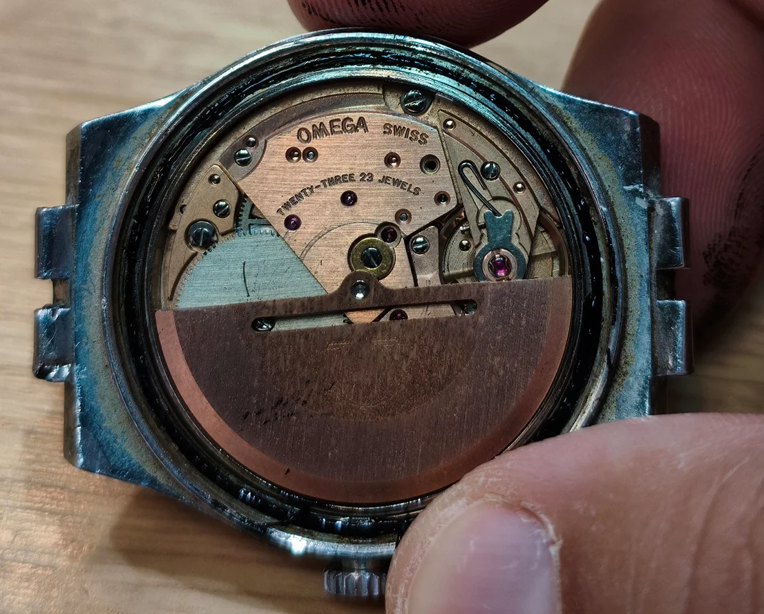

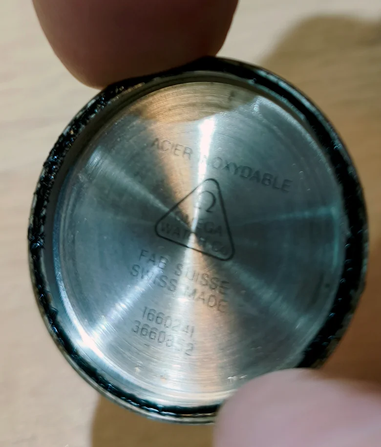

So i took it to service for maintenance. The technician opened it to see the reference number, i post here 2 photos, he told me is 1012 watch.
i hope it will help me to find some more info about bracelet.
712
2,600
Model number is 1660241. Google 1660241 omega
You will get a lot of info and interesting links, and an idea of what it's worth
Also try eBay for same. There is a bracelet for sale, but this watch came with 2 styles the bracelet is for the other style
8
The service will find me one, if not, i will continue searching, ty all !
24,843
55,270
That is going to need some work.
8
but it works fine ! i just asked the technician to check if it keeps working if i am not wearing it overnight and he will also change the melted plastic ring.

Looks at the marks that the rotor has been making on the plates.
8
ok we will see what the service will do and i will think what i will do.
2,684
2,872
Missing screw on the bridge plus some dirt/scum on the movement too. Head on that case screw is ugly too, which makes me trust the last service very little (along with the missing screw!).
BUT that dragging rotor could very well get worse enough to cause serious damage. Where it is NOW, it probably doesn't reduce the value, but a little more damage and its a movement that'll be considered very negatively by future purchasers.
