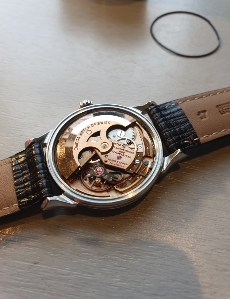

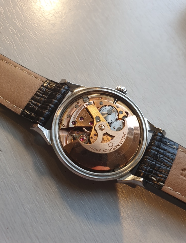

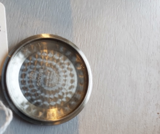

I’m looking to purchase my first omega (a vintage one at that) - a 168.005 constellation pie pan but I am unsure of its authenticity. I am seeking for some advice in regards to my purchase. The seller has kindly sent me a few additional photos which I have attached here.
It’s daunting purchasing a vintage watch but it’s very exciting too! Thank you very much for your time and know that I appreciate it!

Replacement crown

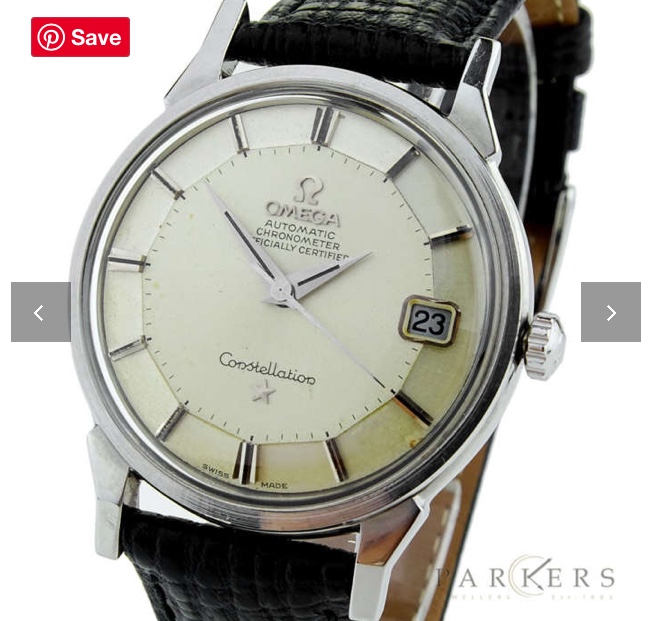

Bit tired dial with damage around 4 (?)
Case polished
What's the asking price?
2,298
3,157
Dial has issues at 4, case is polished, this is no watch worth 1750 Pounds 🙁
Case polished

The asking price was 1700 GBP?
339
547
Replacement crown
Case polished
It's £1750 - Too much IMHO.
Plus, the damage on the dial next to the 4 hour marker would be another reason not to buy it.
978
4,540

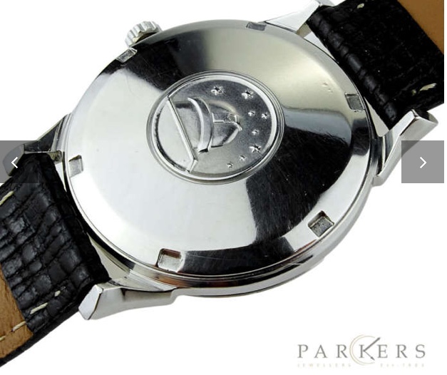

I agree - let this one go. You can do better from established dealers on ebay (i.e. with extensive stock and strong vendor results). And I would be looking for an earlier one with the gold observatory on the back....

You've already been told exactly what it is in your other thread. :whipped:
