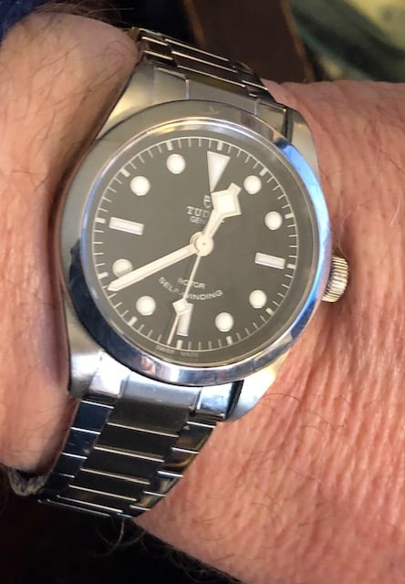

I wear my Uncle Seiko on my Tudor BB36. It is light and strong, the perfect companion.

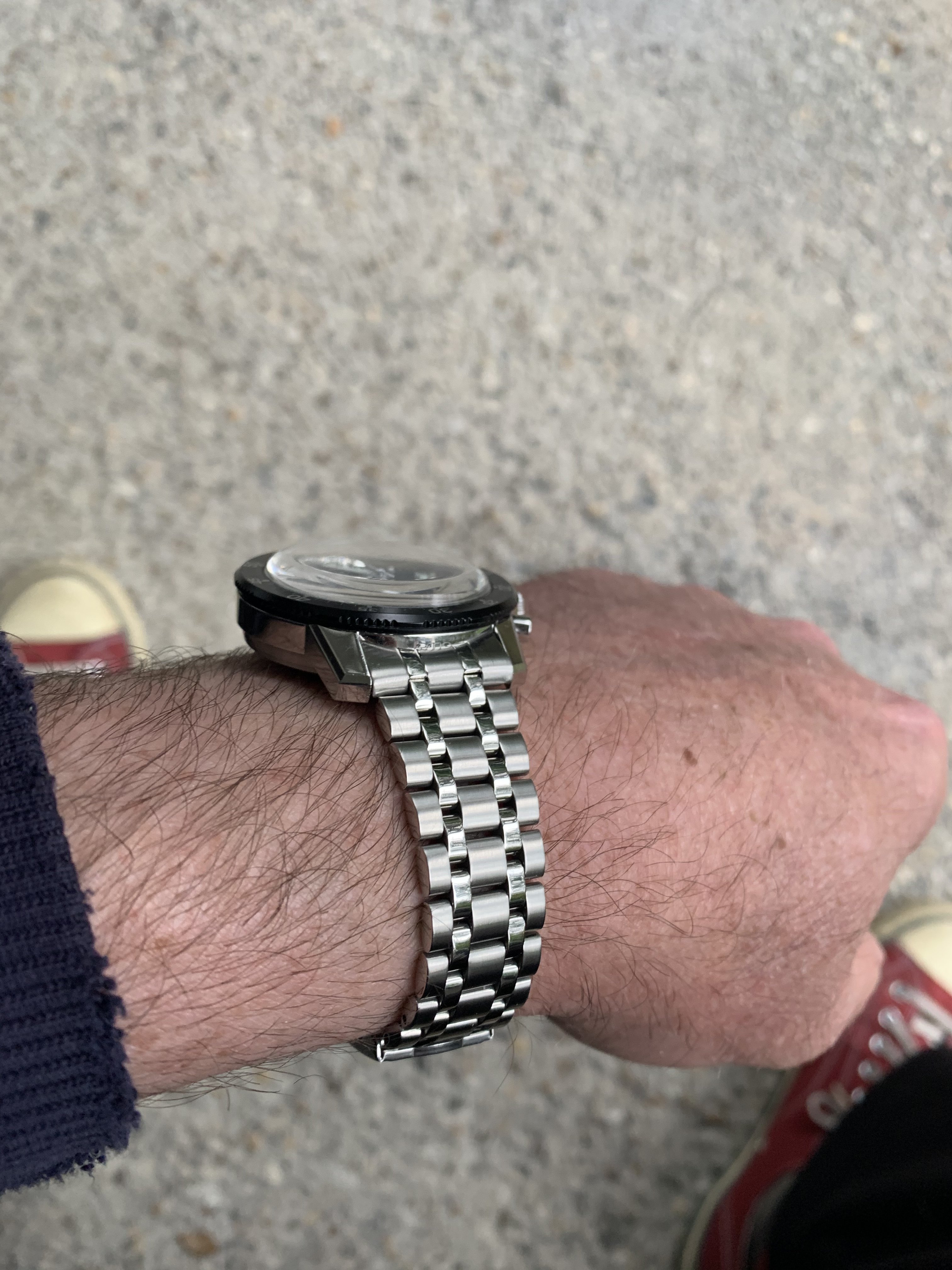

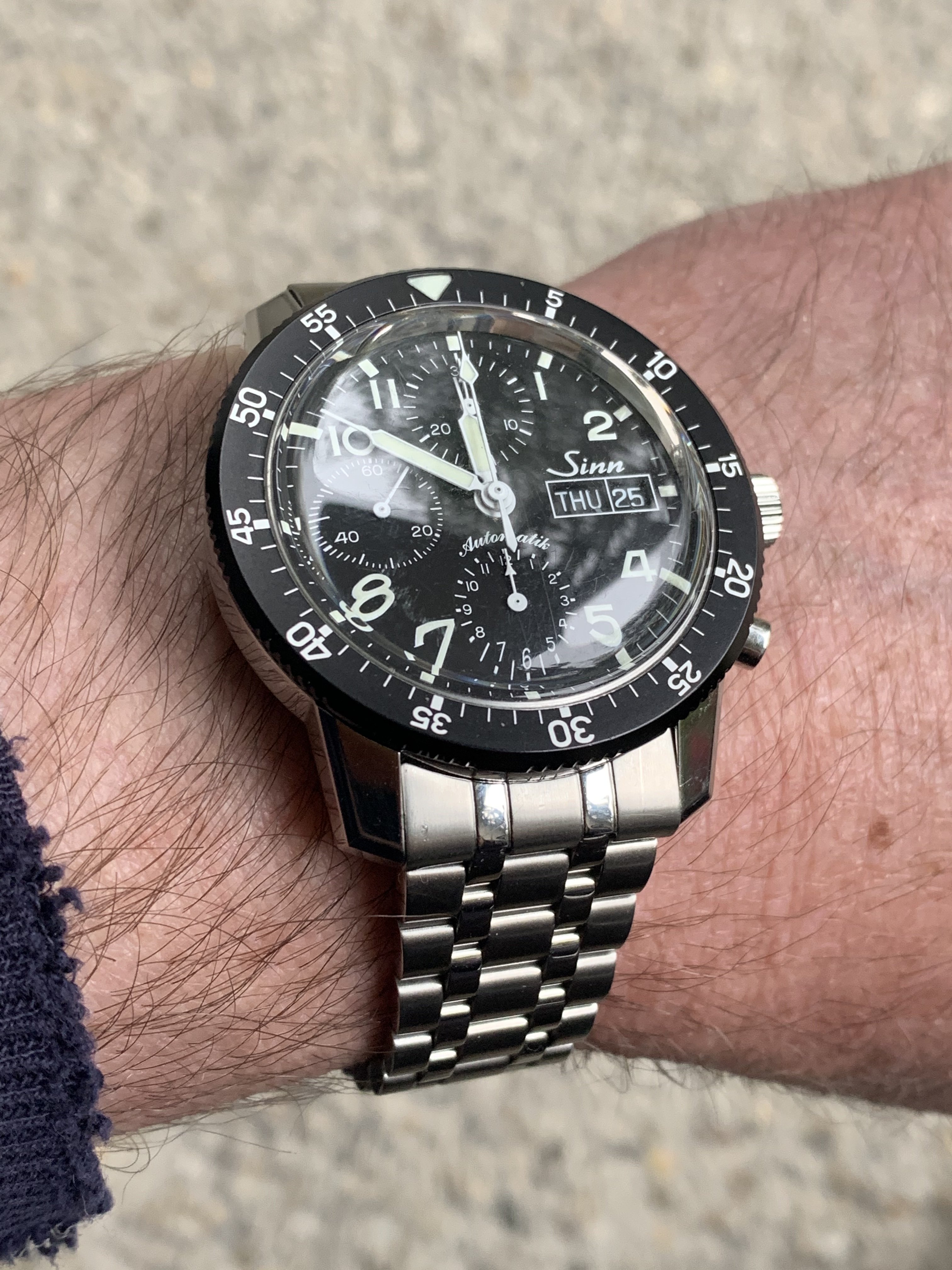

Just threw myself a curve ball and threw my US Holzer on my Sinn 103. I bent the endlinks up to match the lug profile better (benefit of stamped Endlinks)- getting close, perhaps a few more tweaks.
The factory H-link is a brick- adds twice the weight to the watch and actually makes it cumbersome- I love how it looks but my god! Plus it’s only a 20-18 taper so looks like a cuff. This gives the 103 a much more “vintagey” look.
Still haven’t pulled the trigger on any of the 18mm US variants- I would want them for watches other than the Speedy reduced, so the endlinks would have to fit a variety of vintage pieces. Anyone tried the 18’s yet?

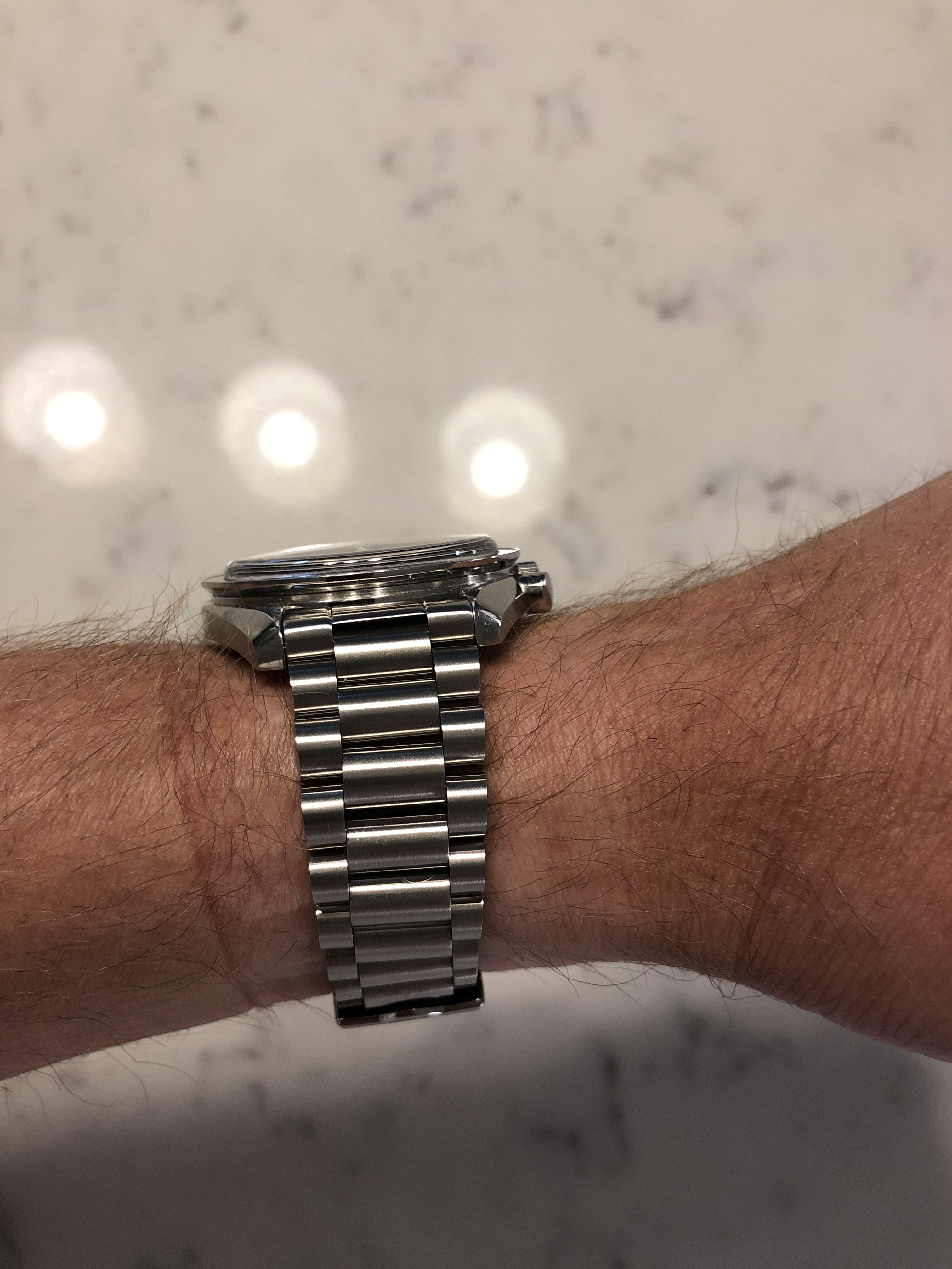

Not sure if you are including the Komfit, or just the newer bands. I'm wearing the 18mm Komfit with my Speedmaster coaxial. The narrow version looked ridiculous in my opinion (as I had posted), but I like the 18mm. It also saves a lot of weight (70g) over the original bracelet combined with 1154 adjustable clasp, 108 gram vs 180 gram.

That's the fun of the Komfit, being narrow, that is (and it's 1mm wider than the original vintage ones) . And this is my opinion. ... 😀

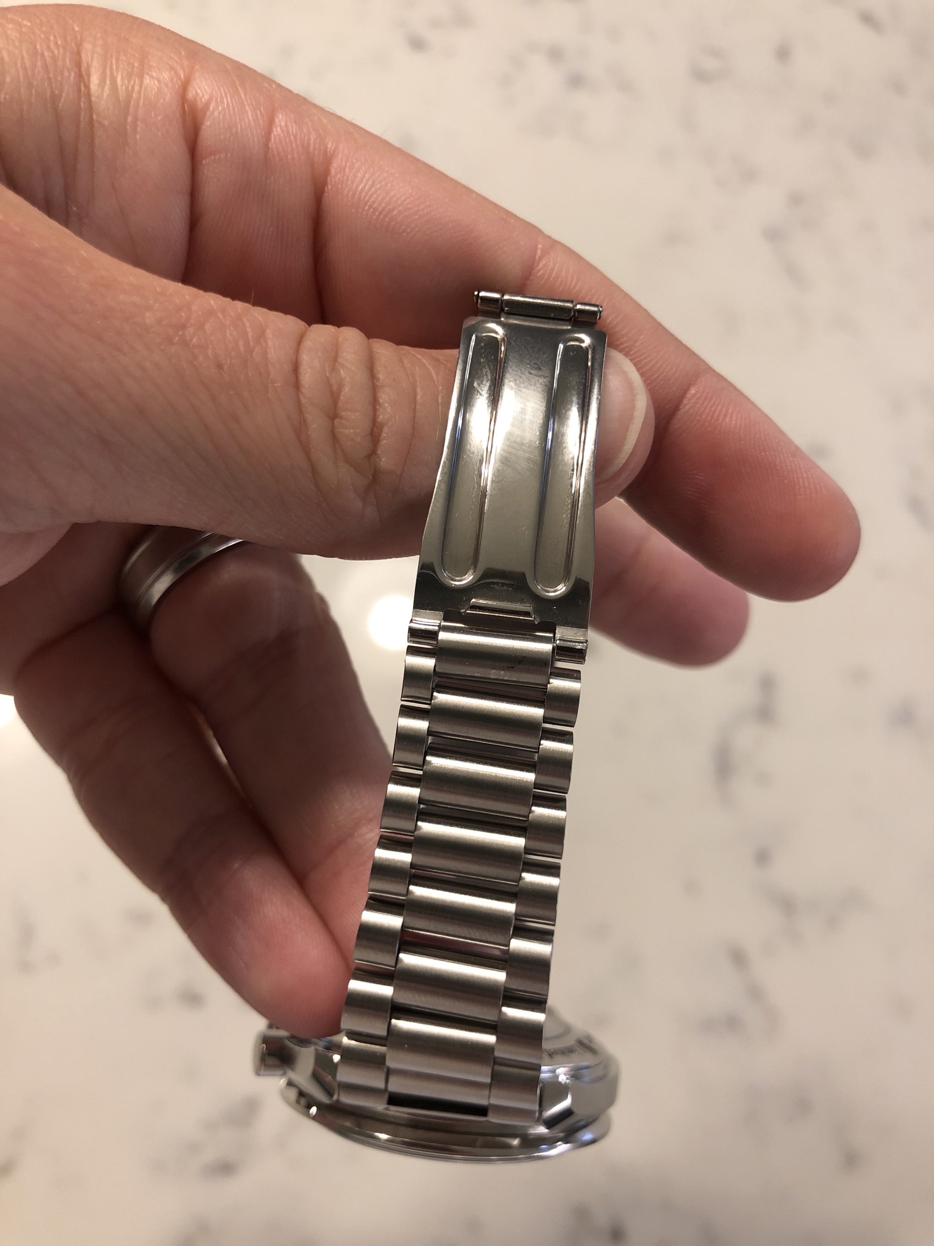

Got my US1450 today, for those that care to know, the Omega eBay clasp discussed earlier in this thread for the US1171 fits perfectly. That said, the updated US1450 clasp is very nice, as are the SELs. Another knockout item from our favorite Uncle!

Got mine today as well, ordered this Omega clasp from eBay that should arrive Friday.
Question about putting the clasp assembly on. One end is obviously just a spring bar for the micro adjust, but the other end appears to be a solid metal pin pressed in, holding the clasp to a link. Can this just be pushed out with a pin pushing tool to install the new clasp?
64
76
Yes, same as removing the pins from the links. It’s a bigger pin, but simply presses in and out.
