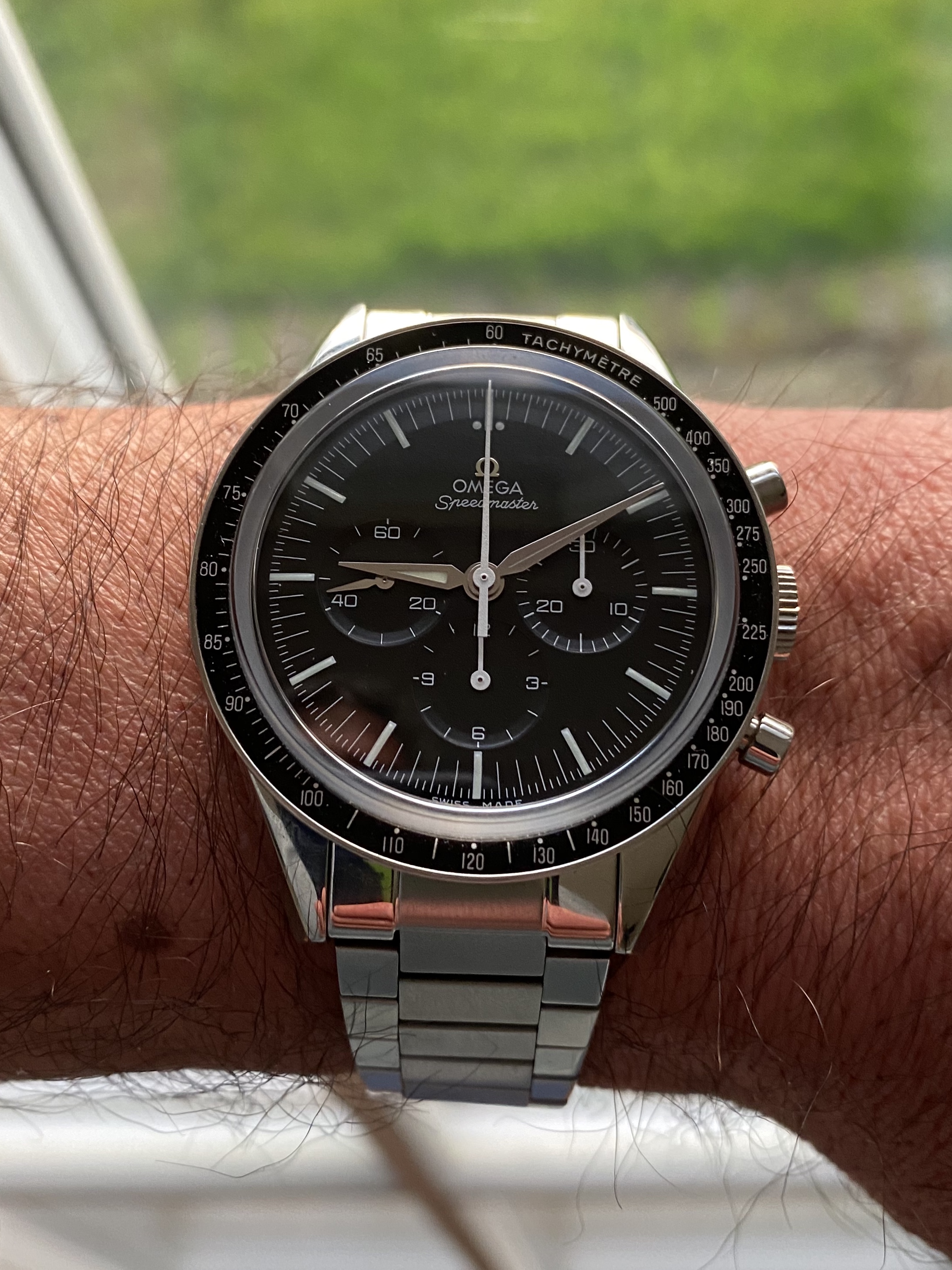

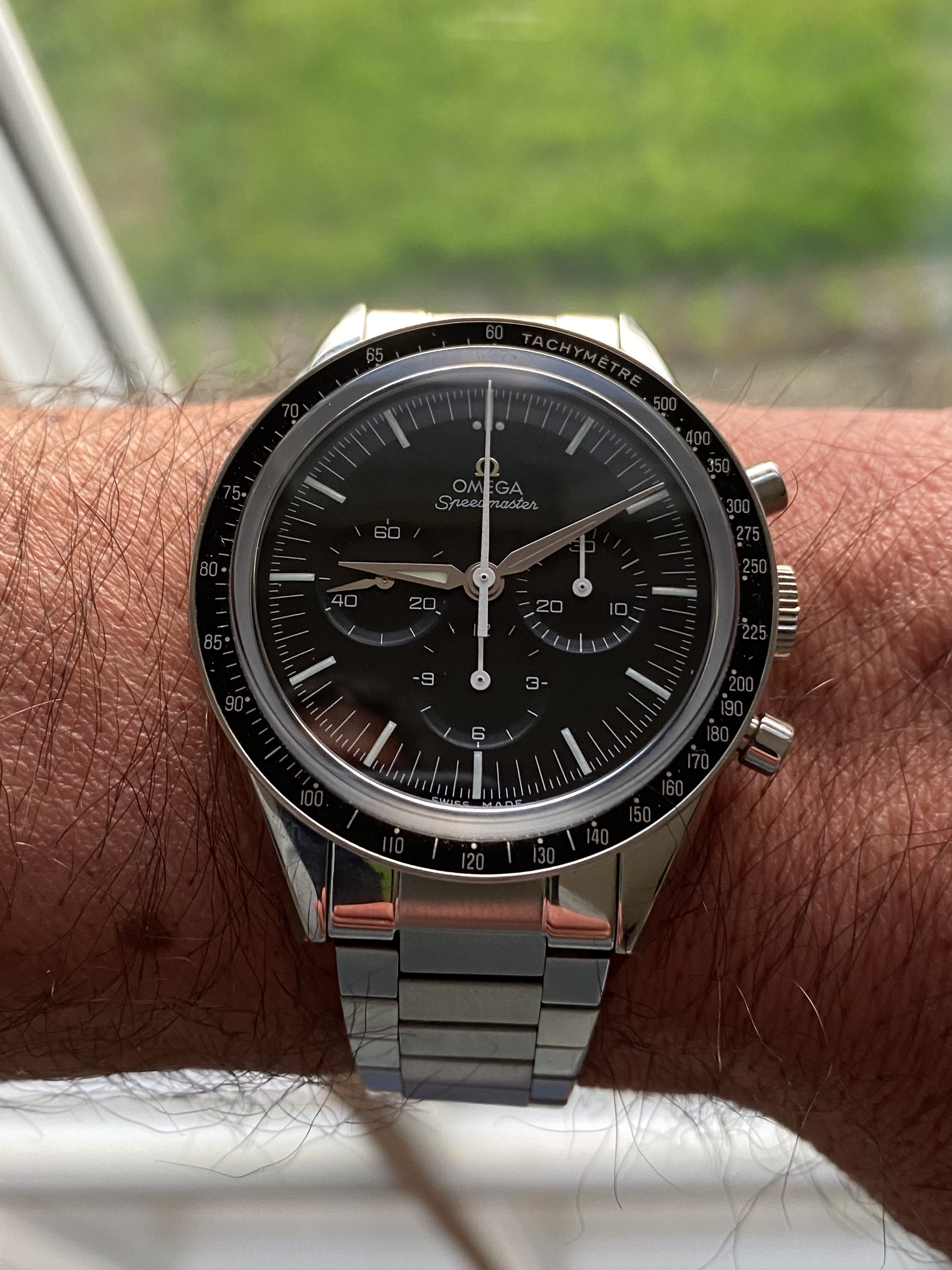

Hi everyone,
Received the US flat link bracelet. Record time!! 7 days to Spain.
It looks great !!!!

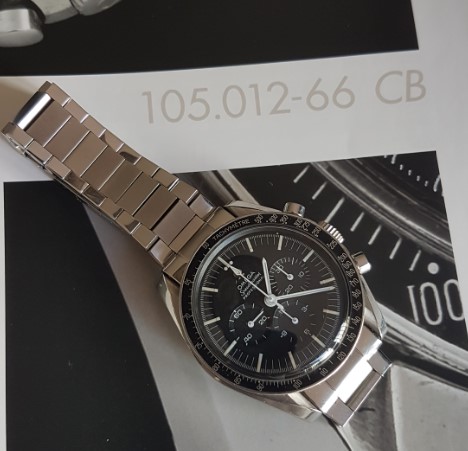

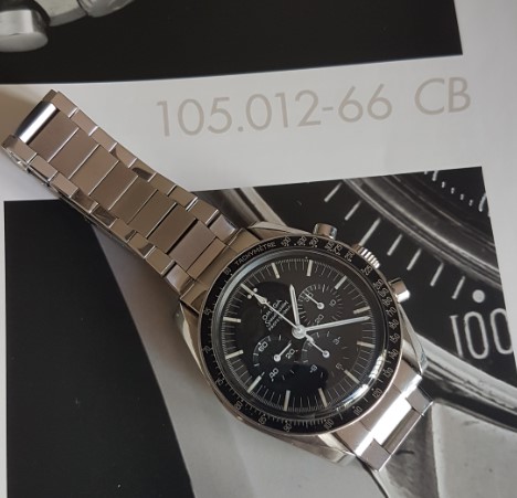

Some very quick shots of my freshly arrived flat links (8 days shipping only to France) with my Holzer too,

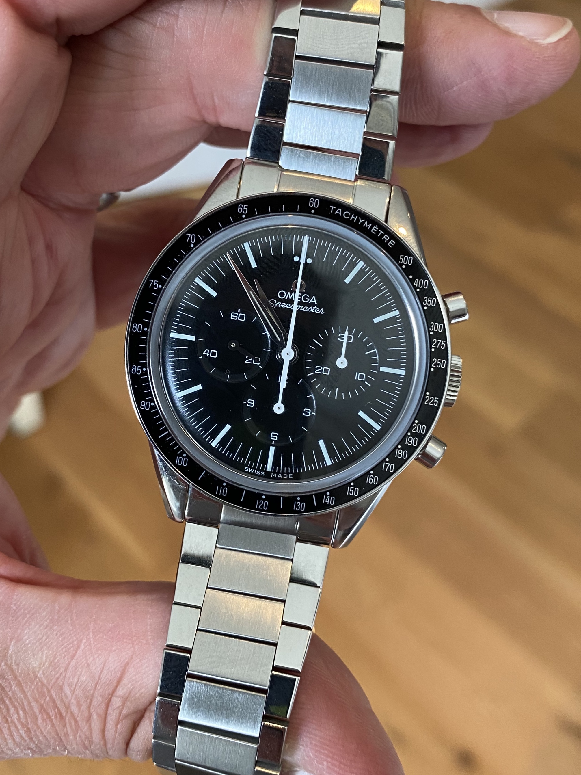

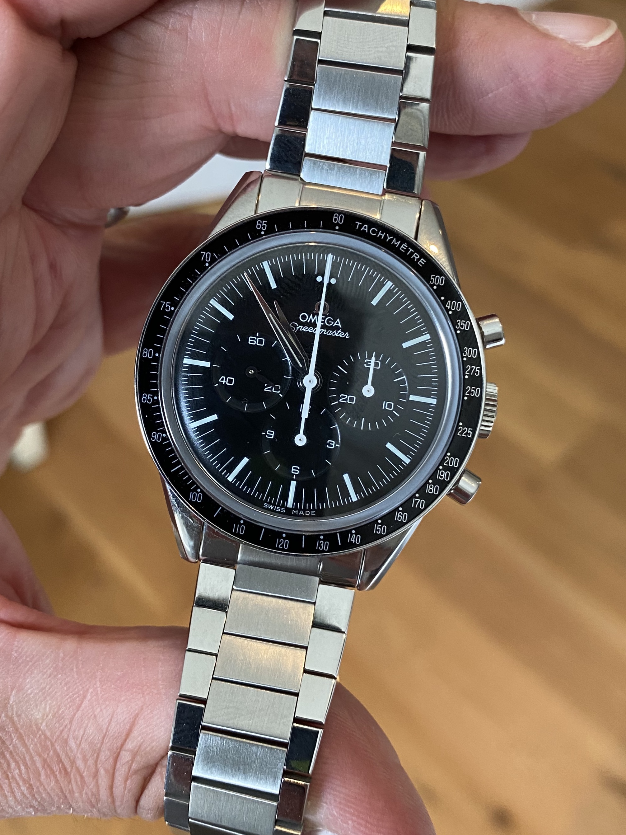

I received my flat link bracelets, one all brushed and the other polished.
I am having some trouble with the installation though, as the end links are hollow and also very tight. Dovyou guys have some tips on installation? Some scratching of the backside of the lugs also seems inevitable.
795
1,159
By tight you mean from the sides or from the top and bottom?
If from the sides, you need to file them down gently and evenly.
And if from the top and bottom, you need to widen them up slowly and just enough for them to slide in.
