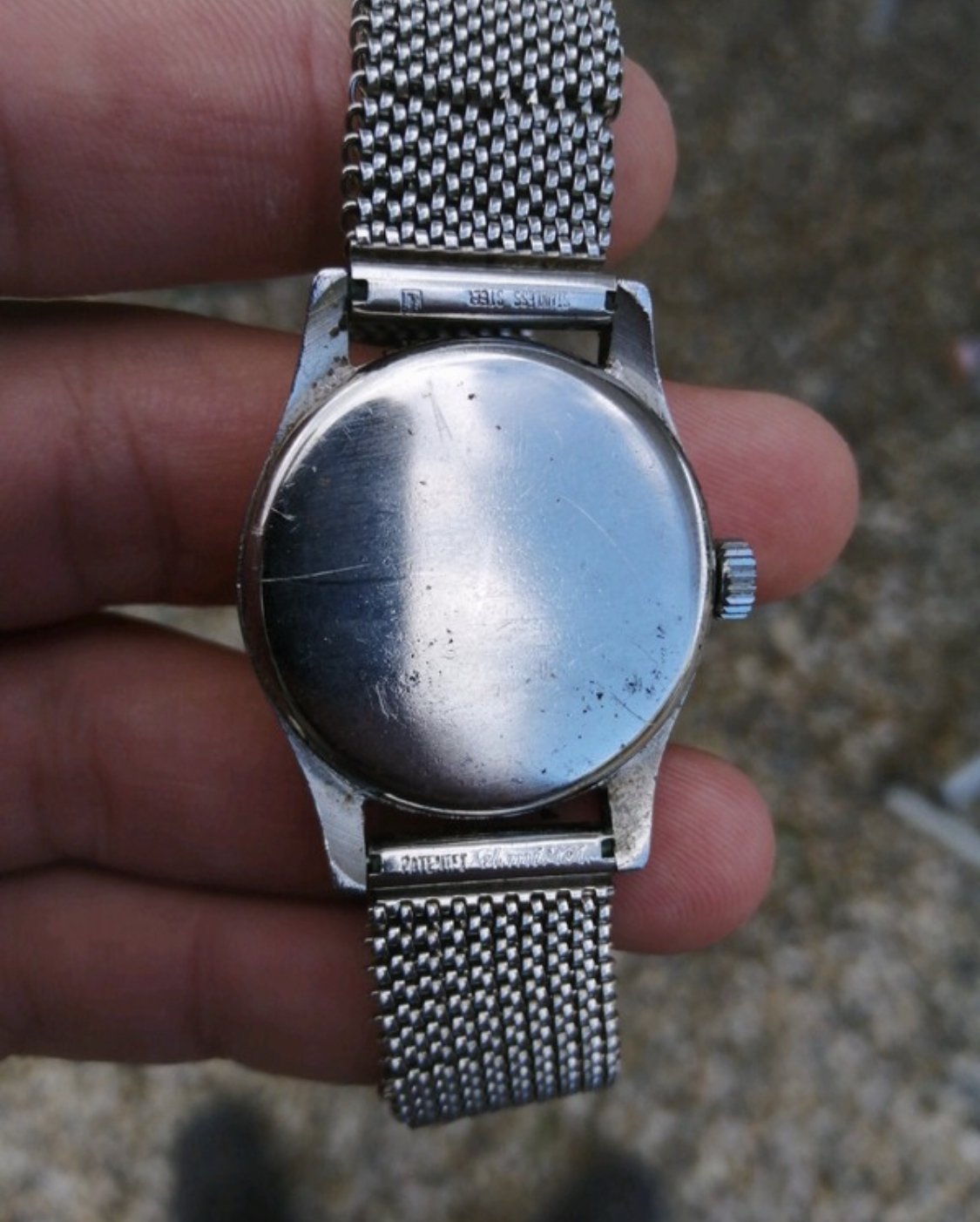

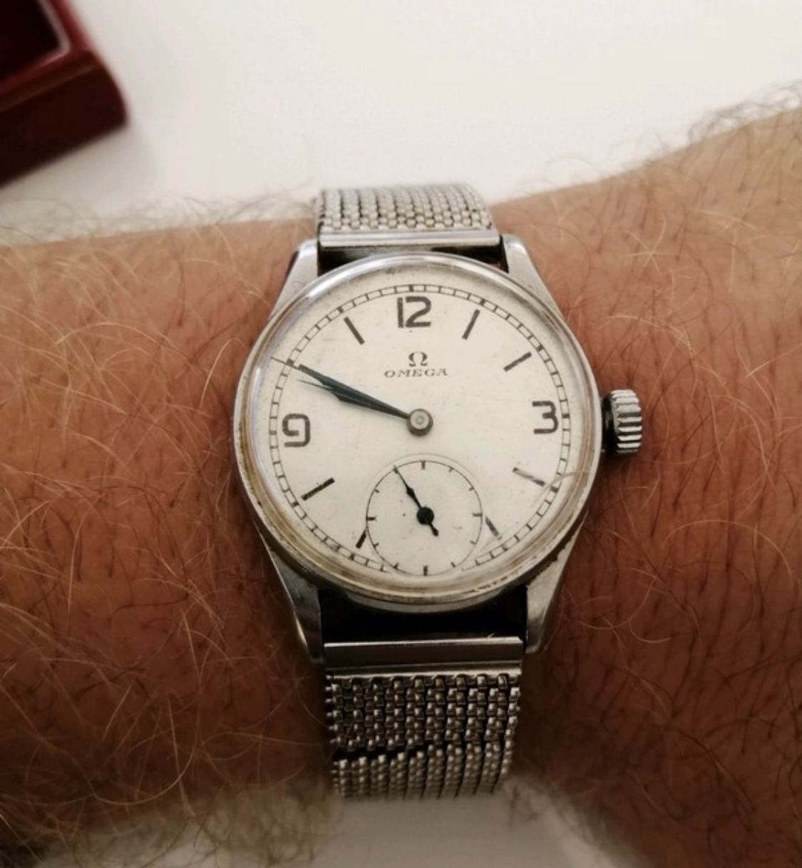

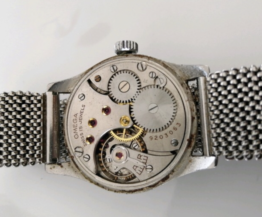

i would like to know if some of you have some information about this watch I’m about to buy ?
According to the serial number the date is 1940 and I guess the caliber is a 30t1.
But do you have further information about this model? And what could be the right price for it?
Thank for you help.

If it matters to you, the dial appears to be refinished. In general, I don't recognize the design, but the most obvious tip-off is the off-center sub-dial printing. And the hands seem too long. As you know, things that are not original do affect value.
10,053
57,246
If it matters to you, the dial appears to be refinished. In general, I don't recognize the design, but the most obvious tip-off is the off-center sub-dial printing. And the hands seem too long. As you now, things that are not original do affect value.
Agreed, a redial. Notice in particular the bottom of the seconds subdial.
