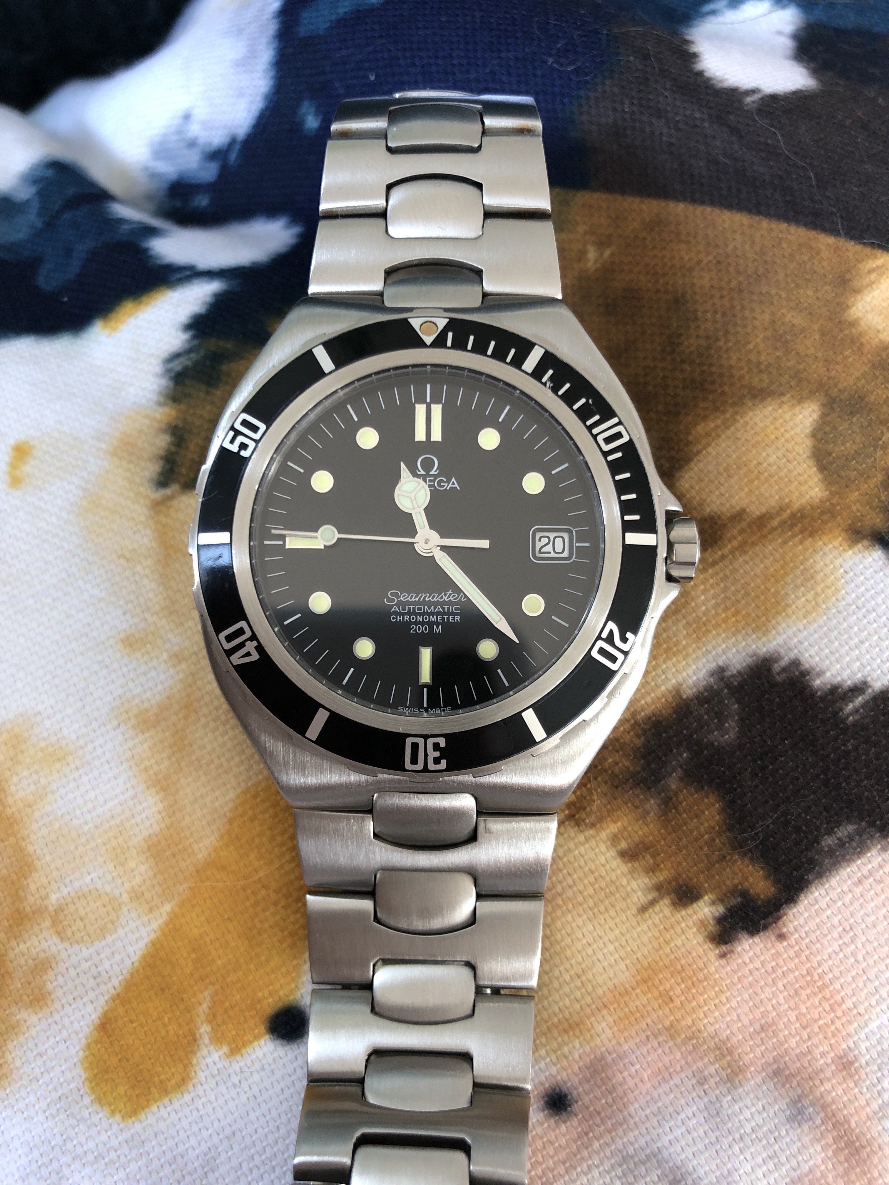

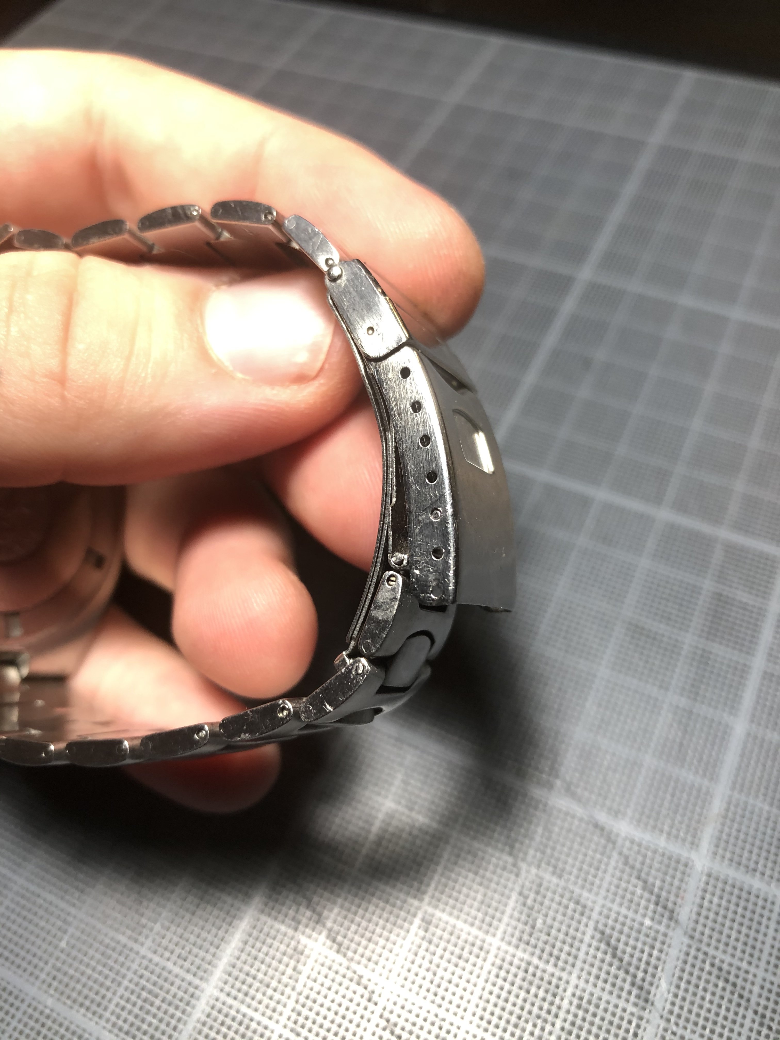

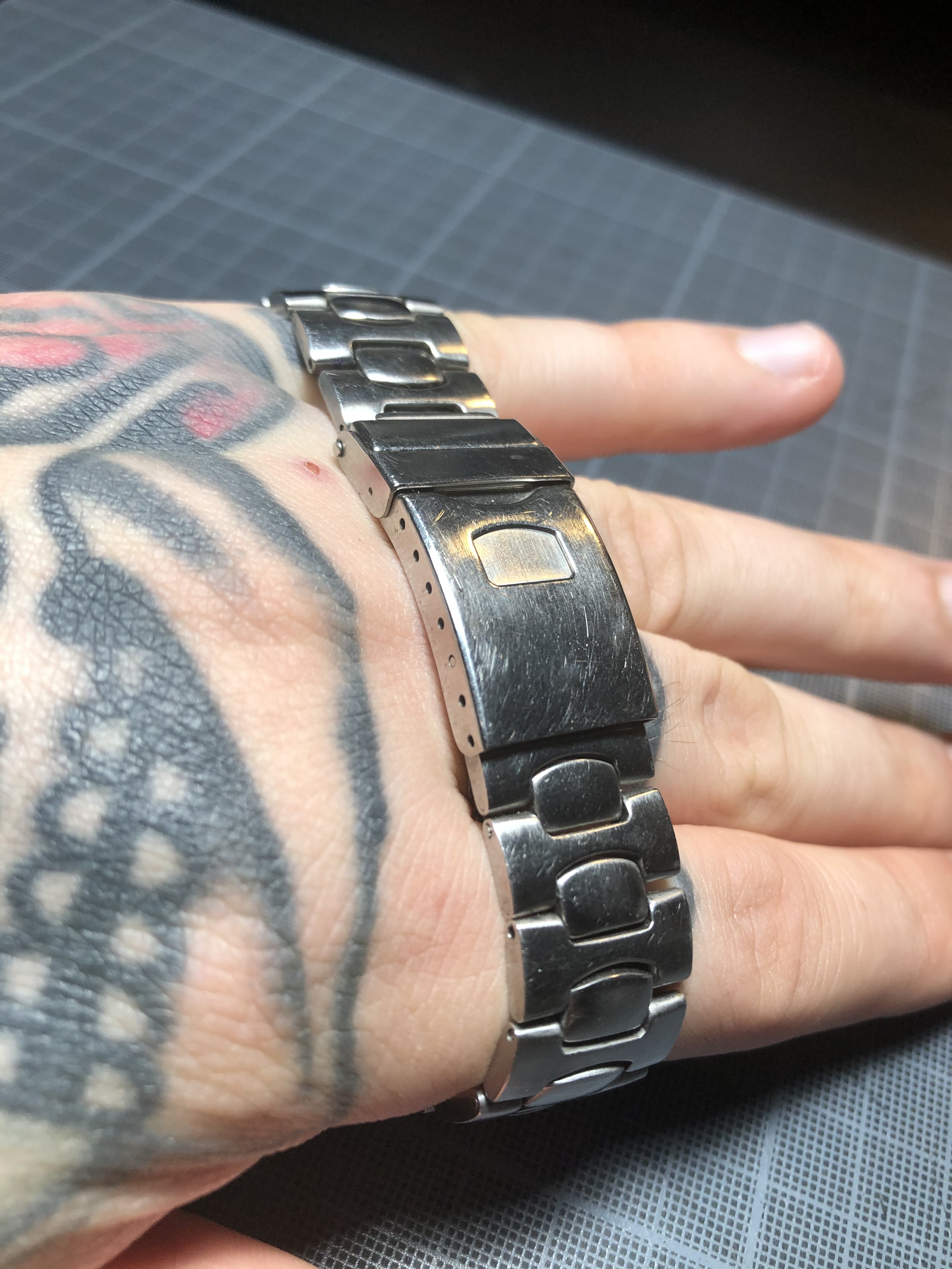

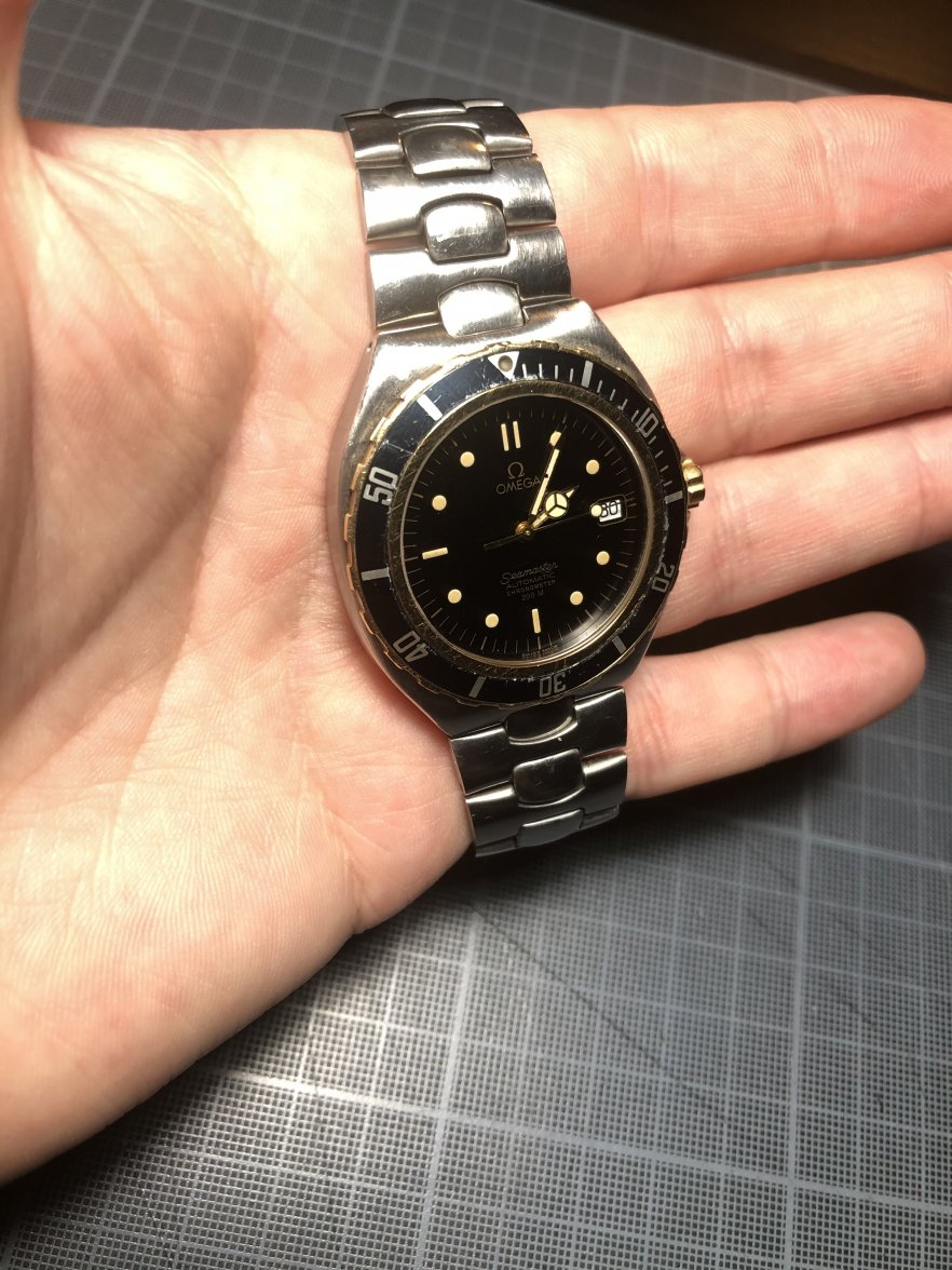

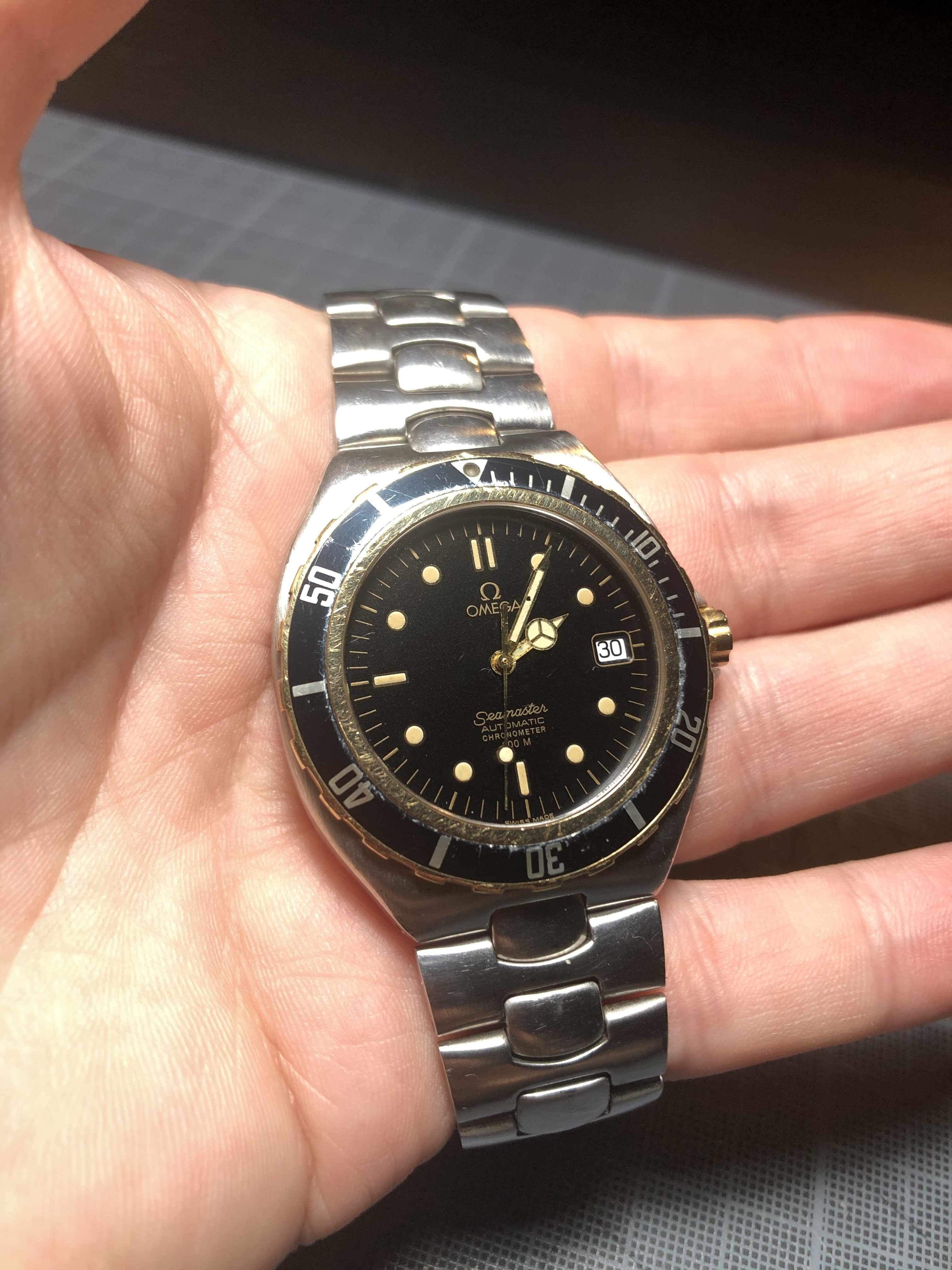

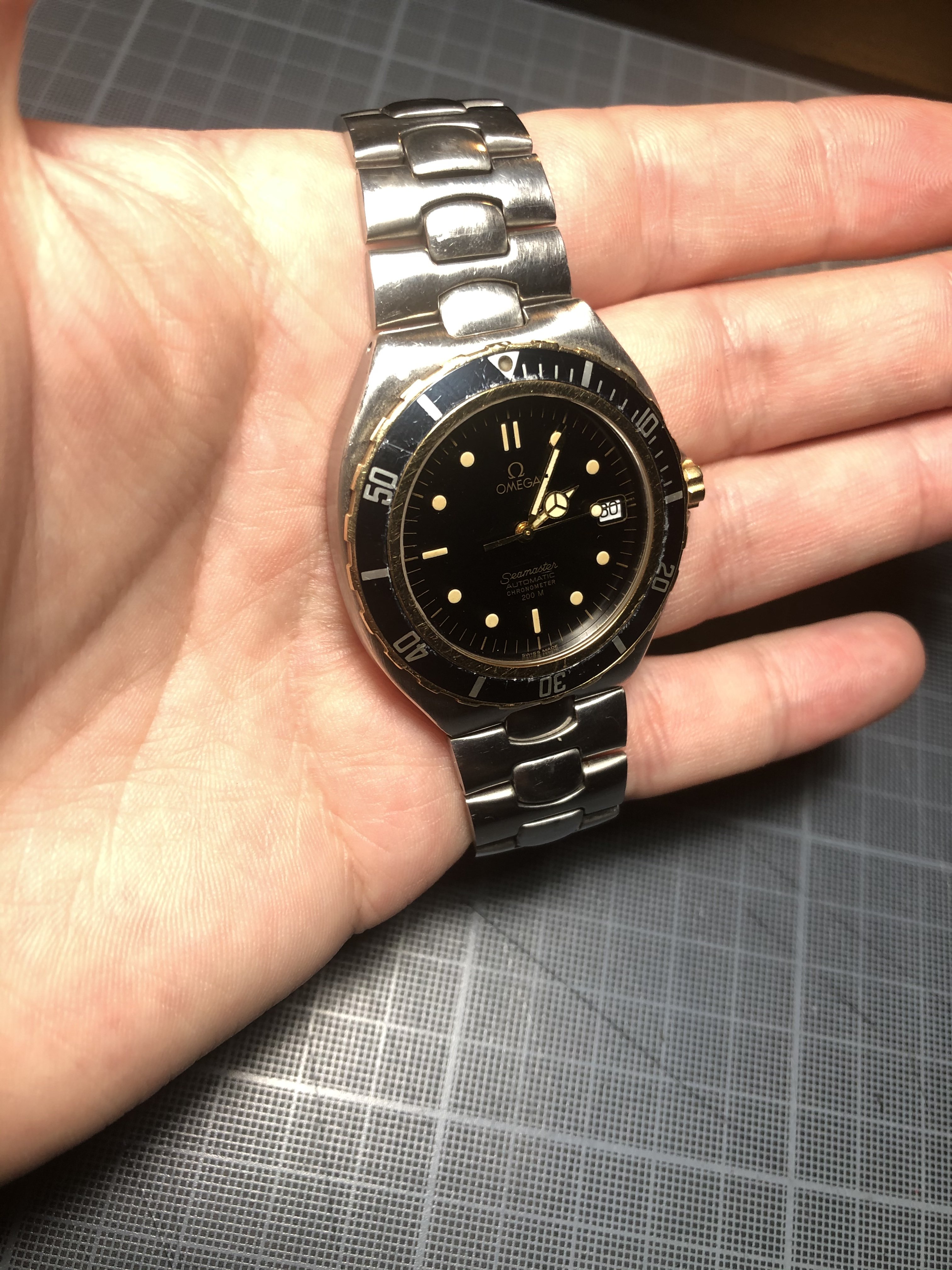

So I am looking for some advices from people who know a bit about the omega seamaster 200 (pre-bond).
I bought this watch during one of my travelling to the states few year ago, and never really wore it, as I fall for a Rolex (sorry...).
It’s not in the best of state, so I am split between selling it, or giving it a new life.
It’s a full size, automatic mechanism, everything run perfectly, but I am struggling to find the right reference and year.

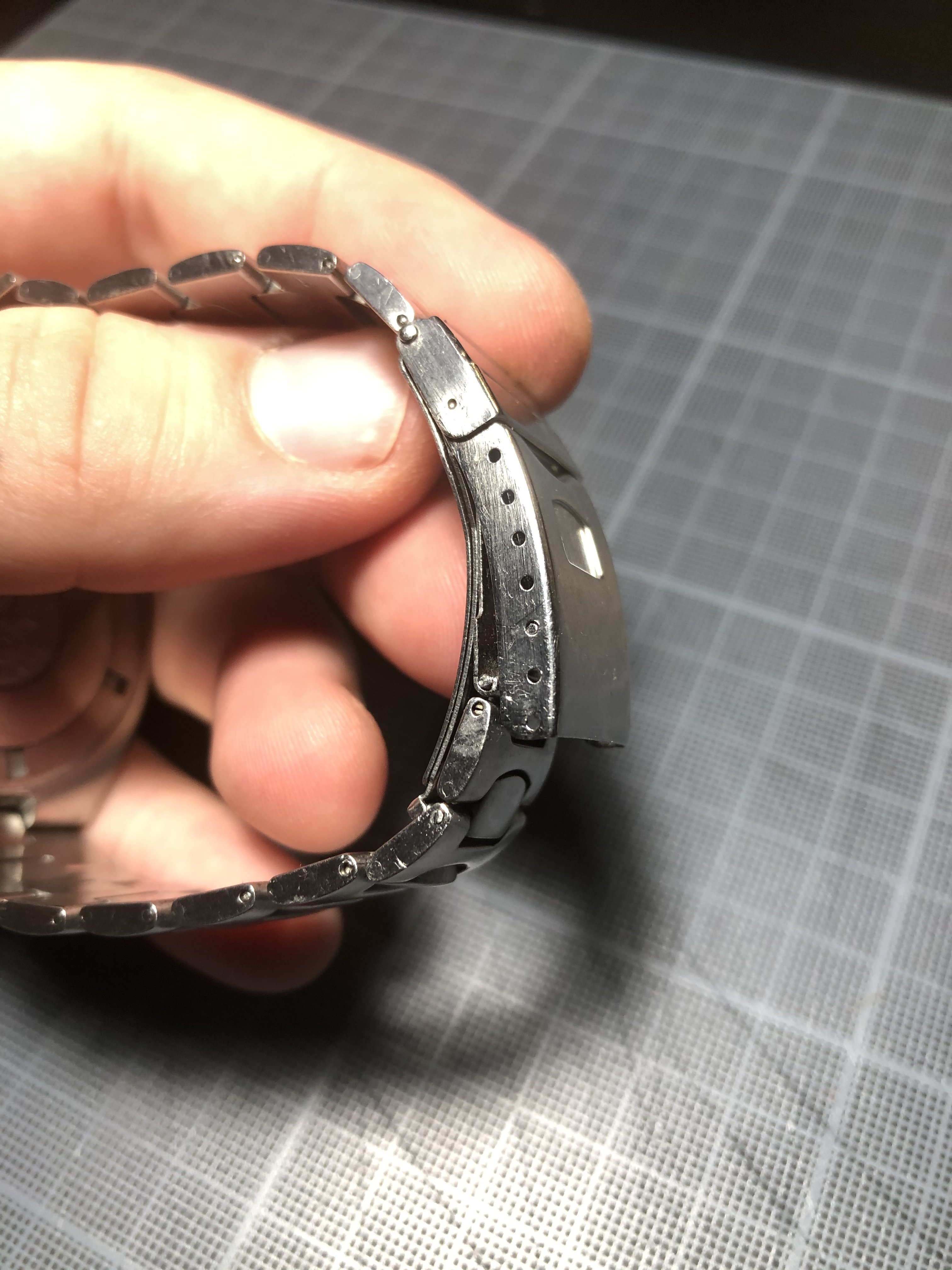

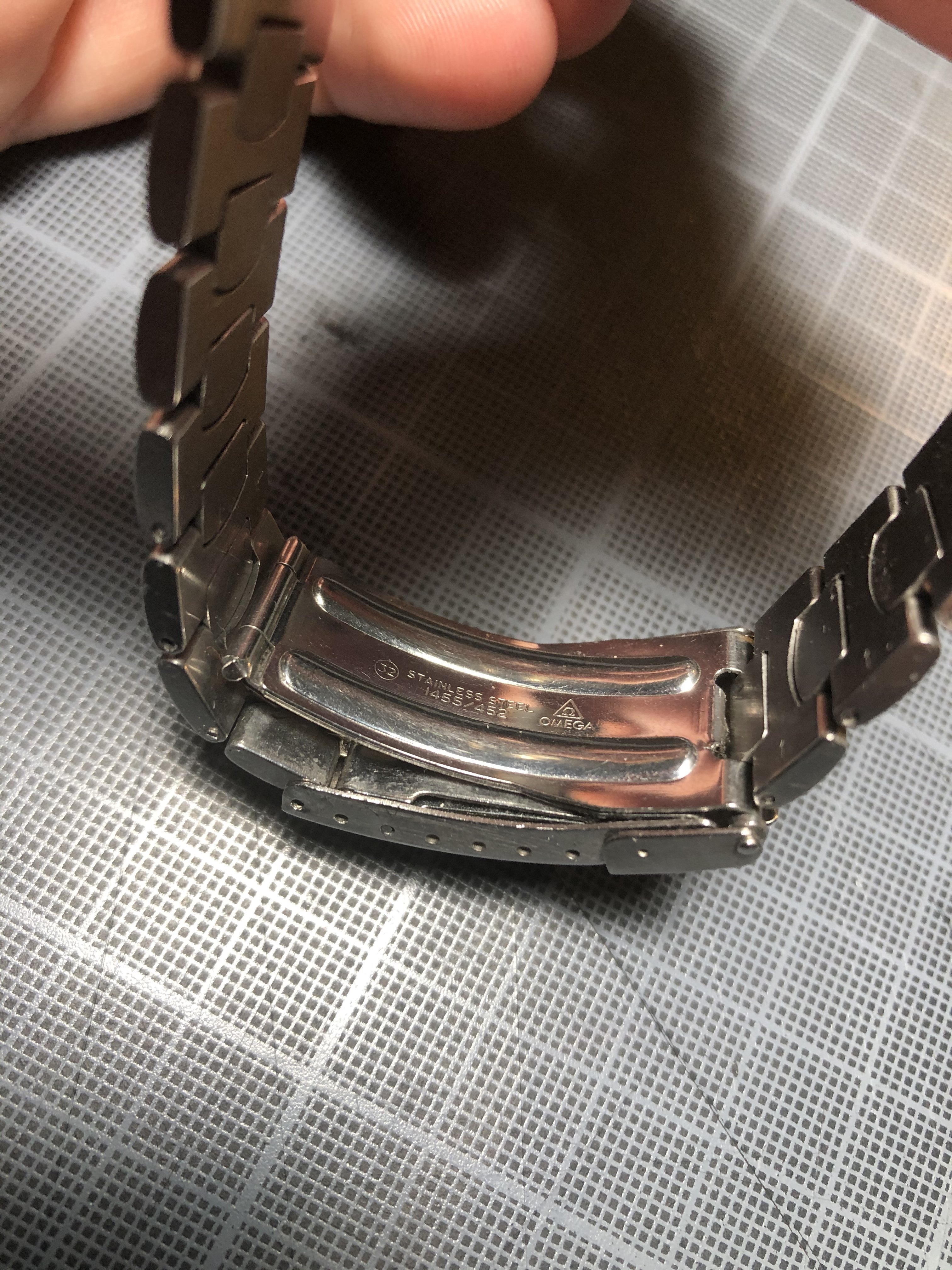

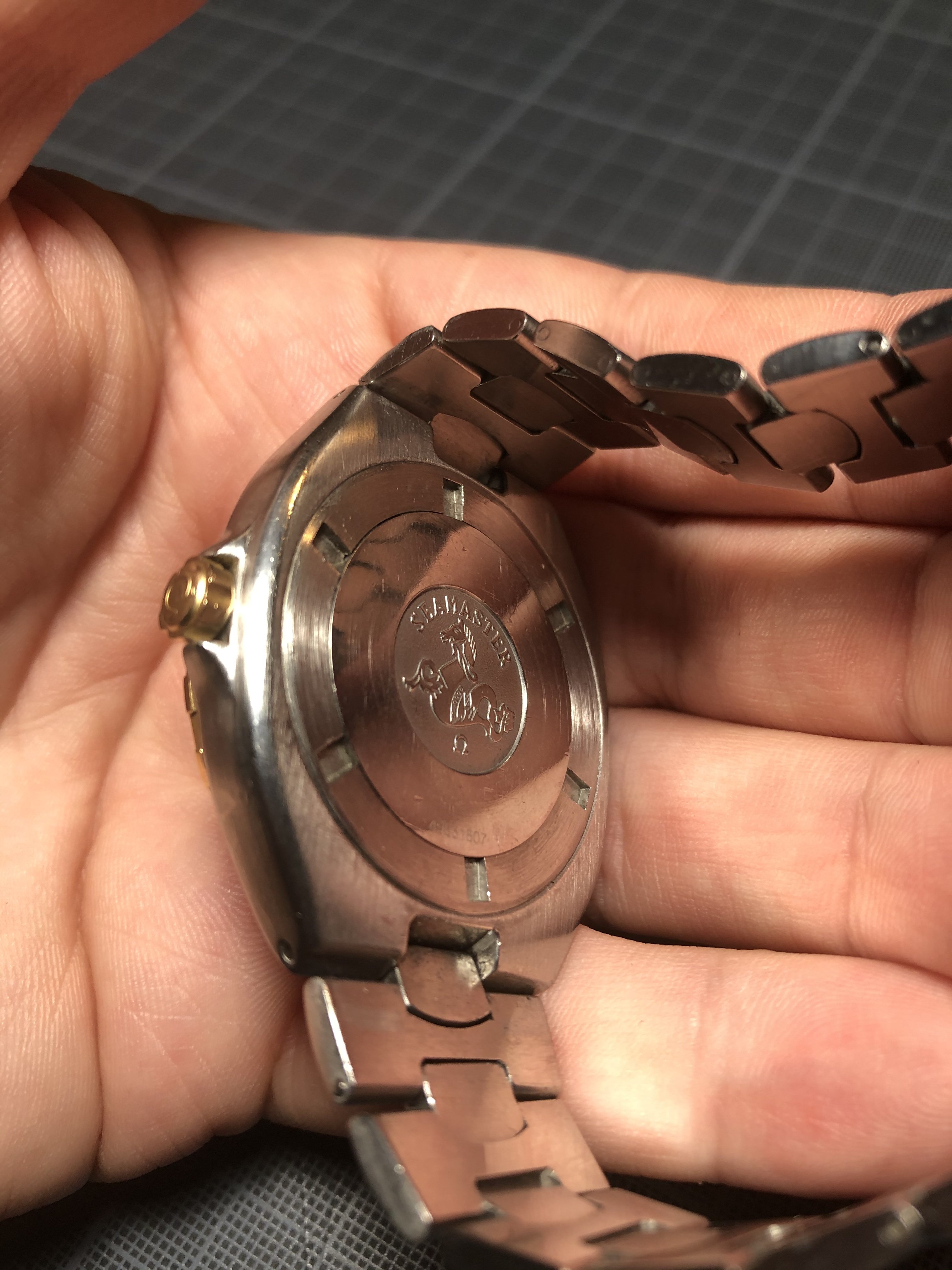

I will just post picture of it here, and i would love to know what do you think about it, if someone is able to give me more info, and why not even a quote of this model, that will help me to know if it’s better to sale it as it is, and pay for a full service etc...
sorry for my English tho, that’s not my main langage.
thanks!
2,059
22,210

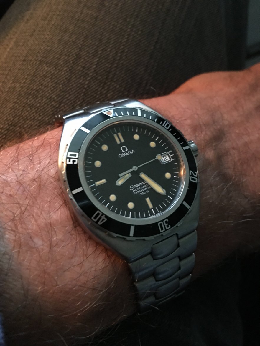

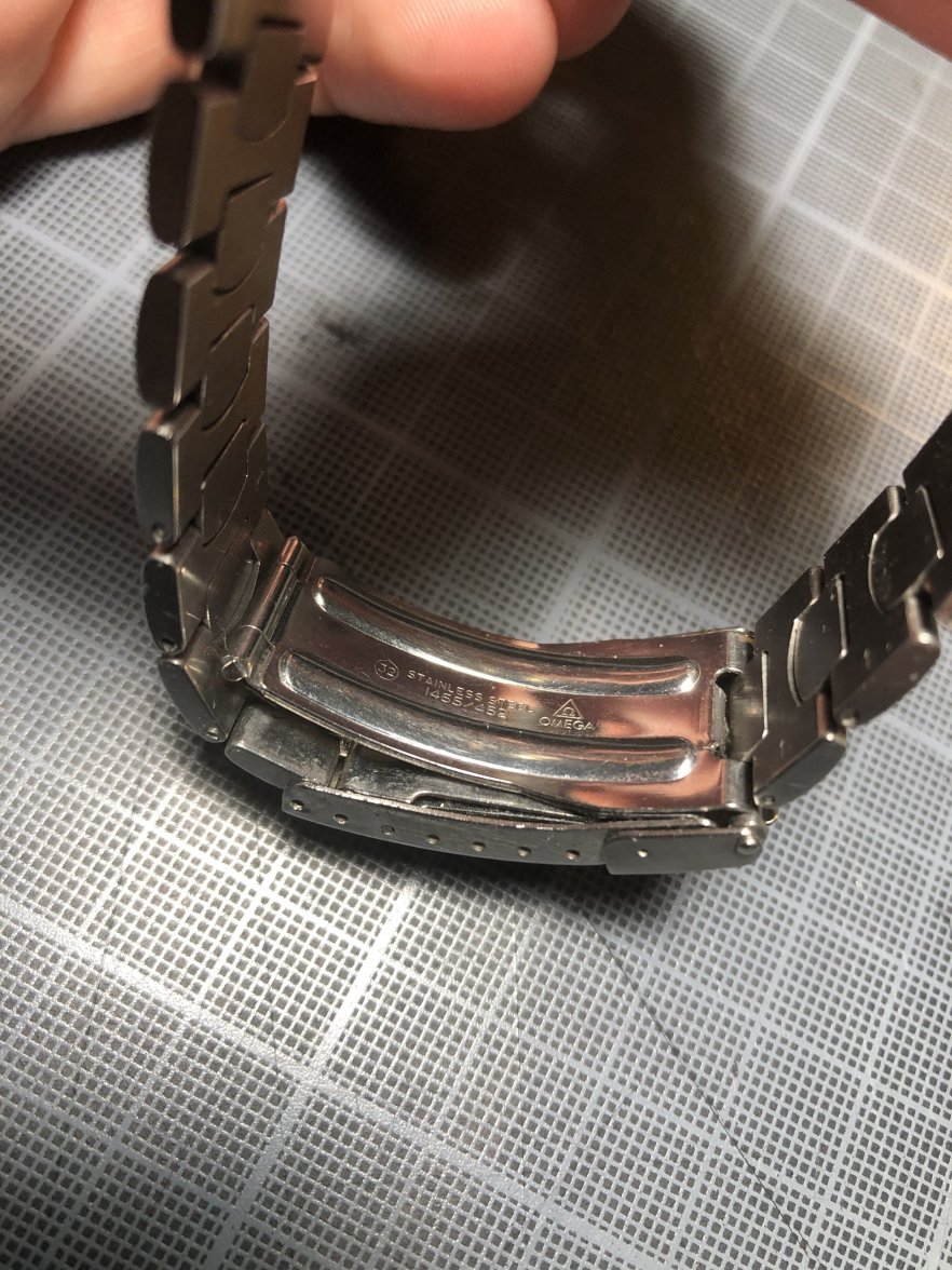

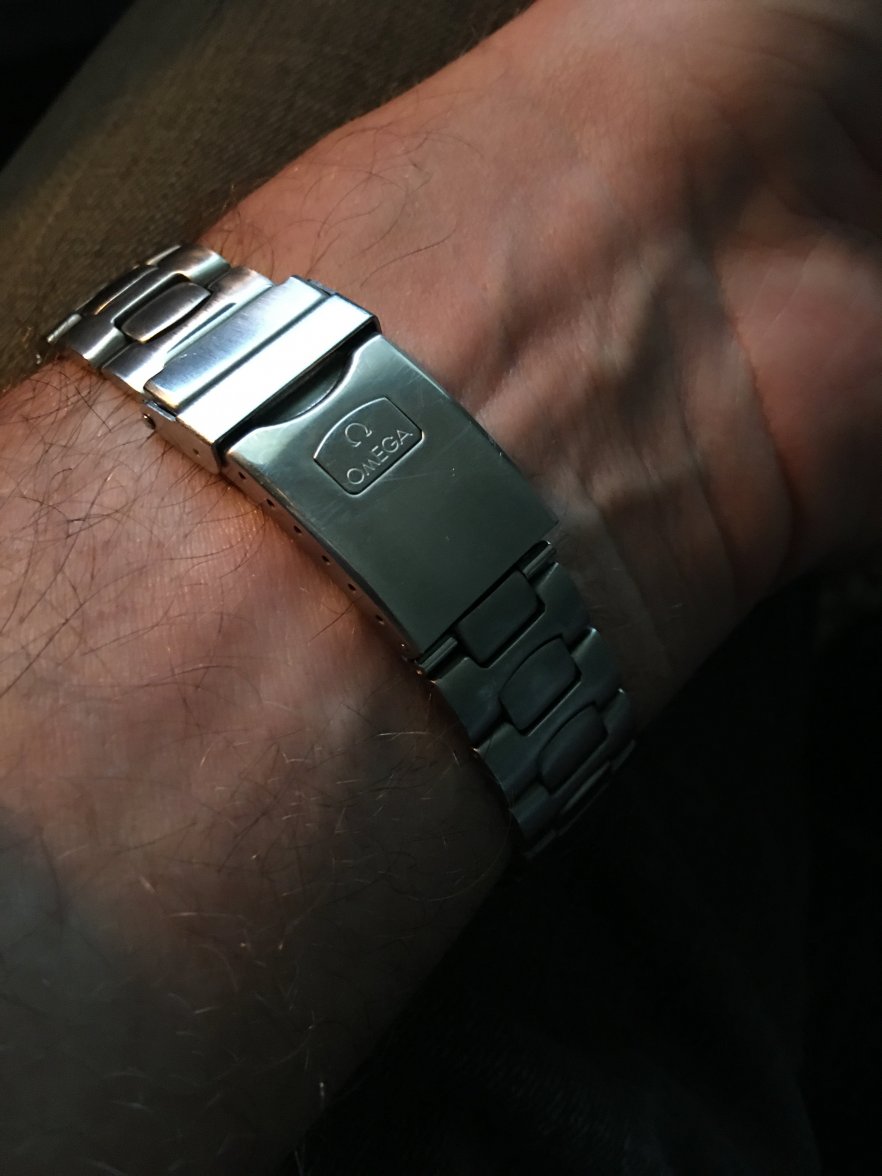

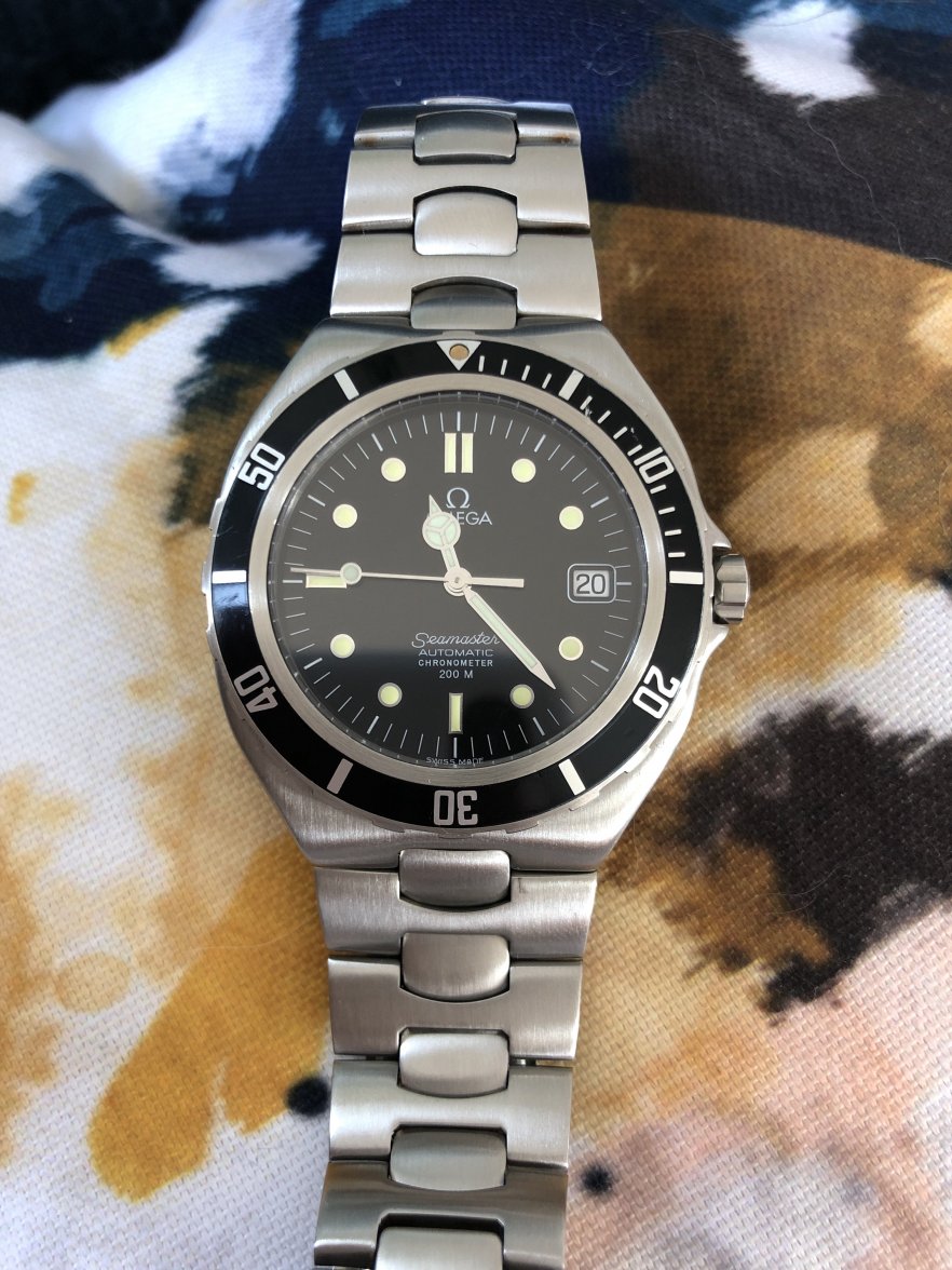

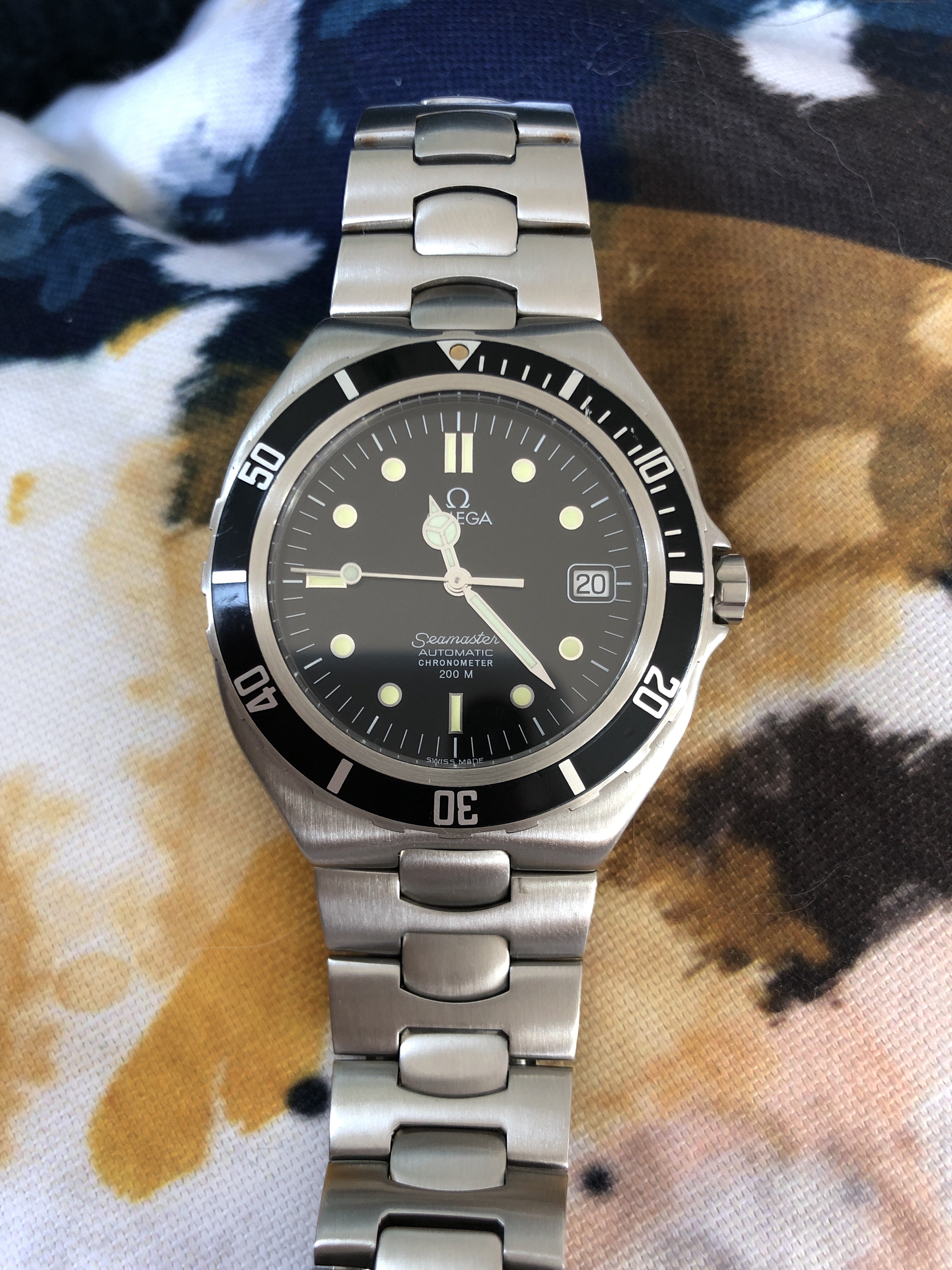

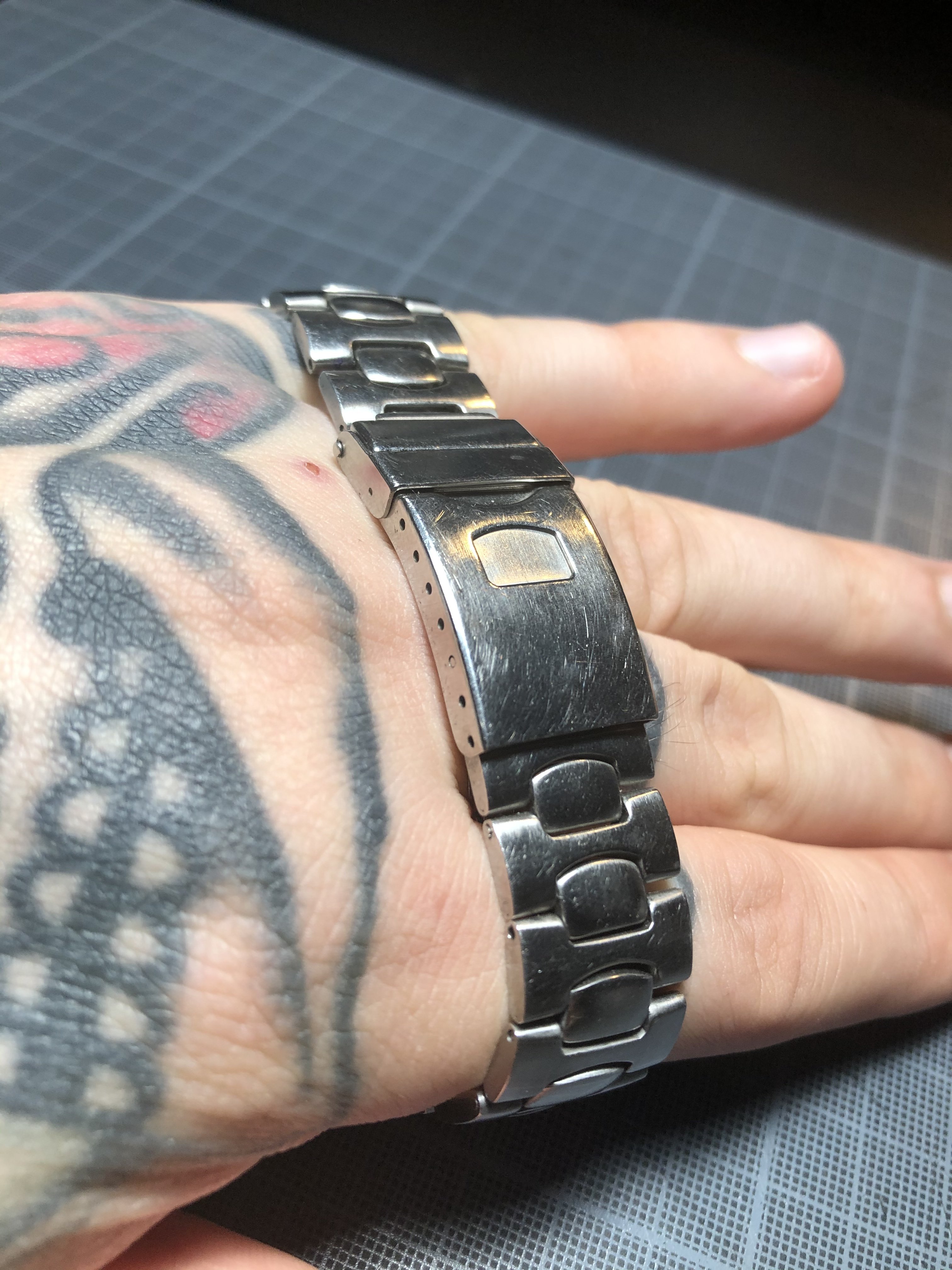

It’s a 366.1041. Circa 1986. Cal 1111 movt. Yours has Mercedes hands used in first 3 years of production. Allow 2-300 for service. Your bracelet has lost the omega logo on clasp. Probably gold on the early versions. Here’s mine this morning
Most are quartz. Auto models more desirable. I would certainly invest in a decent service and wear it.

I had a similar quartz model for a while and it’s among several I wish I had held onto. I doubt you’d have a problem re-selling, especially with a proper and documented servicing.
That said, to me that watch just begs some daily wear!

I have a very similar automatic model. Overpaid for it - something like 3K. But wear it nearly everyday. Very underrated model that you almost hear nothing about.

But they would fully re-brush it. At an Omega service, original finishes are reinstated where practical and possible, both polished and brushed. The downside is they dont laser weld so dents remain after the brushing. Well they likely can laser weld it but the cost would escalate exponentially. For a more reasonably priced full refurb you would need to look elsewhere.
An observation about the Pre-Bond: One major downside is that no replacement bezel part is available AFAIK, if you have a damaged bezel you are either stuck with it or have to replace the entire case, which is not economically sensible, particularly on the part gold cases like here. The bracelet OTOH is available at not too hideous a price, last time I got one about a year ago it was like £260/$350 but it would likely be more now as many parts have gone up sharply in the past 6 months.
