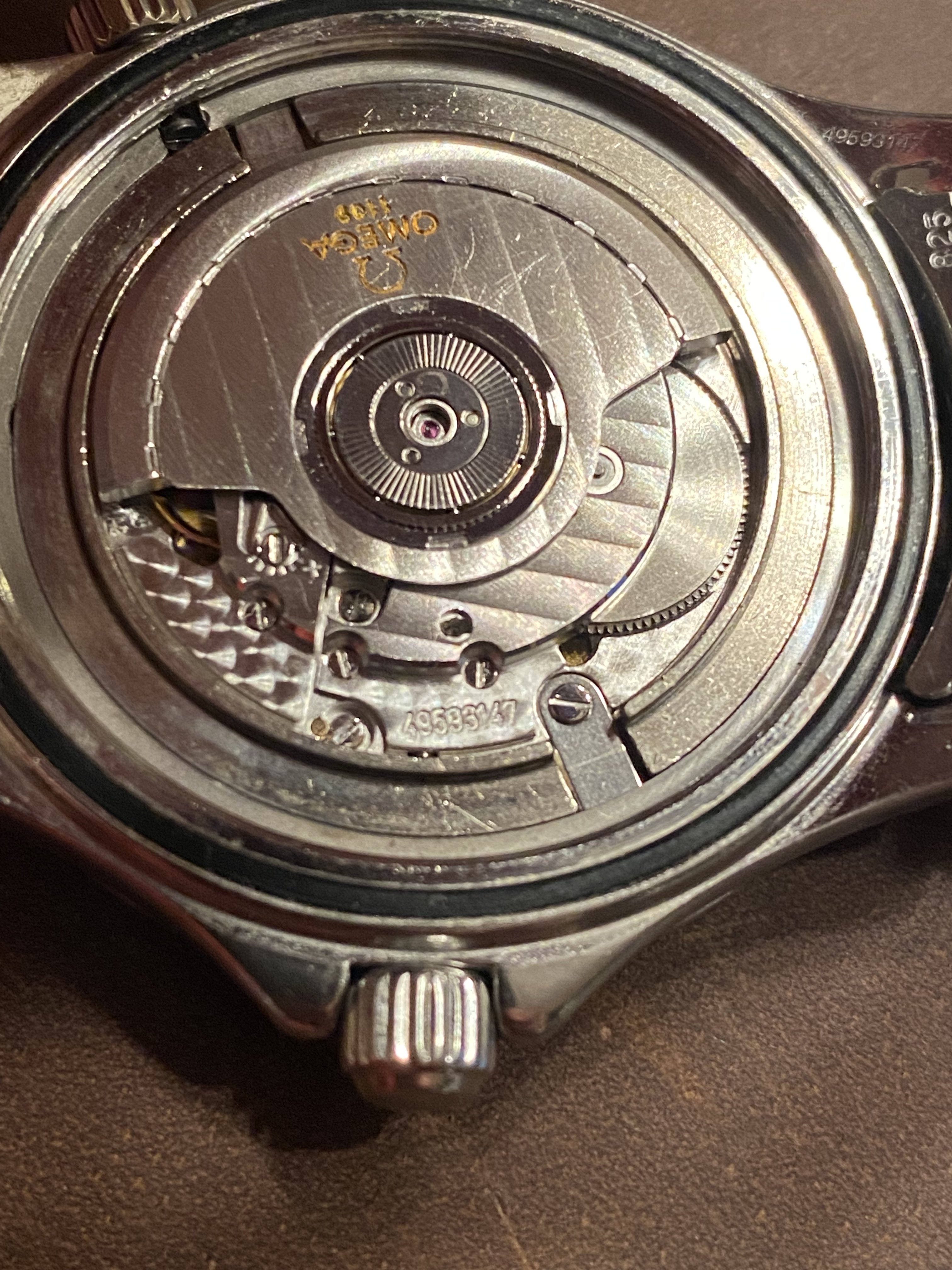

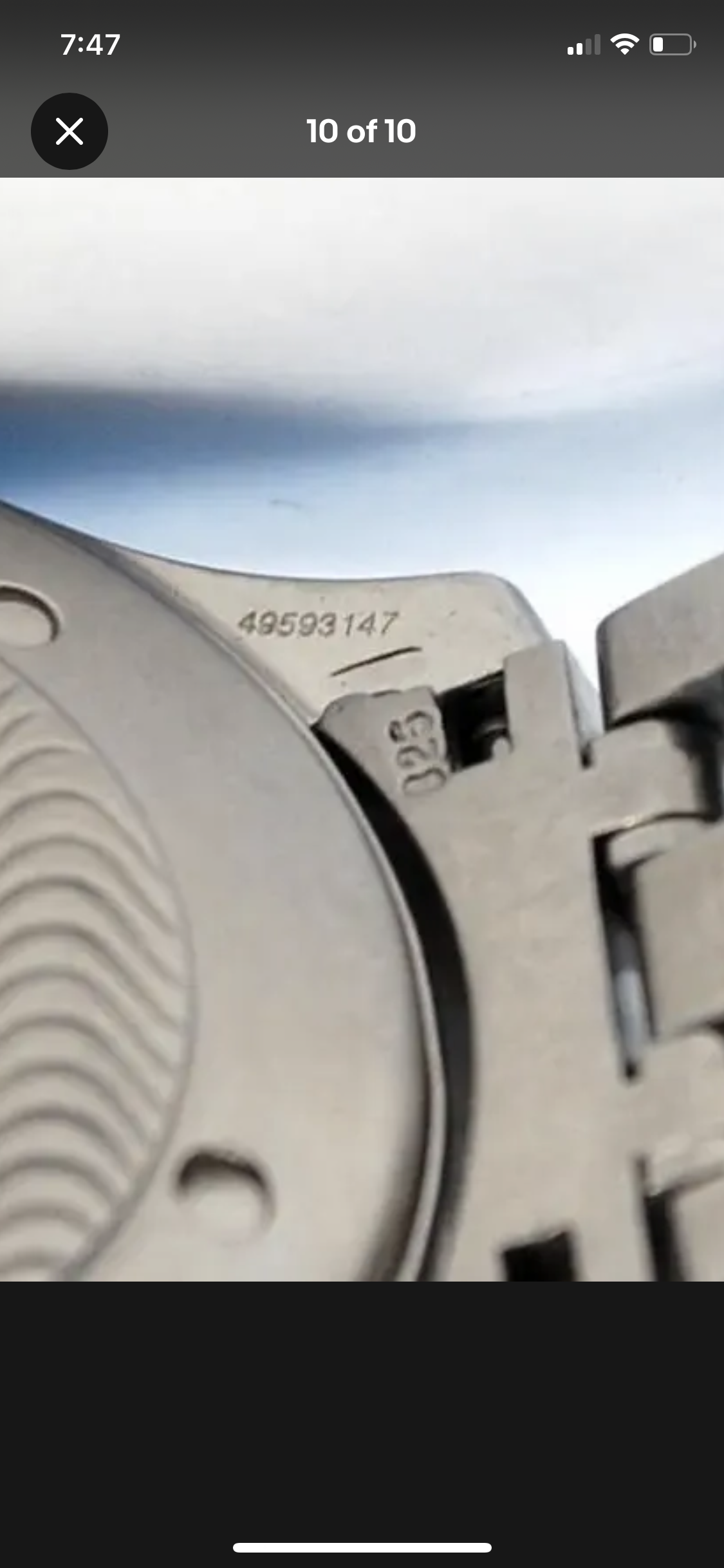

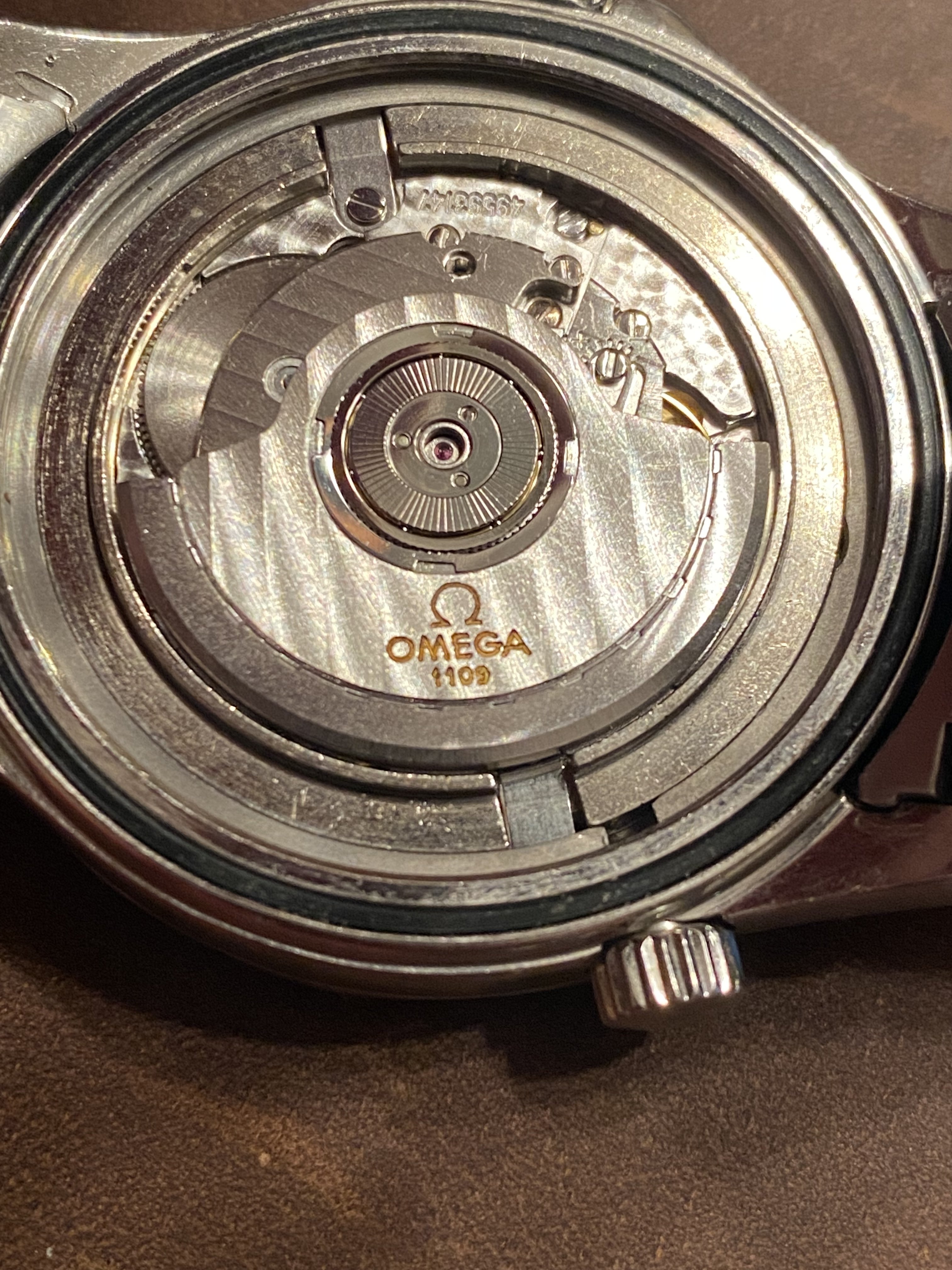

First time posting and first time Omega owner. I purchased a watch from eBay and I’m looking for someone to help me identify what I have. The watch was authenticated via eBay’s service but something isn’t adding up to me. It could my inexperience but here’s what I’m dealing with, the watch I purchased was listed as an Mens Omega Seamaster Chronometer watch - Electric Blue Dial - 41MM - 2255.80, my understanding is they model was manufactured in 2000, 2002, 2003, 2007, 2009. The serial number corresponds to a seamaster manufactured in 85 or 86. Also the dial matches that of the newer models while the hands look like that of the 80’s version.

The hands are certainly wrong (should be solid sword hands), and I'm not sure this model ever came with a Cal. 1109.
The serial number is low enough that the only way to get confirmation from Omega, is via an Extract of the Archives, which will cost you 120 CHF.
It's certainly not correct based on the hands alone.

Even if that was straight, and it’s not, what you would have is a 2055.80, since the 2255.80 comes with the 1610 Speedy type bracelet, not the Bond type.
What you actually have is a probably a very early 2531.80 from circa 1994 with a dial swap. The reason I think that is because of the matching movement and case serial numbers, the 1109 movement was used in the very early 2531 Bonds and they do have high 40s to low 50s serial numbers, which as you say is suggestive of an 80s date if you only followed the online lists. The case number shown there (168.1640) is indeed that for for a 2255 (and 2254) not a bond model but that doesn’t fit with the serial so the back might have been changed too as I can’t see how a 1109 movement got into to a 2255 any other way. I guess the movement could have been swapped for an 1109 and the case re-engraved with the older movement serial but I would suggest that is less likely.
The 2255.80 was actually manufactured between 1997 and 2008 and only came with the 1120 movement. AFAIK there are none with serials lower than 60m (though the quartz models have 50m range serials). This watch doesn’t add up.
Send it back. It’s a mod/Franken.

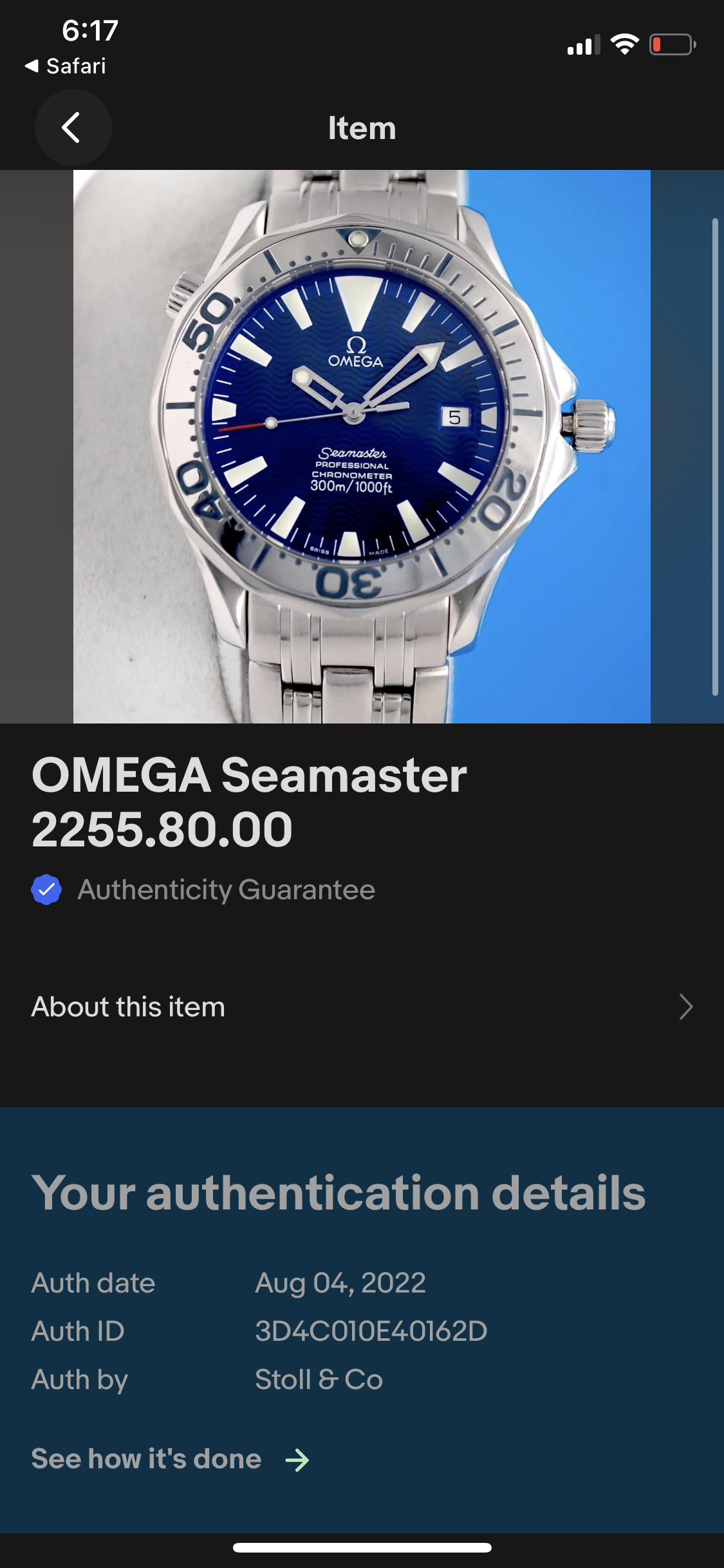

Thank you, as you mentioned before ebay is basically telling me that since the watch was "authenticated" through their service and the tag was removed they can't do anything for me. I'm talking with the seller so well see what happens. I just don't understand the authentication process...reminds me of Tommy Boy, "if you want me to take a dump in a box and mark it guaranteed i will but then all ive sold you is a guaranteed piece of crap" I bought an authenticated non-authentic watch

This is something i asked in another thread, Just what does the authentication mean?
Here I think the authenticator, Stoll and Co would say, it is an Omega watch with an Omega movement. Serial number on the case matches the movement. They do not provide a statement do they.
Swapped dials service hands, incorrect crown ? Dont know, dont care!
The ebay listing does specify the movement is an Cal 1120, that may help. But again the seal has been broken......

Don't know if this would be a viable option, but could OP send the watch to Omega for service, and then Omega would hypothetically reject the watch due to it being a franken. OP could use the documentation Omega provides to him as proof that the watch is inauthentic. The only problems here would be the timeframe this would be done in as well as if Omega would reject the watch and provide documentation.
6,609
26,784
With the security tape removed, eBay will continue to deny the return request under the assumption the OP tampered with the watch.
@NoctorDumbnuts did you take the movement photos or was that part of the listing? If that was the sellers image and the listing description stated the movement was a 1120 as @studeb said above, that is your best chance at getting your return approved. Not guaranteed and you will have a hell of an uphill battle still… but still worth a shot.
