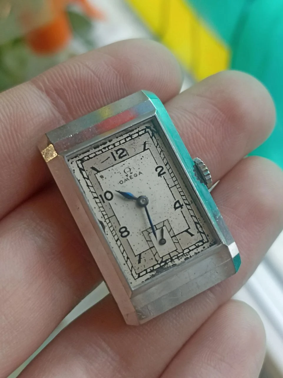

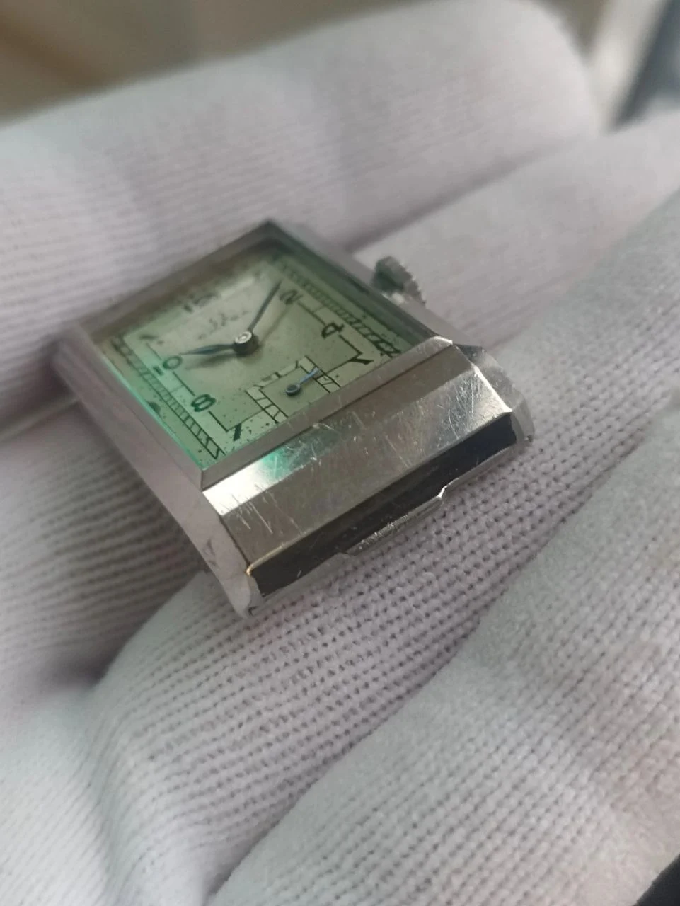

Hello everyone. I would like to understand the authenticity of the purchased watch and find a catalog or at least a reference of that model. I would be glad if someone could help me with this. This is the first time I have seen such a case form factor.

The dial looks legit at first glance. Can you please post photos of the inside of the case and the movement.

It probably doesn't matter very much. If you can find a matching set of blued no-lume T17 hands, they will probably be fine.
8
I interested in originality) My hands set look like the original set, but for another model. I think it can be installed.

Looks like your minute hand was replaced. Based on the ads. Both hands look similar. Sword style?
384
375
I would say the original hands were leaf-shaped.
8
