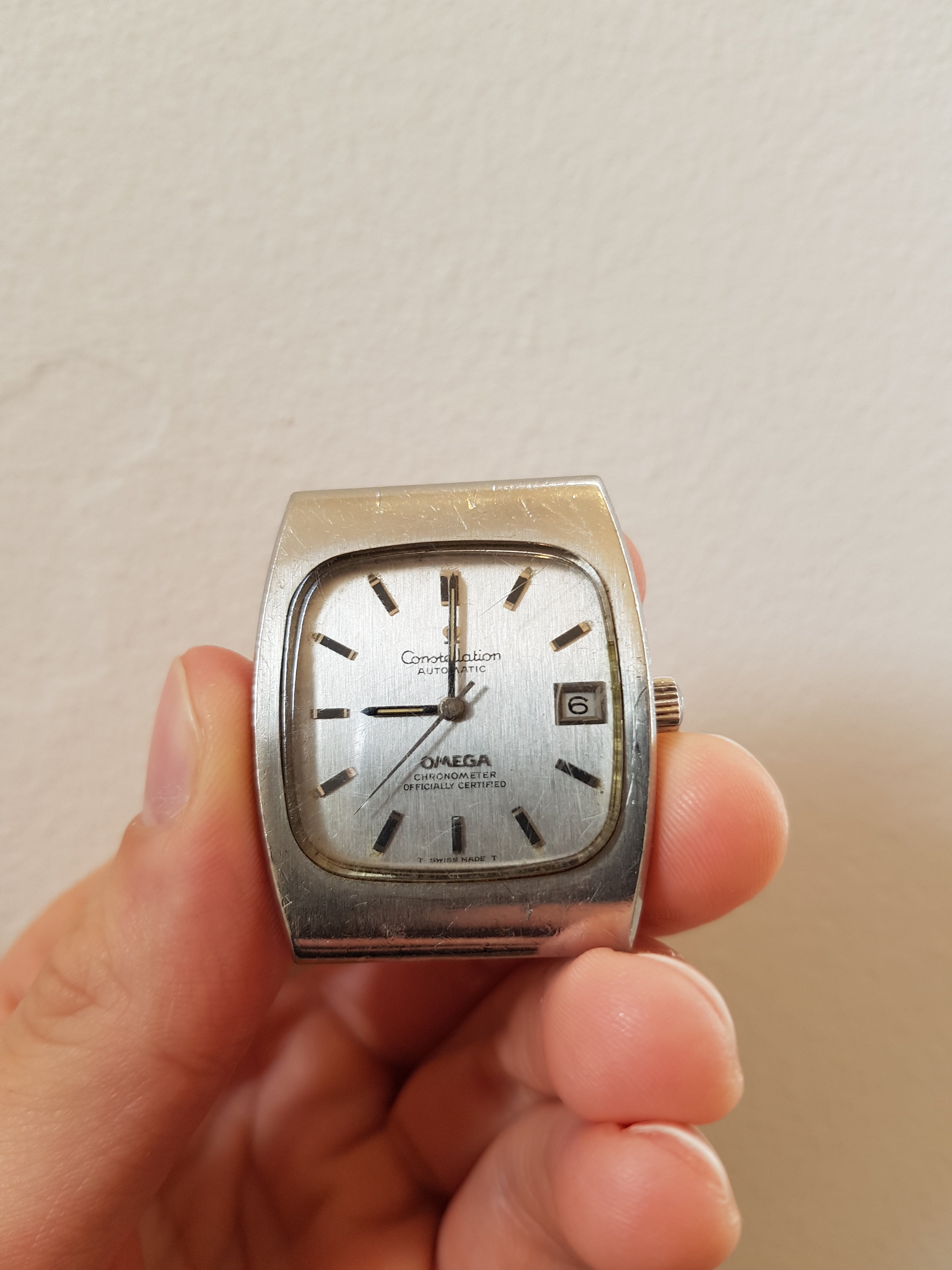

Bought a watch repair kit from a thrift shop and found this watch in it. Have wound it and it appears to be keeping good time!
Have tried some googling and haven't been able to find the exact model. Does anyone know what it is? Also, was hoping to get a new bracelet for it but am not sure what would fit with the square ends on it. Does anyone know of a bracelet that would fit with it? Has a 20mm space between lugs
3,578
13,519

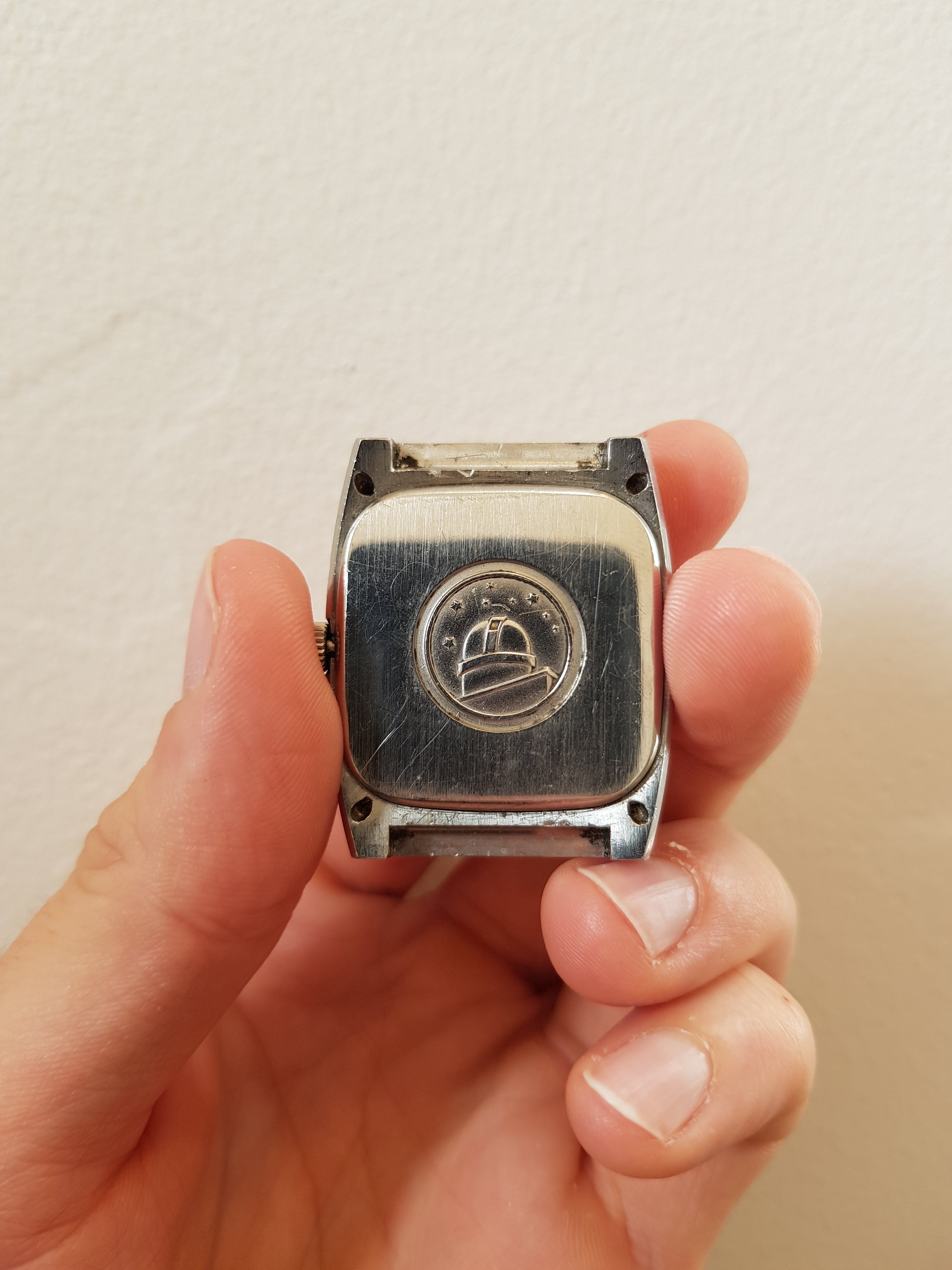

The reference number of the watch will be on the inside of the caseback. You’ll need that for absolute certainty, my guess would be 168.044, cal. 1001. There will likely be multiple bracelets that fit this ref, I’d say 1202/205 (with 20mm straight endlinks, of course) would be a good bet.
Note that this likely hasn’t been serviced in ages, so if you plan on wearing it you should have a watchmaker do so first to avoid damage on the movement. The 100x movements don’t always have the best reputation regarding reliability, unless they’re maintained properly.
