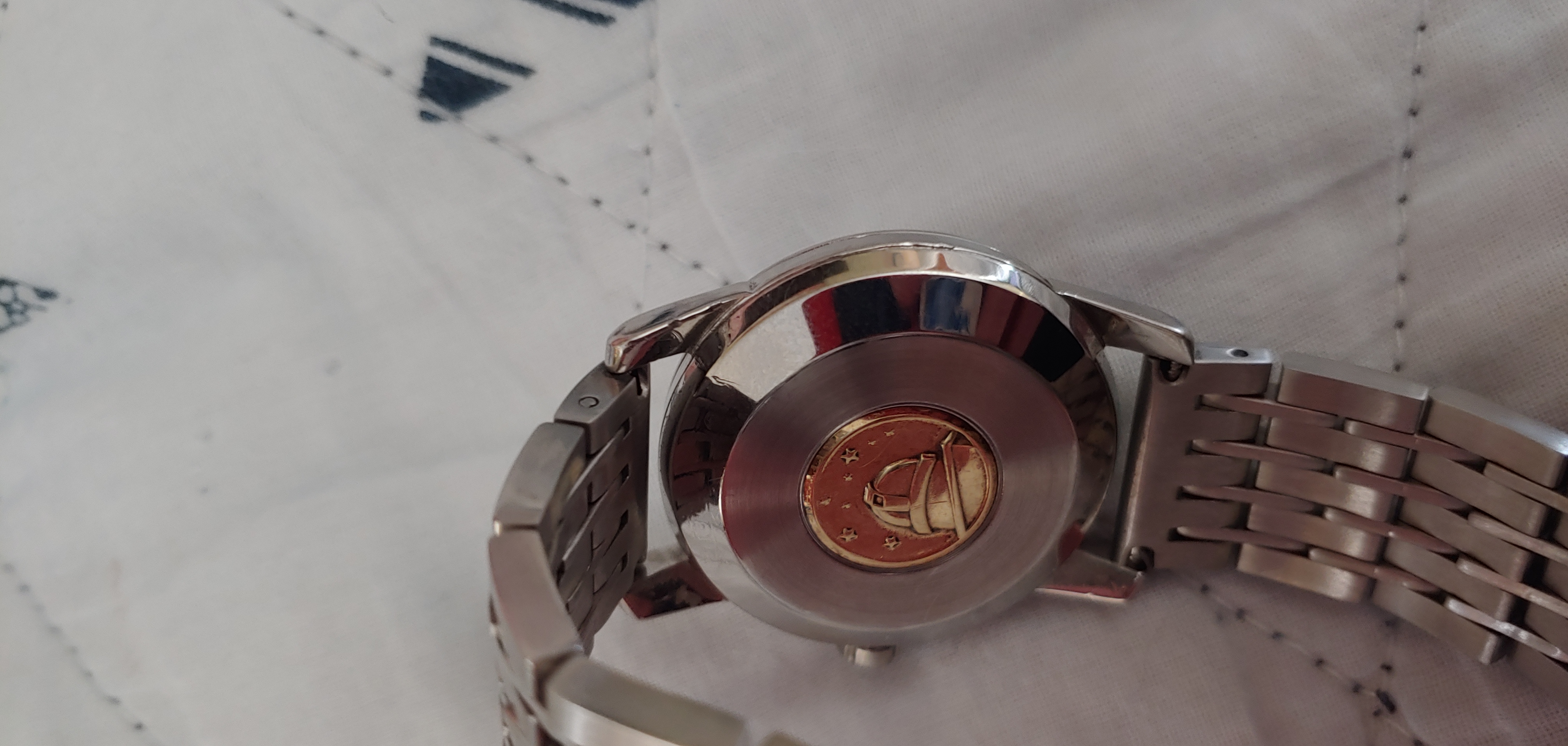

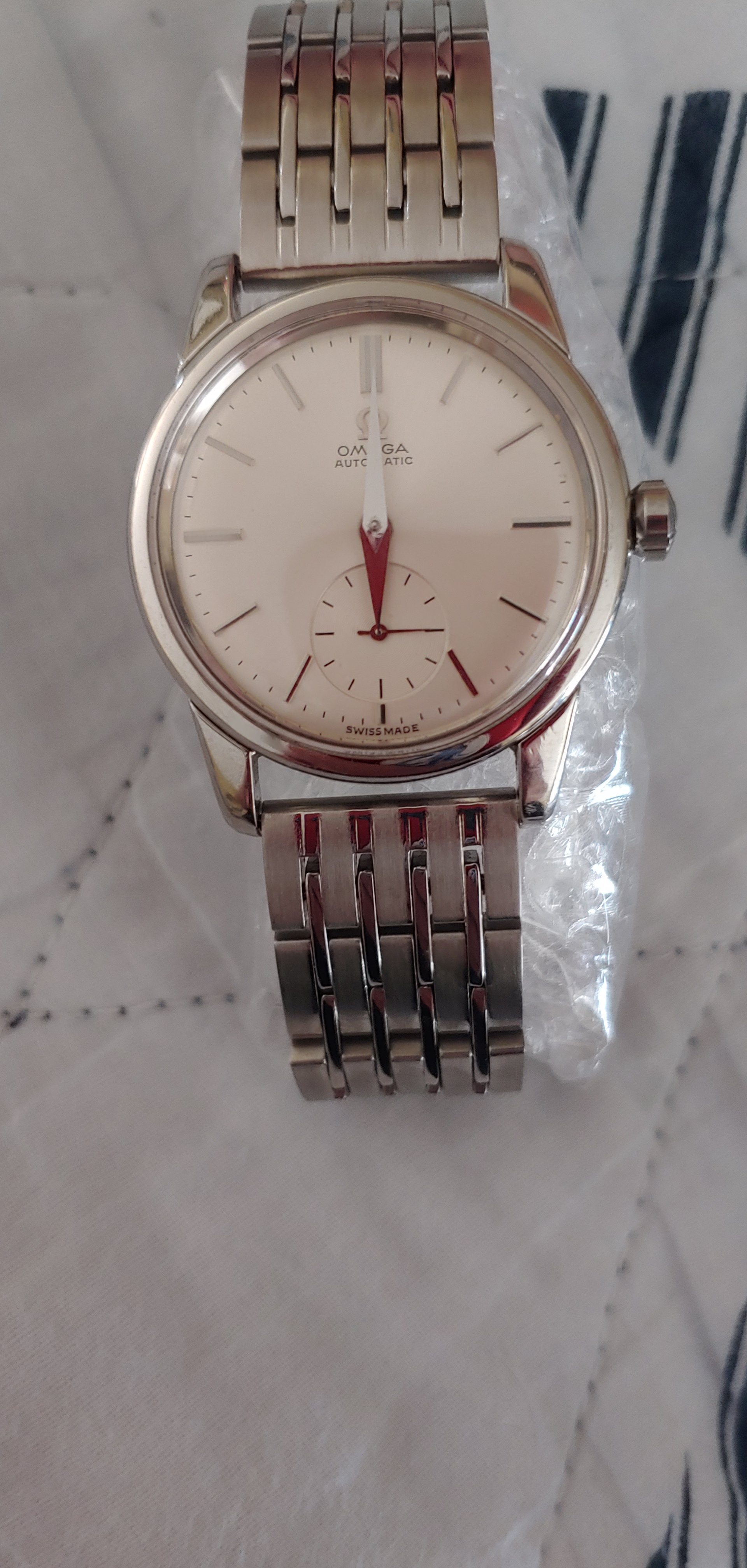

Hello everyone! Can someone give some information on this Constellation I got for my husband in an Estate Sale? I was told it is a 1956 model. I've search all over the internet but haven't found one like it. Thanks for your help!!

I think you have a standard Omega Automatic with a Constellation caseback. Maybe the original caseback was lost and this was handy for the watchmaker.
Or maybe (but less likely) the constellation dial was damaged and replaced.
All of your answers are inside the watch.
Read up on this for guidance,
https://omegaforums.net/threads/how-do-i-identify-my-vintage-omega-watch.93146/
you can ignore the part about fakes, it's a genuine Omega.
It's a Seamaster case and looks like a ref. 2848, so it's a replacement caseback.
I would have expected it to say Seamaster on the dial, so this is a replacement dial? Or a redial? Not bad looking for sure!
