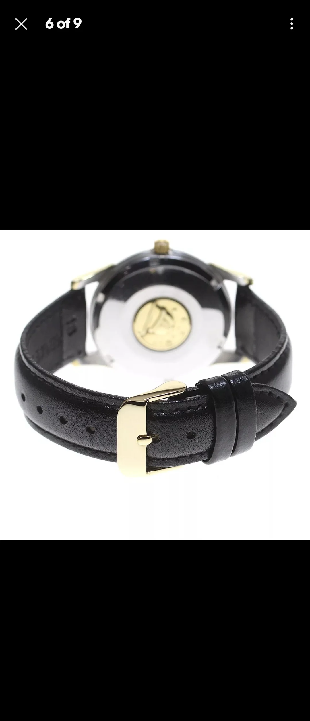

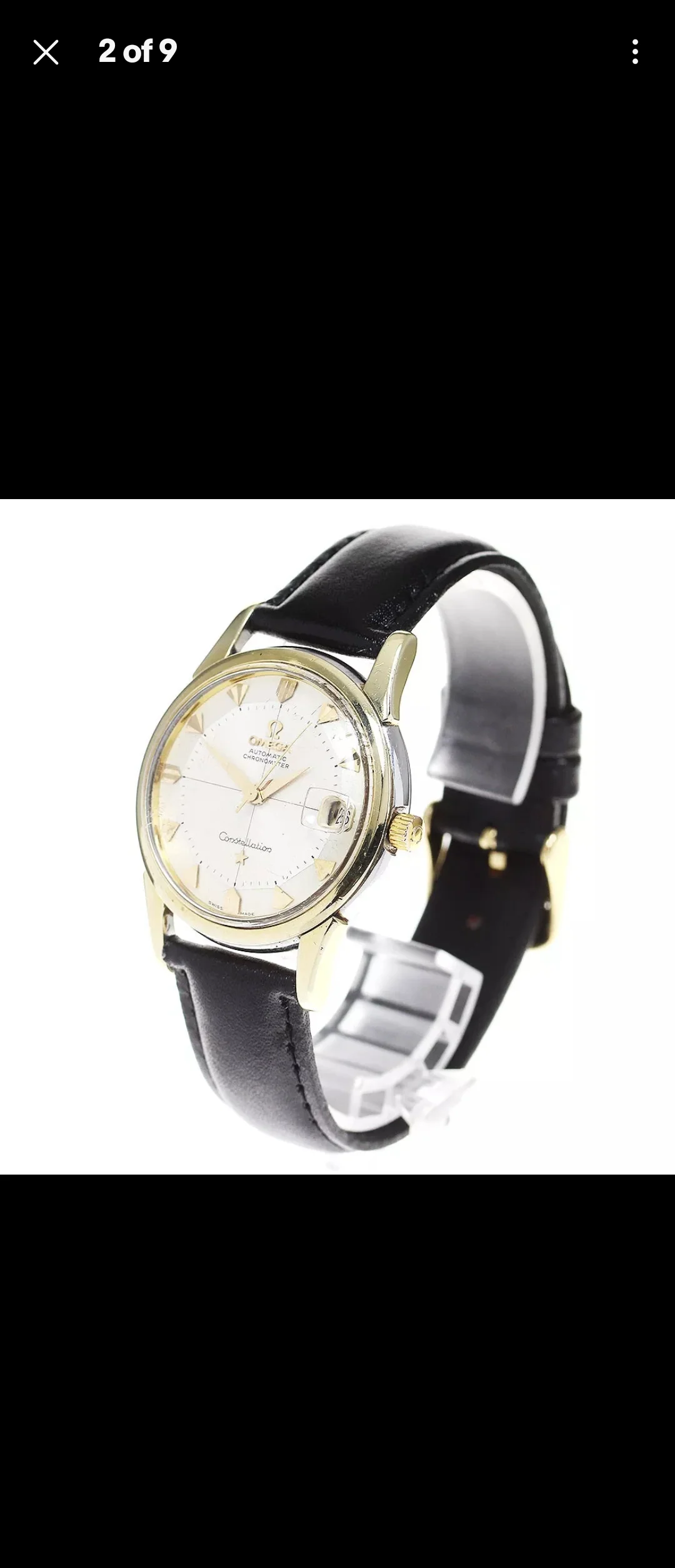

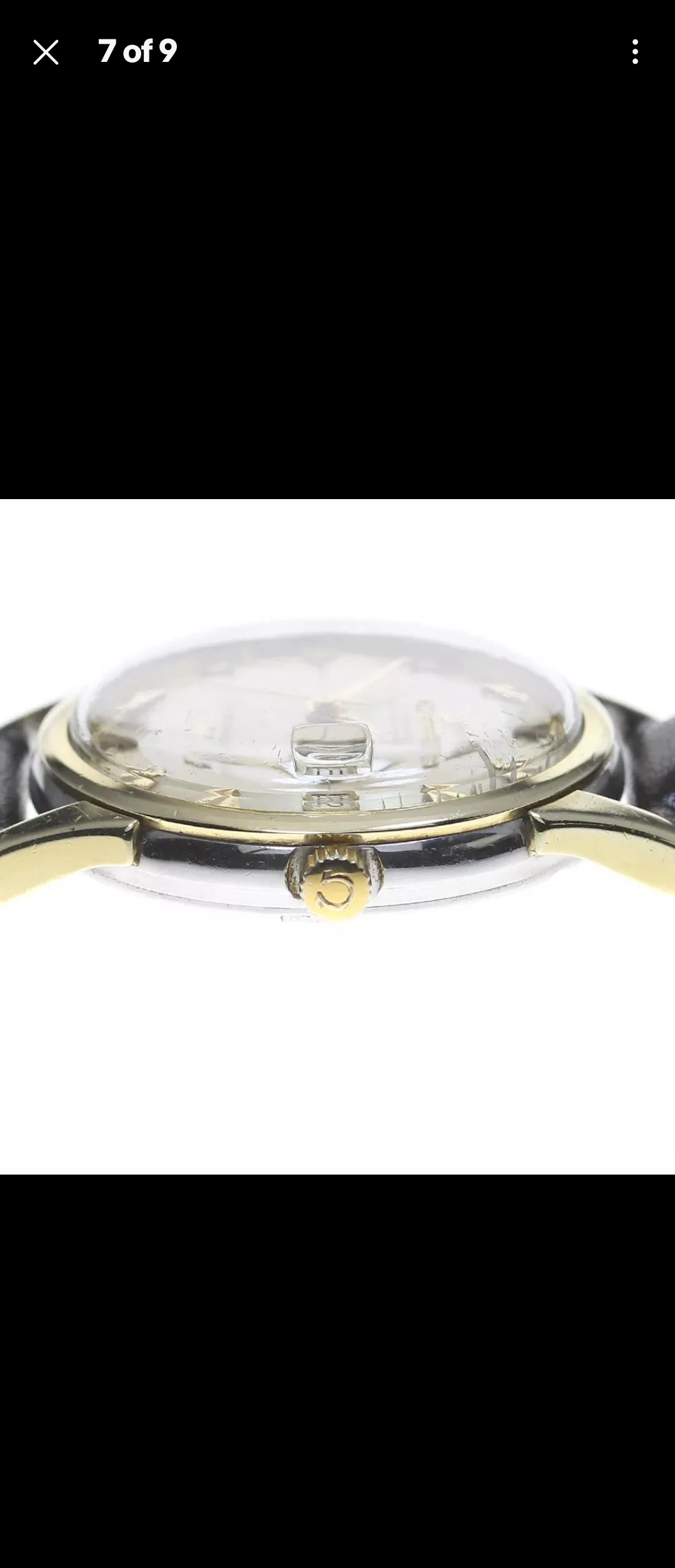

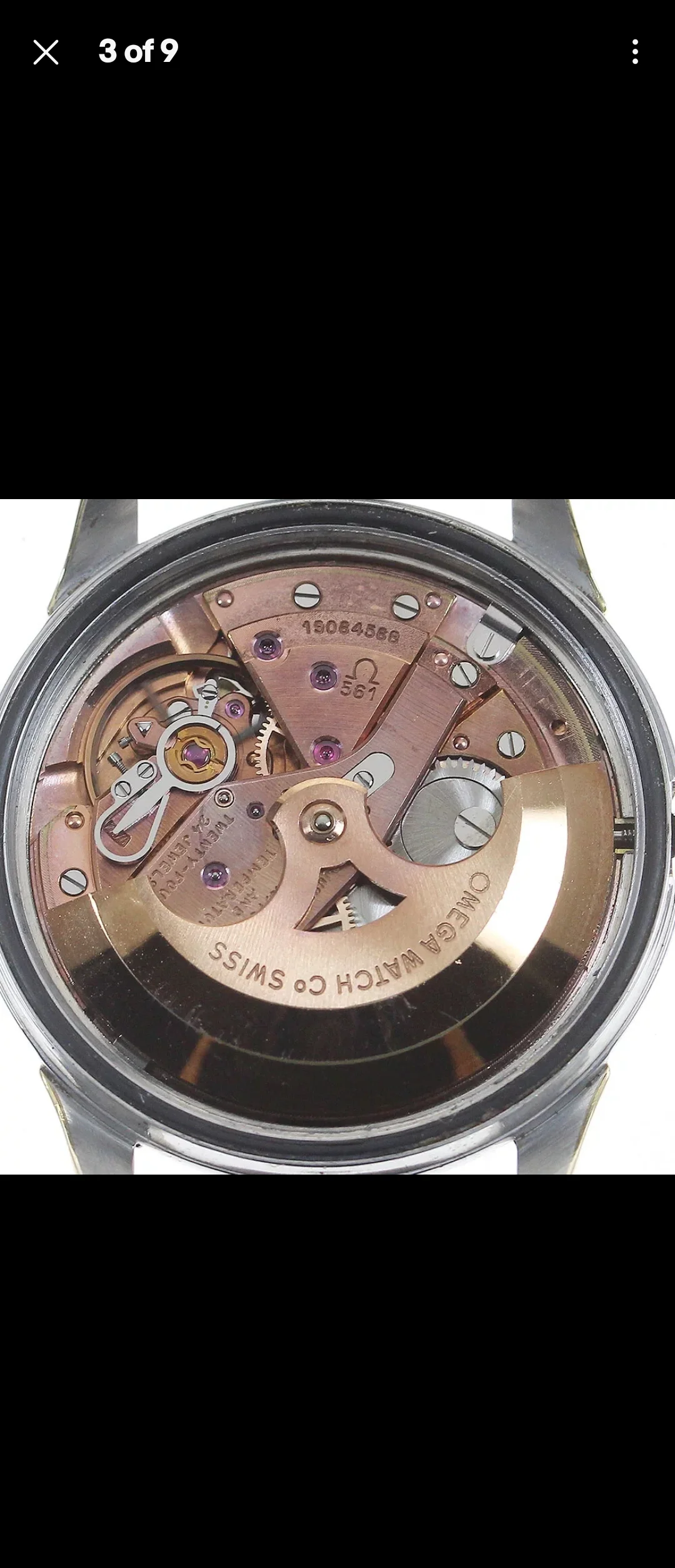

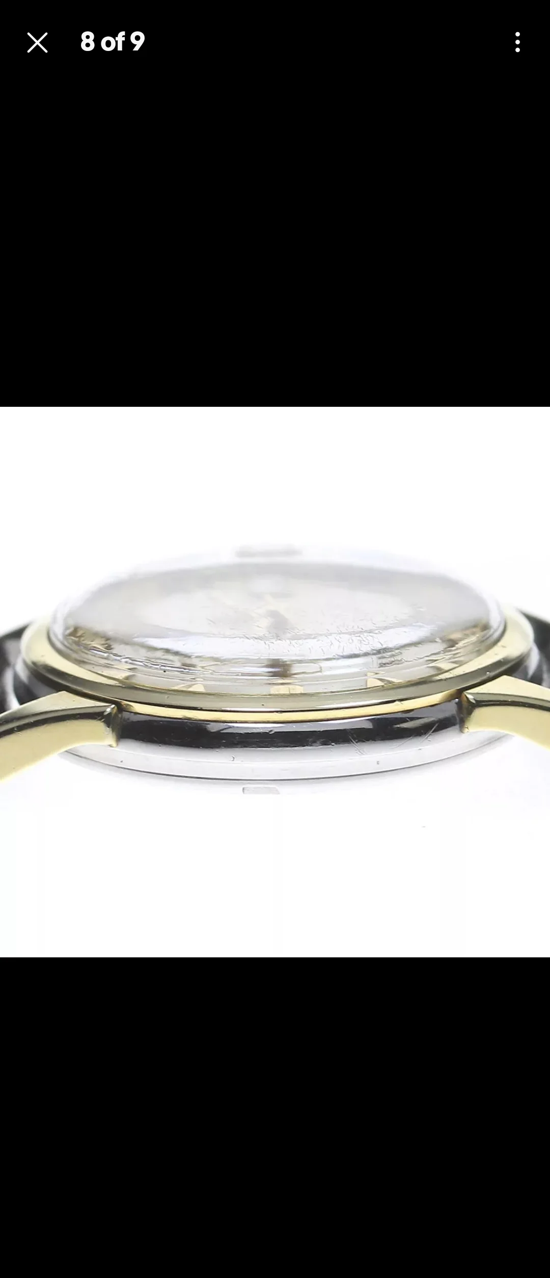

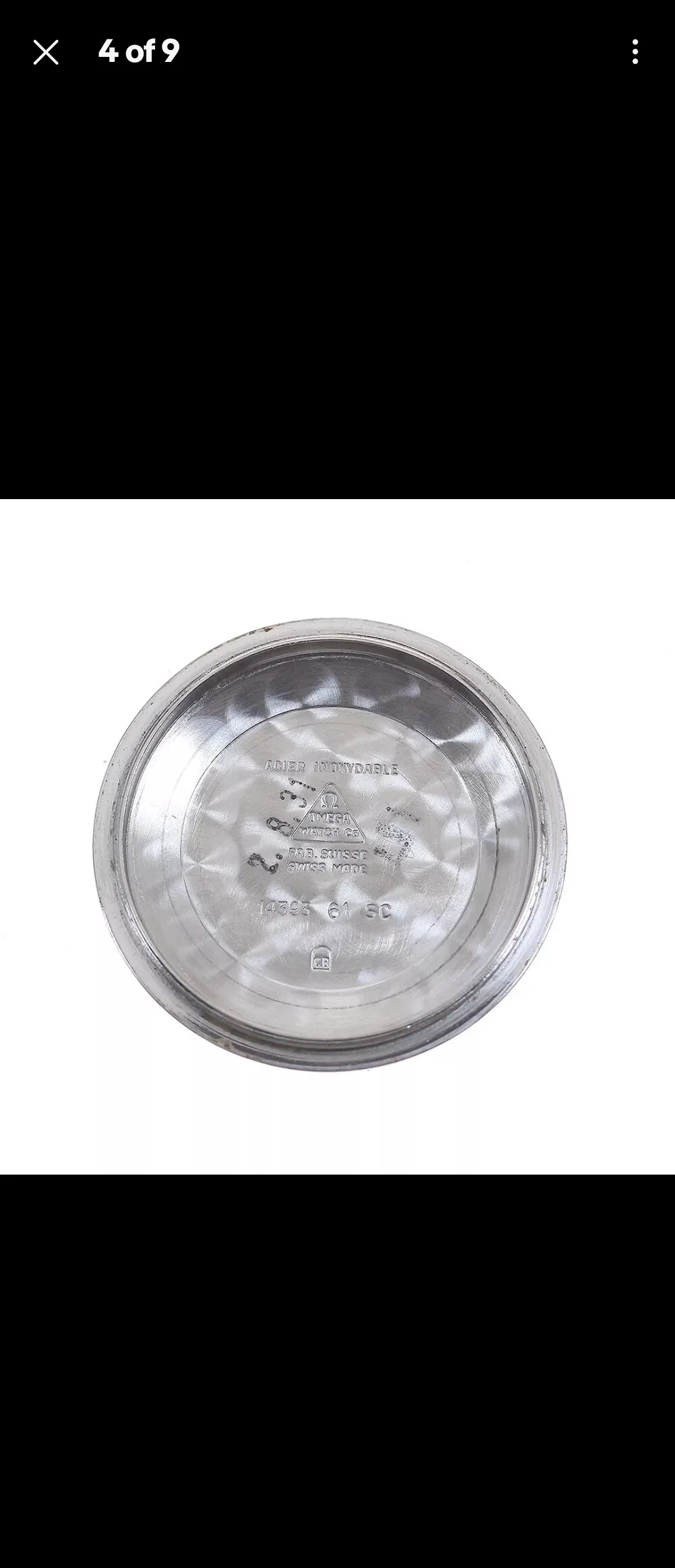

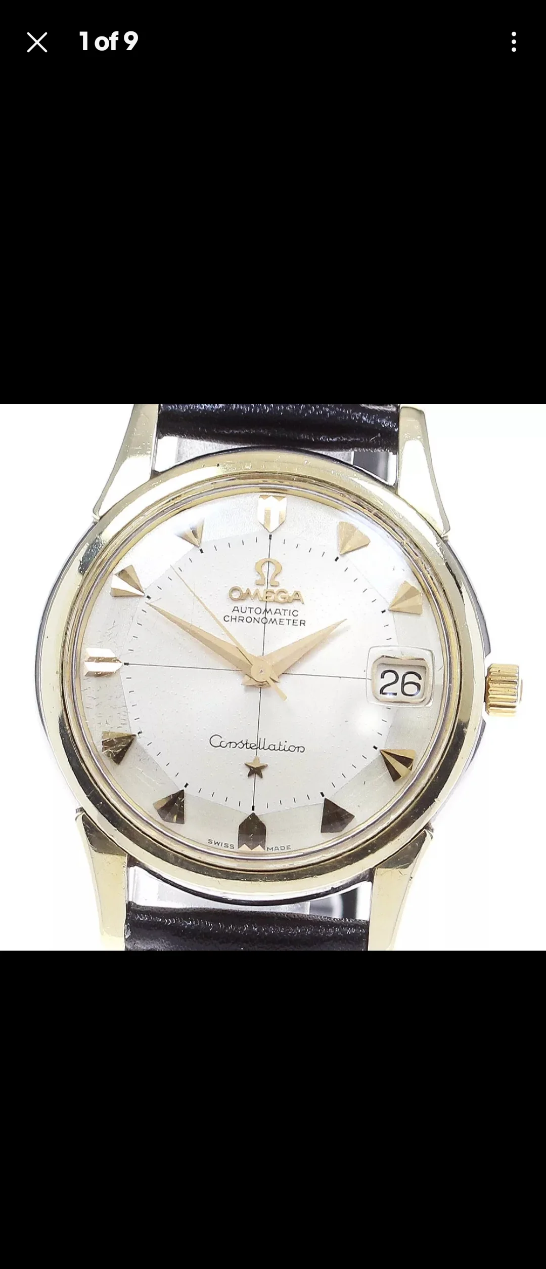

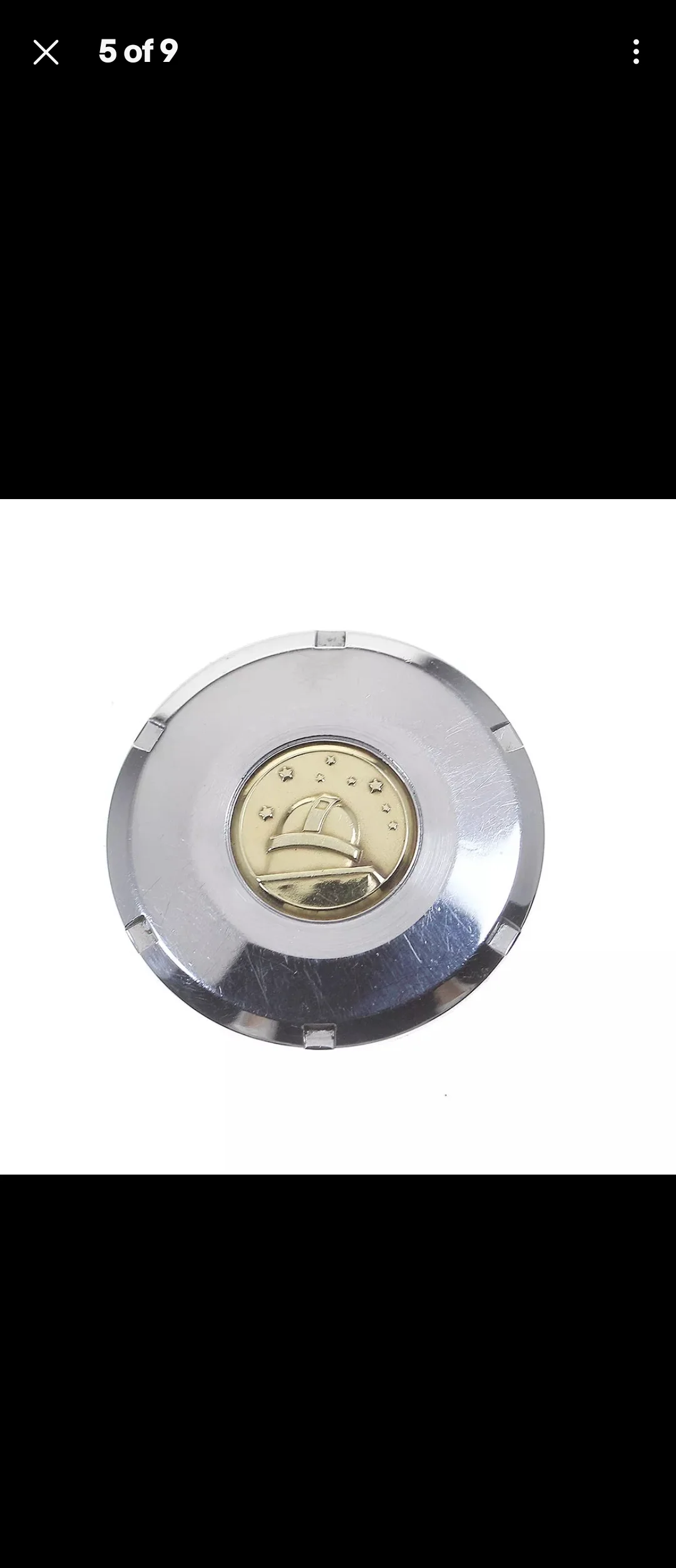

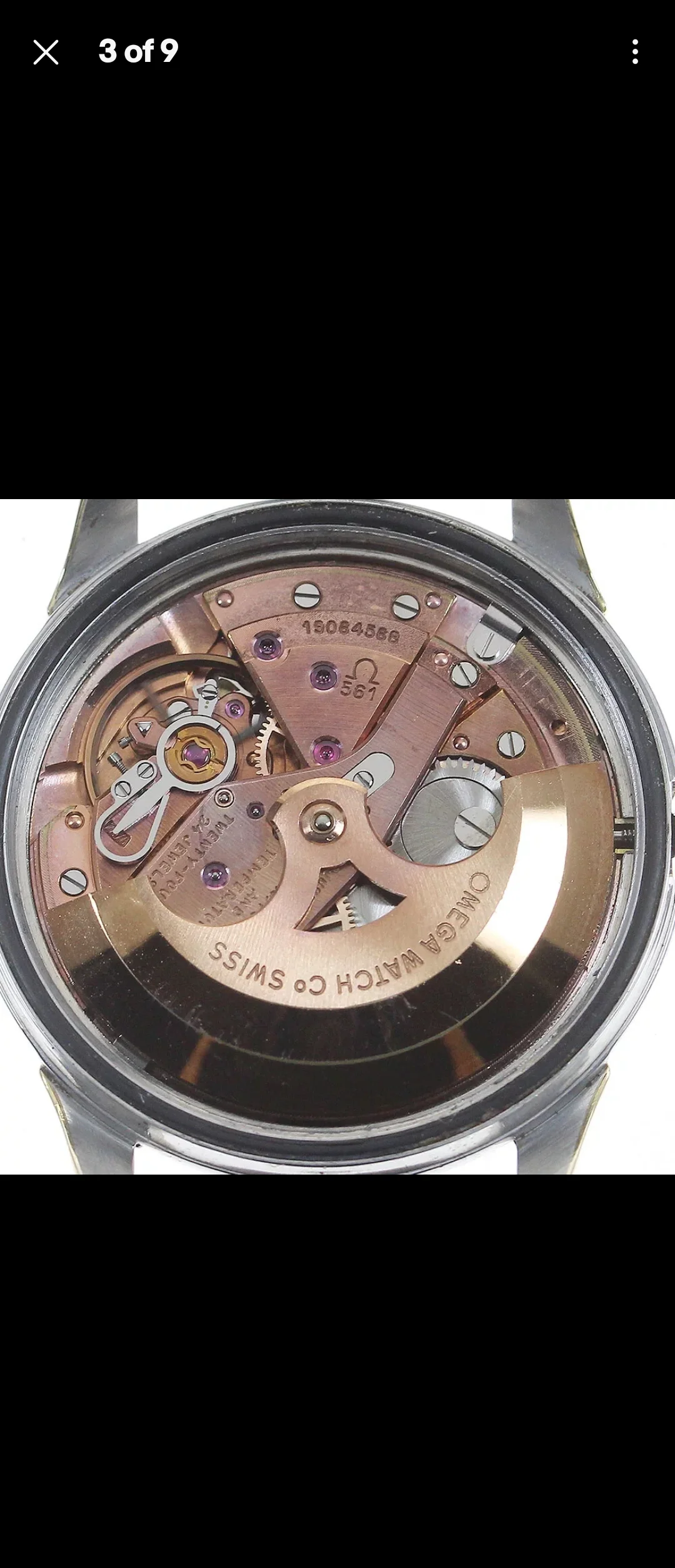

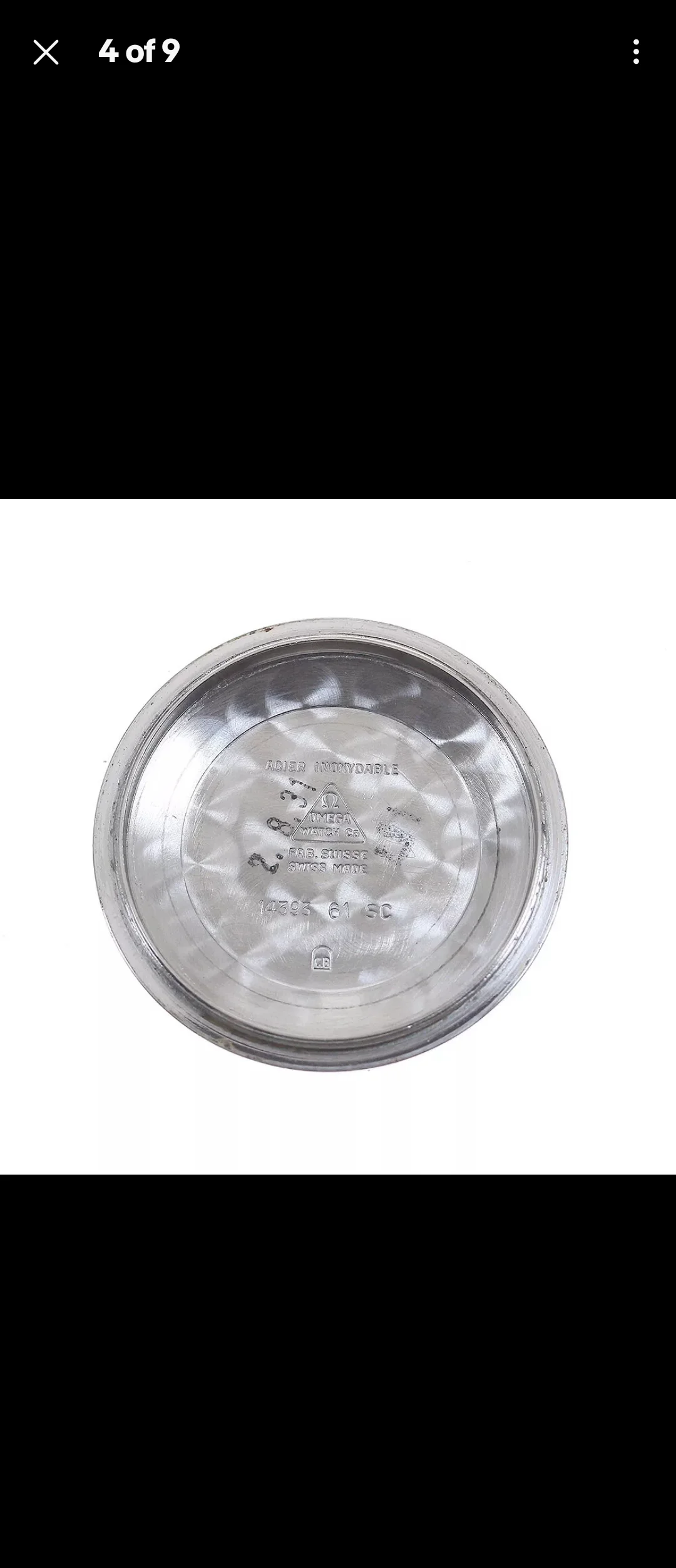

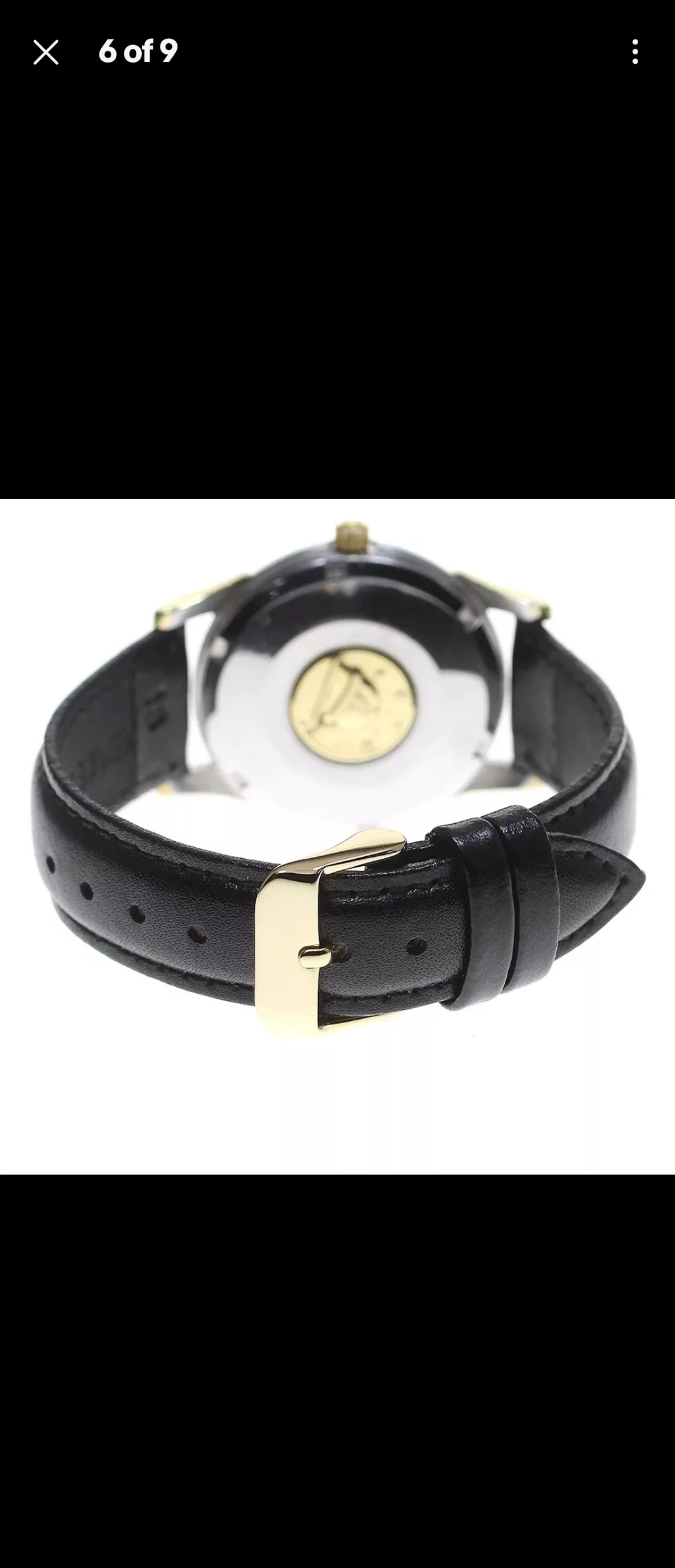

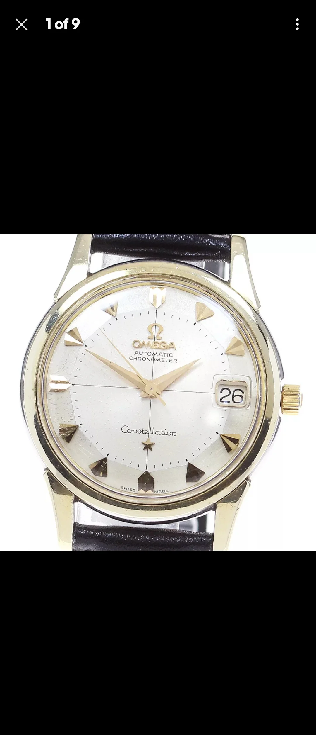

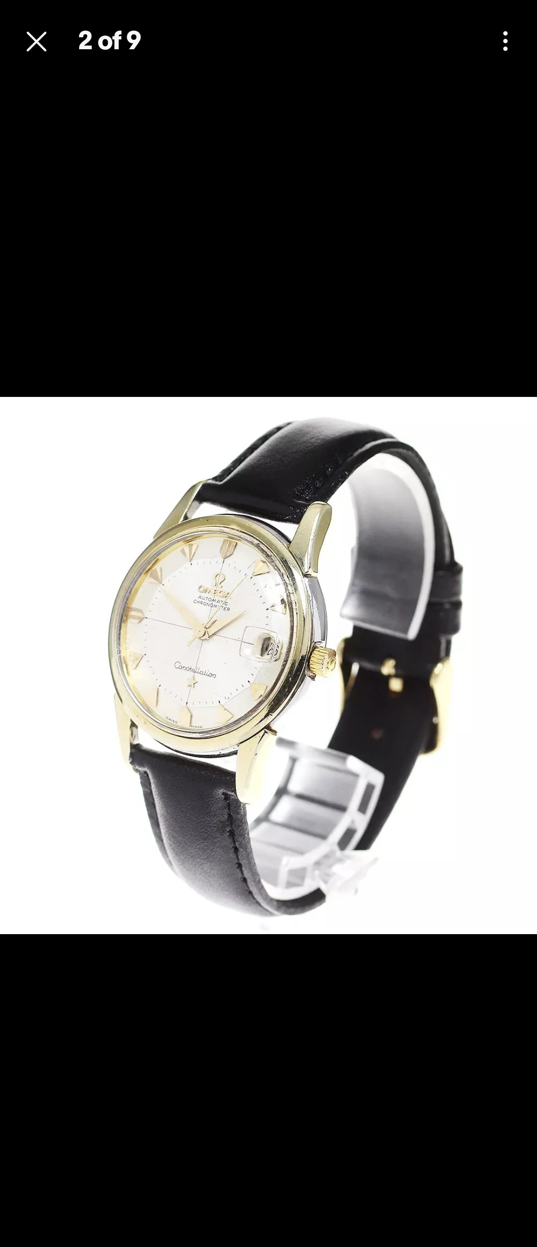

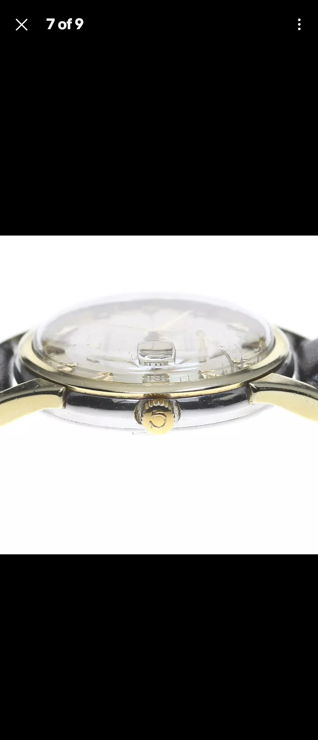

Hey all, I'm looking to buy my first vintage watch but really don't know exactly what to look for on how to verify if this watch I'm looking at is legit and if any major parts were replaced. Any chance anyone can help? This is regarding a OMEGA Constellation 14393 61 SC Pie Pan Dial Cal.561 Silver Dial
Can anyone let me know if it's legit and then what major flaws this watch might show that I should be aware of now (and in future searches) as well as what a good estimate would be for this particular watch.

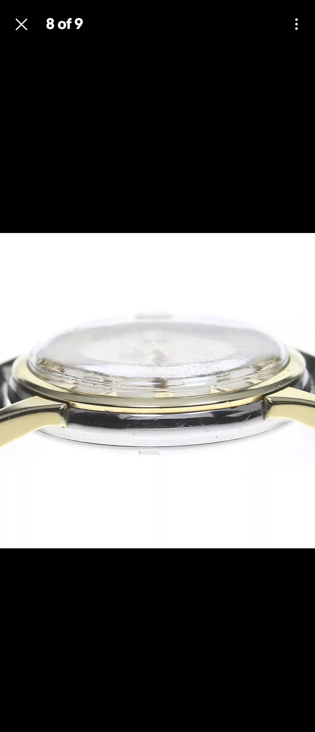

Welcome to OF @Alchemist-NYC
The pics provided aren’t really good enough to assess the watch properly and they have been over exposed to hide any flaws the watch has.
In principle the watch looks genuine.
But as a critique:
The case is soft
The dial has bubbling
The crown is an incorrect replacement
The movt looks to have been harshly cleaned and has a replacement rotor.
And IMHO the aftermarket cyclops replacement crystal is hideous.
I think the marks around the 8 index might be on the crystal but can’t be sure.
In saying all that - The arrowhead dial variant of the 14393 is reasonably uncommon, so whether the watch is still worth buying will come down to price and tolerance for a less than perfect watch.
It’s much easier if you tell us the asking price rather than trying to give a ball park figure.
620
1,969
It is quite common to see the color of the rotor is different from the rest of the movement. I don't know if the rotor was replaced or just because parts of movement come from different supplier. Of course, the movement needs a proper service.
The marks at 8 are on the crystal, not the dial.
The crown is not correct for this model.
The case was polished (a common thing for vintage watches from Japan) but IMO it is not too bad since we still see the line on the bezel and the joints where the lug meet the case are not flat.
The dial has small bubbles (another common thing for vintage watches from Japan).

I believe they were asking for~$1,500 USD. The arrowhead indices is the reason why I was attracted to this watch but I wanted to ensure that the watch was authentic and in a condition worth the price. My biggest worry is that the movement looks very dark and the condition of the case.
Do you believe that with the soft case and the condition of the movement that it has the potential to be worn for years to come?

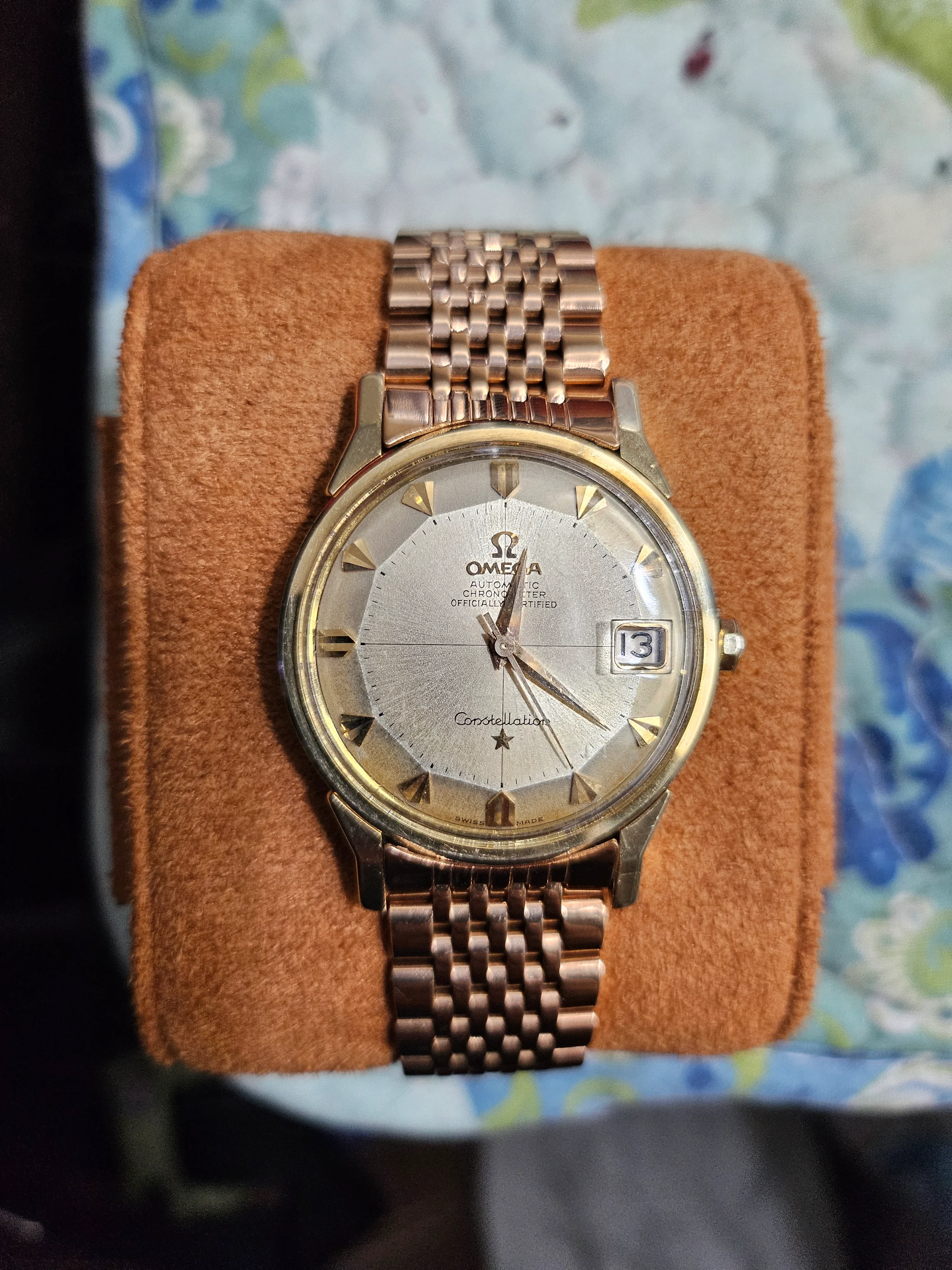

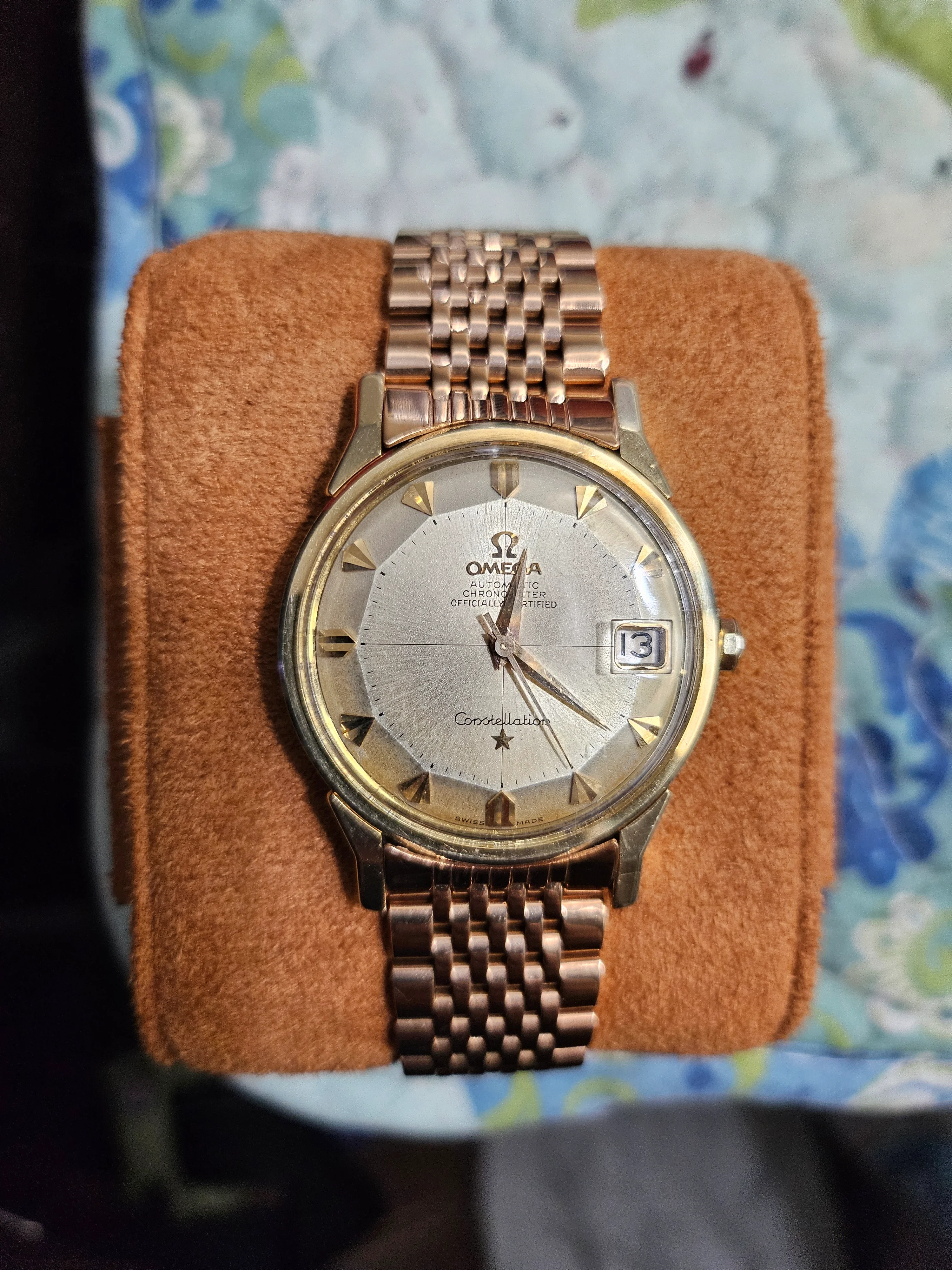

Finally ended up going a different route and found one that I was content with! I've owned it for about 2 months now and after a service it keeps great time (Time Grapher read ±1s/day) and honestly love it!

Nice choice. Is the bracelet rose gold?
Sure is. If original, OP can buy two gold plated bracelets for the sale revenue. But my guess is, it isn't.
6,849
10,525
Congratulations @Alchemist-NYC
Dogleg arrowheads are significantly less common than lyre-lug versions.
Is it a 14902?
Do you know the movt serial no.?
15
11
It is, it came with a gold Beads of Rice bracelet that was too small for me and needed minor repair and cleaning (no extra links unfortunately) and this rose gold one. Not a fan of it clashing with the yellow gold of the watch but it doesn't look terrible, looking for a nice brown leather strap. All the ones in my local shops are low quality so I haven't swapped it yet, but that's the goal!
15
11
It came with a yellow gold one (see above reply) and this rose gold one with the purchase. I swapped the yellow gold one for this one as the last one had damage. Both are omega stamped but the yellow gold one i was told was original (not sure if that's true) but i know the rose gold one is aftermarket. Hopefully i can find a nice long-lasting quality brown leather strap
