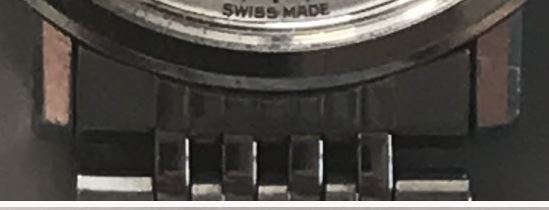

This first one looks like it overlaps the top of the beads a little and has a small angle on the outside edge.

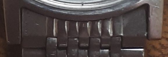

This second one has notched areas for the beads and a larger angle on the outside edge

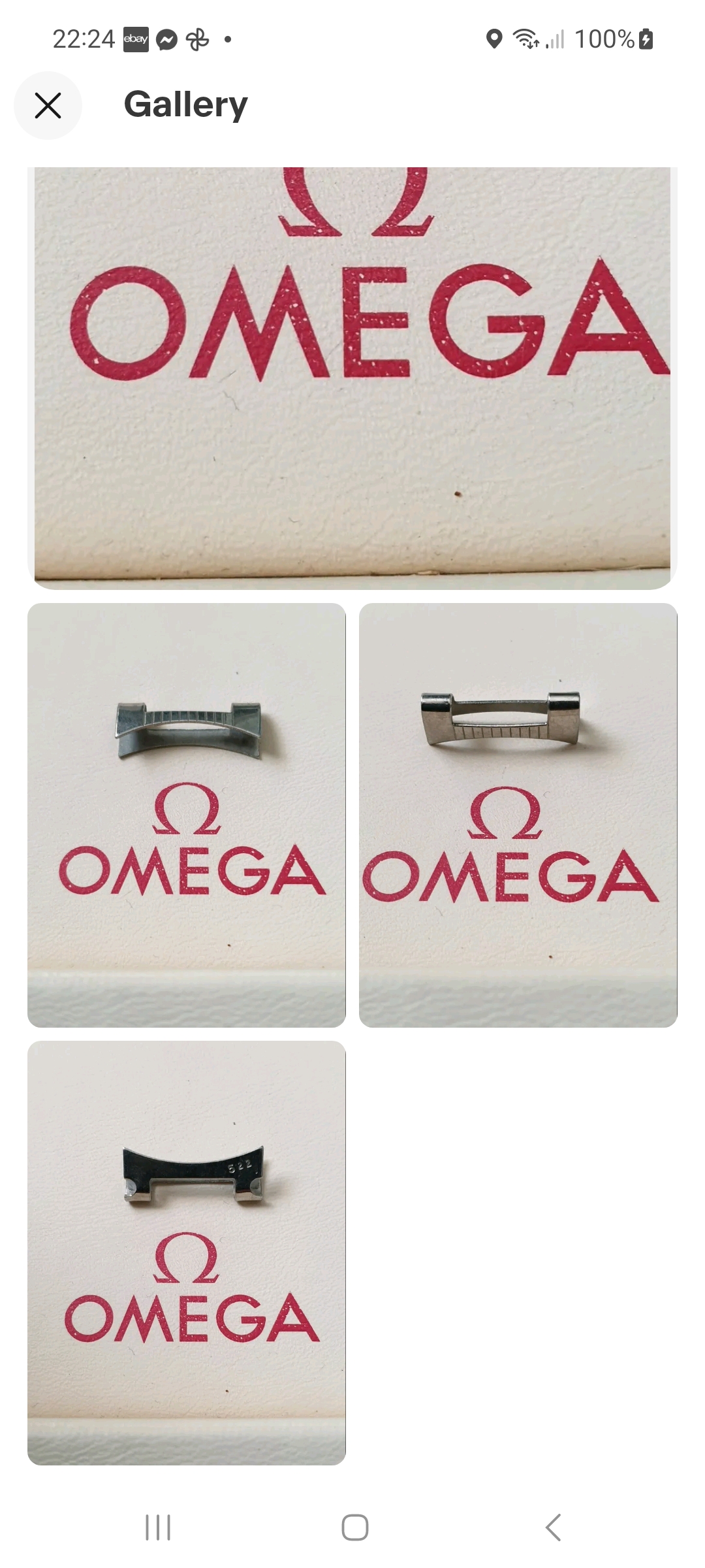

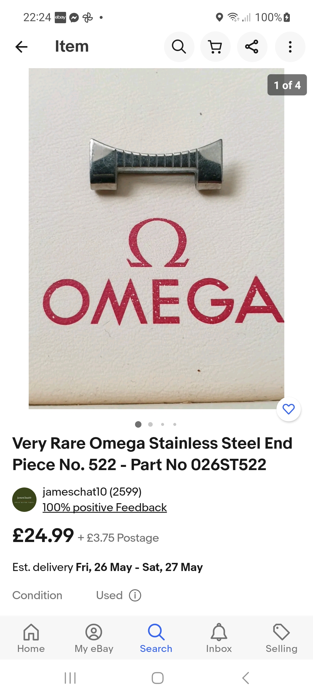

I've just found 1No 522 end link on ebay but I can't see how this works with a 1037 BoR.
62
67
That looks completely different from what I would expect. It has 10 divisions and no offsets. I wonder if there are multiple designs.
3
It does seem a bit odd - I'll keep looking and try to substantiate that that really is a 522 end link. I'll keep you updated.
