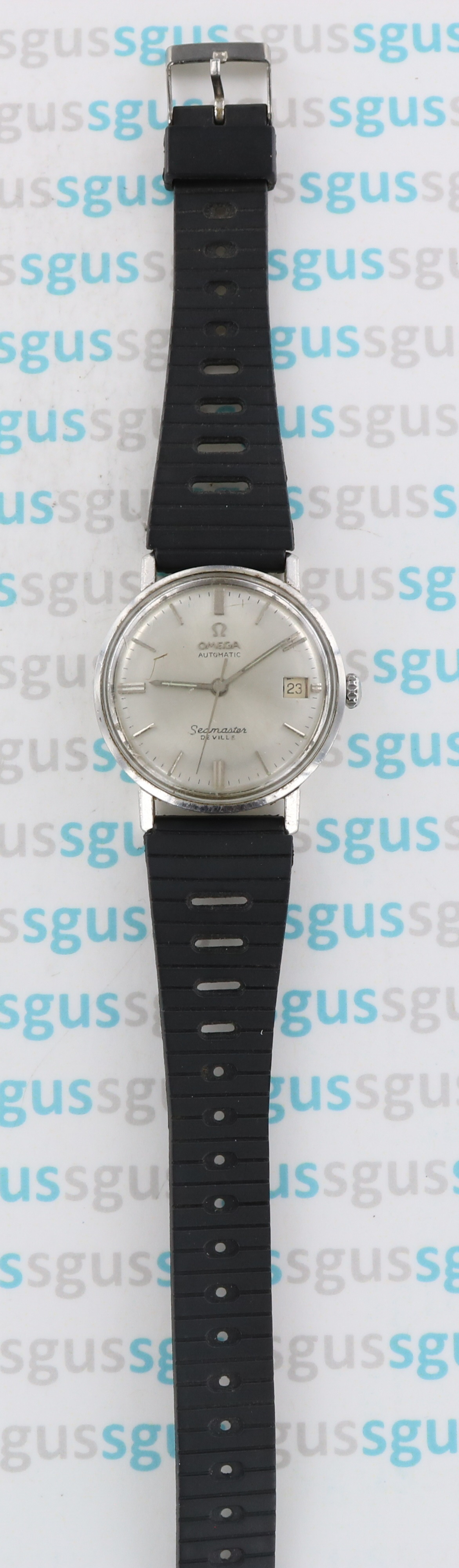

    1)
    1963 Seamaster Deville
    14910-SC
    Cal.560
    does not say "swiss made" on bottom of dial
    does not have bezel around date window @ 3o'clock position
    (wondering if that is factory, or possibly lost when cleaned 20 yrs ago)
    ----Looking for stainless steel bracelet (8270 style)
    (The picture below with black rubber band is my actual watch, the other series of pics are from the internet but look exactly like mine, except has the bezel around the date, and "swiss made" under 6o'clock position.)

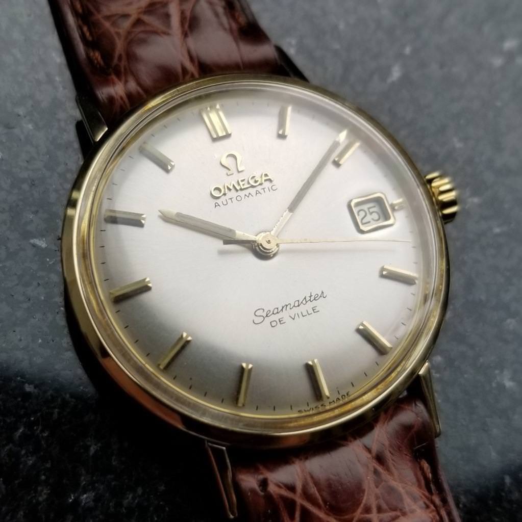

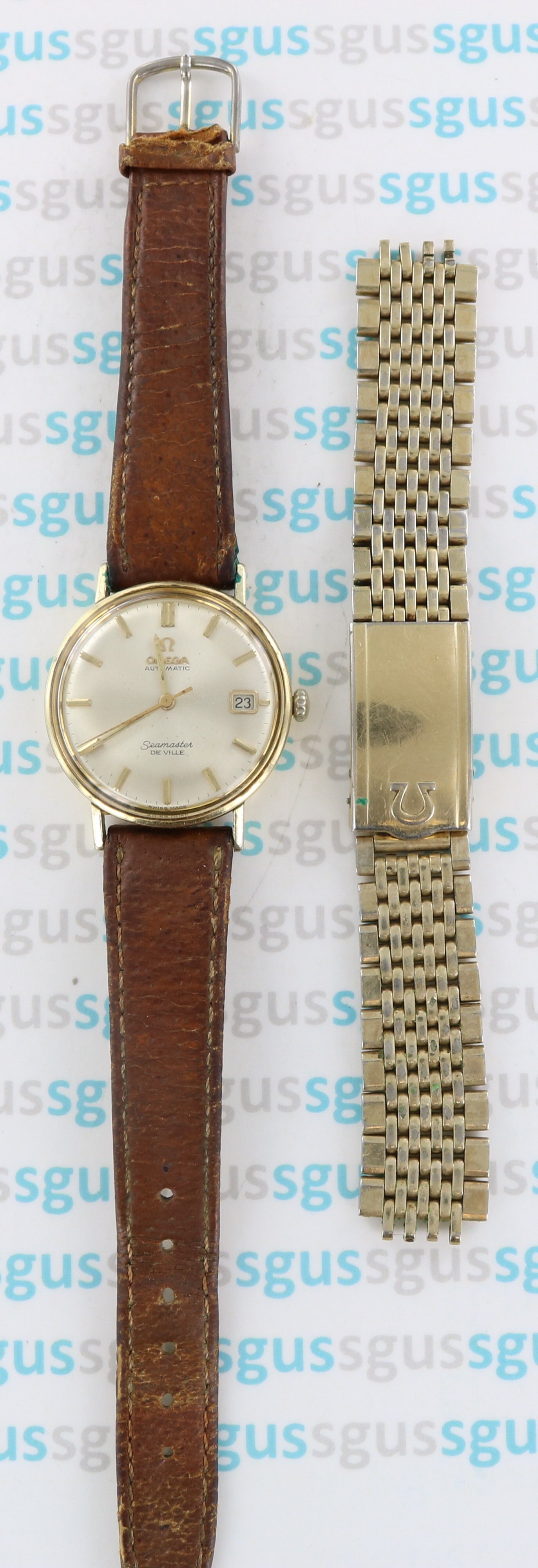

    2)
    1285462 KL6292
    Cal.560
    gold plated, with gold filled bracelet (8270 style, missing end links)
    ----Looking for gold plated end links
    this bigger picture is not my actual watch, but the only one I can find that looks exactly like it, just showing closer detail since the other picture isn't very detailed. KL6292 copy.jpg KL6292 paper.jpg
