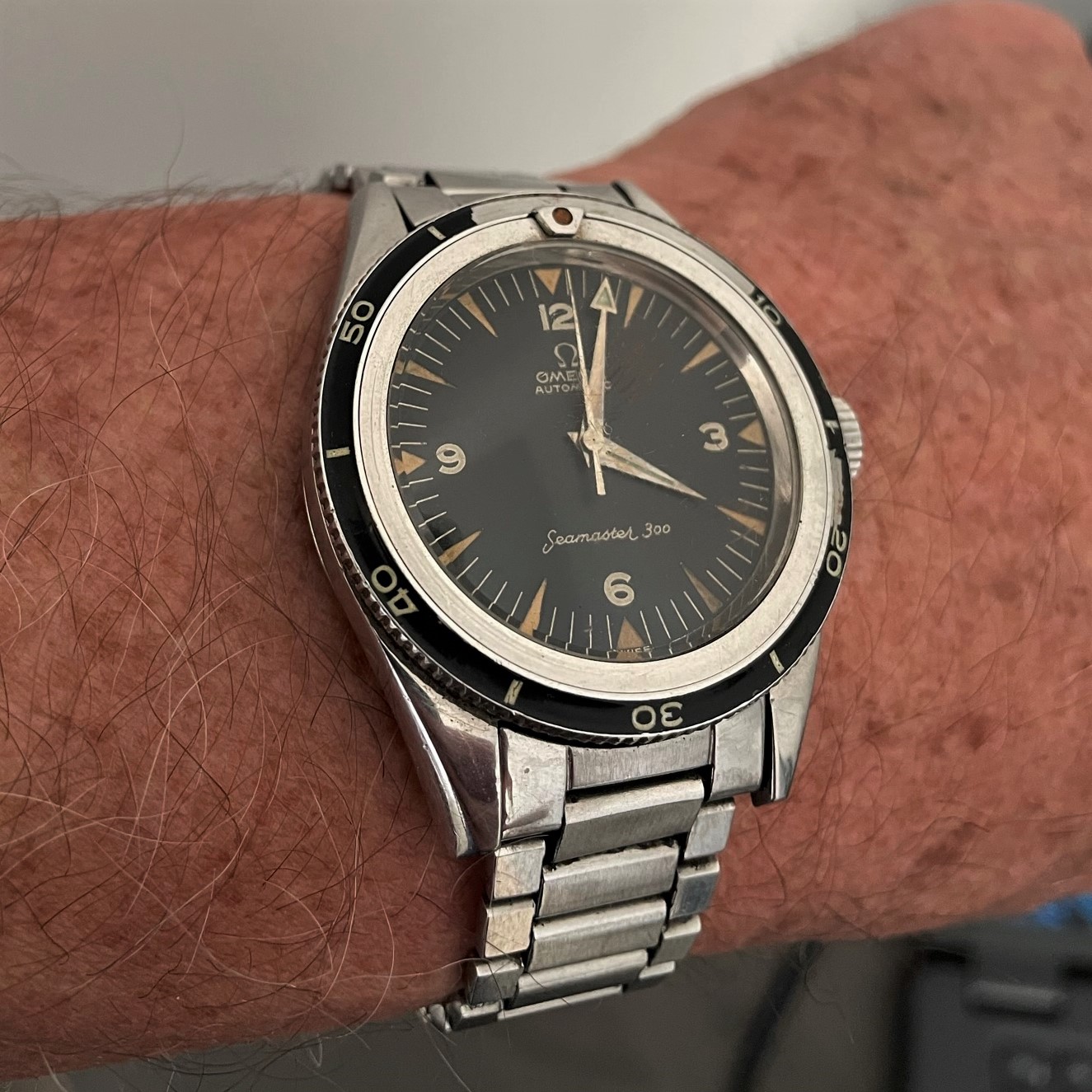

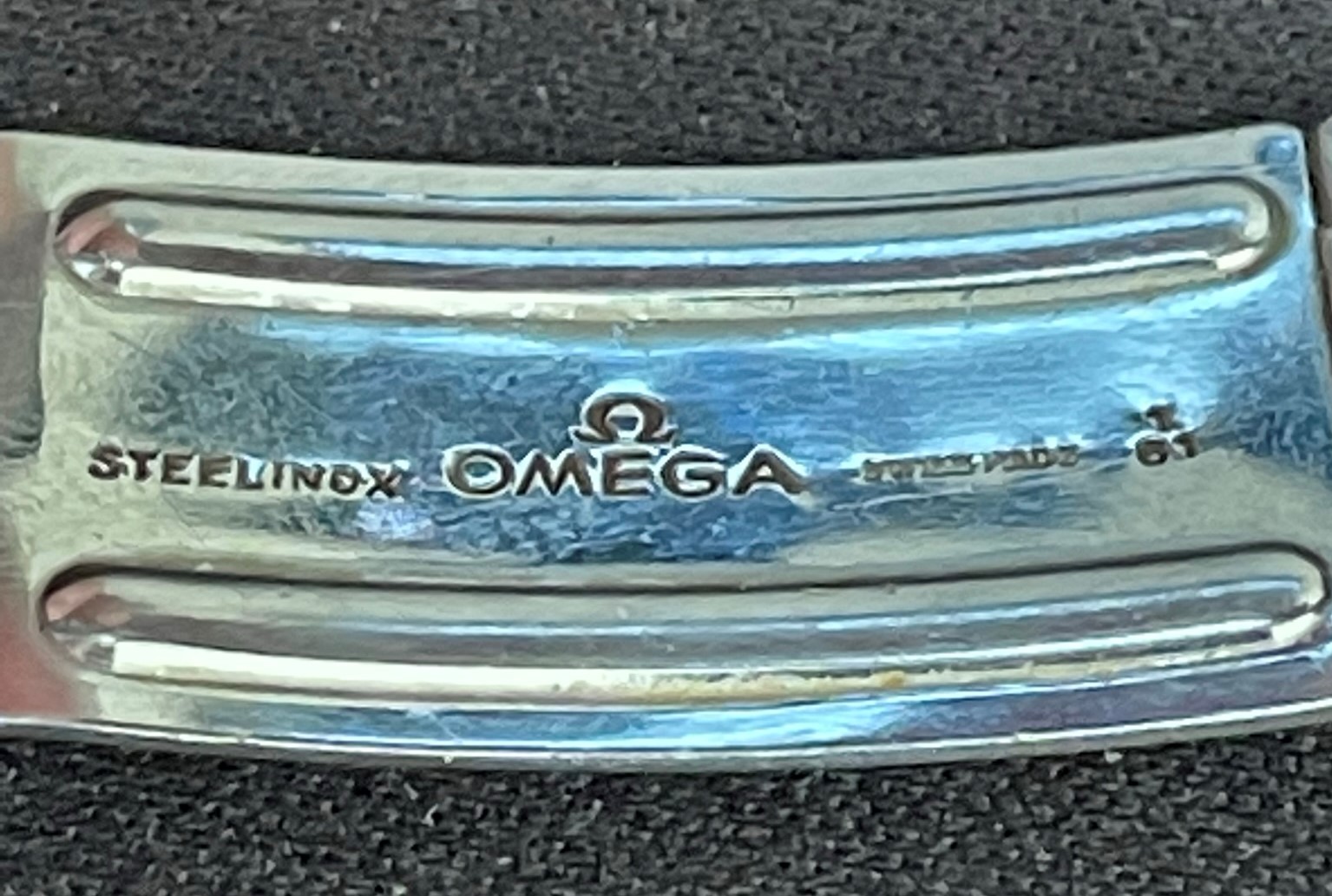

Hi All - and thanks in advance for any help you can provide. I've created a new thread because I've received some conflicting advice on what to do and NOT do with this watch. I've also reviewed threads on posting to this forum and photography (which is very difficult). So here goes...
The watch comes from my late father who passed in 2005 at 80 yo. He has had the watch for as long as I can remember. I received it in this case, along with another watch (Hamilton) and other items of his. We are in the Los Angeles area and I'm sure he must have purchased it nearby.
I had it serviced in 2005-06 time frame and I believe they replaced the crystal and got it "running" again. Other than that, I don't believe anything else has been done. I wore the watch for a year or so, which resulted in some of the black bezel coming off and I stopped wearing after that.
I'd like to get the watch serviced again, just to keep it running, but I don't plan on wearing it. I'm really just interested in maintaining it. I'm looking for the following help/advice:
1) What can you tell me about the piece? Age, model, condition, value
2) What is the best way to preserve the watch without reducing its value?
3) Should the bezel inlay be redone? I've communicated with Aldo (WWW.MILWATCHMAKER.COM) and he quoted 450E.
4) LA Watchworks has been recommended to me to service the watch. What kind of service should I request and what other things should I beware of when requesting service?
5) Should the watch band also be serviced/cleaned?

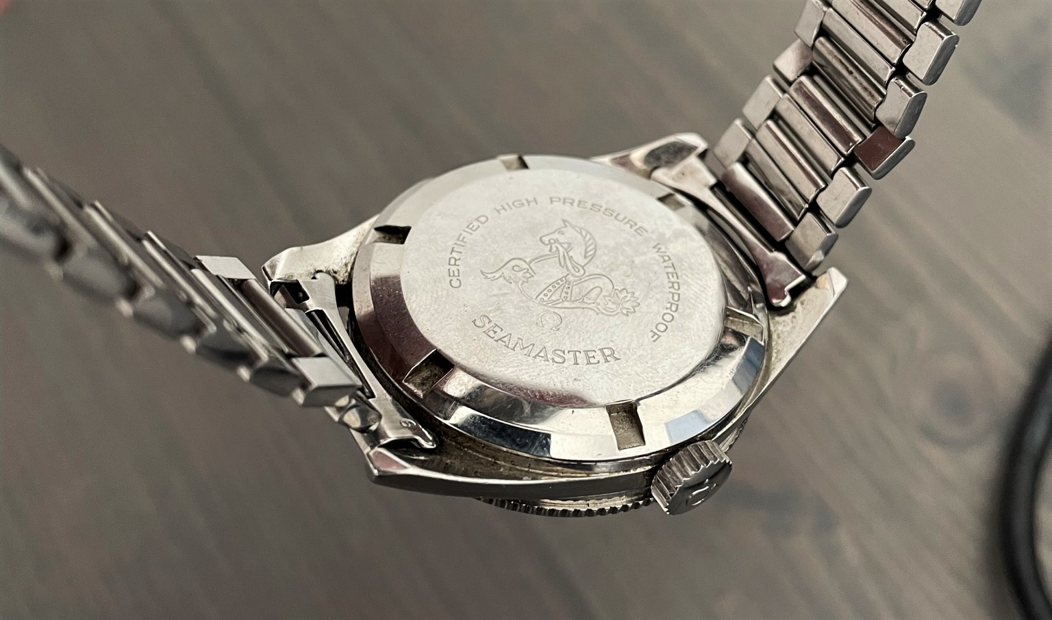

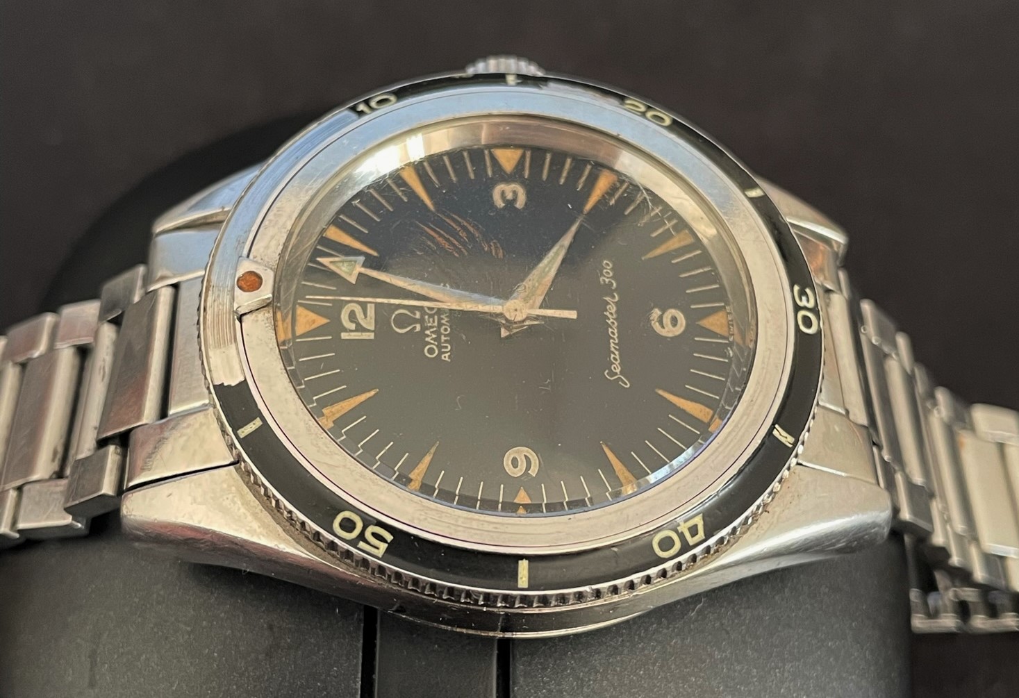

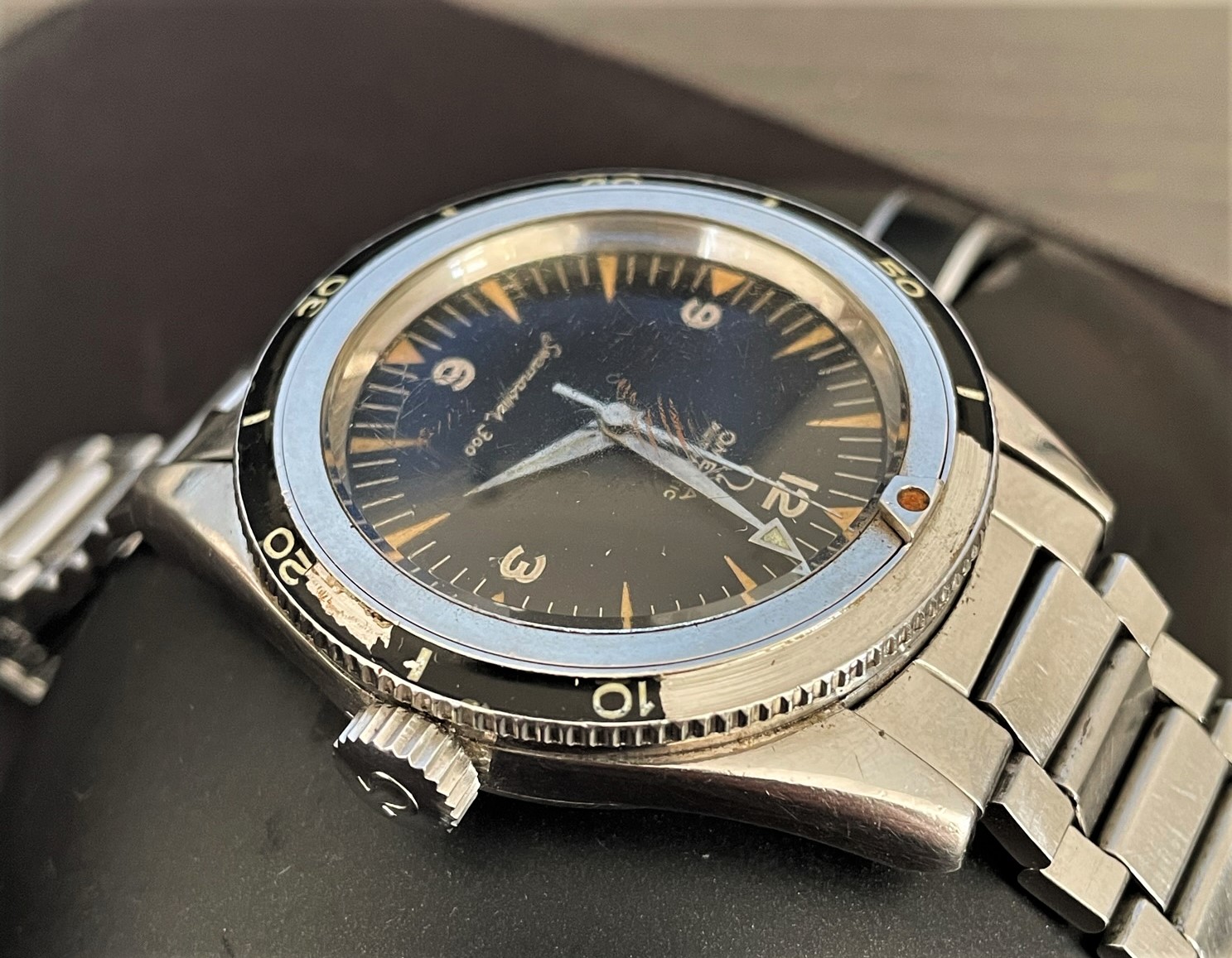

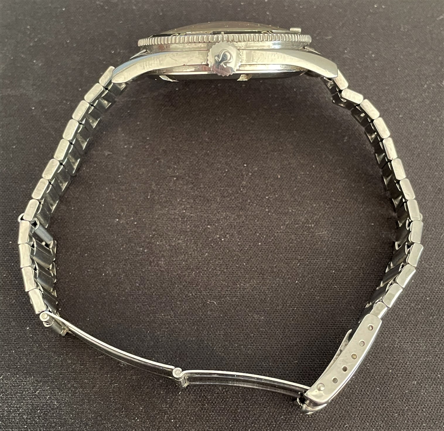

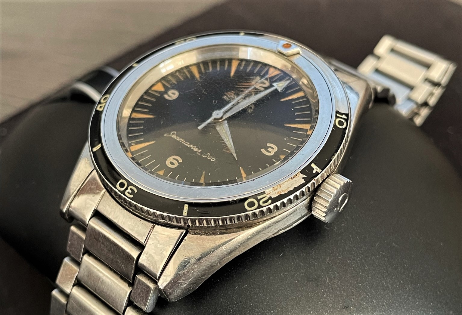

Any other advice is greatly appreciated. Here are some photos. Sorry I don't have any with the case open.

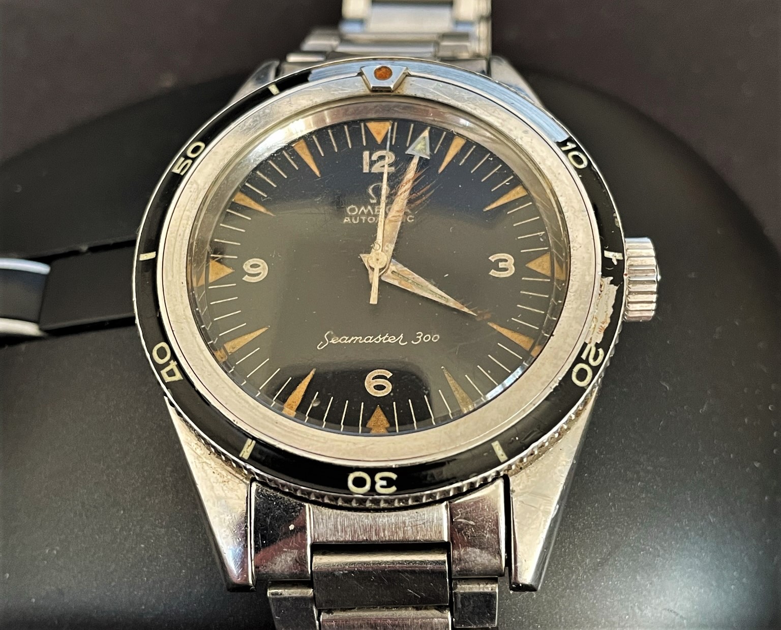

I would have the movement serviced and keep the rest of the watch as is. Even the scratches on the crystal.
One can certainly find nicer examples of this collectible model - it takes money and time to do so. But memories of your dad including the fact that this was the watch face he looked at blemishes and all cannot be replaced. My dad had an omega de ville from the 1970s that he wore for many years and he lent it to me to use when I was in the 5th grade as my watch was waiting to get a new battery. I lost the watch to a robber who stole it from me at knifepoint. If I had that watch today I would consider it the jewel of my collection.

- if you plan to sell it: leave it as it is and let the new owner decides what to do
- if you want to keep it, let the bezel be repaired, then send it to a watchmaker (NOT Omega) for a service of the movement. No polishing, no change of visible parts except it’s necessary for some reason (for eg changing the crystal of its not watertight anymore). NO work/change on/of the hands, dial etc.
Choose a watchmaker who is used work with vintage (Omega) watches.
Good luck and keep us updated.

Agree with above comments. If it was mine I would definitely try to keep the bezel as is and try to find someone to stabilize it. Then you might be more inclined to wear it. If you plan on running the watch by all means have it serviced. I am sure you know that LA watchworks is super expensive. If you have no intention of running it at all, then don't even service it.

Yes LA Watchworks is very expensive and has a long wait... for the reason that they wont mess with your nice vintage watch, only do things a collector would want done. If I didnt know a lot about watches but knew I had a valuable one (you do) LAWW is one of the places I would send it, they cater to collectors and understand vintage. Plus it sounds like they are local to you so you can go by and drop it off in person to discuss the work. That, for me, is worth the couple hundred extra right there. I would stop by, see if they can help with the bezel and if they can, then discuss a movement service as well. Say NO to a relume but if they say the lume on the hands needs to be stabilized I would let them do it. Just my opinion, lots of folks in the world that can do it well but only so many are in your own backyard.

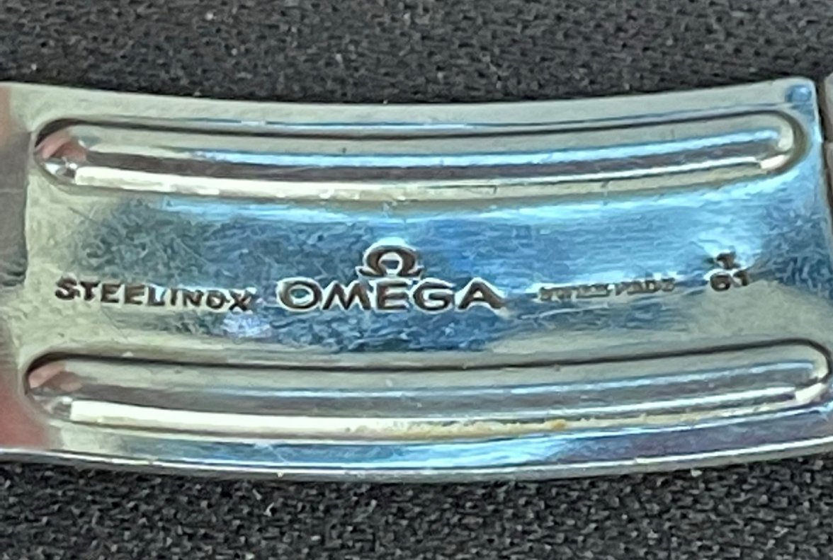

What a nice ref.14755 you have! Maybe is a 14755-1 or -2 from 1961.
All original. Only " Swiss" dial. The bracelet is a transitional, correct for the period. The "6" end links are original (and very rare!).
The cristal seems to be original.
You can go to the watchmaker for a movement service. Please do not polish it. I would polish only the scratches on the glass.
You can clean the bracelet by removing from the watch and put it in a pot with water and dish soap. Keep it inside until the water boils. Repeate if necessary.

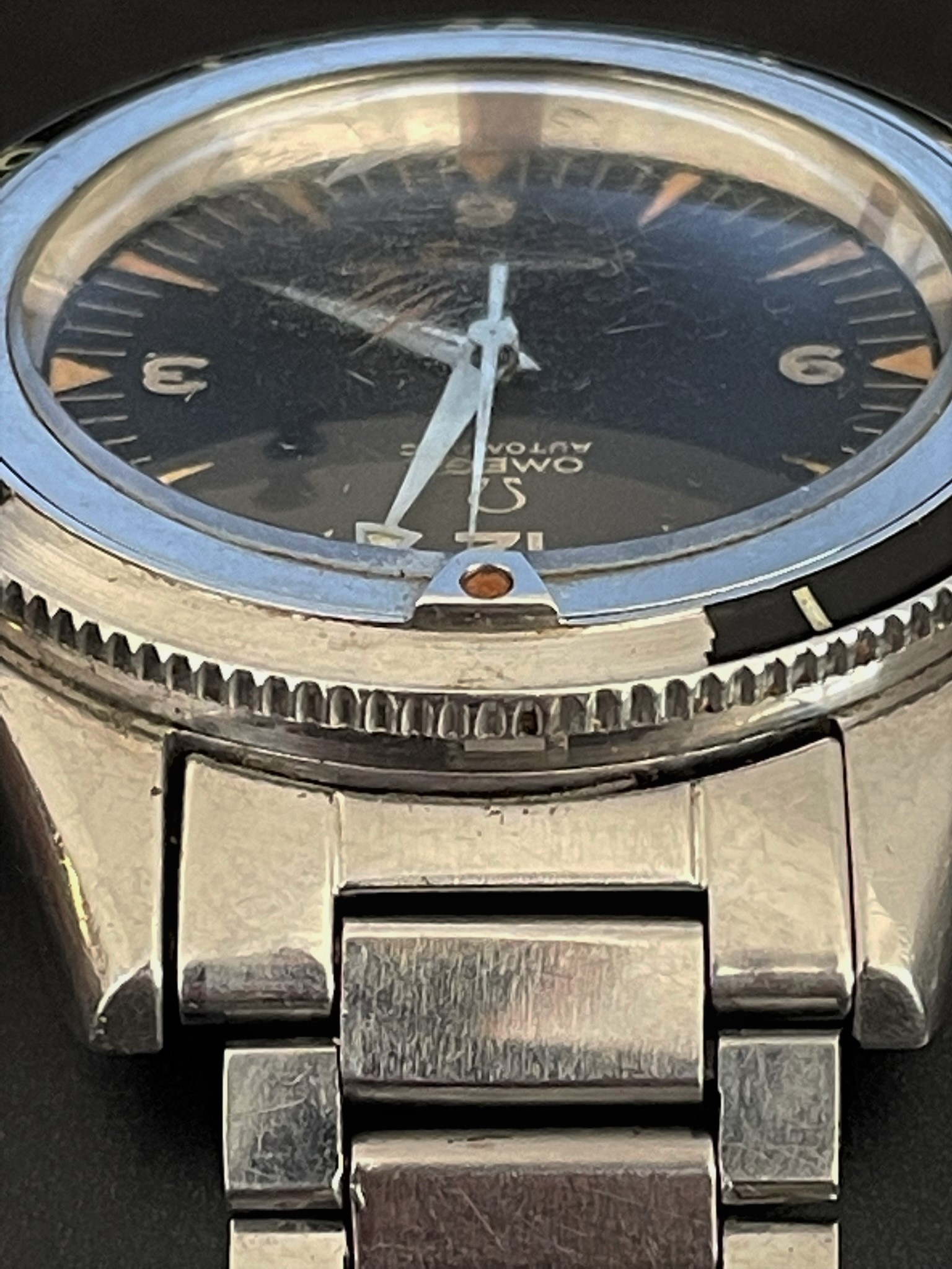

Please note that the bakelite insert is very fragile.

Just to say that once it’s had a good, sympathetic service (ie full movement service, case clean but no polish, no new crown, no work to the dial/hands unless the lume is crumbling in which case stabilisation is ok and finally some method of stabilising the bezel to prevent further loss), there’s absolutely no reason this can’t be worn safely.
I wore a similar aged Speedmaster as my daily for 5 years before the arrival of our first child made me decide to retire it from daily driver to occasional wear. Even if you want to be super careful it could be worn a couple of times a week.

10k? If you advertise it for that price it will be sold in a flash

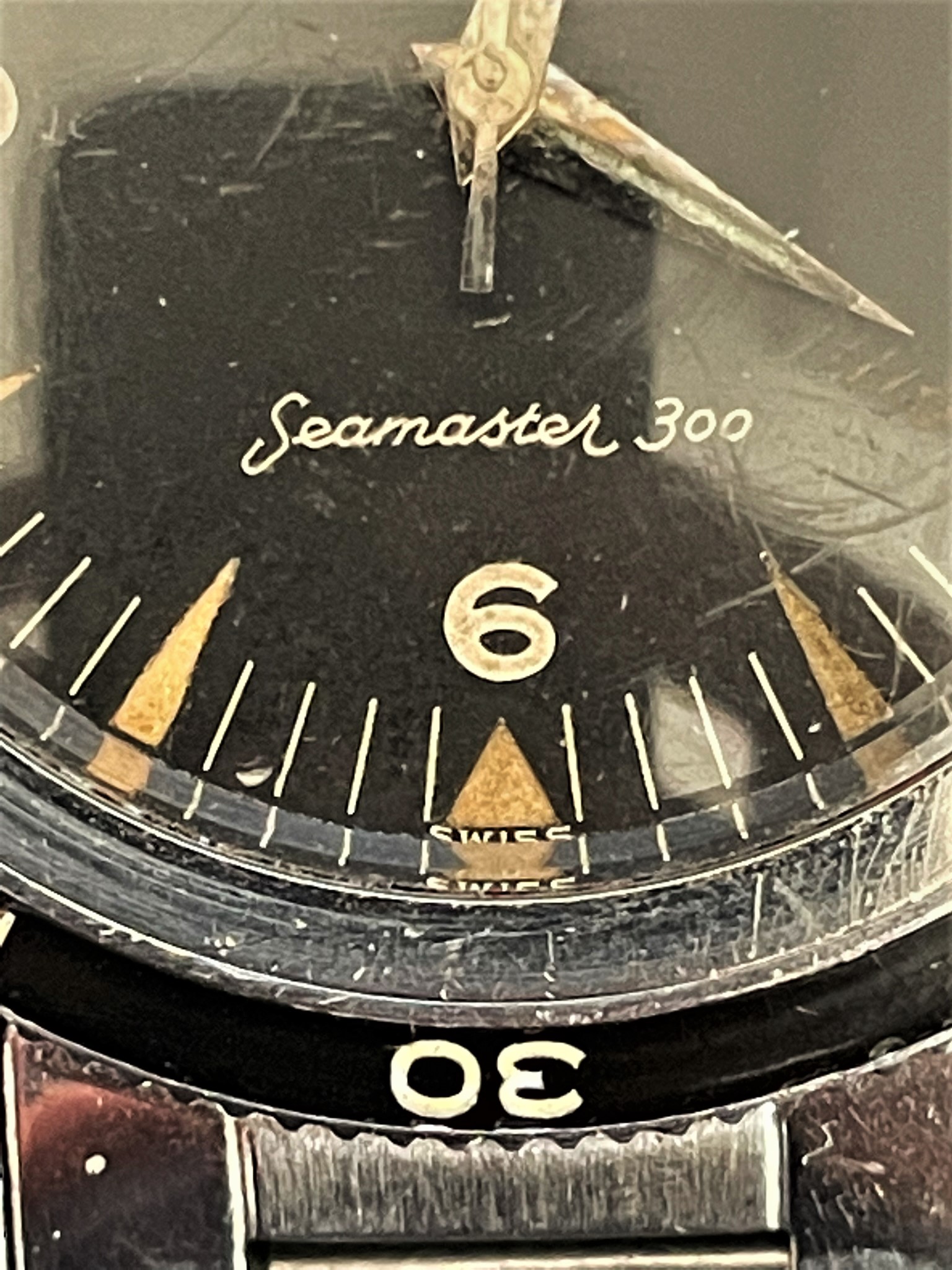

That SWISS only dial is really super nice 🥰.
As for the price, the bracelet and endlinks are worth a lot (I guess in the 4-5k$ region). So attached to the watch head, I guess we are more around 15-20k$.
