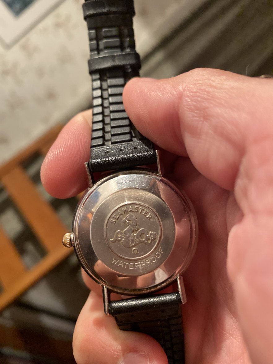

My grandfather recently passed away and left behind his seamaster. I will likely take it to a jeweler but was wondering if anyone had any clue on the ref # for the attached? Thanks in advance!

Just googling, and others with more expertise than me may well have a different view, it may be an early 60s pre-De Ville, Seamaster 14765.
This is what I found on Google.
You can google yourself.
Yours looks as though it may have a monocoque case which means that the back isn’t removable and a professional watchmaker - not the guy in the mall - would have to remove the crystal, the crown, and the stem to gain access to the movement, which will have a serial number and a movement number which will tell you a lot. Also the inside of the case will have a case number.
Get your watchmaker to photograph the numbers etc.
The watch will need a service and would look better with a nicer strap.
The crown looks wrong and you might get it replaced and the crystal could be polished or replaced.

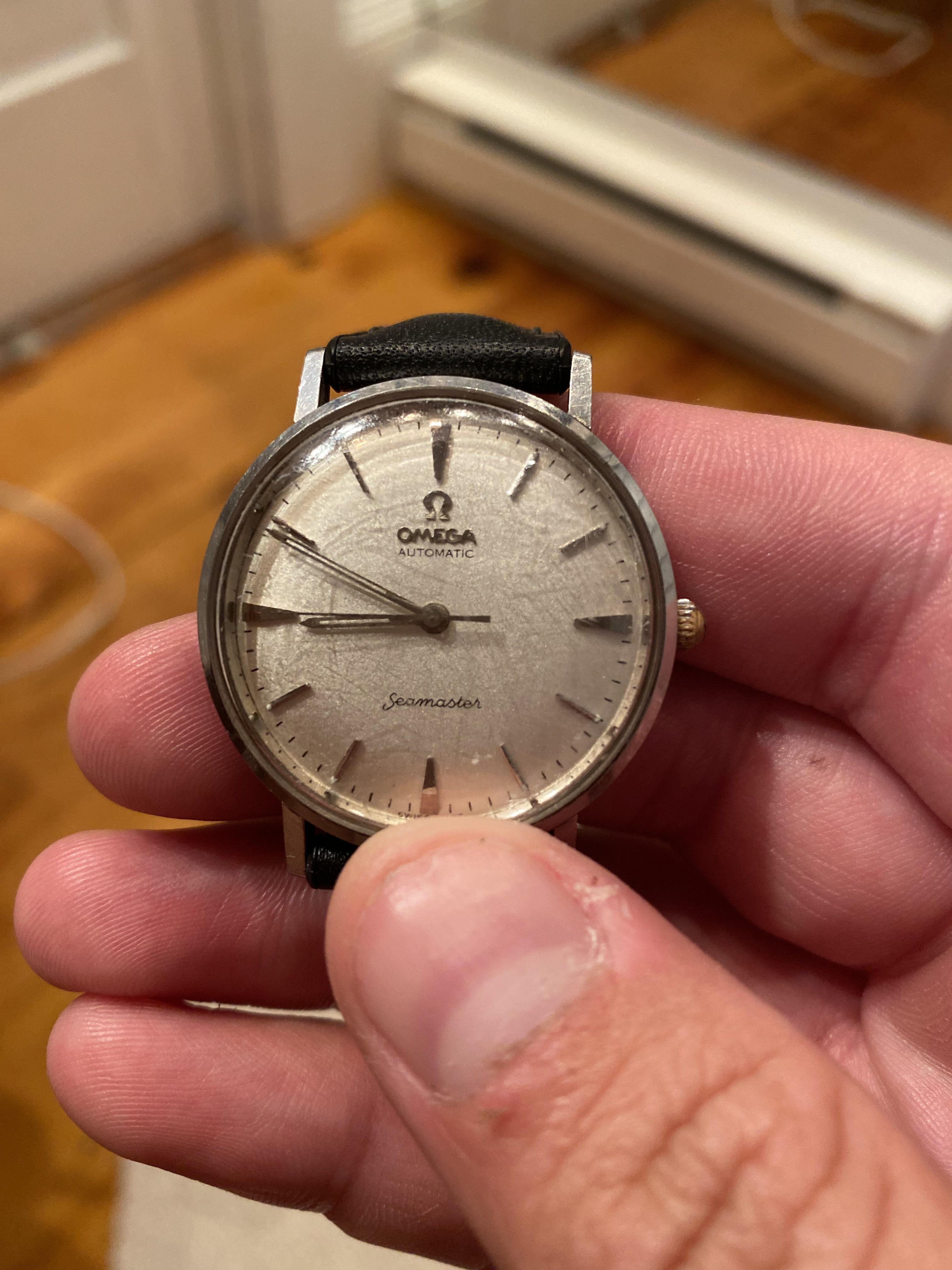

Nice. The case looks original and unpolished. The hands are missing lume. The lume on the dial appears unusually white, but that could be the image. The white lume could suggest newer lume and a possible redial, I'm not sure if the font on all correct on the dial.
