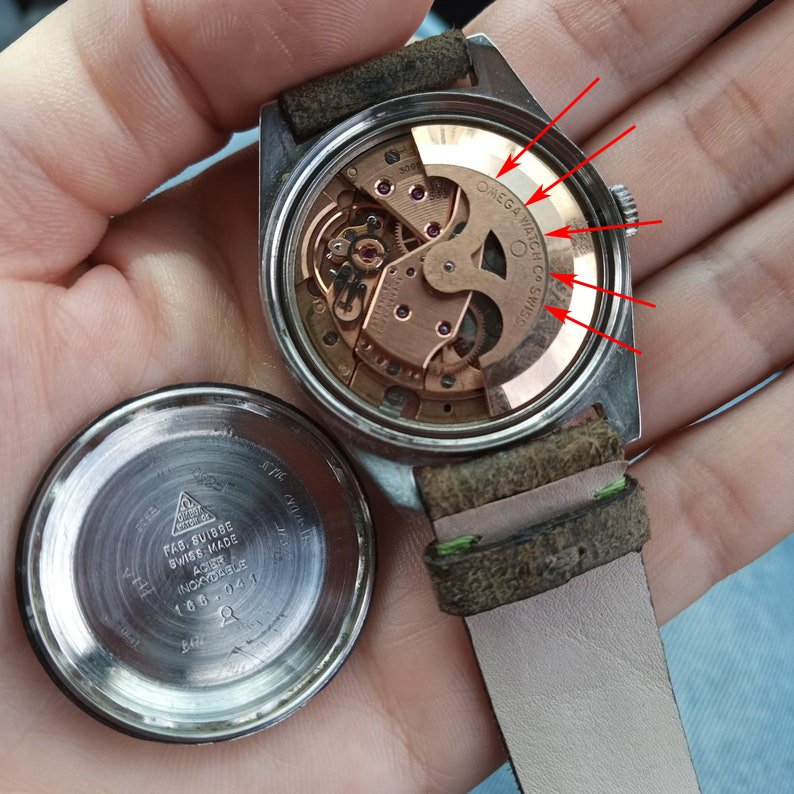

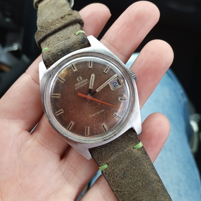

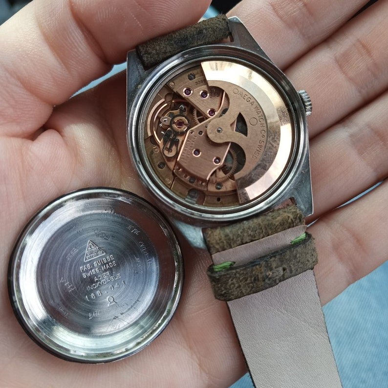

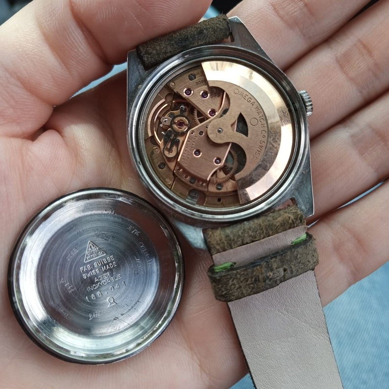

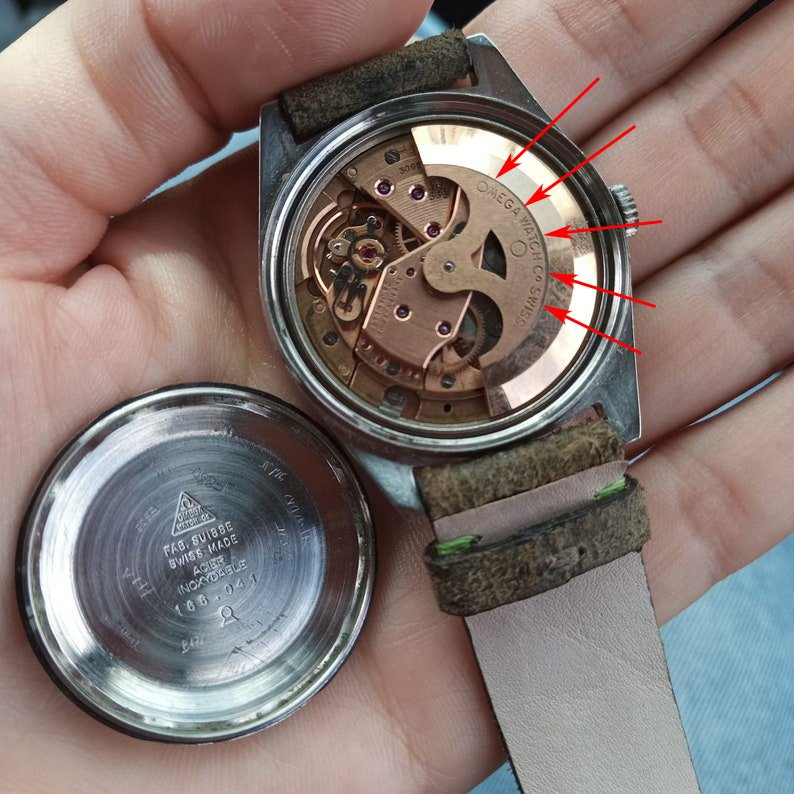

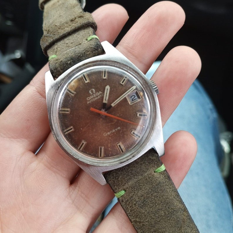

Wanting to know if this vintage omega is legitimate. everything looks good to me but I’m still new to this and I really like the patina on the dial

Looks correct however there is evidence of severe rotor rub caused by a worn or broken bushing/axle.

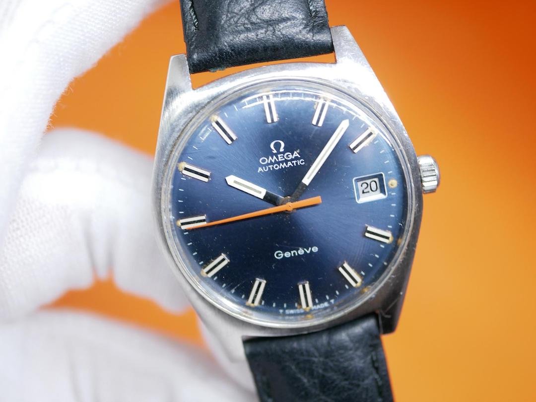

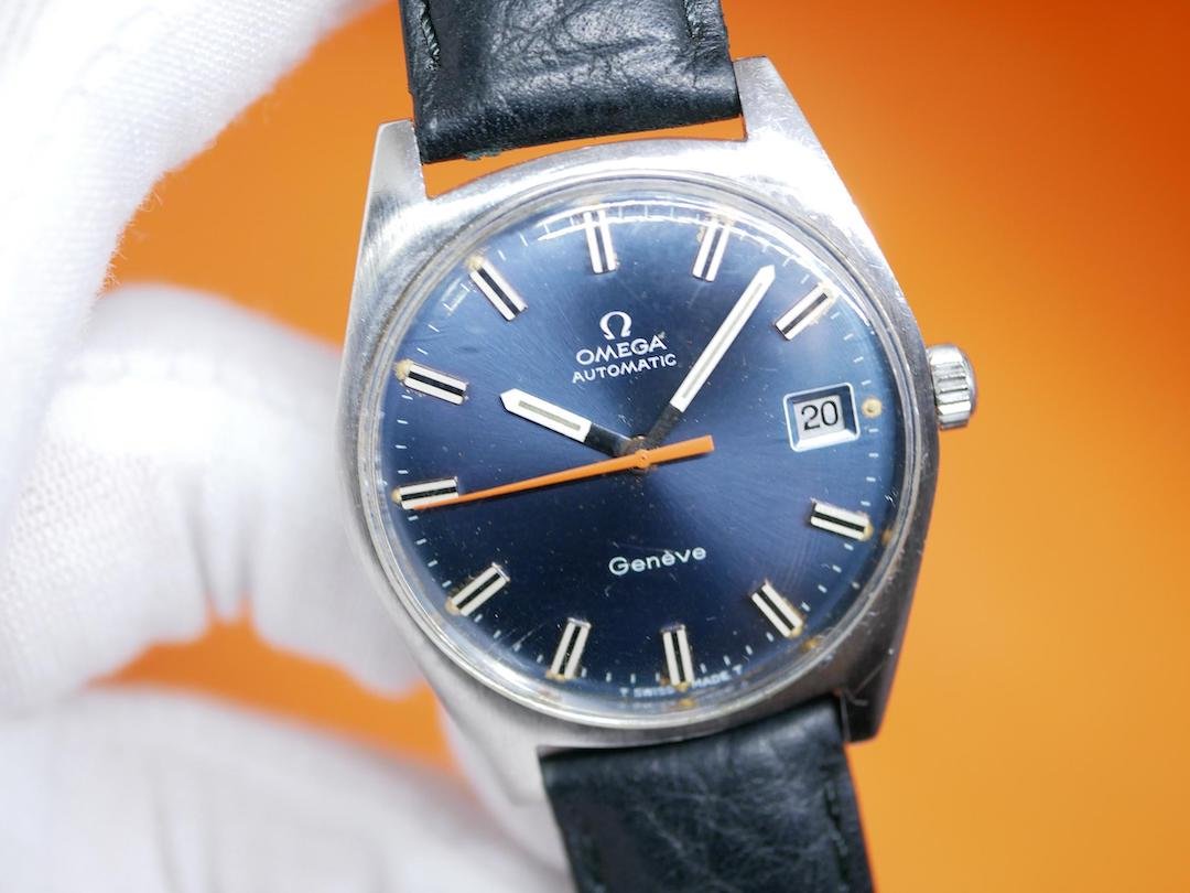

Believe it or not that was once a blue dial.
Ha! Never would have guessed it use to be blue. And thank you for pointing out the rotor rub, with that pointed out. is this worth getting deep cleaned and touched up? Is rotor rub a serious problem?
Yes, it's dumping tiny bits of ground up metal into the movement which in turn is wearing pretty much every other part.
Unless it's really cheap like $100 I'd pass.
