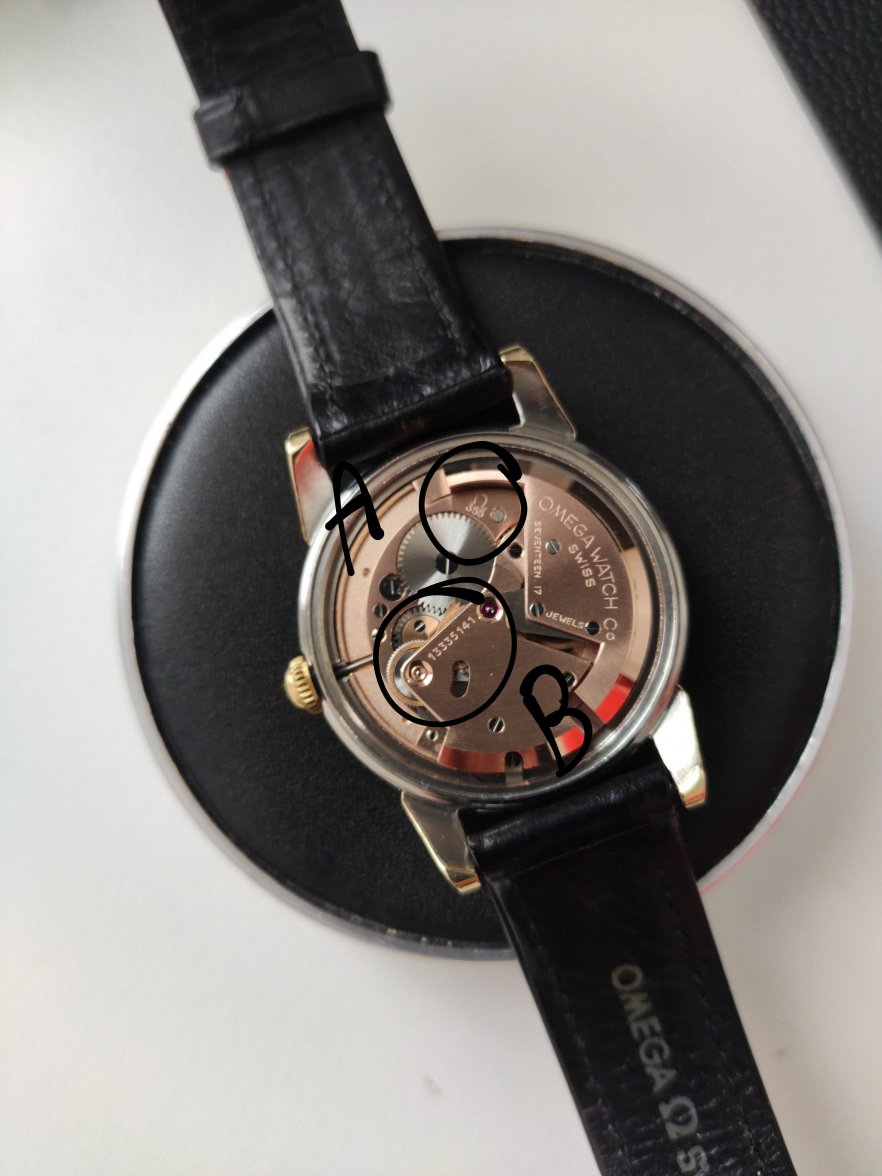

Pull need to open the case on the back of your watch to display the movement of the watch. As an example, here is the one from my SM calendar:
A: is the caliber number
B: is the serial number ( allowing by searching the internet to date your watch approximately)
