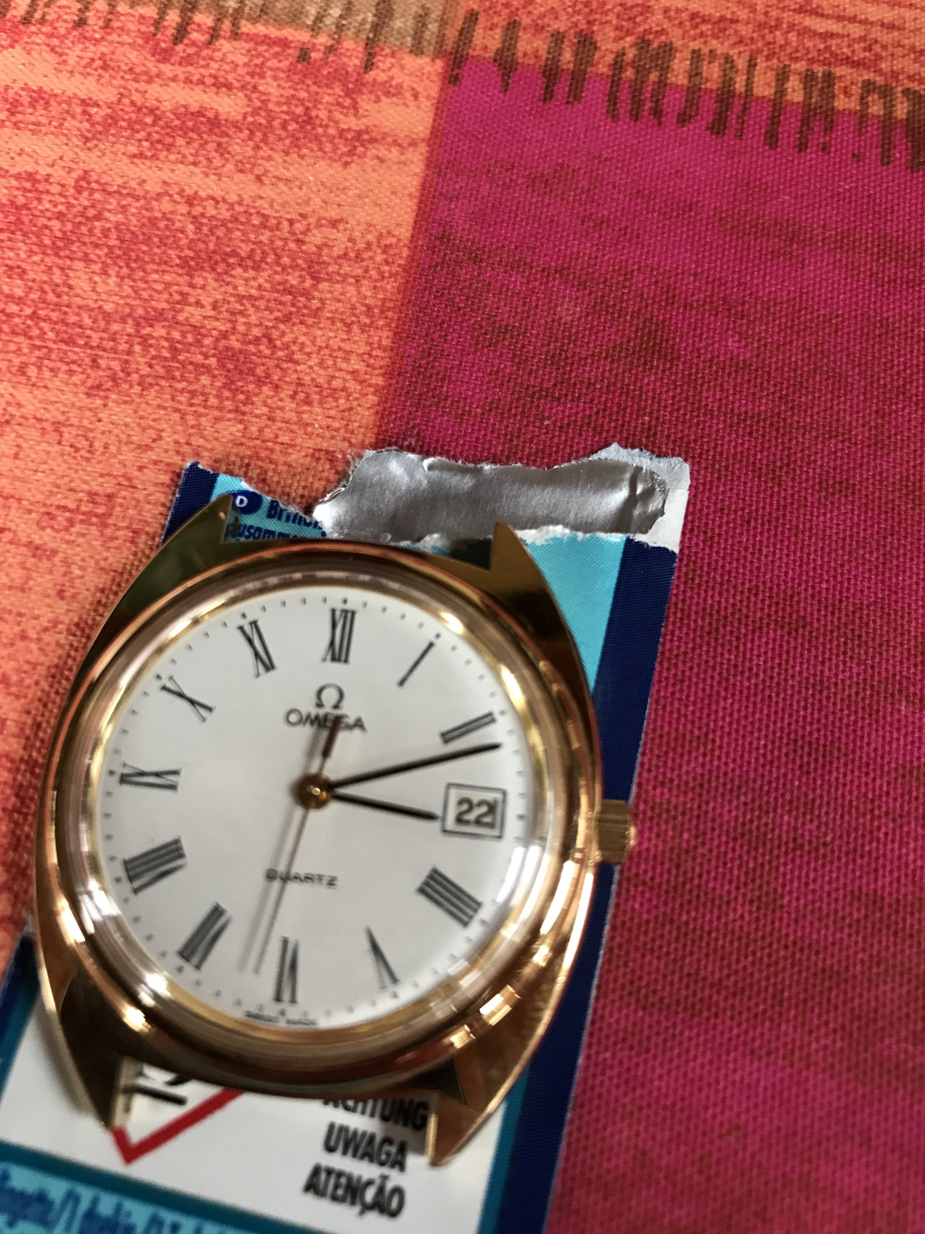

Hello

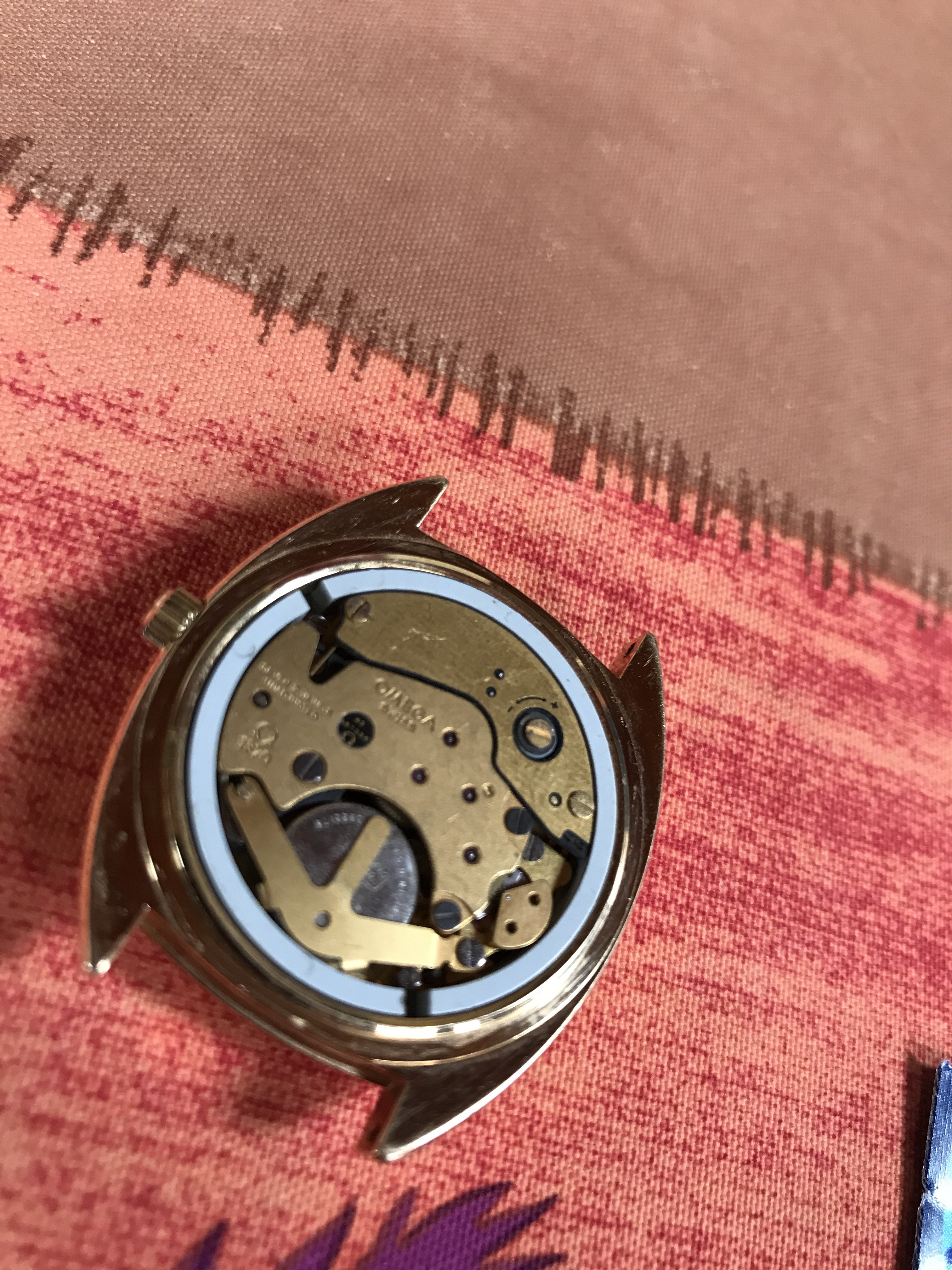

i just found this nice little omega quartz with 1370 mouvement.
i asked myself how can i change de battery, i dont know how to do on this mouvement.
thanks a lot

Maybe just remove the existing battery and read the numbers on it. Looks like you will need a screwdriver. 馃榾
5,631
5,815
Unscrew the big screw about 2 full turns and slide the bridle out. Don't remove the screw.
7,797
14,399
And be careful of that bridle, if it breaks you are screwed. For safety I would remove the screw so you can slide it out with minimal twist and tension on the bridle.

It just worked ! Thanks a lot. The watch was sold for parts but i succed to repair the mouvement !
Now i have another little problem the rod of the crown fall when i pull her...
How can i fix it ?

That's the "winding stem" and depending on the movement, you might not be able to. But that tiny screw nearest the crown tube is what holds it in.

Sucess !
The winding stem dont fall anymore ! Well now i have to find the back case absent of the watch...
