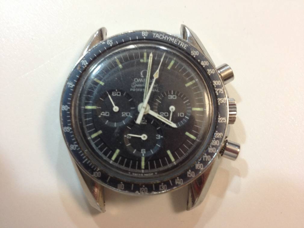

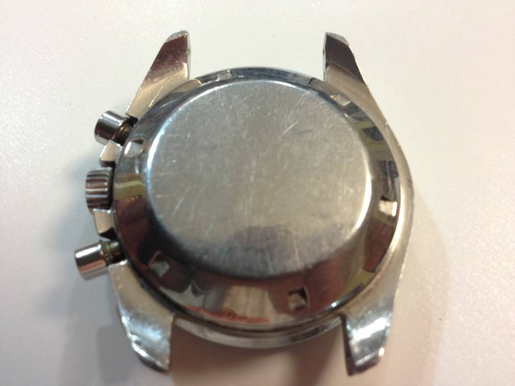

    I posted another thread here where I received much help:
    http://omegaforums.net/threads/inherited-an-omega-speedmaster-professional-from-father.4733/
    I have another question: What bracelet should I get? In the previous thread it was said that the 1171 bracelet fits it. However, both Nesbit's and Al Archer have said they cannot guarantee it fits because it is not listed on the Omega Extranet as a bracelet that goes with the 145022 case.
    Here's the info:
    861 Movement
    S/N 30392799
    Case # 145022-69
    Al Archer says these are supported(as stated on the Extranet): 1498-840, 1998-840, and 1998-849 bracelets.
    I do see elsewhere ofrei.com that the 1171 may work, though:
    Omega Speedmaster Bracelet 1171-000
    with End Piece 633 to Fit Omega Bracelet 1171-000, Sold by the pair fits case # 145.022(mine, right?)
    Any help in narrowing down the bracelet would be appreciated. The Extranet-recommended bracelets are about $800. I don't feel like paying that at this point.
    -Nathan

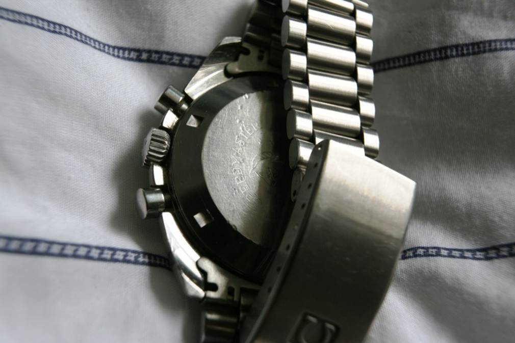

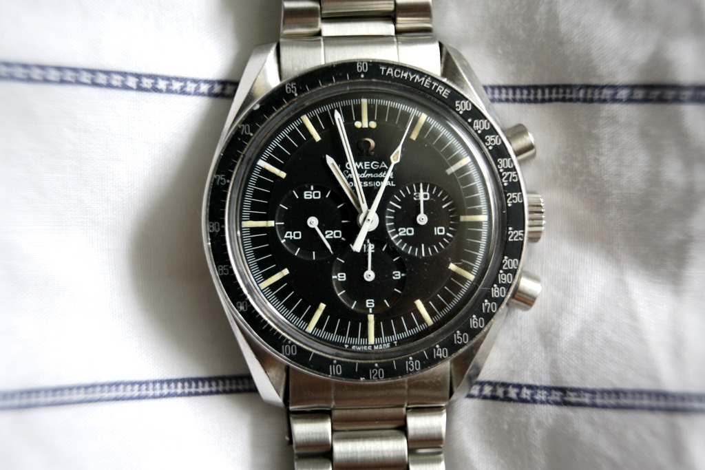

  8. Wheels Apr 8, 2013
    367
    100
    Here are two photos of my 145.022 68ST fitted with an 1171/1 and 633 end links. It looks fine. As you can see there should be no problems with it fitting at all.
    ImageUploadedByTapatalk1365421295.592520.jpg ImageUploadedByTapatalk1365421308.845866.jpg
