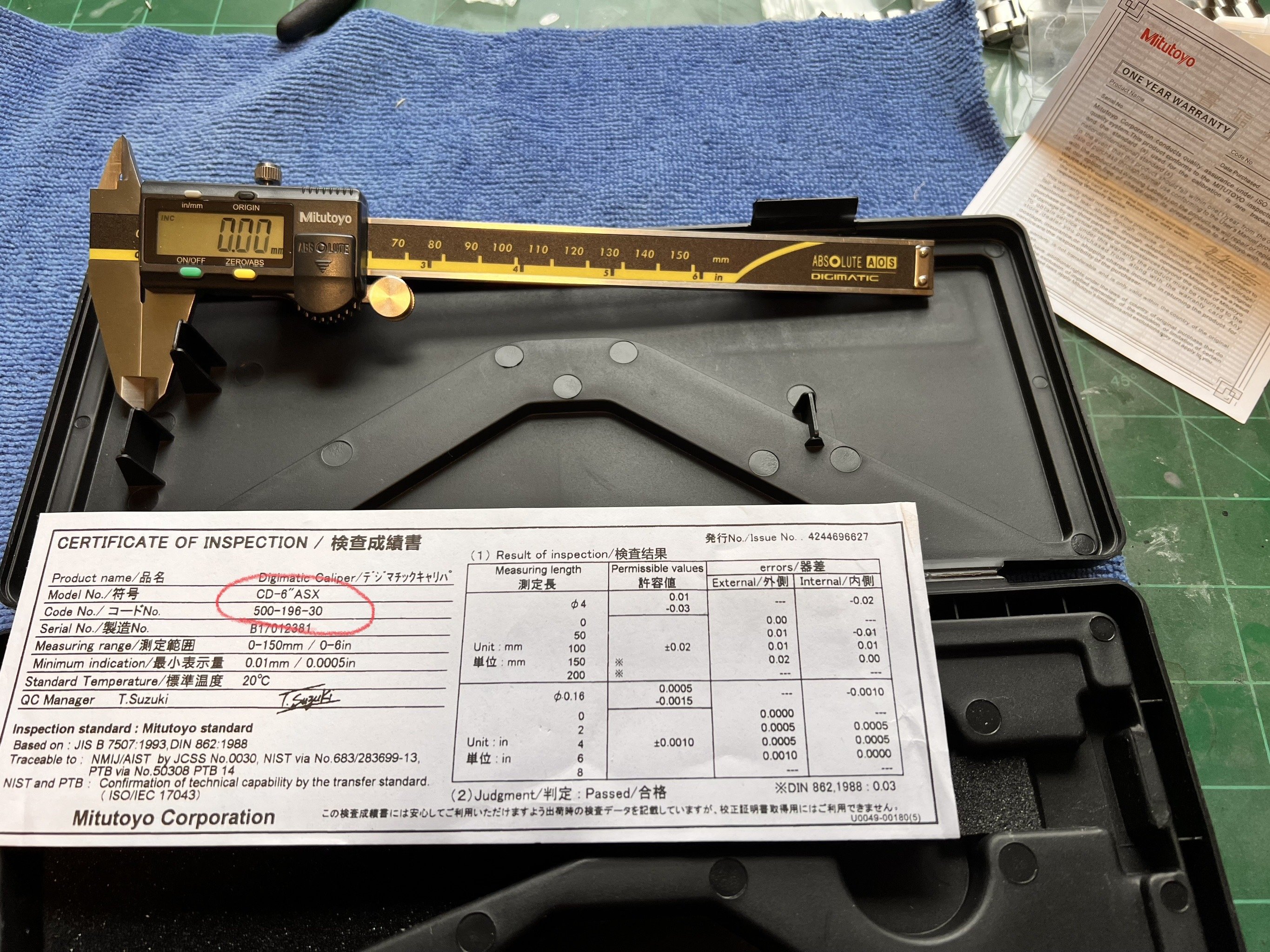

Get these all day long on EBAY $40-65 some new, some rebuilt or lightly used.
Probably some of the finest vernier caliper you can find-for the money.
