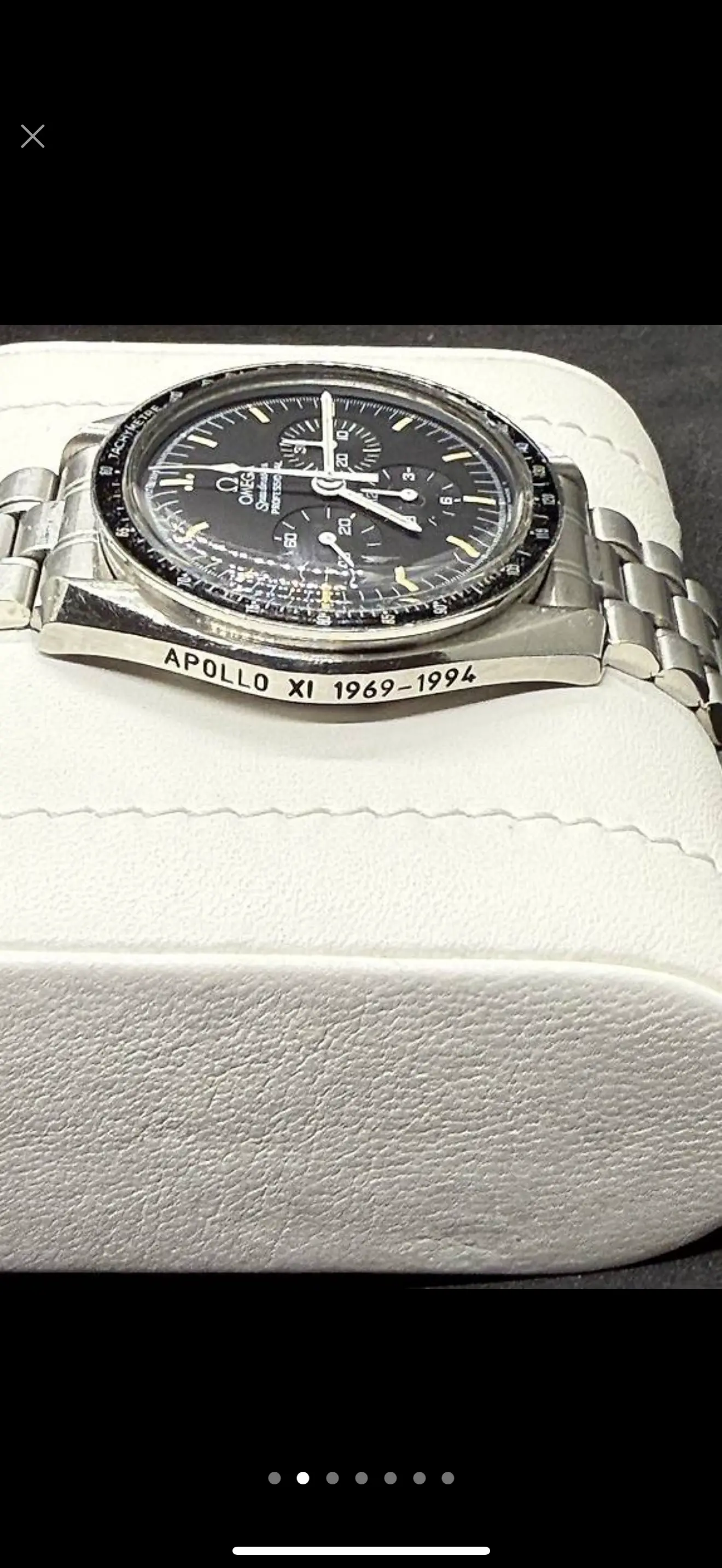

Good evening all,

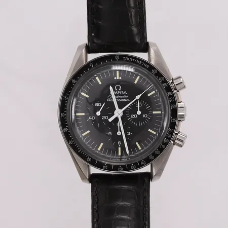

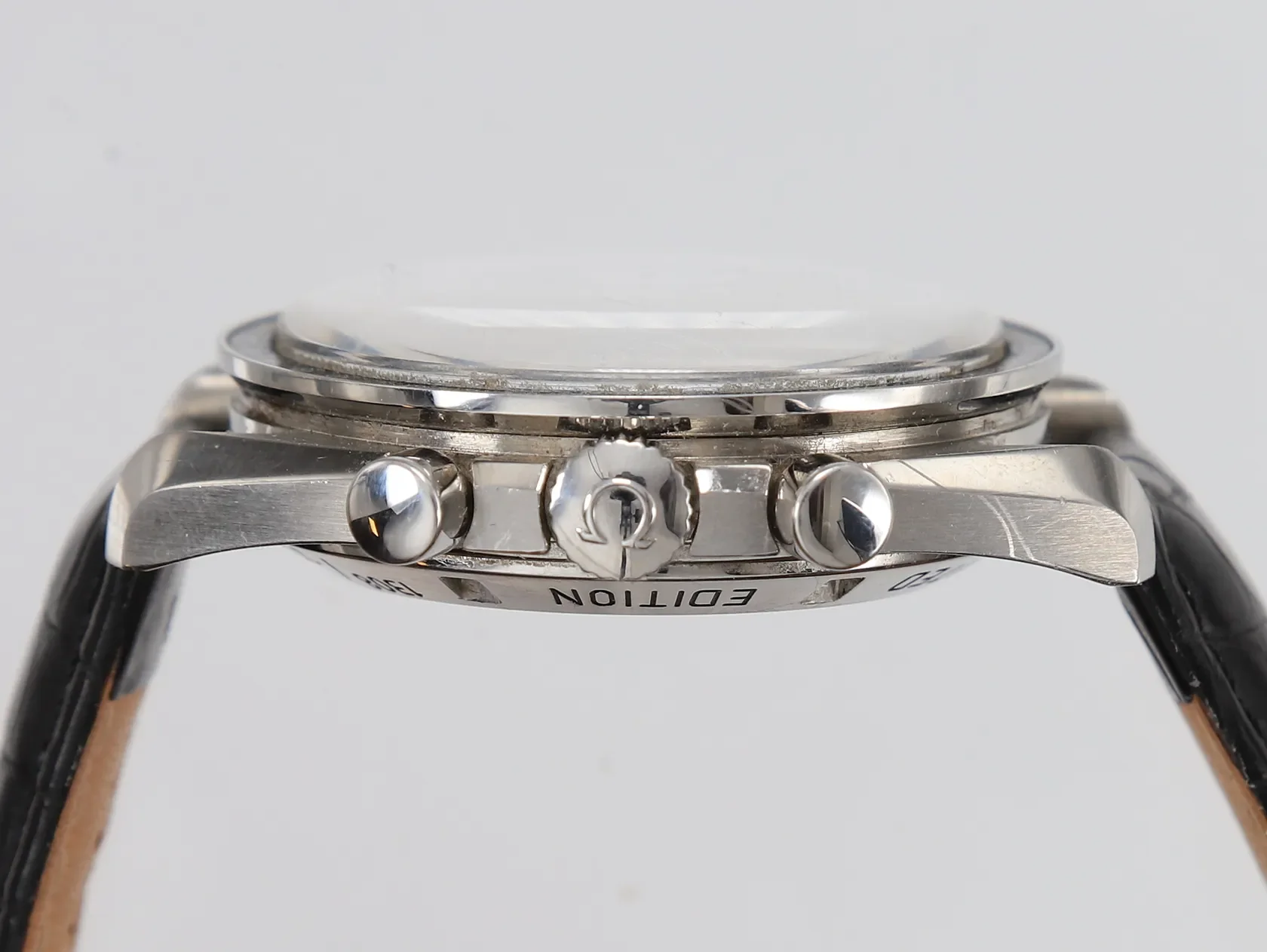

This speedy is up for sale at an auction site
in my country. I'm interested, but I have some concerns and Speedmaster is not my field im afraid.
This is the info from the ad;
Apollo XI 25th
Ref. 145.0062
Cal 865
Year 1985
Serial 48303828

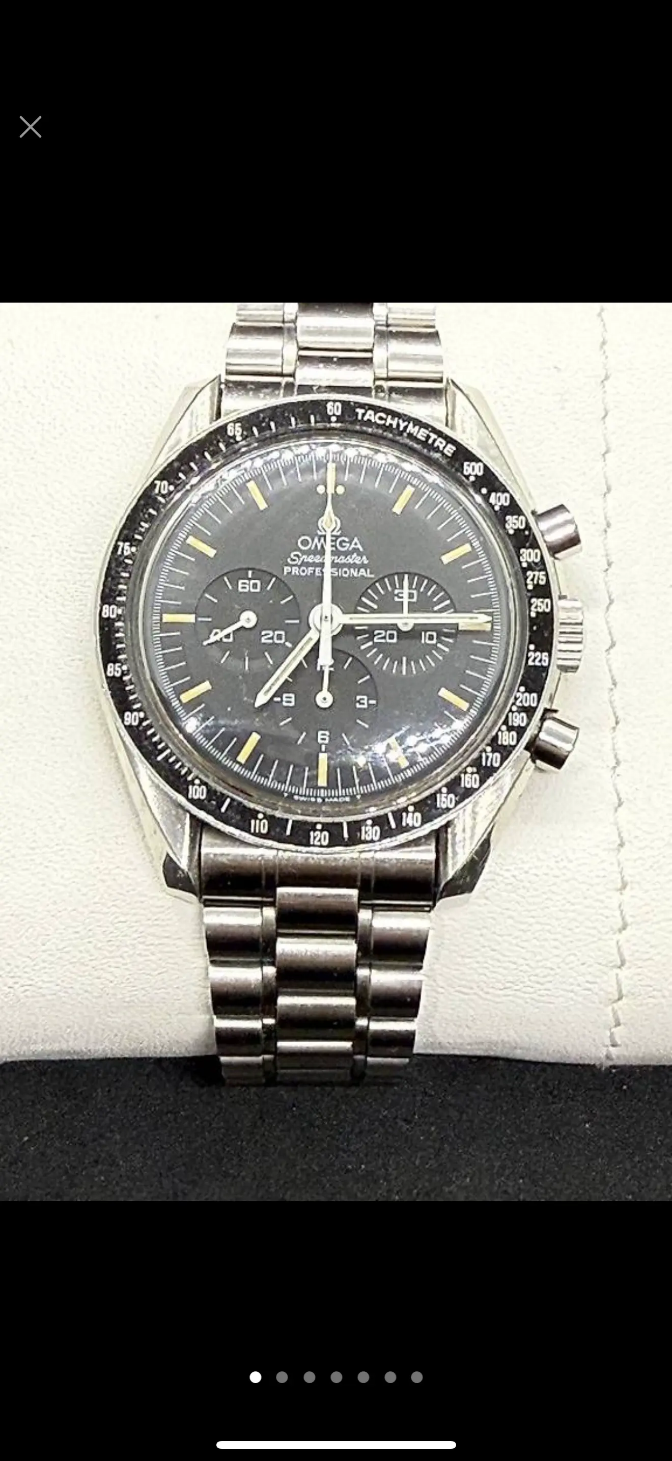

It's watch only and obviously on this aftermarket strap.
No movement picture or service history

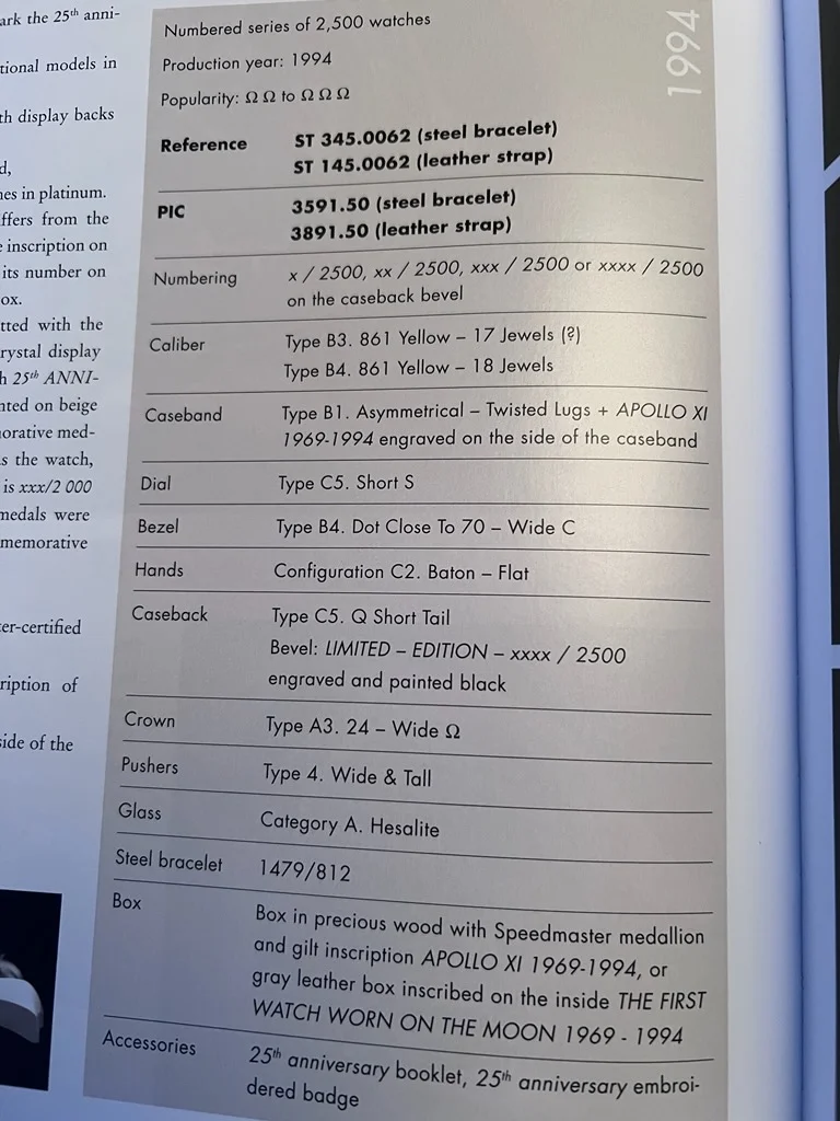

Serial number 48mill matches 1985
This is a 1994 collection?
Cal 865 is not correct?
And there are several ref.nr for this model
How can 145.0062 be correct?
148.0062 / 348.0062 (solid white gold)
3891.50 (stainless steel)
Anything else I'm missing here?

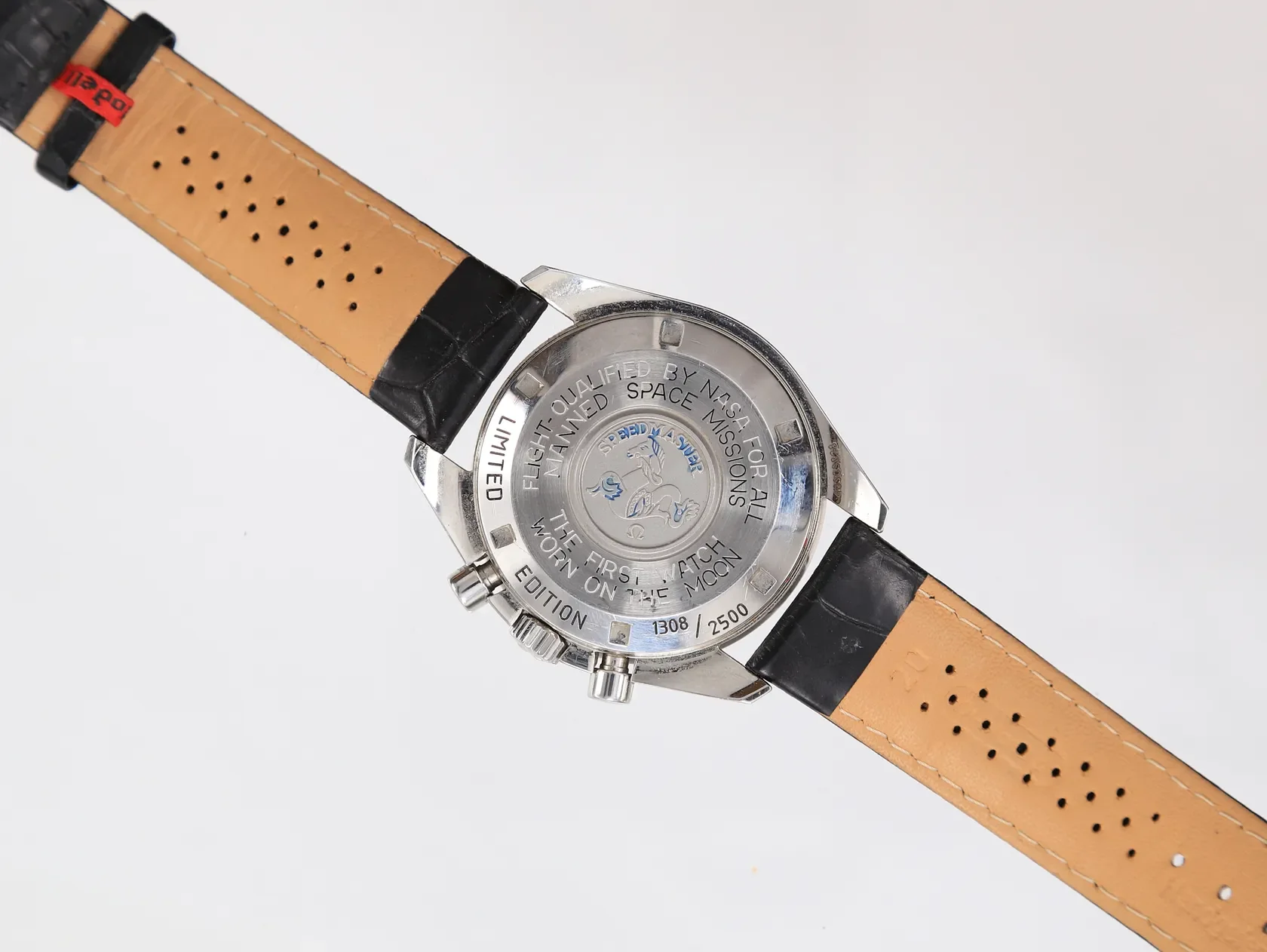

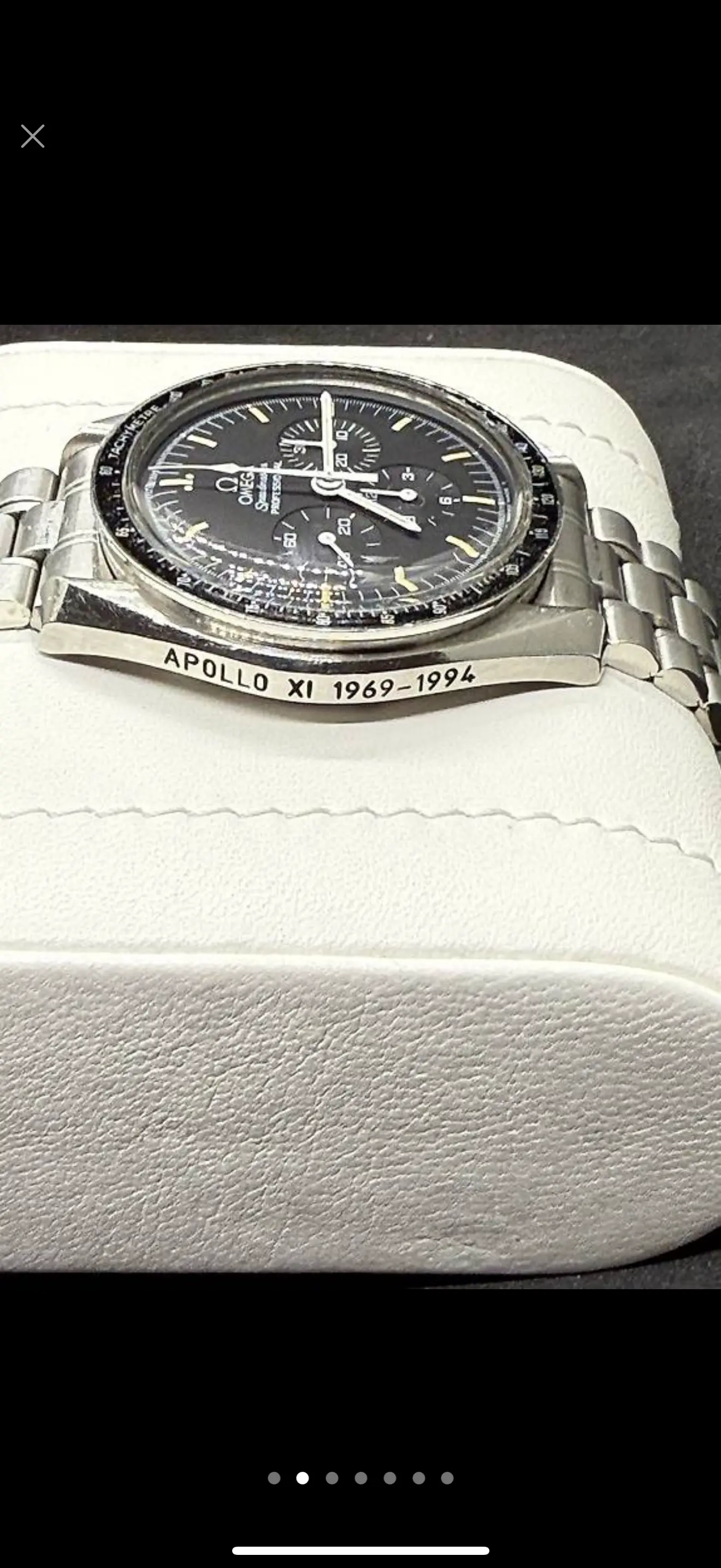

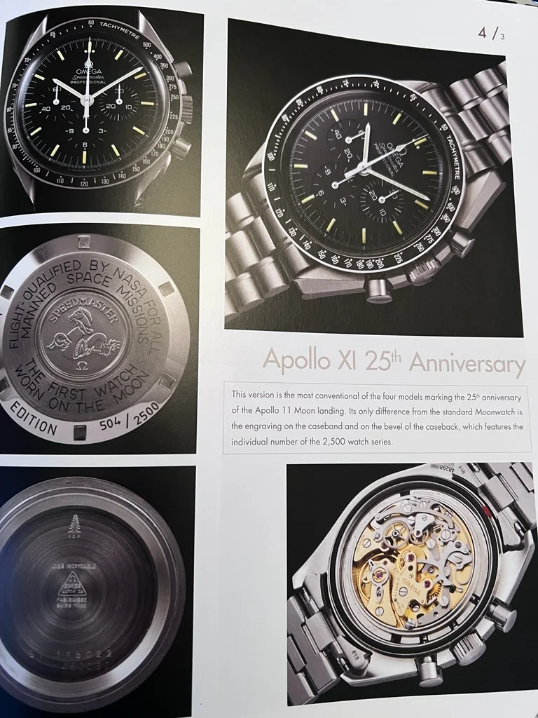

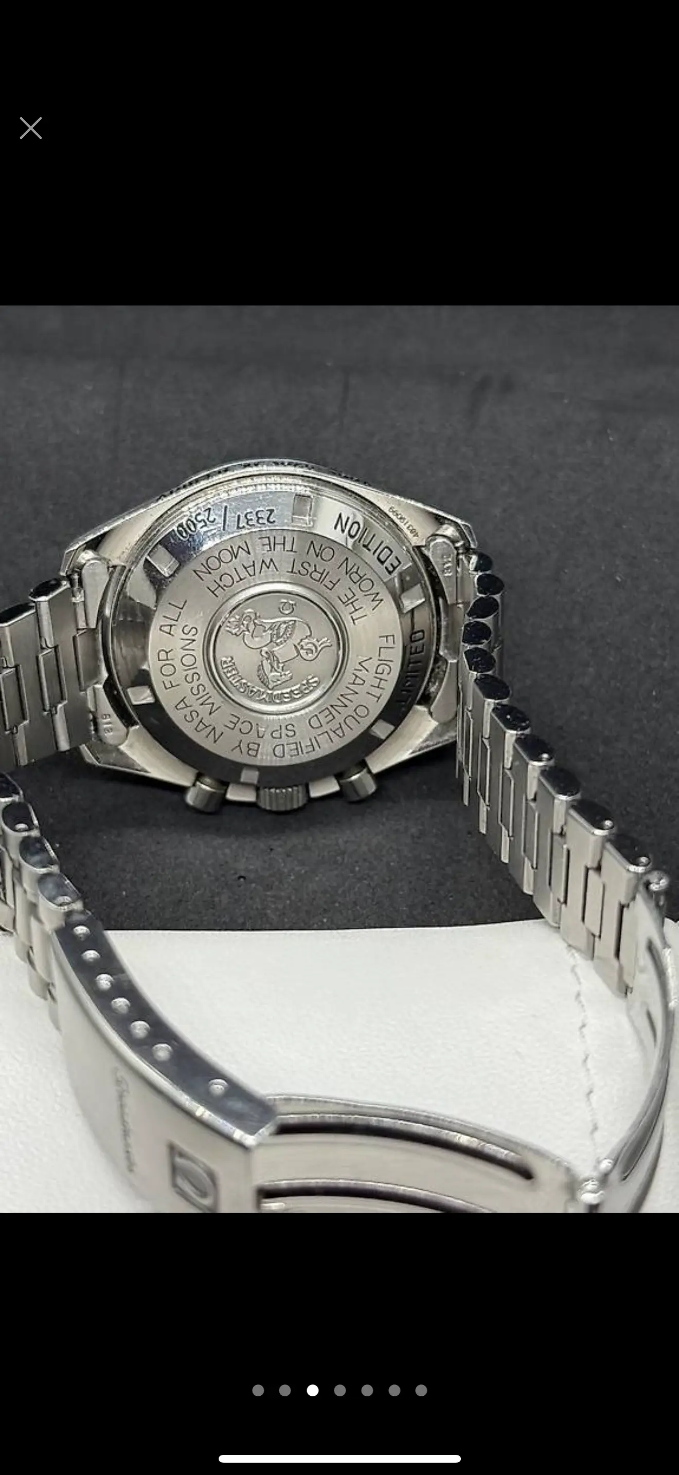

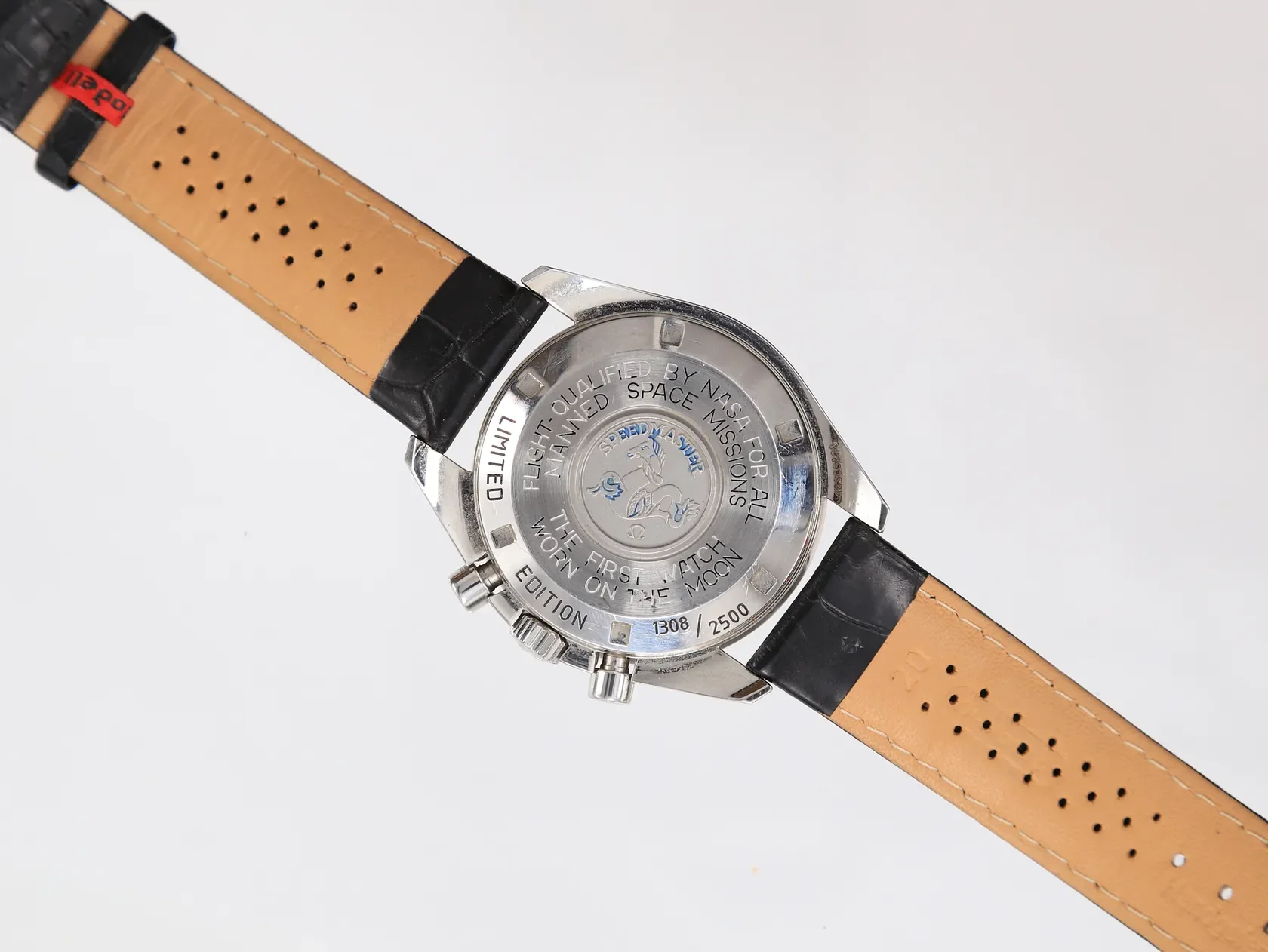

Do you have photo of back? I believe this has open display back

From Zeeee Bible...

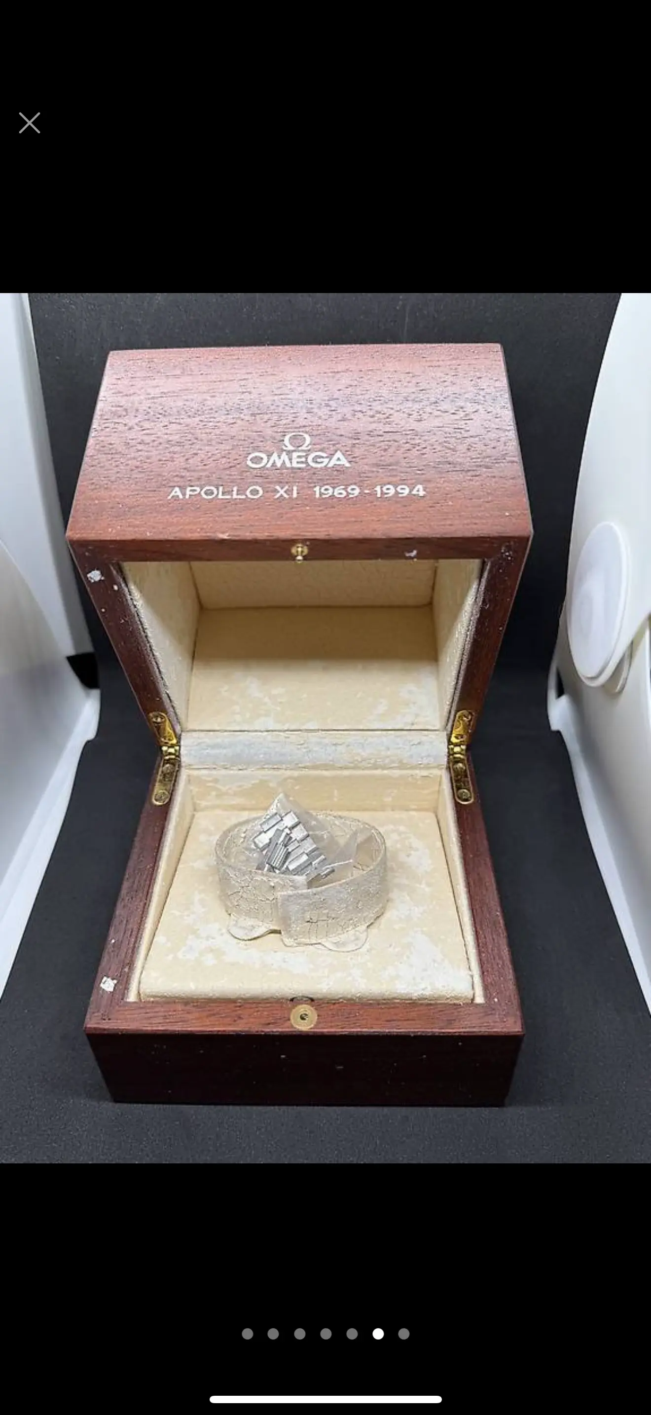

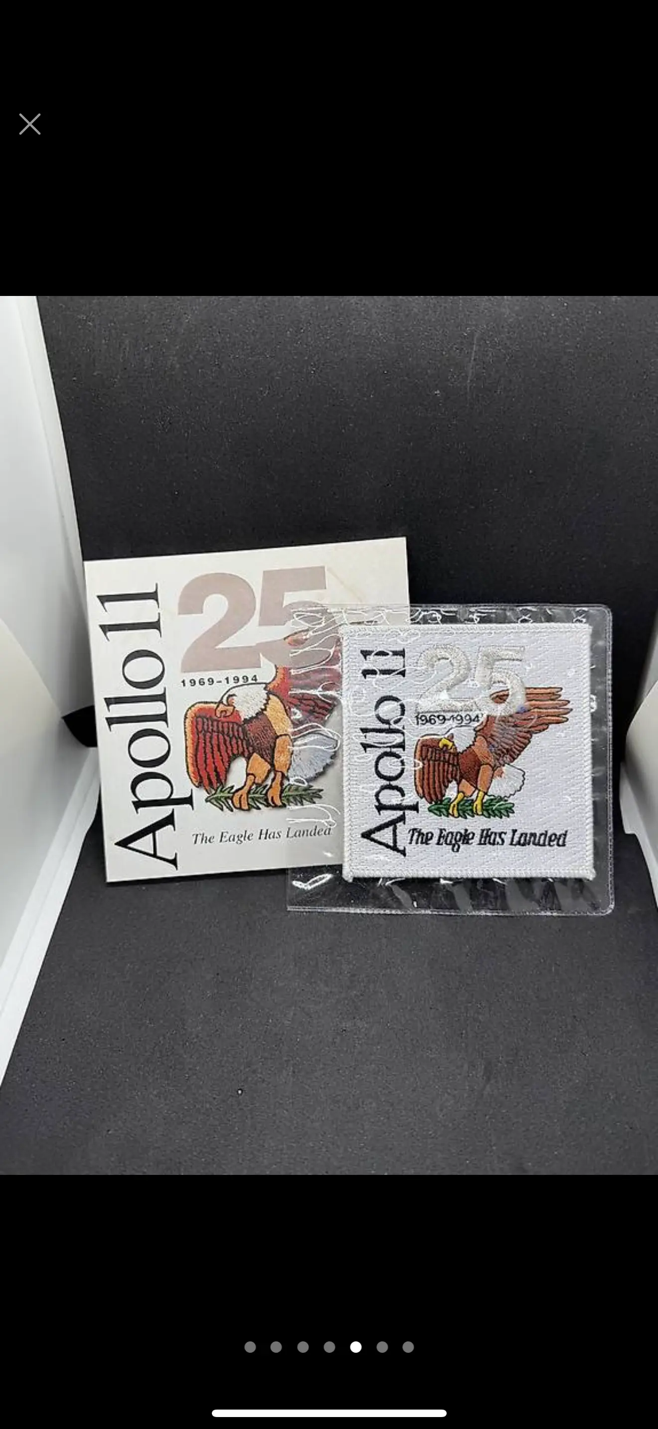

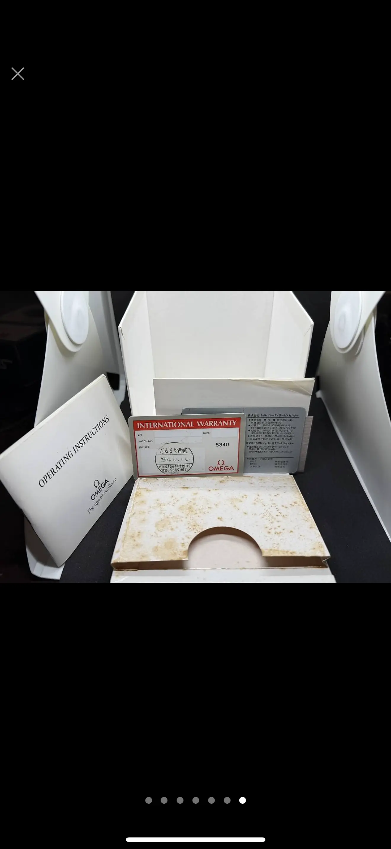

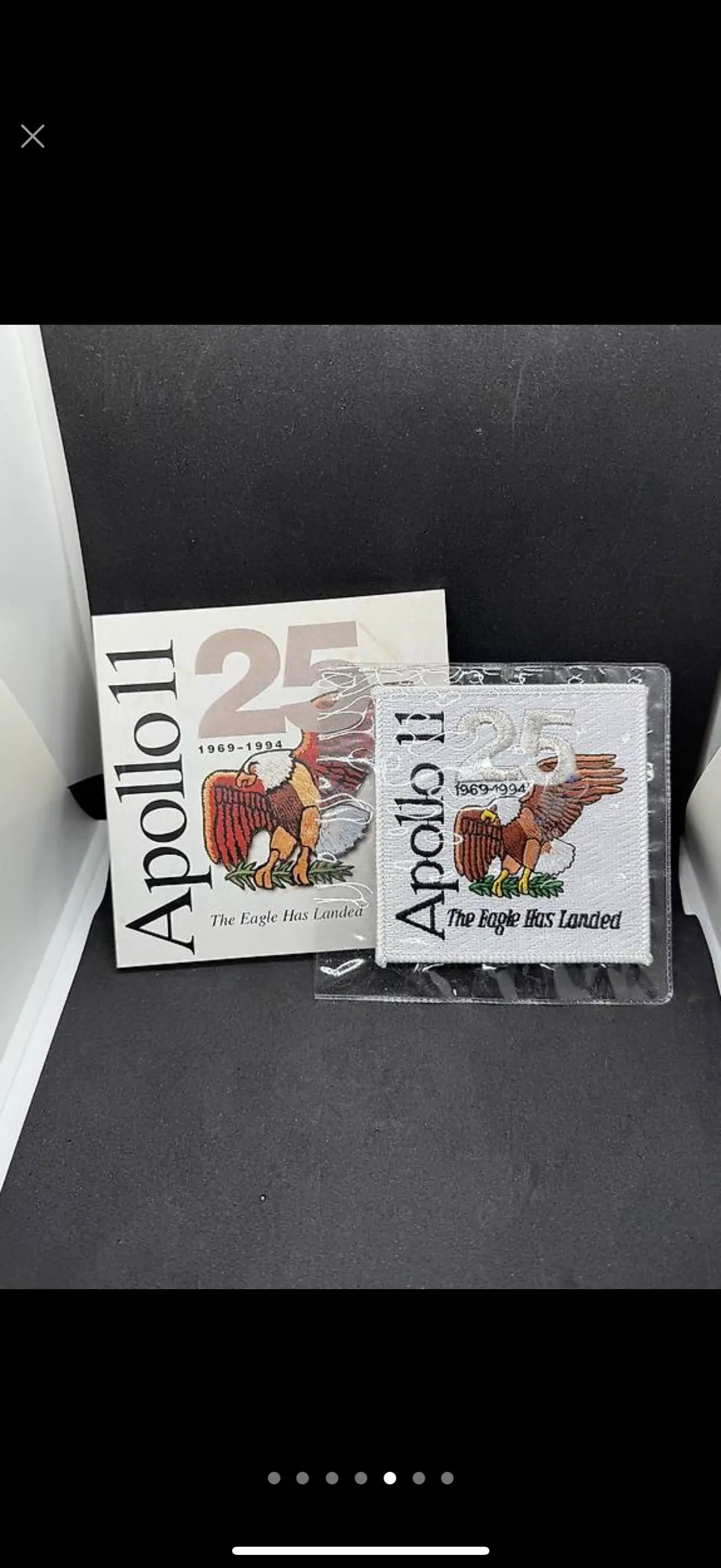

The watch is not coming with the special box , special booklet, patch etc… and in aftermarket strap, also 2 heavy scratch on the side do not play more than 4K USd and this is really the max , a full kit fetch 7000 to 7500 USd

Currently at usd 3200 with 2 days left
They will not provide me with a movement picture, also there is no service history, so I might back off on this one.

This is what you need to get normally , with this release the paperwork and the box keep the value strong, with nothing , 3,2 + service is not bad at all but it is not a regular speedy .
