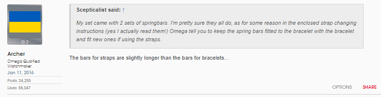

NATO arrived. I was expecting something like a padded envelope with the strap and a small plastic bag with the spring bars. Surprise, here is what arrived. So, do I use the long or shorter spring bars for the NATO strap on my 21mm lug PO?
I would think the shorter spring bars provided would be appropriate for the 21mm lug width, as the strap is sold for the 21/22mm lug sizes. I've bought a few of the 20mm size Nato straps from Omega which cover 19/20mm lug widths and the shorter bars work best for the 19mm lugs.

Yes, I also think the shorter ones should be used for the 21mm lugs.

It doesn't really matter what the strap size is, Omega watches with 21mm lugs on are delivered with partno. 068ST2208 (bracelet) which is shorter compared to the 068ST2209 which are used for Nato/leather.
