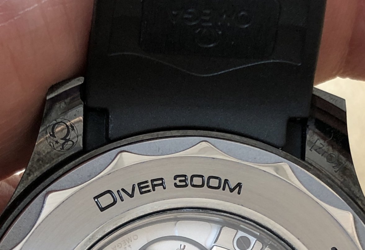

After bringing the issue to my local Omega Boutique, we found another watch in their inventory with the same issue. Both watches then were sent to the service center for resolution. It turned out that the casebacks were, in fact properly locked, but the text on the caseback was simply misaligned relative to the locking features -- a manufacturing error.

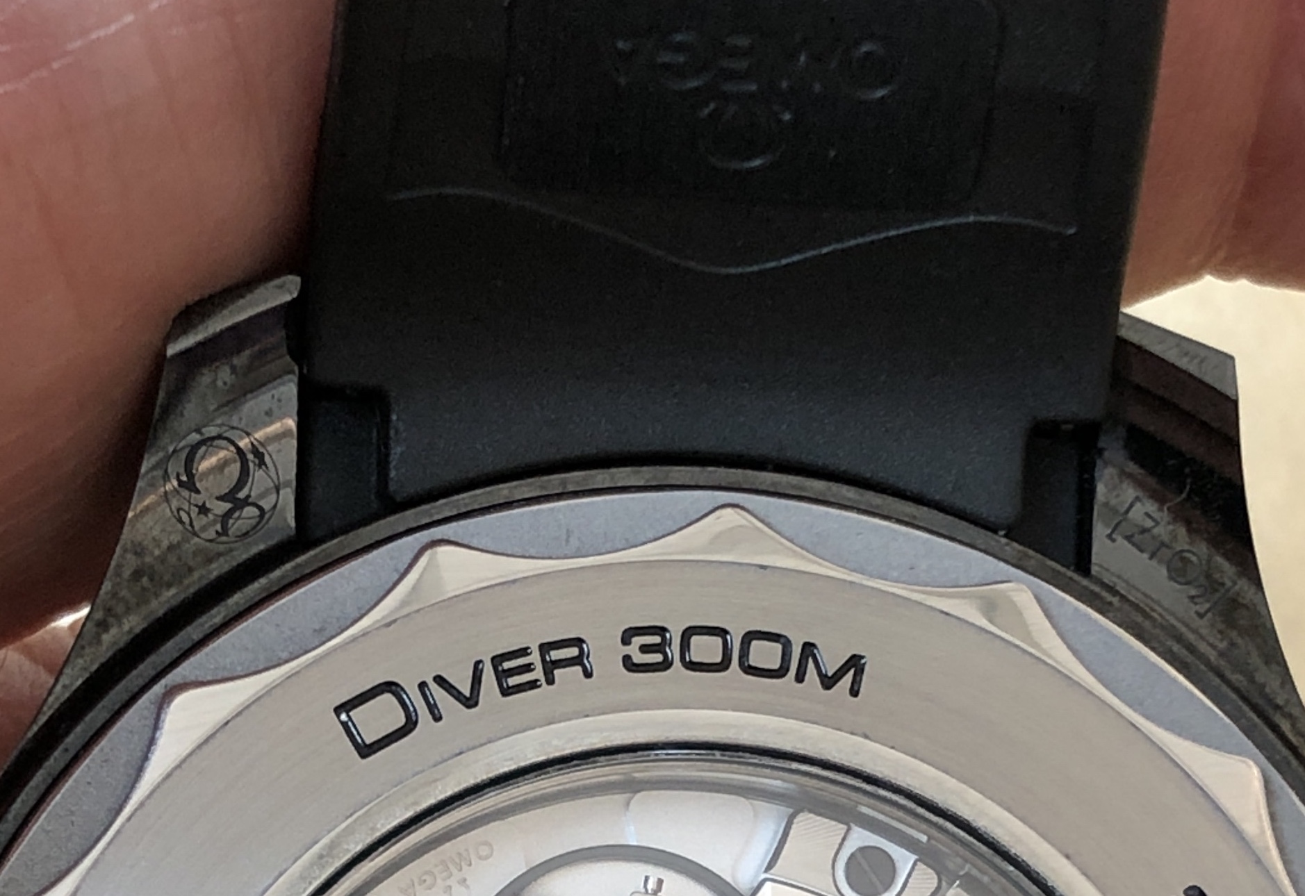

Before the fix, misaligned:

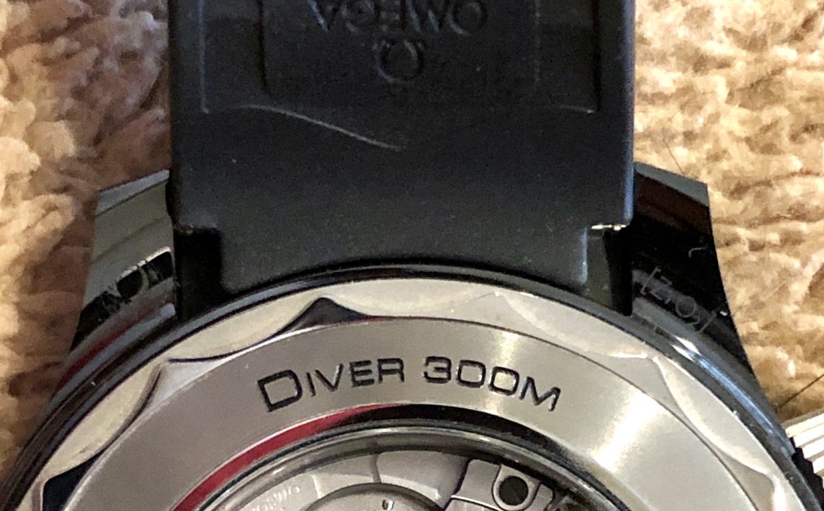

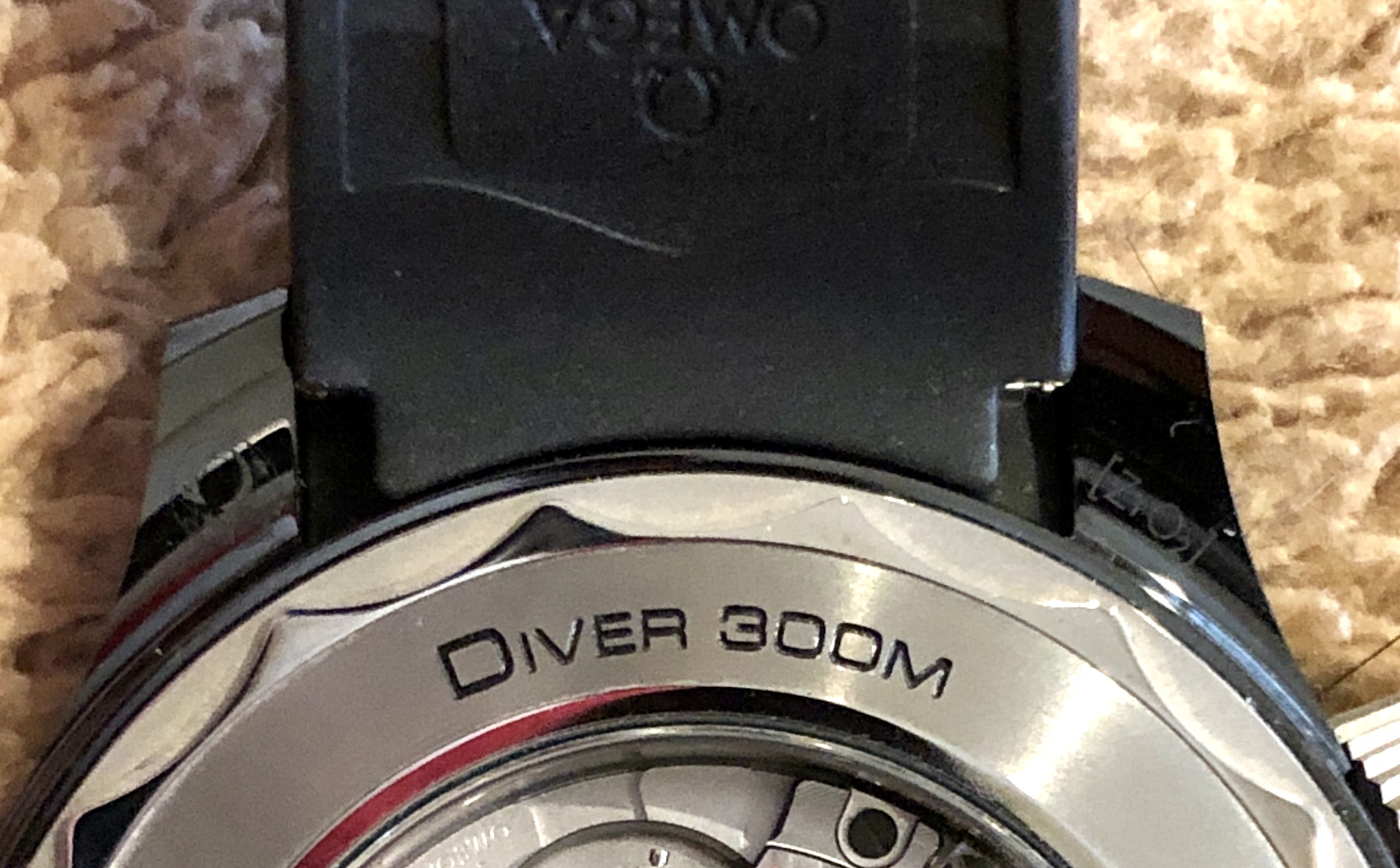

After the fix:

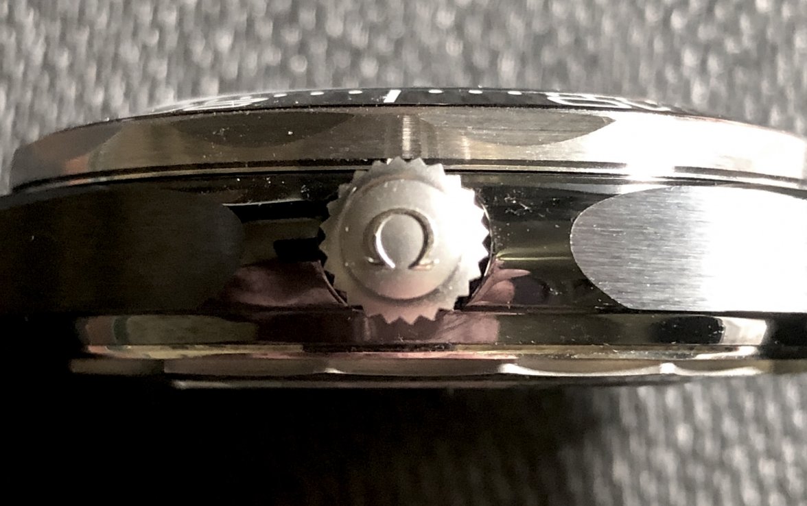

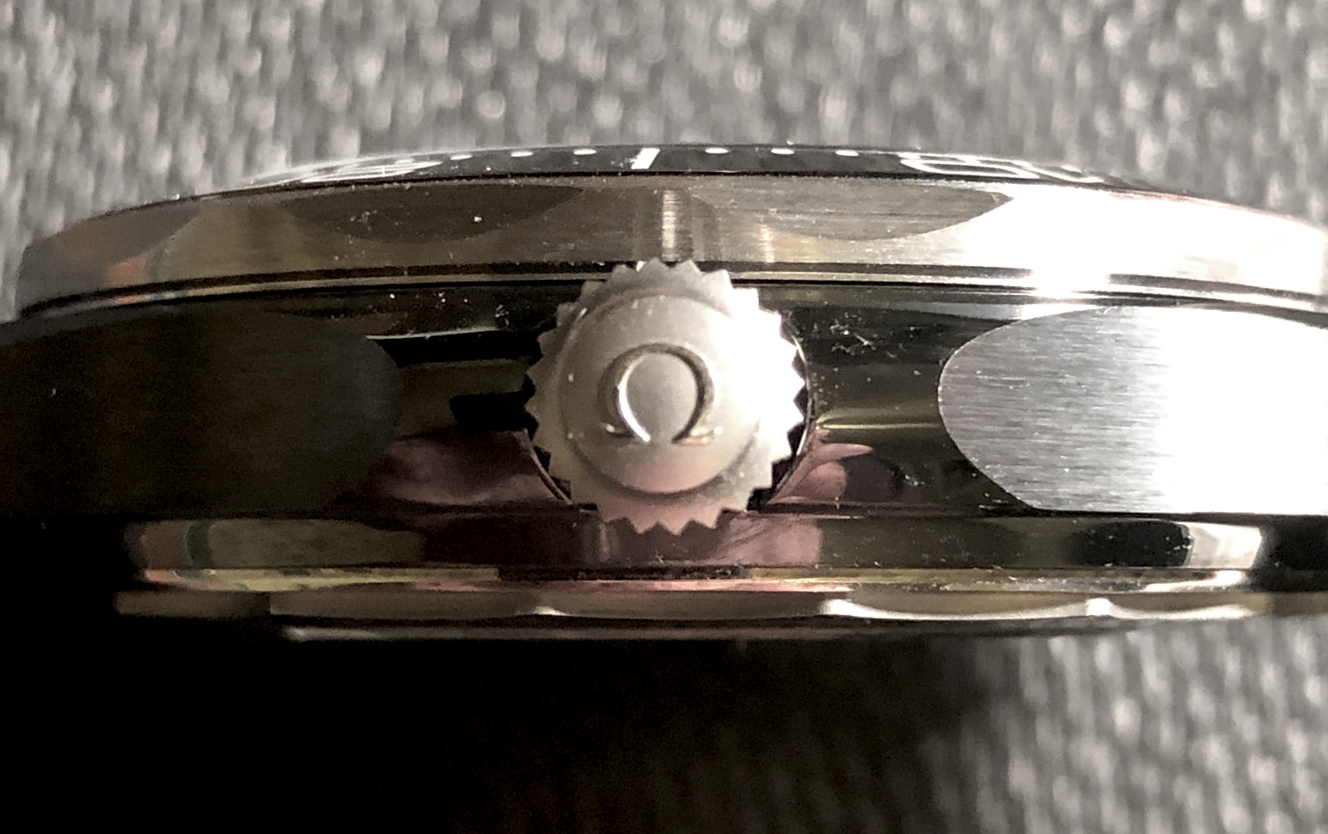

How's the alignment of the Omega symbol on the Winding crown when it's screwed down?
